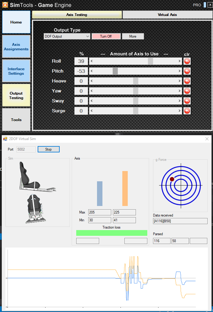

    I turn off an turn on an now works.
    I use @perdicheco tool and I can send information from SimTool Engine to tool and works.

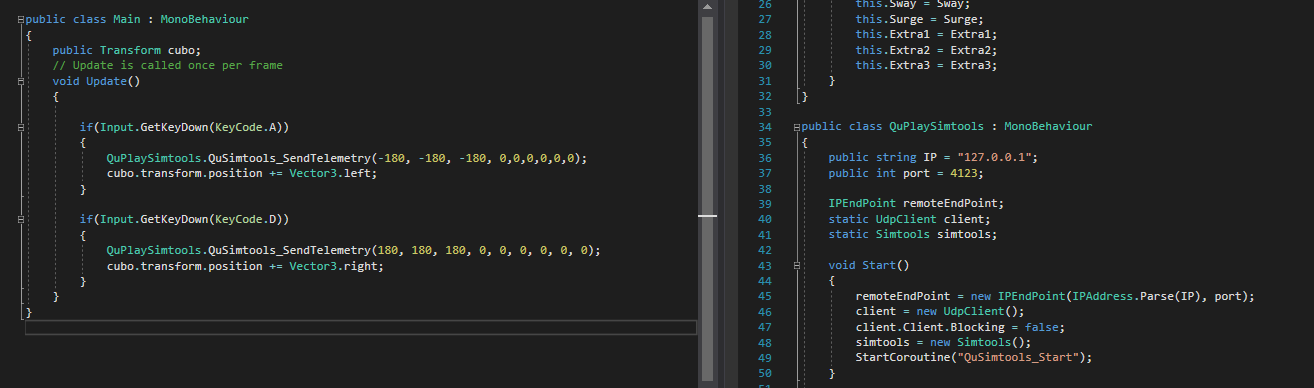

    But when I try to catch the information and send from my game don't work. I cath the information whit UDPReciver but in SimTools Engine don't recive nothing.
    This is my code in Unity:
    And this is the plugin:
    I upload .rar of plugin if necessary.
    Thank so much :)

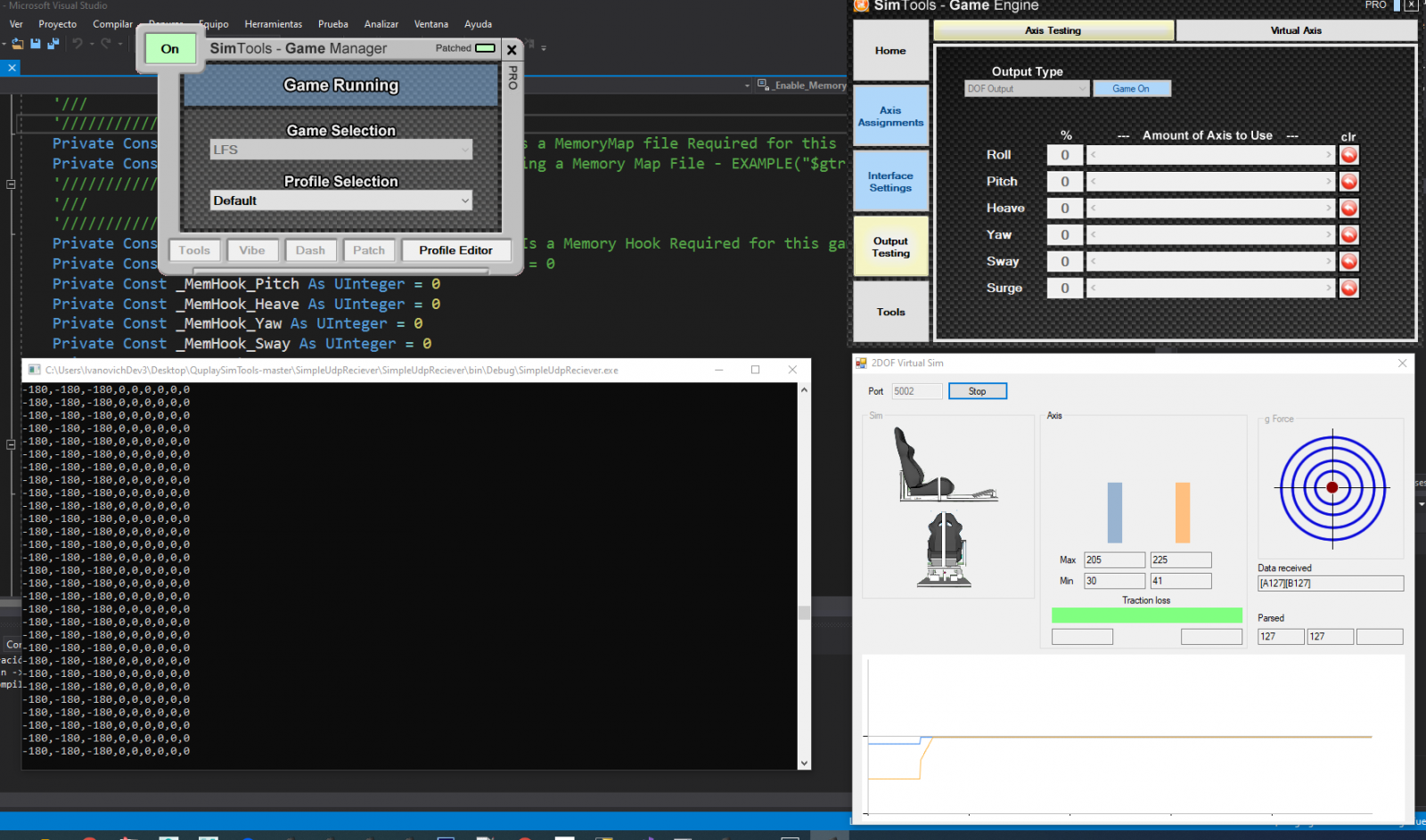

    I try to shitch port but it didn't work. Yesterday I got data to come out in Tuning Center / Game Data -Input and the 2DOF Vistual Sim and it receive the data successfully.
    Now I try to do the same but it didn't works, I don't undestand why. I only just made a plugin for other Game, and occasionally i have this problem https://www.xsimulator.net/community/threads/simtools-v2-4-released.13545/page-3#post-183918 I turn off the computer and sometimes it works and sometimes it doesn't.
    The only change i do before it worked is add a max and min in Roll and Pitch in Tuning Center, but it now didn't works.
    I'm super lost :(
    If anyone knows what happens please explain it to me.
    Thanks!

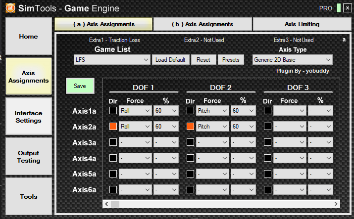

  9. yobuddy
    51,747Coins
    +5,205 / 19 / -0
    How are you installing you custom plugin buddy?
    You need to use the plugin updater or the properties of the plugin may get locked.
    Simply re-installing you custom plugin with the plugin updater will fix it if needed.

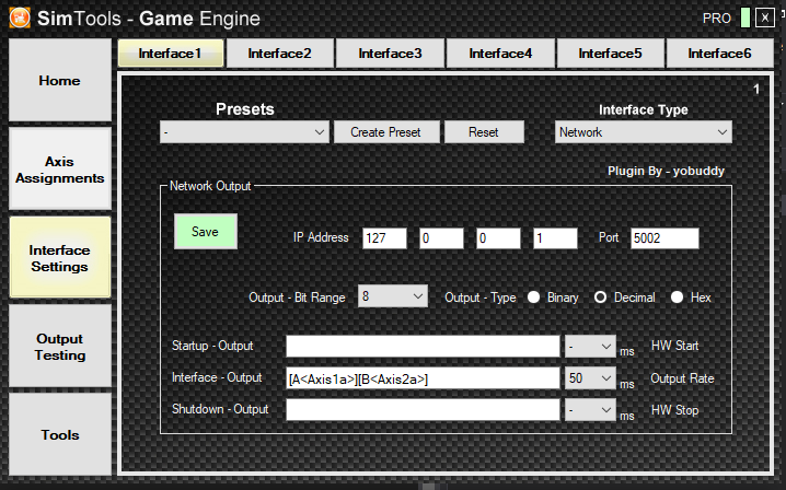

    Also, make sure you have some interface output.
    For testing purposes, select the Network output option, and then assign some Axis outputs.
    If you are using the (a) axis assignments, then assign "<Axis1a><Axis2a><Axis3a><Axis4a><Axis5a><Axis6a>" for interface output.
    Let me know how it goes buddy,

    After doing a lot of test and I found that. If I use a client to see if I send the data well by udp, in Game Engine I don't recieve nothing. When I unisntall and install and testing whitout opening the udp client I recive data.
    Thanks for reply :)
  11. yobuddy
    51,747Coins
    +5,205 / 19 / -0
    Yes, you can only have one receiver going at a time buddy.
    Great job of working thru the problem!

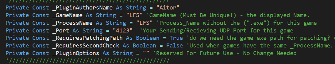

    I'm just trying to use Claudio silva's tutorial. I think the unity's part is OK. It sends frame by UDP to 127.0.0.1 on the port 4123.
    But I can't create a functional plugin.
    The code is this one :
    https://github.com/ddkclaudio/QuplaySimTools/blob/master/SimToolsGamePlugin/GamePlugin/GamePlugin.vb
    I open GamePlugin.sln in visual studio 2017, and I generate the project. Then I have, in /bin/debug directory a file named QuPlay_gameplugin.dll, I drag and drop this file in simtools update plugin, and I hope that it's going to work fine... but not... it doesn't work.
