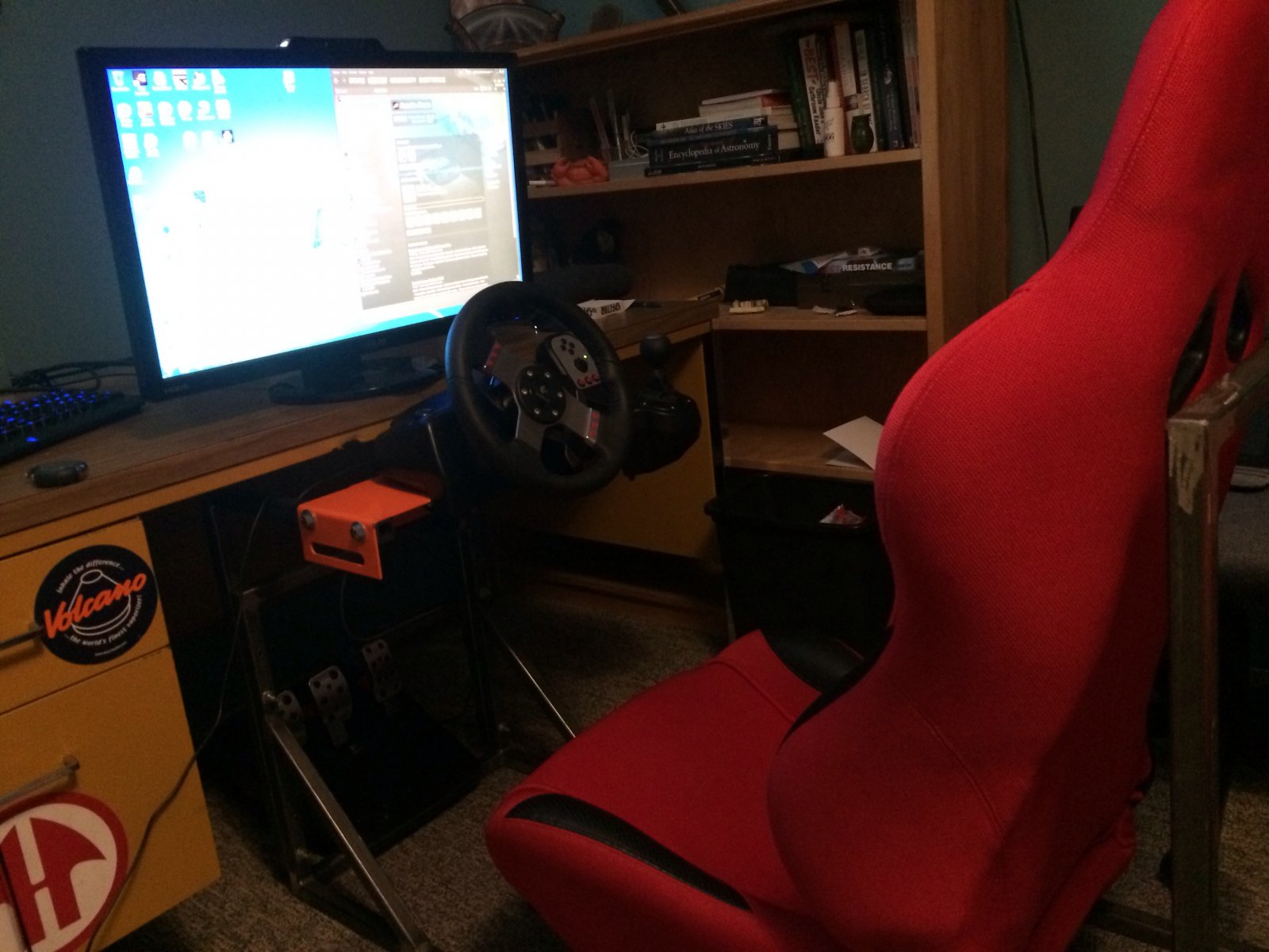

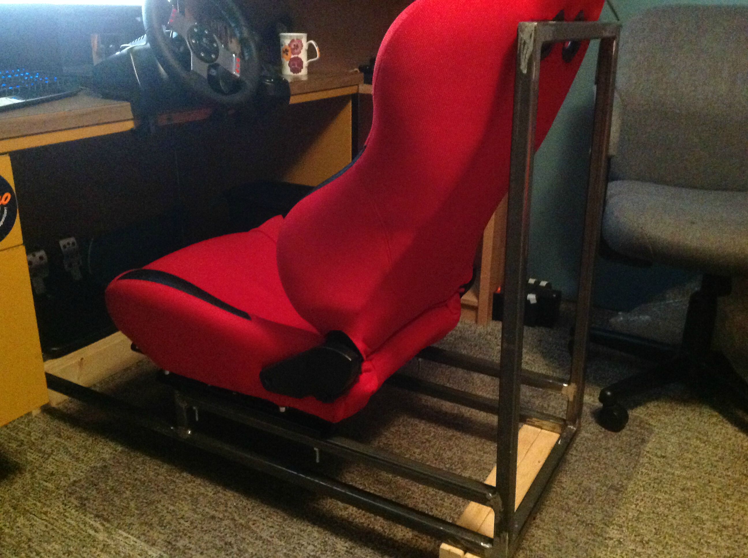

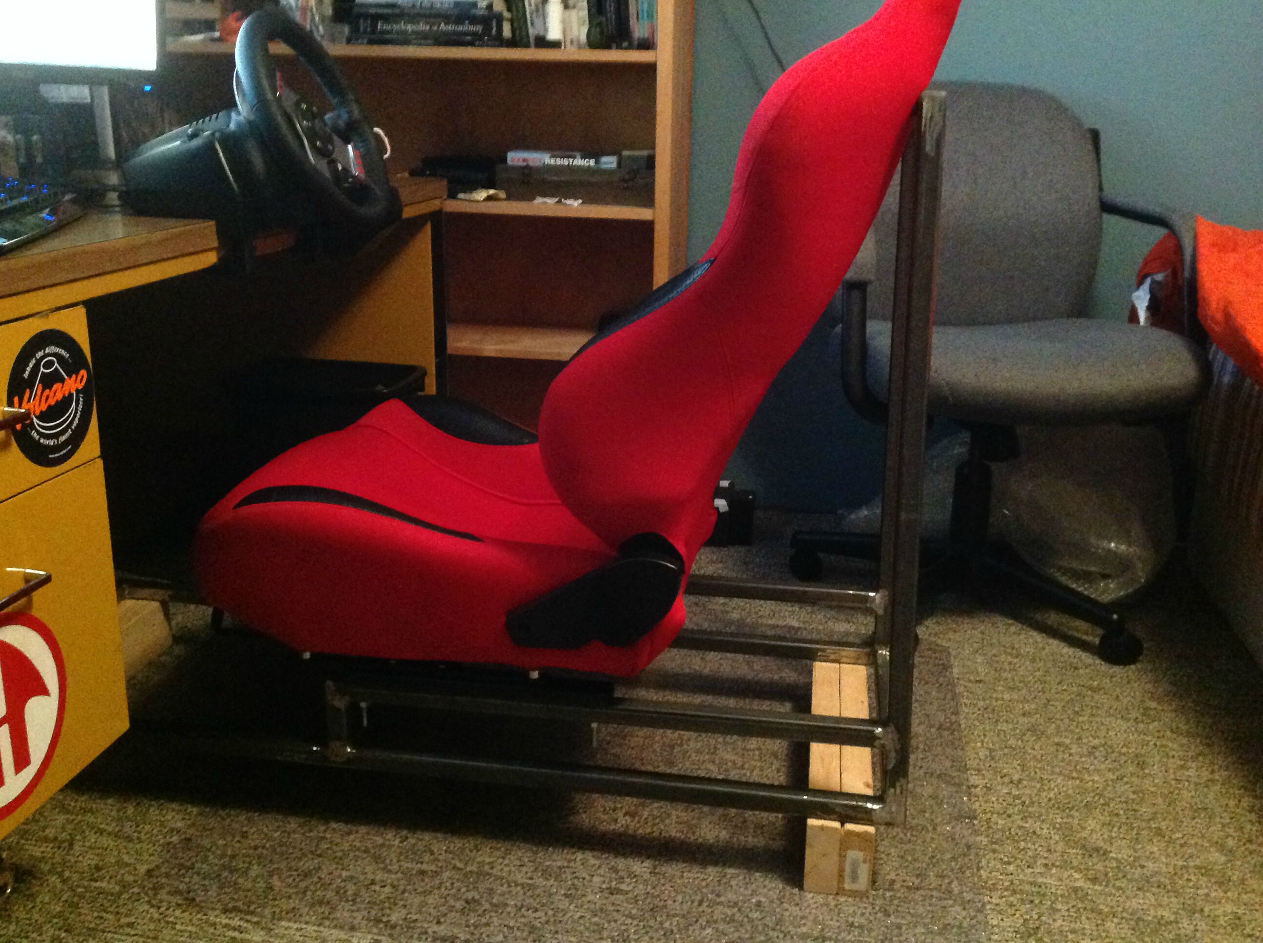

    Hey guys I didn't fall off the face of the earth just other things in life keeping me busy atm. Just thought I would show you guys how the physical rig is coming along.
    Right now the seat is moved far forward and leaned back for browsing but I pull it back and tilt the seat back up when actually racing. Right now its just stating on some 2x4's to get a feel for height and spacing of everything, next will be to build the wheel and shifter mount and get this whole thing on a gymbal base.

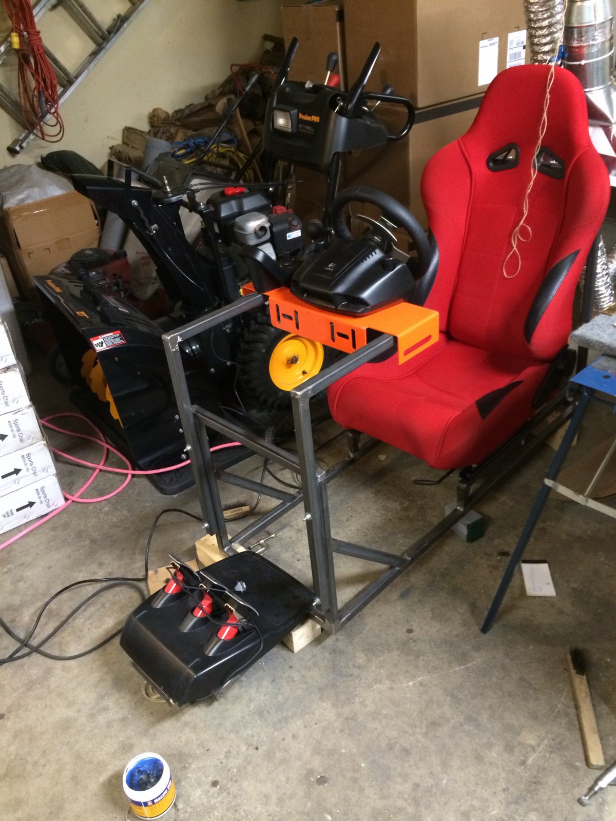

    well guys back again after some time spent in china. I ended up getting the front of the rig done up with the wheel and shifter attached.
    unfortunately as suspected the kangaroo doesn't seem to be a very viable option anymore and I believe that in the near future I will be looking to put together a simaxe board.
    Still keeping an eye on these forums and thankful for all the help that people have been willing to give.
