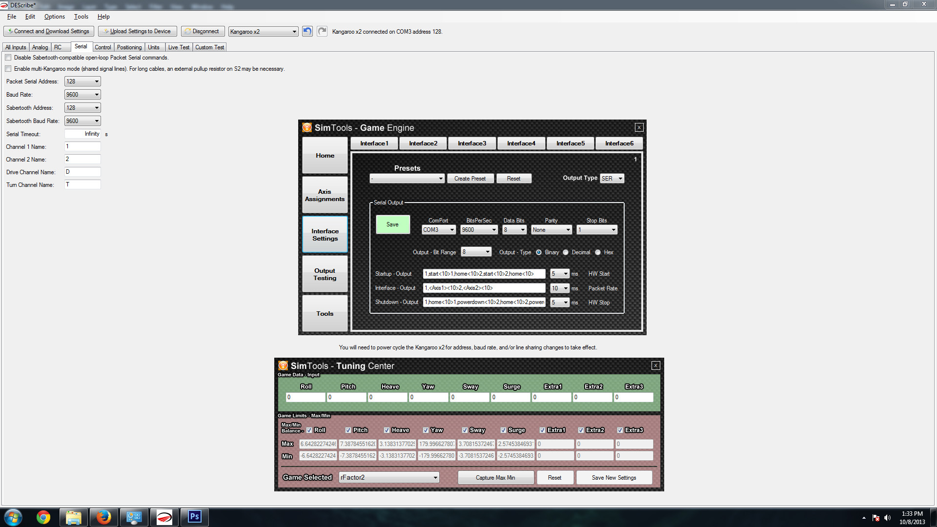

    As for the dip settings those look right for what I have as dip2 off sets analog feedback from pots.
    Now when it comes to these commands you will have to bear with me as I have zero prior experience with motor control and input commands/coding.
    As for understanding the "interface" field Ill just write out what I assume it mean and you can correct me where I'm wrong. (1,<Axis1><10>2,<Axis2><10>) so the first "1" identifies motor "1" in the sabertooth then the ",<Axis1>" uses the comma to associate motor "1" with "<Axis1>? As you said if I enter <10> in that same field that just tells the software that a new line starts with new commands?

    yes <10> is a new line.
    In a windows terminal it is controlled one line at a time. so we need a <10> in between commands.

    Right on, that was what I was assuming. Now that I'm home from work I will have to see how the sabertooth/DEScribe software has the "home" location set. Right now it knows the high and low limit through the switches and has the mV range for those as well through the pot so one would think I could set the "origin" or "home" to whatever value between the limits and the controller should know that is "home" from the commands.
    Edit: also I was wondering what "bit range" to use in simtools. I contacted dimension engineering and they said it will accept up to 32bit range. In their documentation for "packetized serial" with the sabertooth it shows 7 different commands in "independent mode" but 17 total which include 6 "mixed mode" commands and 4 setting commands?
    Edit2: Also working on getting Assetto and Rfactor2 to play nice with simtools and get virtual axis feedback, nothing yet, still trying options.
    Edit3: Seems my g27 will no longer interacts with rfactor2 after using simtools with it again....hmmmmmm wondering if a game reinstall might do it. (Reinstall didn't seem to work which is odd since assetto corsa and netKar still function fine, might try deleting the controller .ini and letting rfactor make a new one)
    Edit:4 yup seems to have been bad controller.ini files, got steering working in game again.

    Alright so I have gotten the wheel to work again with all the games I have, and on top of that while playing rfactor2 in windowed mode with the virtual axis panel in view I could see "slight" movement of the roll and pitch sliders. So I believe I have simtools grabbing the game info properly, I just have to see now If the commands in the interface field are correct by seeing if I can get motion in the test rig.

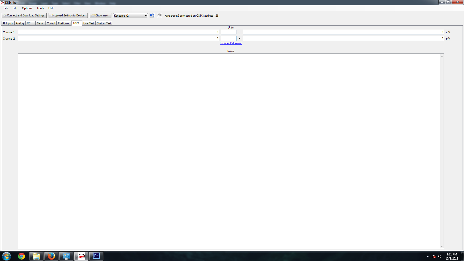

    I'm still a little unsure as to what units simtools is putting out and how I should define the saber/kangoo combo units, they are x=y in the DEScribe software with the "x" being the user defined value and "y" being mV from the pot feedback i believe. Any help on this would be awesome. You guys are making this possible for me :)

    First of you may find the Min Max values in the tuning centre to be a little high, these can be changed to suit your simulator (Test Bed)
    Second Sim Tools sends the value in 8 bit 0 - 255, so the x value <Axis> will be a value between this and uses 63 as the centre point.
    Other other side if required you can set Output bit range up to 16 bit - 0 - 65 536 with a centre of 65536/2. All depending on your needs.

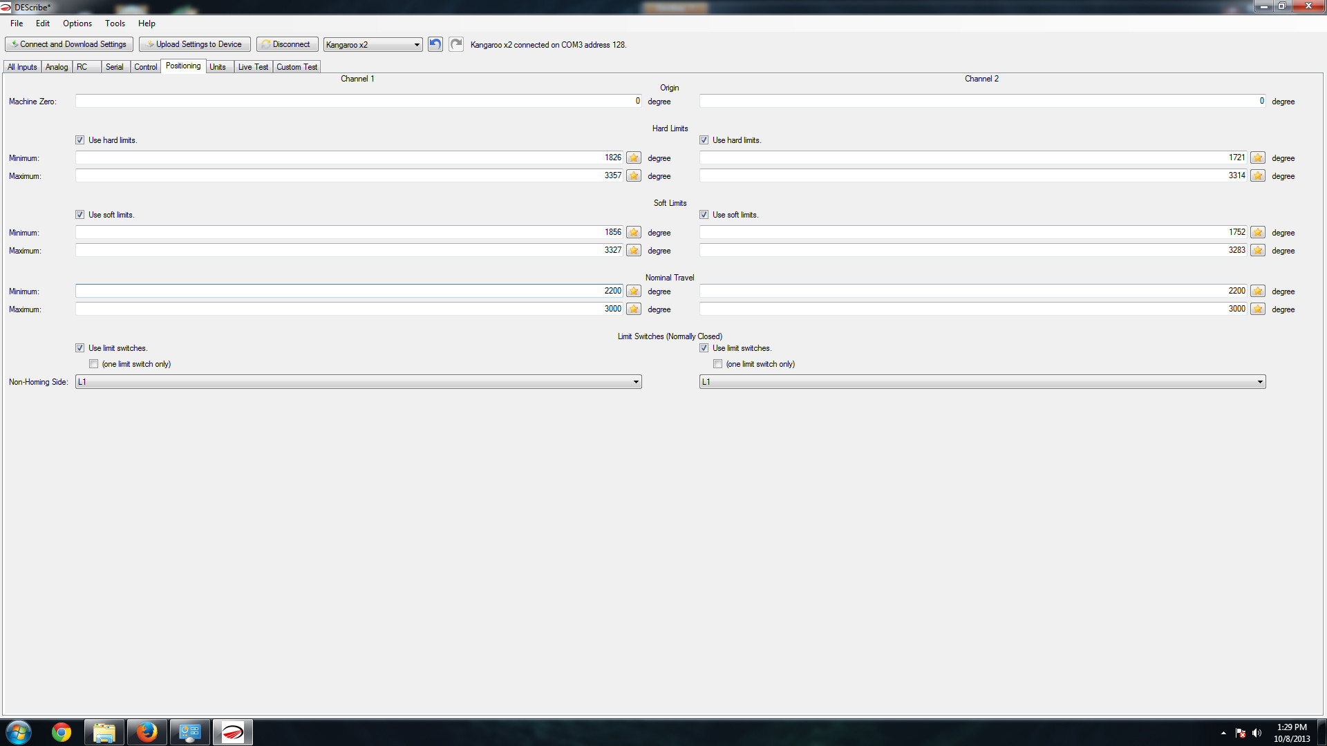

    Here are some pics of the DEScribe software where I can enter my limits and units and the fields I have filled out in simtools and gathered from rfactor for tuning.
    In the range field it should be "mV" from the pot feedback and not degrees as I have labeled. At the moment I can't seem to get any motion from the motors in output testing.
    Again my lack of knowing anything code related is becoming obvious.
    Edit: with the command you are talking about 0-255 it seems they are "simplified serial" from what I have read in the kangaroo/saber manual. Right now though I have the saber dips set to 1 and 2 off for a "128" address in packetized mode which is what the DEScribe software said to use? In the saber manual it says that a dip setting of 1 on and 2 off gives "simplified" mode and 4 off give it a baud rate of 9600.
    Edit2: This is from the saber manual in its section on "simplified serial mode"
