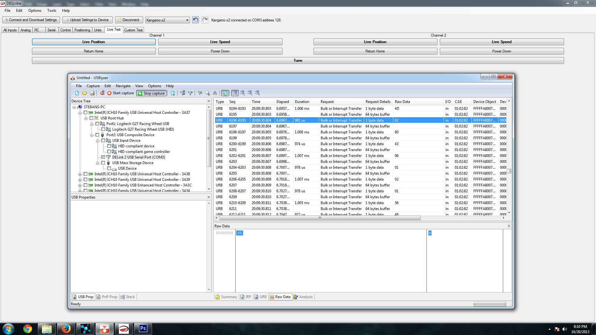

    This is the output of DEScribe which works good

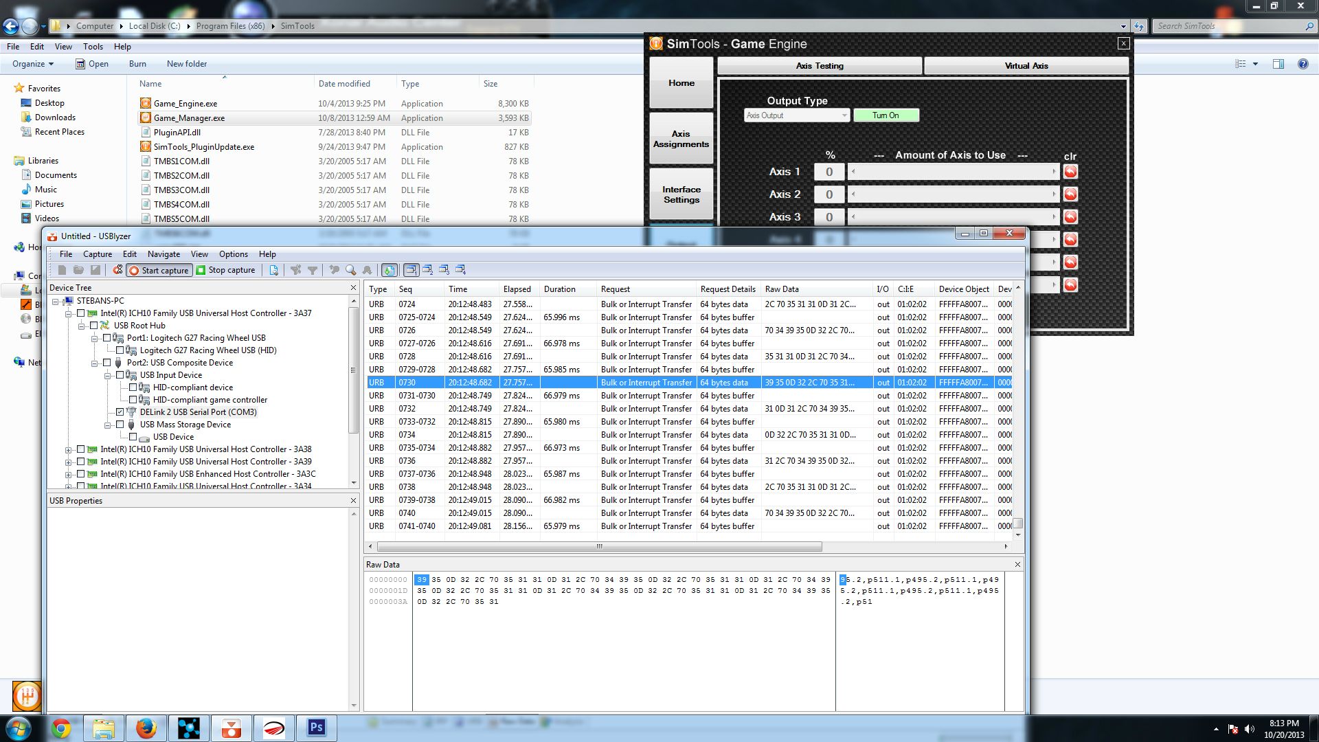

    And here is what simtools is outputing (keep in mind the values for positioning are different as here I have it in 10bit mode
    I hope this helps

    As stated I'm not extremely knowledgeable with this but the obvious is the slow output from simtools. Did you set over 30 ms delay in simtools? It also looks like maybe simtools is not outputting the <13> properly.

    I think the 1 byte is when a carriage return executes in describe. In simtools it sends as 64 bytes. Maybe that's where the delay happens. The buffer could be waiting to time out.
    Edit: Only problem with the 1 byte statement is that the raw data column is showing different values for it. If it were always a carriage return the raw data would always be the same.
    Edit2: However, there is a direct coalition between the execution times and the number of bytes of data sent.
    Edit3: It appears simtools is waiting until the 64 byte buffer fills before it sends out the data where describe is executing byte by byte.
    Edit4: It just dawned on me that Describe software uses packet serial where we are using simple serial. That's probably why it is sending out 1 byte data. That's how packet serial works on the kangaroo apparently, just like on the controllers. Since simple serial on the kangaroo sends texts commands, not single bytes, it will take several bytes to represent the command being sent to the kangaroo. But 60ms execution is way to much. I still think simtools possibly is not executing <13> properly and it has to wait for a time out to occur. That is if you don't have a large delay set in the simtools output. On the other hand, if the 60ms execution and the 64 bytes data represent several commands being sent out and executed, then it might be just fine.
    Edit5: simtools is sending out a 13. I can see it in hex as 0d even though is looks like a period in the text output. I think this means simtools is working okay.

    Making Interface in simtools 30ms instead of 10ms like I had took the latency down. Its better but still not as good as DEScribe
    EDIT: I have also only been able to get movement when using 12bit as it seems that the unit conversion is a little funny as well, since I can only get movement between 2000mV and 3200mV when It gets a signal within the 4096bit range.

    Edit: simtools output about 8 kangaroo commands in that 66ms time at the 10ms delay setting. Thats actually over 100 updates per second. That's not bad when the kangaroo will be handling the actual motor adjustments at a much faster rate!
