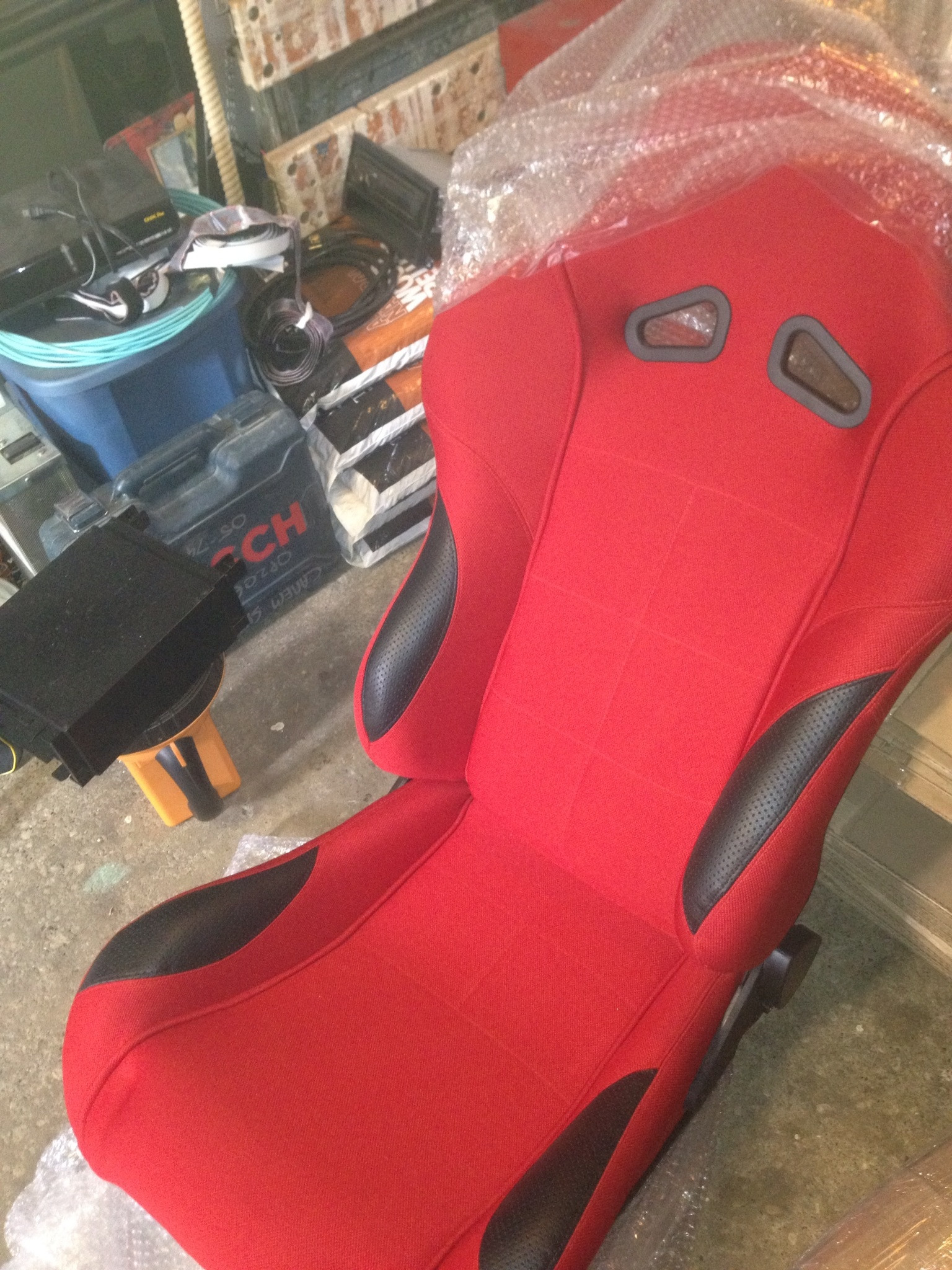

    Getting exited since I grabbed this new on the way home from work for $125canadian[​IMG]

    Sweet seat, Will look good on Sim. Red ones go faster.
