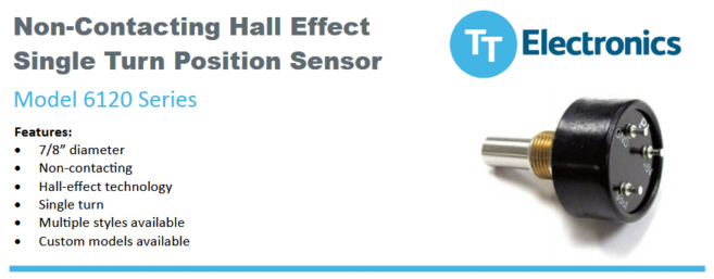

    A lot of us use these. You can get them for around $15 to $20 and they're noiseless because they're non-contacting.
    Since you can't reverse the output on hall pots by switching the wires that's why I just say reverse the leads to the motor because that works in either case @MarkusB.
