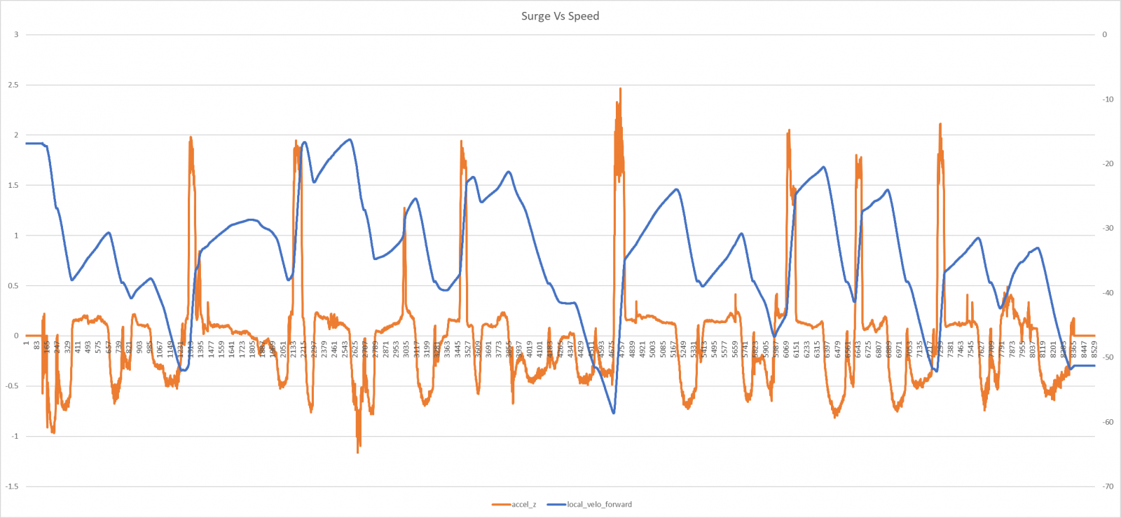

    Hi @vthinsel,
    I've attached the 2 files generated but I've had to add the .txt suffix as they wouldn't upload otherwise. The car was the Renault Clio RS at Brands Hatch GP circuit.
    I hope it helps you resolve the issue. If you need any more info please let me know.

    Wow ! You upgraded the engine ? Getting more than 10G with a Clio RS :)
    Indeed the result is weird. With constant speed increase, we should get a stable forward force. I'll check more in details when I'm back home if I have the same behavior and debug the issue in more details.
    You said you tried with earlier versions of the proxy, and you had the same issue, right ?
    Version upto 1.2 uses regular math operations, without numpy/pandas. It is here: https://github.com/vthinsel/GT7Proxy/releases/download/v1.2/GT7Proxy.exe

    Hi I've literally changed nothing. I've gone through the initial driving lessons just to be able to pick a car and circuit. I started with your initial release of the proxy and the surge worked well but as you can see it's now erratic. It was only when I looked again at the plugin I saw an update but that didn't change anything and then when you mentioned further update I downloaded that. So I would suggest the sway issue was there from the start and the surge happened with one of the game updates.

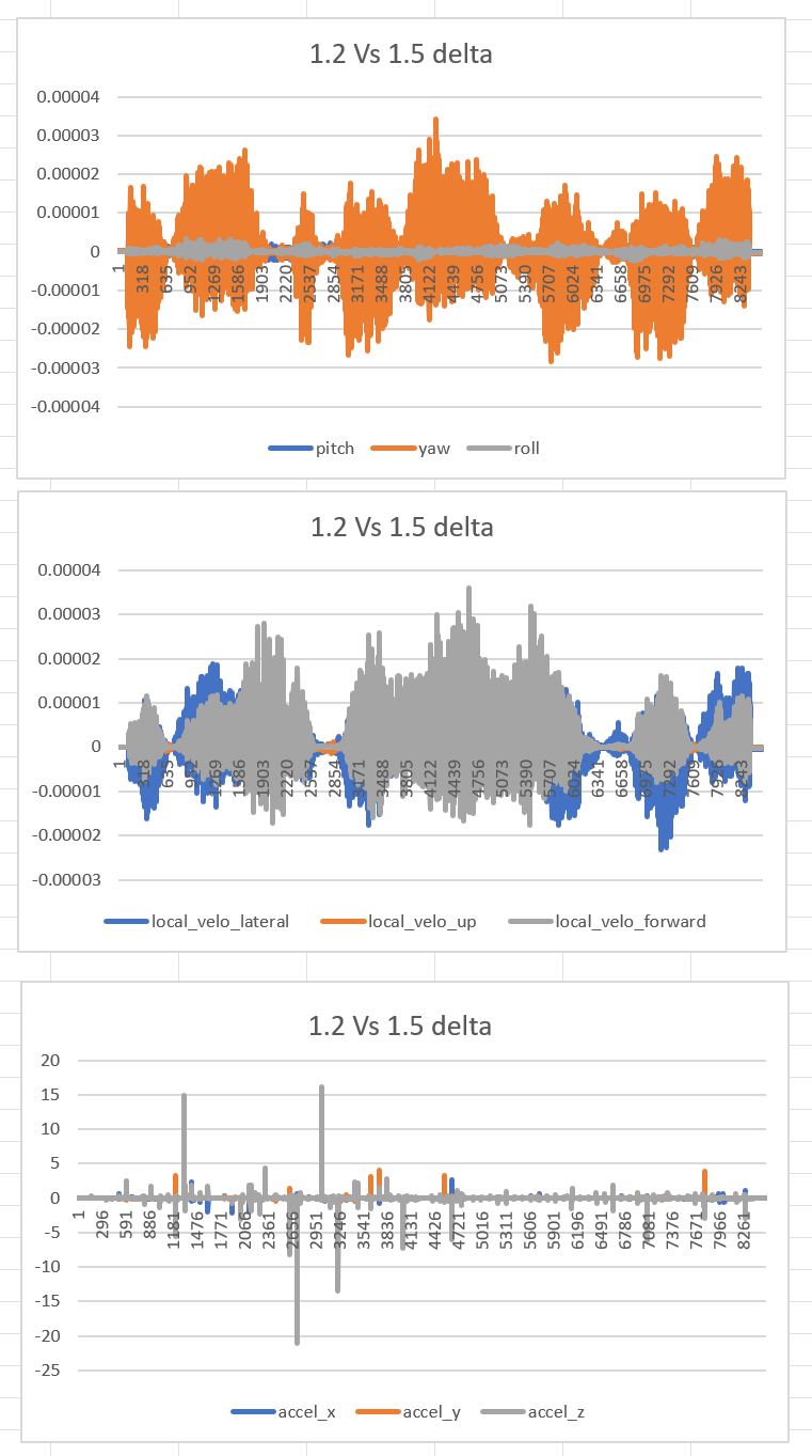

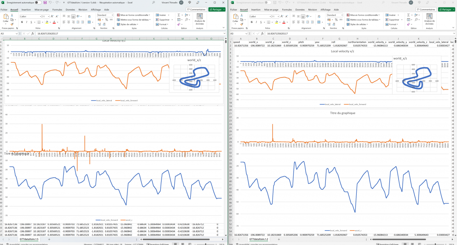

    Well, I have done a comparison between version 1.2 and 1.5 (1.5 uses numpy/pandas) and the result is interesting. I used my record/playback tool to have the same basis:
    version 1.5 on the left and 1.2 on the right.
    Local velocity looks the same, but we can clearly see that the surge force is different. This is strange as well because surge is just a delta of two consequent local velocity values divided by the time. I need to dig this further, but unfortunately, I'm off tonight for 3 weeks.
    For now, I suggest you go back to version 1.2. I'll also pl$ull-out version 1.5 from github.
    Thanks for pointing this issue. Feel free to open a bug as well on github.

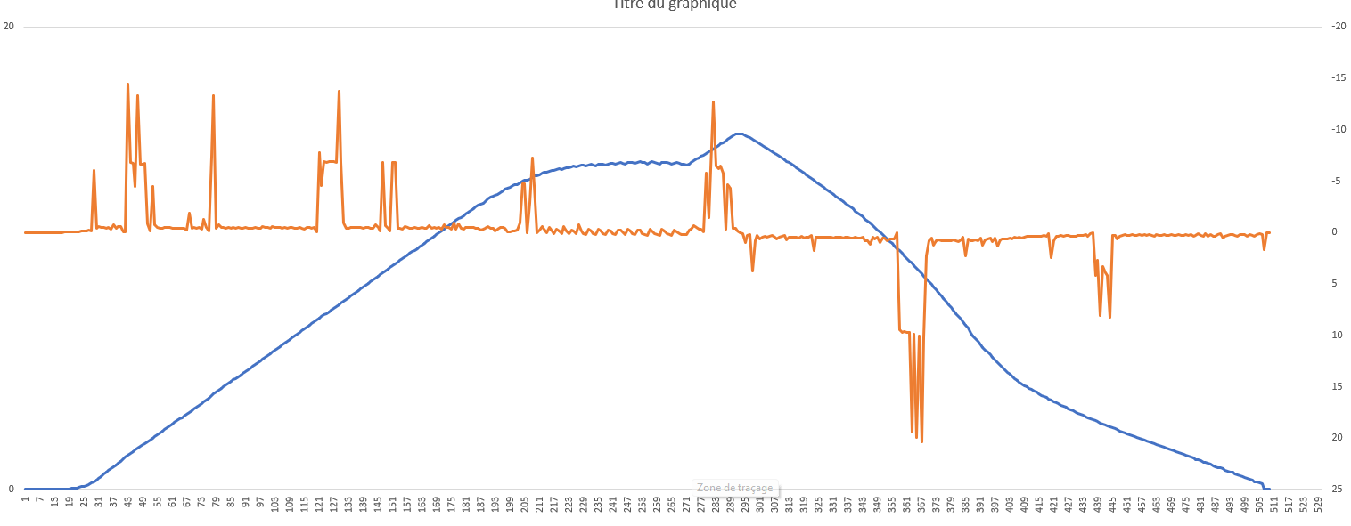

    roll/pitch/yaw and local velocities are fine in both versions. I really need to find a better way to compute the forces :

    Hi @vthinsel,
    I've tested it and surge is much better. Did you make the same changes to sway as that seems a little better but still has the random direction changes.
    Thanks for your efforts!

    Good News then. Yes, all forces use the same calculation. Will check if this can be improved when I get back in a couple of weeks
