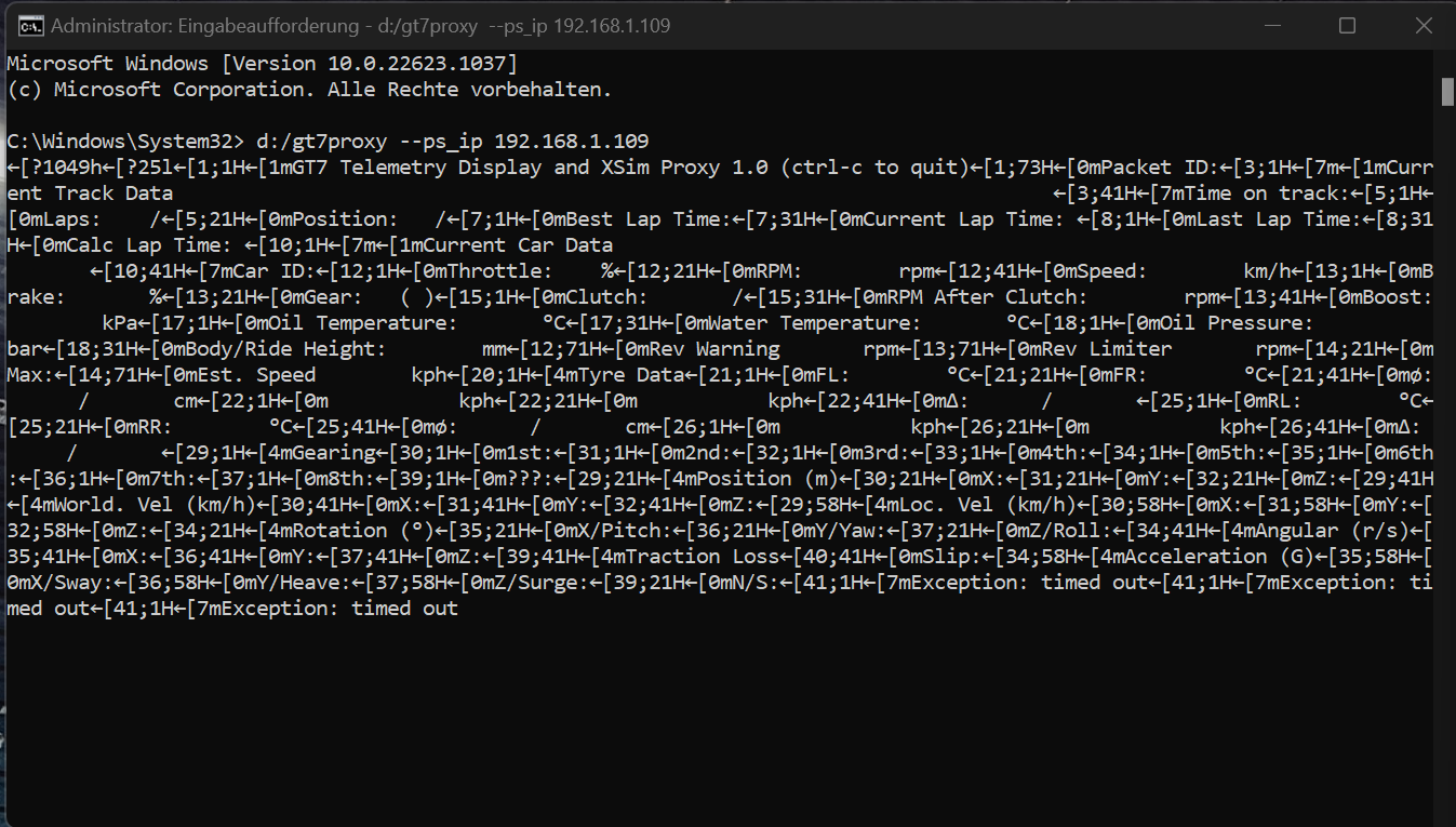

    Hi @ all,
    1st of all thanks for that nice piece of software. Sadly I cant get it to run :/ got a njMotion Compact-R and wanna try to play GT7 with motion, but that thing doesnt work on my win11 Computer. I post a screenie from my desktop, would be nice when anyone could help me out. Thanks in advance :)

    Hello .
    Try in something else than powershell ISE.
    A simple cmd window should do the job.
    Happy new year !

    I wish you and your fam a happy and a nice new year :) I tried it with the nornal cmd app of win11 but with that I got a tineOut, I make a Picture asap and show you what I mean, thx for helping :)

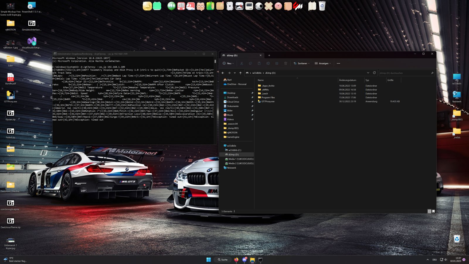

    ...thats the output that I got when I use a normal cmd window on my win11 pc.

    hmm sorry for pinging, but I cant edit my posts :/ I tested a random iP instead of my PS5 iP, and I got the same output as I showed you in the screen before (with the satndard cmd of win11). Thats crazy cause thats an iP outside of my iP range : I tested : .\GT7Proxy --ps_ip 192.168.0.109 and .\GT7Proxy --ps_ip 192.168.5.13 and both gave me the same output/result.

    Telemetry uses UDP, with no handshake or whatever. So you can put any IP you want, it will alaways give the same result. Check firewalls (including on your windows PC).
    Timeout messages can be an issue related to antivirus/windows TAP/VPN interfaces. Anyway, even with timeout you can get telemetry data. That's my case on one of my windows 11 laptops.

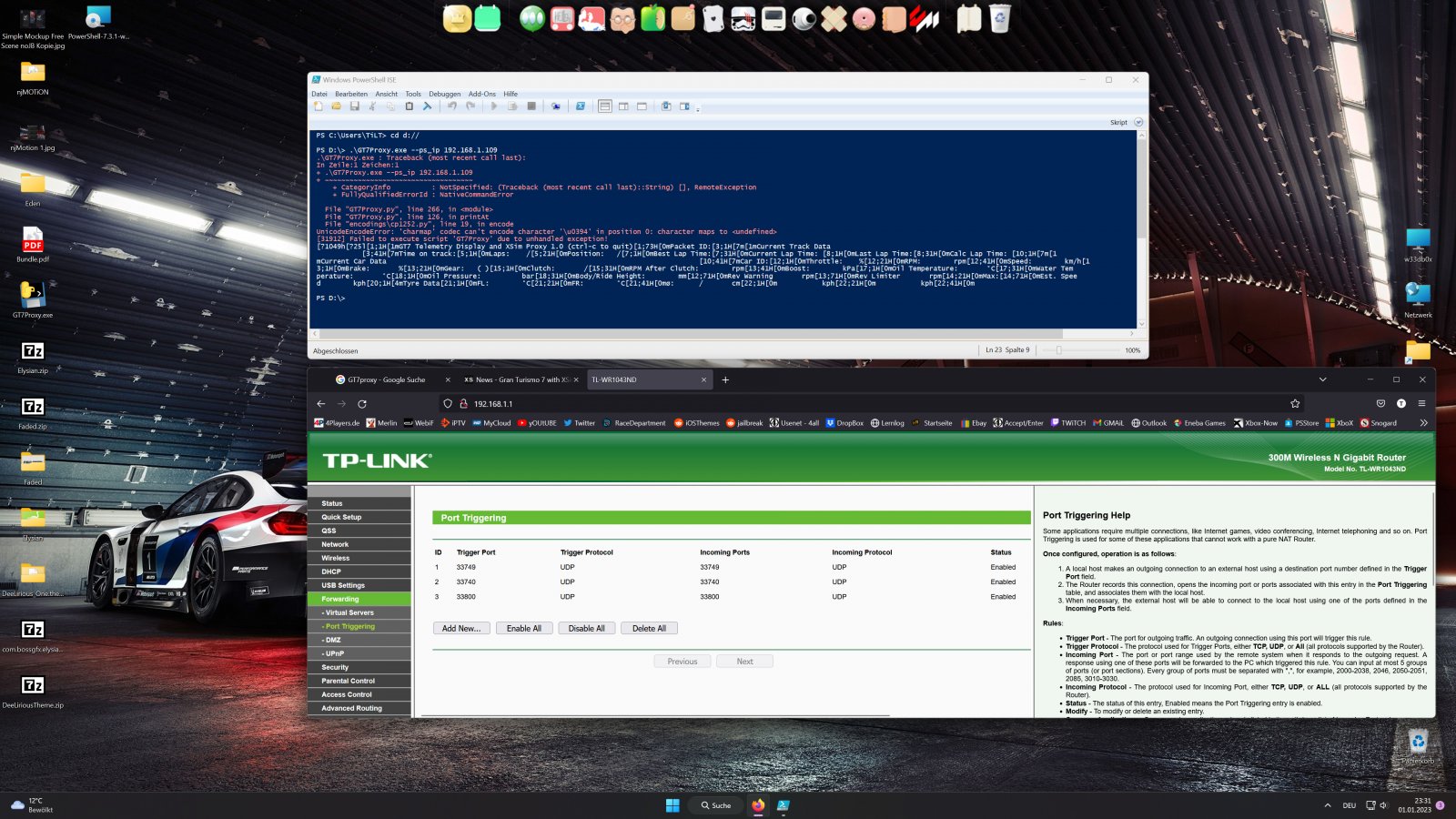

    hmm, I dont get that thing to work :( I disabled every security releated settings in windows and disabled my AntiVir, but sadly with the same result. I tried already to ping my PS5 in my homeNetwork with success, but everytime I try GT7Proxy I get that timeOut and no Packet iD :/ do you see my router settings where forwarded the UDP ports? Maybe something is wrong there...?
