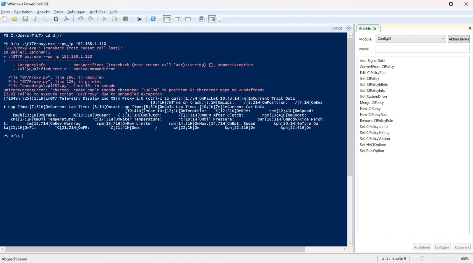

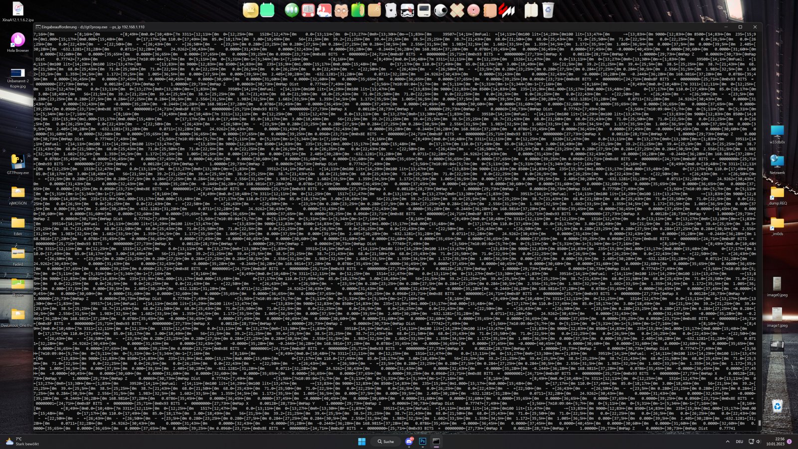

    Hi buddy, did you see my streamable link? Is it normal that it looks like that? I tried so many cmd apps, but no one give me the looks that you got in your video/screens. Maybe that has something to do that I use win11?

    I use win11 too. Just make it full screen, as it requires many columns to display all data.

    Hi Buddy thanks for your help, but as you can see that didnt help, and the powerShell ISE thing put some errors out, maybe that could help you. Can I ask you what version of PowerShell you are using? Cause in your video you have tabs in you PowerShell window.Could you please tell me the correct cmd that I can record some data for you, so you can see if I got some probs while recieving the telemetryData...

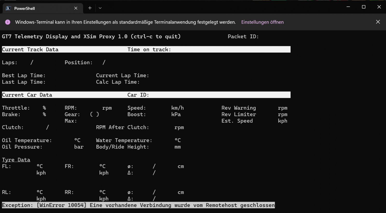

    I use Windows Terminal from Microsoft store. As said before, stop using ISE. Powershell version should have nothing to do with GT7Proxy, as it is written in python. From your screenshot, it looks like you are using an overlay on top of windows; that could be the issue too. As the console displays garbage, it means that telemetry is flowing. GT7Proxy.exe -h for CLI options if you want to make captures.

    nono I dont use any overlay on my win11 Computer, that thing at the top iss RocketDock only a lil dock extension and I use it since a decade and nothing bad with it :)
    edit:
    got it, Windows Terminal did the trick thanks alot for helping I have to go to work now but the 1st thing I do when I come home iss testing that out. Thanks Thanks Thanks, finally we made it :D

    Is the new release working in other terminal, where it failed before ? I'd like to know if the code I changed is working, or is the soltuion coming from using Terminal
  11. j0k3r
    j0k3r Member
    Jan 1, 2023
    41
    307Coins
    2DOF, Motion platform
    ...all is working fine now with that release on all cmd tools I got :D
