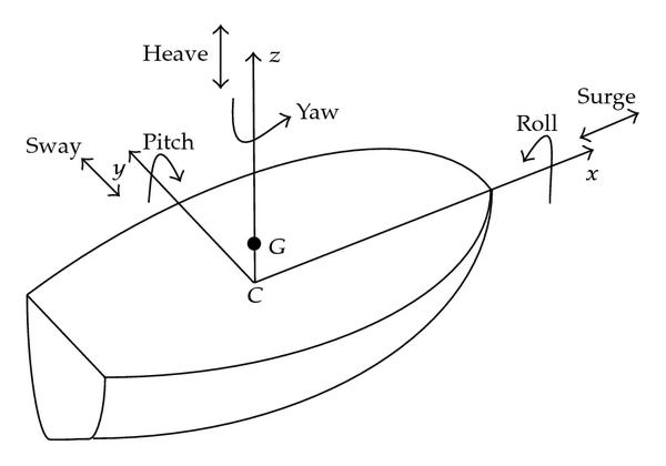

    Yaw is rotation around a central pivot point, TL pivots from somewhere around your feet they are 2 distinct and different motion effects.

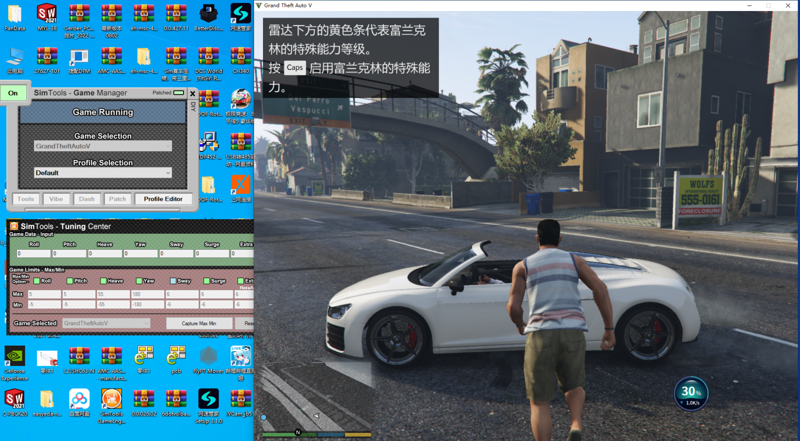

    I'm trying to get the plugin that came with Manual Transmission mod to work with the NLR v3. The buttkicker is working but the motion is not, even though the diagnostic tool shows data coming in on a bunch of different graphs. I don't know enough to make sense of all of them, but I would think it should be working. I tried FH4 just to make sure the motion platform was still communicating with Platform Manager in general, and it was indeed working.

    Brother, do you know why there was no feedback?

    it will only output data while you are in a vehicle, .. but there could certainly be other things going on. ... i am just going off your screenshot... you are not in a vehicle.

    I'm driving, but he hasn't given any feedback!

      1. Install scripthookv
      1. Install scripthookvdotnet
    I don't know if I have installed these two incorrectly. Can you share the file?
