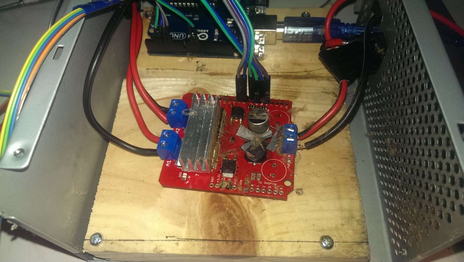

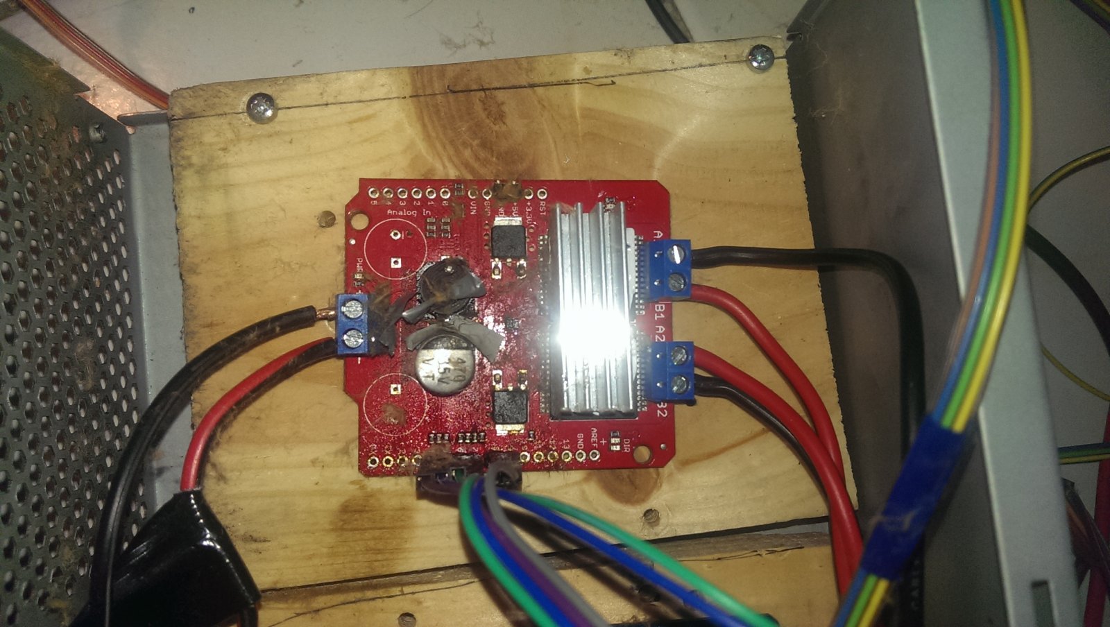

    So finaly managed to find out what was wrong.. some cabling issues!
    Anyway fixed that yesterday, so today after work I was "running" home like a little kid before christmas.
    Started putting together the box for the Arduino and the Monstermoto.
    Wanted to test is again before I tighten the screws.
    And then...
    A little advise for the less experienced like me!
    WHEN IT SAYS IN THE MONSTER MOTOR PWR + DAMN YOU DON'T ATTACH THE NEGATIVE SIDE THERE....
    I'am a dumb ass...
    So ordered the new Monstermoto..
    Arriving next week :think
    Yet another lesson from the book of patience :confused:
  10. eaorobbie
    20,491Coins
    +1,687 / 23 / -2
    OMG I feel for ya mate , made a simular error in a rush, can happen and will happen Murphy's Law.
    Need to always double check wiring after a change and then check again before throwing the power switch on.
    Hope it doesn't take long for the new one too turn up, and actually lucky it didn't take out the ARD and the usb port that's connected to it.

    @Greg83 gutting sorry for your bad news, but don't throw it away order a new capacitor very low cost and might still work;)

    @Greg83 - sorry for you mate, it happens, my PSU's capacitor exploded like that, it scared the sh*t out of me. When the smell reached me I've first thought it was my PC, but on my relief it wasn't, just that cheap chinese PSU I was using for sim :grin
    Well, now the more painful thing would be waiting for new parts :thumbs

    @eaorobbie :Thankfully the Arduino works, so I'am gratefull that I only managed to fry half of my setup. This was pure stupidity, I should have made a picture of the whole working cabling... Learned my lesson ;-)
    @Daguru :Thanks I will try this! Is there a specific capacitator that I need or just use the 470 35V VT written on it?

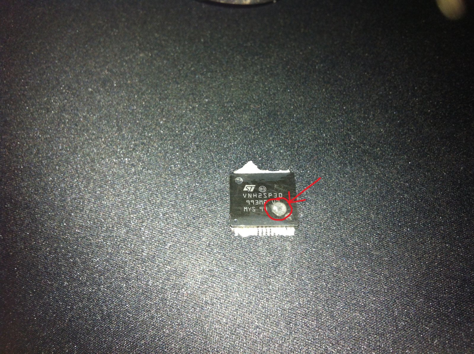

    @Greg83 yeah if you use the numbers off the cap to find a local replacement you maybe lucky;)
    I was, I burnt out the main VNH2SP30 got a new chip, replaced it and it worked:)
    I found that some monster moto shields the two chips are not flat with each other so 1 heat sink over the two chips didn't work the best (I have 3 monster motos 2 are flat one was not:( just a tiny step and the heat sink didn't sit right )
