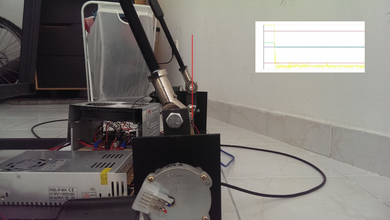

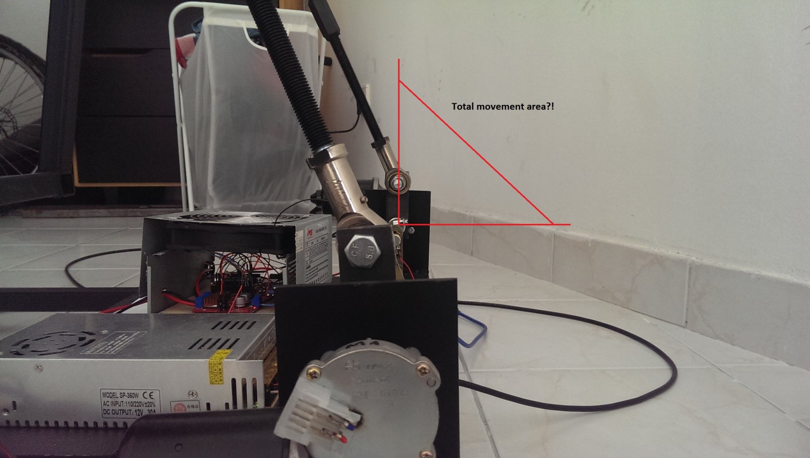

    Hey,
    I think it might have to do something with how I have setup SMC3 right?!
    I might have defined the parameters of the "work area" wrong while configuring the Pot and the default position?!
    Made a two video's so you can see a bit better:
    I will modify the axis % allocation, it was only for safety :) (tried learning from past mistakes!..)
    But then I should modify the Pot position so it would move more like this right?!:
    Thanks!
    Greg

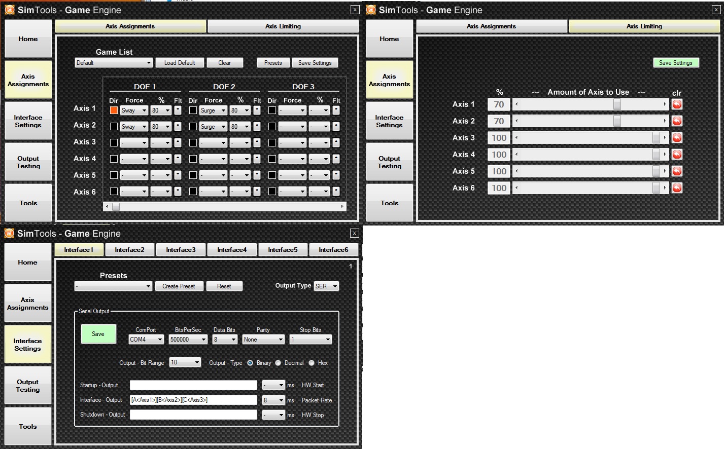

    Hey Gents,
    Soooo managed to make a video:
    My settings are:

    Try deleting the third axis of the output interface , let alone [A<Axis1>][B<Axis2>]
    :thumbs
    (sorry for my English)
    21,665
    151,644Coins
    +11,043 / 56 / -2
    Thanks for the video, here are some suggestions to try:
    Your Startup and Shutdown options are what affects how the sim behaves when turned on: http://www.xsimulator.net/community...and-windows-utilities.4957/page-33#post-83250
    It pays to download the guide to Arduinos and creating profiles: http://www.xsimulator.net/community/faq/guide-to-set-up-simtools-arduino-and-write-profiles.47/
    At 80% each the Axis Assignments % is too high, drop them back to 60% or lower: http://www.xsimulator.net/community/faq/axis-assignment-percentage-totals.120/
    Then you are limiting it too much with Axis Limiting. Personally if I need to limit something I do it in the Game Manager and you can create profiles there that are tweaked for certain cars/tracks via the Profile Editor.
    So try putting Axis Limiting to 100% and tweak the Tuning Center profile to get the best generic settings for different types of cars. For example I use the Cobra, Corvette and Williams FW31 in Assetto Corsa to sort the Tuning Center values. Then you can create specific profiles in the Game Manager for each of those cars and tweak the setting to get it spot on for that vehicle. It takes time but is well worth the effort.
    I agree with @Maxi17, there is no need for the C Axis.
    You have not posted Tuning Center screen shots but it pays to do a base run for them: http://www.xsimulator.net/community/faq/set-base-tuning-motion-values-in-the-tuning-center.122/
    For members it is much easier to give advise if the video shows the sim and on screen game at the same time.
  9. Pit
    3,012
    30,482Coins
    +3,097 / 31 / -0
    There's also a thing you should know: packet rate should be 10ms. For further help please follow the advice of @noorbeast "it is much easier to give advise if the video shows the sim and on screen game at the same time" and try the axis output instead of the dof output.

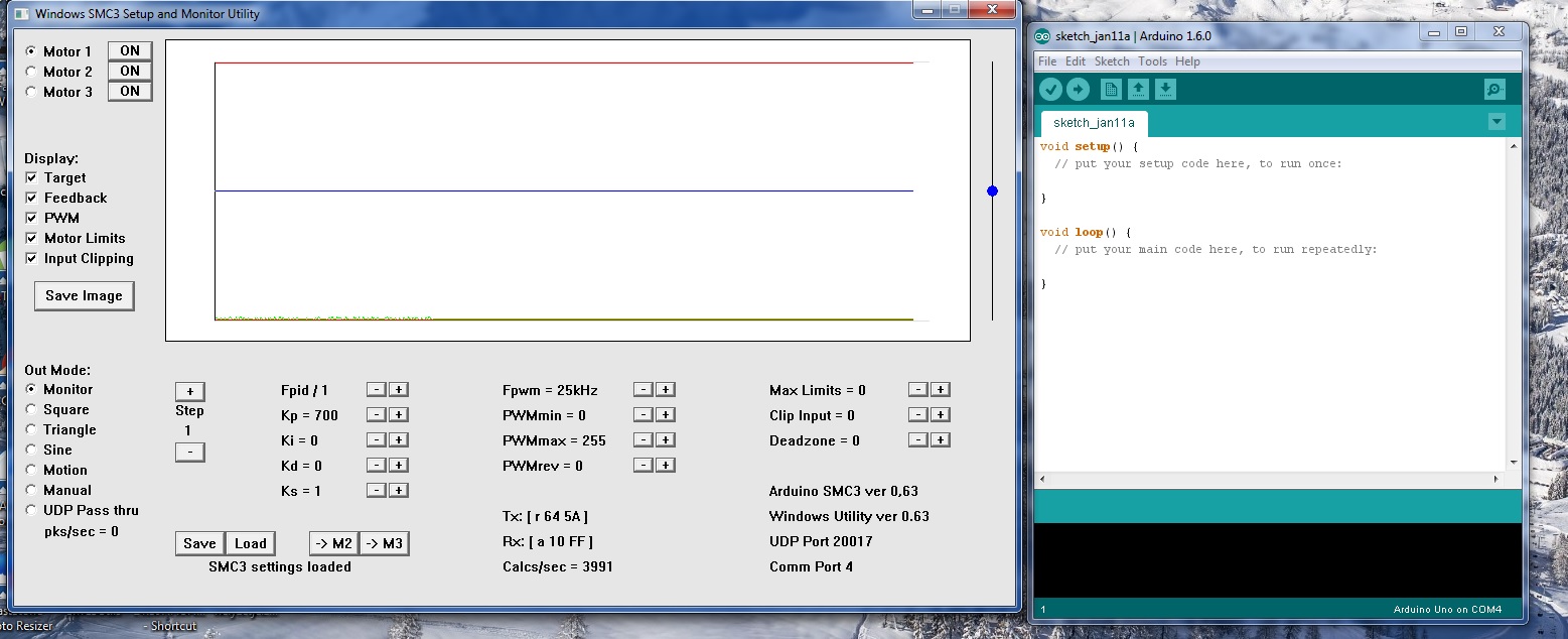

    Well its been long since I have touched my project, been a bit frustrated with it so thought today will be a good day to restart it.
    Last time I drove it atleast it was moving...
    Today hooked it up to the machine and this is what I see upon moving the motors manually (Wanted to check it before I run it actually)
    The green feedback line is going nowhere...
    I simply can't get it, if I don't touch something what happened?.....!%"'/"%!=/!
    The only UPGRADE I did it install a turn off switch for the main PWR line going into the MM so the rig wouldn't be online all the time...
    But even if I managet to kill my MM (highly doupt it) the Arduino should still display proper feedback line???!!
    Any one any idea?
  14. SeatTime
    2,573
    'Manual' not selected.
  15. Pit
    3,012
    30,482Coins
    +3,097 / 31 / -0
    Did you upload any sketch to the Arduino?!
  16. Greg83
    Greg83 Active Member
    Feb 2, 2015
    104
    IT Specialist
    Budapest, Hungary
    328Coins
    +46 / 0 / -0
    @SeatTime : Well that was not the case as the motor feedback line would have still moved I guess as selecting manual only moves the reference line manually.

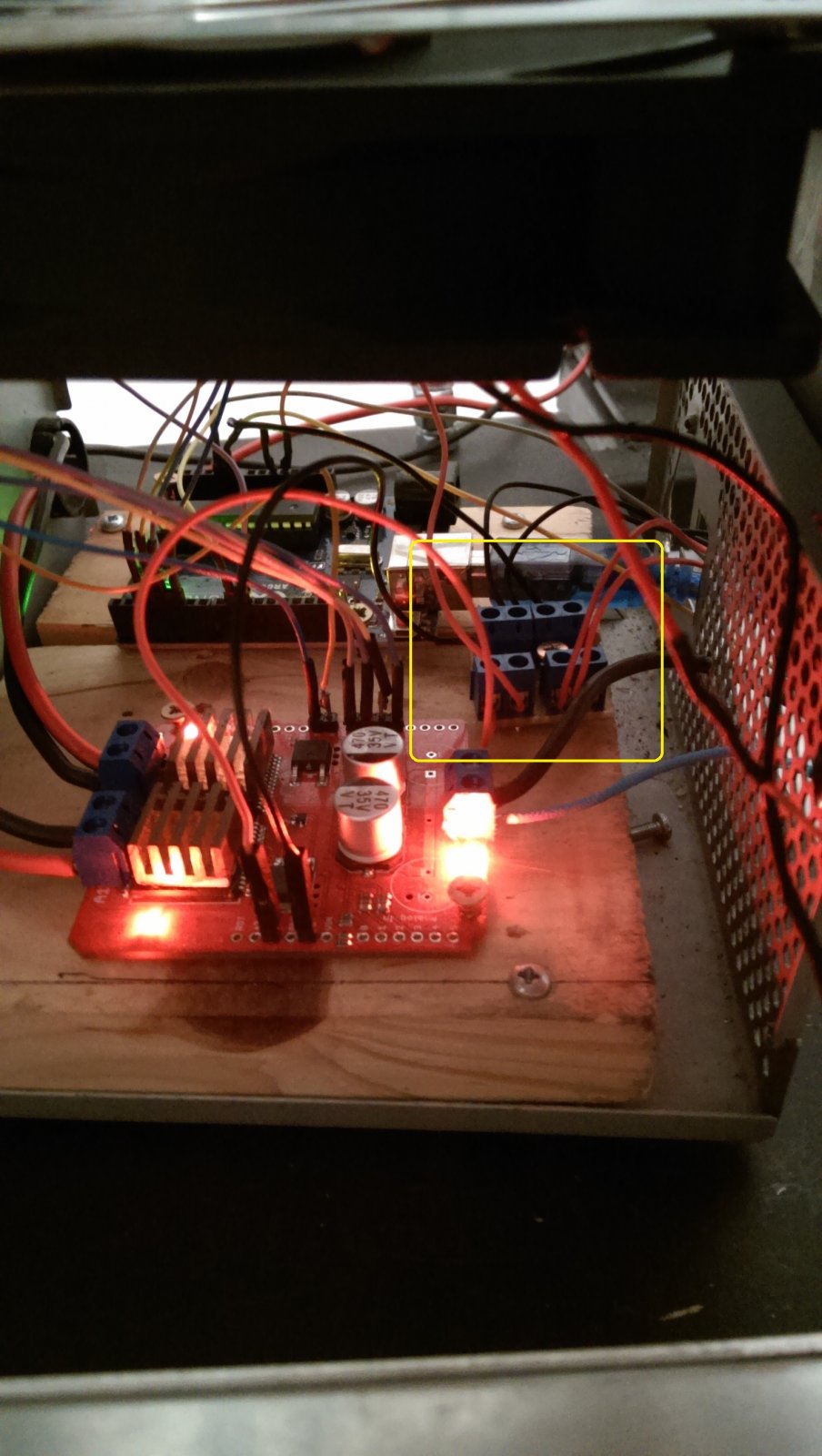

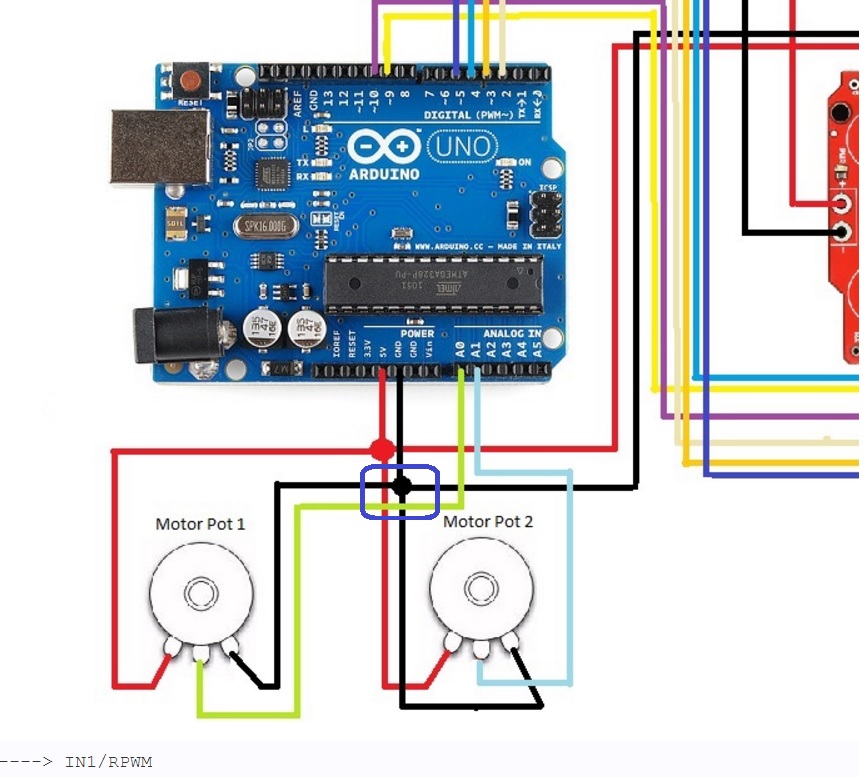

    @Pit : Eventually came to the same conclusion, but first checked Device manager, okay Arduino was visible. Code uploaded, but to be on the safe side uploaded it again. Still nothing... Hmmm.
    Okay wihtout ordering new things let start from step one of the wiring! Bingo... Don't know how but one of my wires from the connection part of the two motors was disconnected...
    Now it works again.
