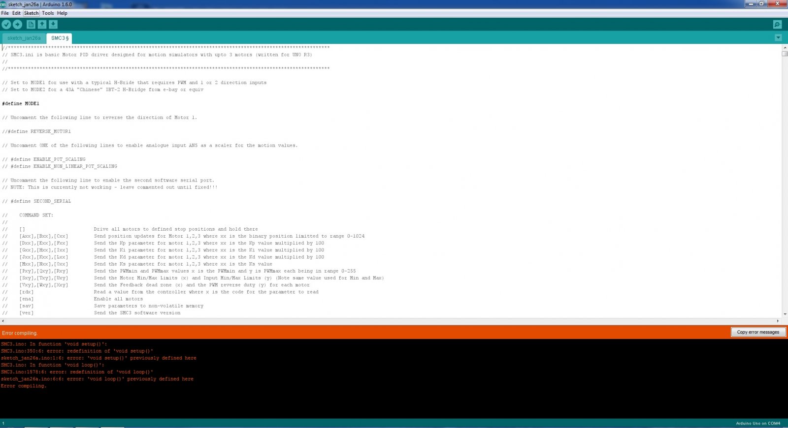

    Had an idea to try out SMC3 v0.6.zip or SMC3 v0.7.zip but upon compileing I get this:
    So can't try this either...
    I think this project might be doomed...

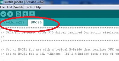

    don't know if this is the problem but my knowledge for arduino is limited. why do you have two sketches opened in the arduino program open only the SMC3.ino

    @insanegr : that was the default sketch, had to reinstall my Arduino program and that sorted it. Uploaded the SMC3 v 0.6 and made a small test video:

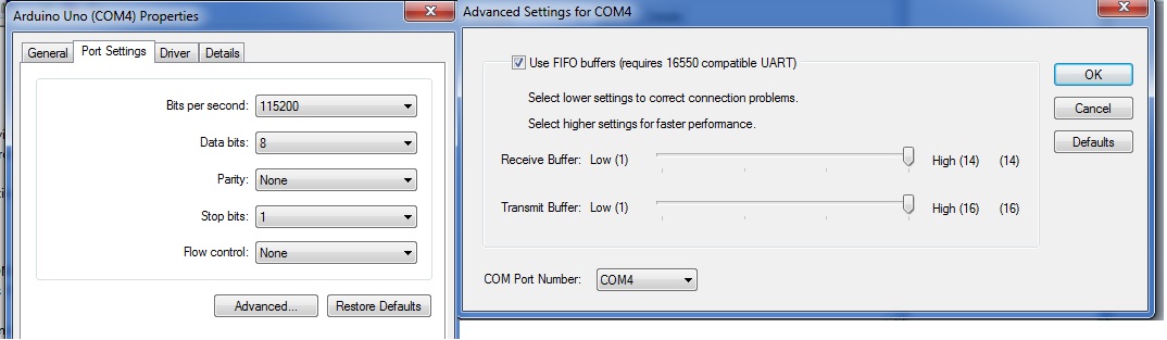

    Arduino Settings in device manager: Arduino settings.jpg
    @Blame73 : But the pot is moving as the motor changes position! And in SMC3 Utils it is fine nice and smooth! Shouldn't it be rugged in there too?

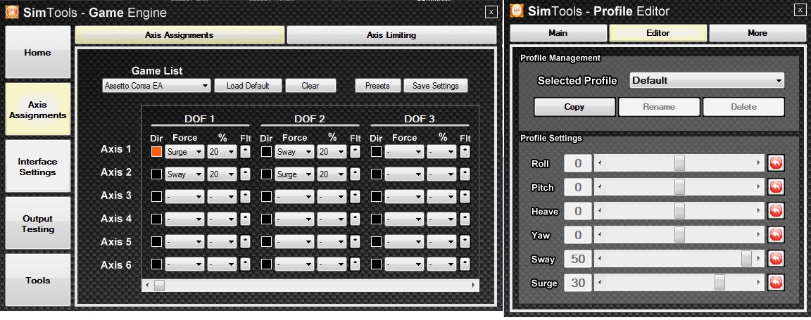

    @Greg83, here are my observations and assumptions:
    1. You post a screenshot of the device manager com port settings... This has no relevance for either SMC3Utils or Simtools, they automatically setup the com ports based on the in program settings so adjusting anything in device manager is a waste of time.
    2. You say everything is working well and tracking as required using Windows SMC3Utils... This means your hardware must be correctly assembled and wired and mechanically ok, with serial coms working to the arduino.
    3. This leads us to assume it is simply incorrect settings in simtools so focus there.
    4. As mentioned in an earlier post don't worry about start and end codes in the simtools interface settings (or if you do note that the center position is 512 not 128)
    5. I note in some of your earlier posts you had made changes in the simtools profile settings of the game manager... I would suggest keeping these in the default center position until you have the axis setups working properly. (*** my guess is this is your main problem ***) don't forget to check all game and default profiles.
    6. Also you show the settings for rFactor and Assetto corsa but the video is demonstrating manual output testing... you need to change/ensure the "default" axis assignments are correct for manual output testing.

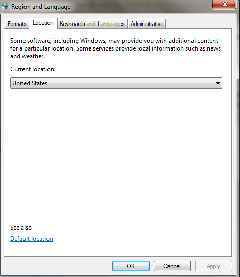

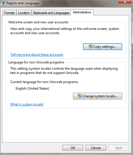

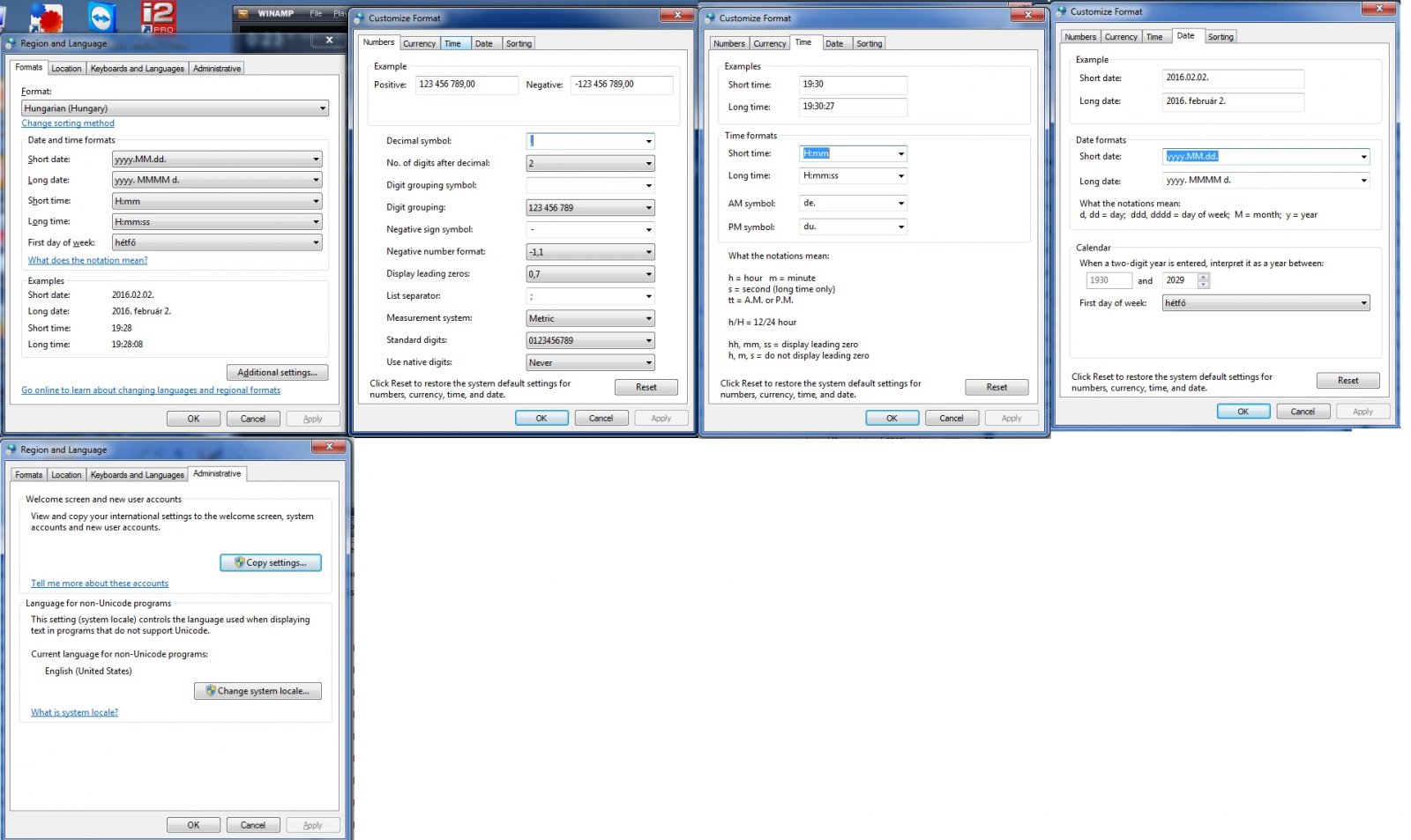

    Hey! Sorry left that out...:
    Windows language is English, but the regional settings are Hungarien.
    Does Simtools store any data anywhere else than the program folder?

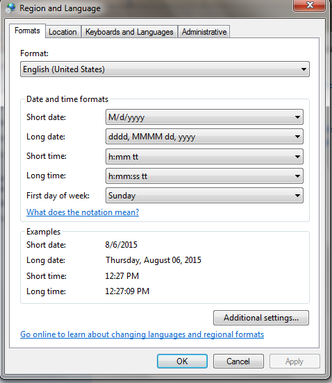

    In early versions of simtools... If your region number settings used a comma for the decimal place (as yours appears to) you would experience problems with simtools.
    I thought the current release of simtools had fixed the issue but perhaps not.
    I would definitely change your settings to use a full stop (.) for the decimal and see if it fixes your problem.
    [EDIT: It may also be the digit grouping symbol... Best to use EN settings to see if it solves the problem and then work back from there to see which setting is causing the issue.]

    @Greg83 do what rufusdufus said and 99.9% (with a dot not comma:grin) you will run with no problems
    EDIT: something like this

    GUYS,
    (@RufusDufus , @insanegr , @Pit , @noorbeast , @bruce stephen )
    That was it... Had to change the whole regional settings to the US and bamm, no more tilting to the left! Axis working fine. :grin:thumbs
    Now it is off to tune the whole thing.

    My current settings:
    This is version 6 I think.
    Sway was good in one setting where I had this exact same setting but the direction ticked in both sway boxes. But then Surge moved from left to right so that went to the trash bin :)
