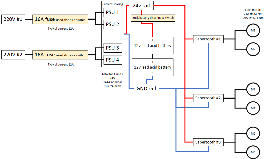

    @BlazinH, so did you use a battery in your setup with Sabertooth 2x60's? Do you happen to have a scheme of your connections?
    Even if I am not putting any emergency cut-off between battery and Sabertooths, I still need some manual switch to disconnect the battery when the rig is turned off. One option would be to just remove the wire from the battery, but there definitely should be a cleaner solution.

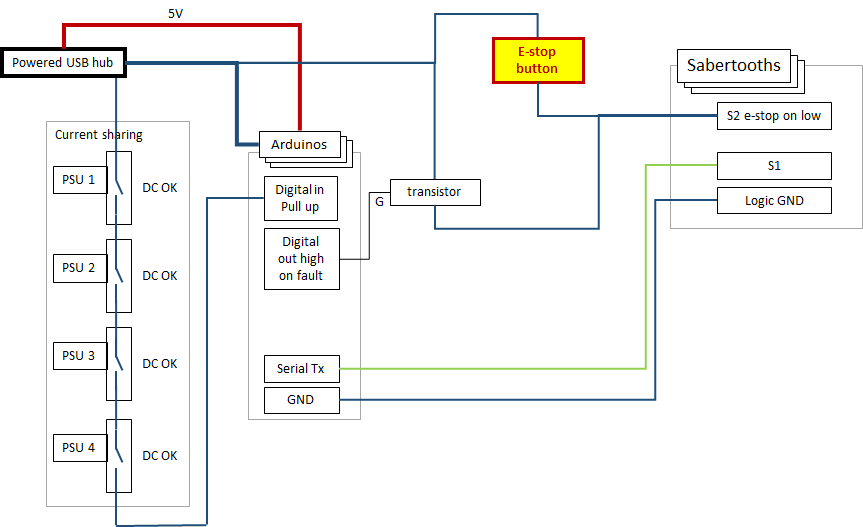

    Ok, so this seems to be the "final" layout:
    Emergency stop will be as follows, together with Arduinos monitoring PSU status through DC OK contacts and pulling S2's low by opening a transistor to ground:

    I used a battery but I don't have a scheme to show you. But its like you posted less the fusses and the disconnect switch. And I just leave my battery connected directly to my sabertooths all the time now. It’s not really any different than leaving your television or a clock plugged in all the time. I had been using a somewhat large knife switch to cutoff battery power for a while, but even its contacts got weak after a while and didn’t always pass the full current.
    Just be sure you use the DE recommended wire sizes for your motors size and solder up the ends of the wires if your using stranded cable before you put it in the 2x60 to be clamped down and you shouldn’t have any problems. Also, I minor flaw in the 2x60’s that can cause some major excitement unless they have fixed it by now is that the aluminum heat sink is immediately behind where you insert the wires into the clamp screws. If you push any of the power or motor wires in a little to far, they will touch the heat sink. Getting a couple like this can cause some major fireworks.:eek:

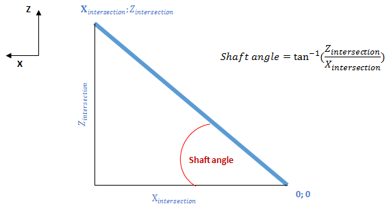

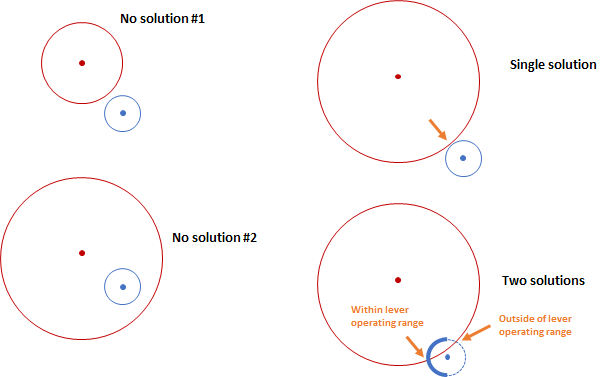

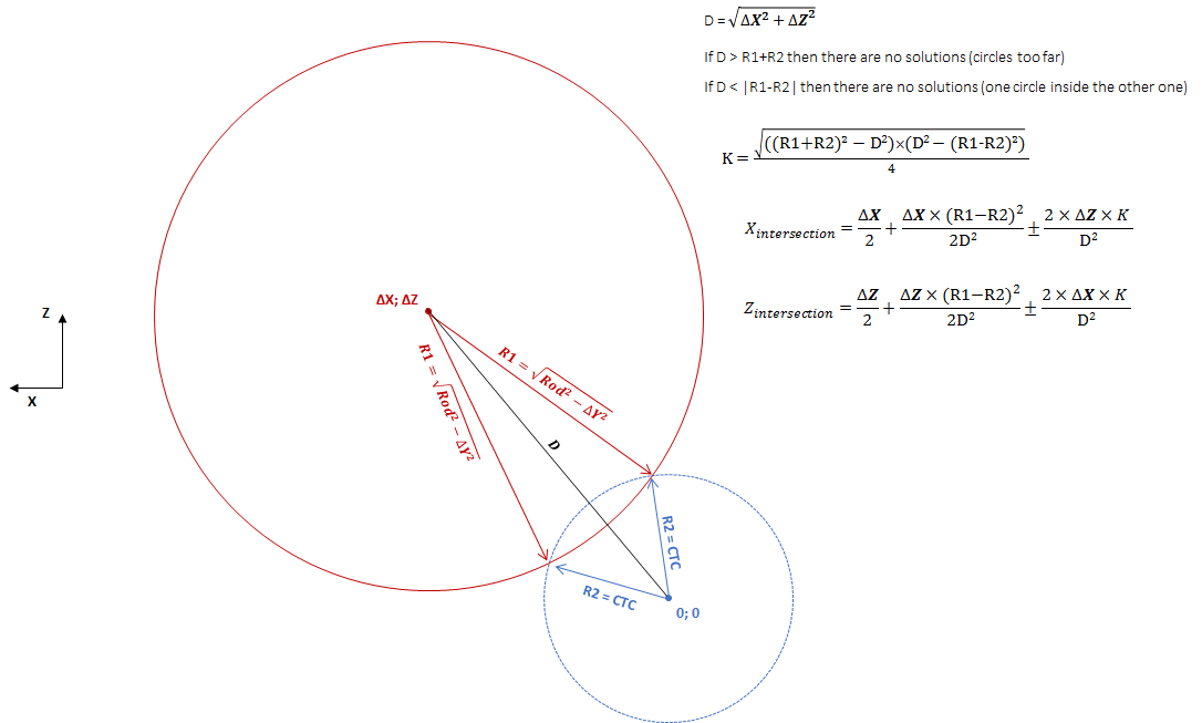

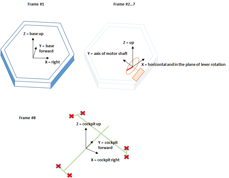

    @BlazinH, I think the algorithm for 6DOF calculation can be like this:
    1) define eight coordinate frames:
    #1: Global" with center somewhere in the middle of the base
    #2-7: six frames for each of the motors, so that up direction is parallel to global up and X plane is the plane of lever rotation, each of these frames should be defined by rotation and translation in the global frame #1
    #8: frame of the moving cockpit
    2) set coordinates of points where rods are connected to the cockpit -- in cockpit coordinates, i.e. Frame #8
    3) when position of the moving cockpit in the global frame is known (X = sway, Y = surge, Z = heave, roll = rotation around global Y-axis, pitch = rotation around global X-axis, yaw = rotation around global Z-axis), resulting coordinates of each rod attachment point can be converted to corresponding motor frame by successive application of transformation matrices: first converting to the global frame and then to the frame of motor.
    4) Now cooridinates of corresponding rod attachment point are presented as dX, dY, dZ and attachment of the lever to shaft is at 0;0;0
    5) rod length is fixed and the rod goes between rod attachment point and the end of the lever. If we draw a circle showing possible positions of the lever end and another circle showing possible trajectory of the rod end in the lever rotation plane, then required lever-end position for the current coordinate of the rod-attachment point will be one of the one or two intersections between the circles:
    The cases here may be like this:
    Coordinate(s) of intersections can be found like this:
    Then, the required shaft angle for this motor will be:
    There may be an error somewhere here of course, but it now looks to me like it should work.

    That’s helpful information assuming it’s correct but still leaves me with too much work to do to transform it into lines of Visual Basic code. If you could tell me step by step and in order the individual math functions that need to be performed to transform Simtools telemetry into the shaft angles given a set of rig perimeters, then I could certainly build an interface to input a rigs perimeters, take the inputs from Simtools, and send out each motors transformed position data over serial or a network to a controller or another program for further processing. And if you can also show how to do the math in order to adjust the center of gravity, I can add that to the interface too. :p
    Ps I wouldn't need every math function stated individually if you can show multiples it in a bracketed form.

    I have not yet looked into the format of what comes from SimTools. Am I right in assuming it gives six figures?
    1) sway = position left/right
    2) surge = position fwd/back
    3) heave = vertical position
    4) roll = rotation forward-looking axis
    5) pitch = rotation around left-right looking axis
    6) yaw = rotation around vertical axis
    The question is what is the reference frame here. If the cockpit is turned to some yaw angle then the cockpit's left-right axis will also turn relative to the base. If pitch is commanded by SimTools, where should the cockpit rotate, what would be the effect of adding pitch: should the cockpit ignore yaw and just raise/lower driver's legs or should it take yaw into account and lower/raise whatever part faces forward of the base?

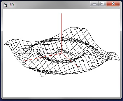

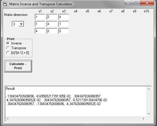

    I found this and its source code. Is this what I need?
  14. BlazinH
    BlazinH Well-Known Member
    Oct 19, 2013
    2,145
    Oklahoma City, USA
    16,701Coins
    +1,840 / 32 / -1
    Yes. And you can adjust the output type and bits used.

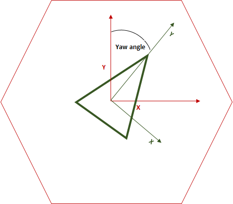

    Just to make sure there is no misunderstanding. I am wondering how SimTools expects the rig to handle this situation:
    If the cockpit is rotated by a certain Yaw angle, then its own coordinate system (dark green) will be rotated with respect to the coordinate system of the base (red). If now SimTools tells us to pitch forward, should we rotate cockpit around green X-axis or red X-axis?

    I believe the base and the vehicle yaw together unless the vehicle is in a traction loss condition in which case the vehicle will no longer be perfectly aligned with the base.
