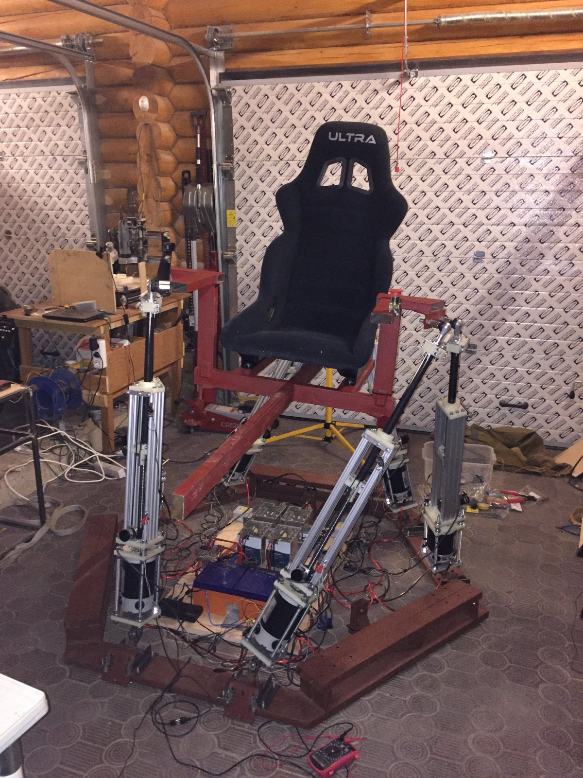

    Oh, this thing is NOISY!
    I disassembled the nut, double checked that all the bearings are in place and added some extra lubrication -- it became a little bit less rumbling and started to move a bit smoother, but still nowhere close to the quietness of gearboxes :(
    Some sort of noise insulation would be needed, I guess

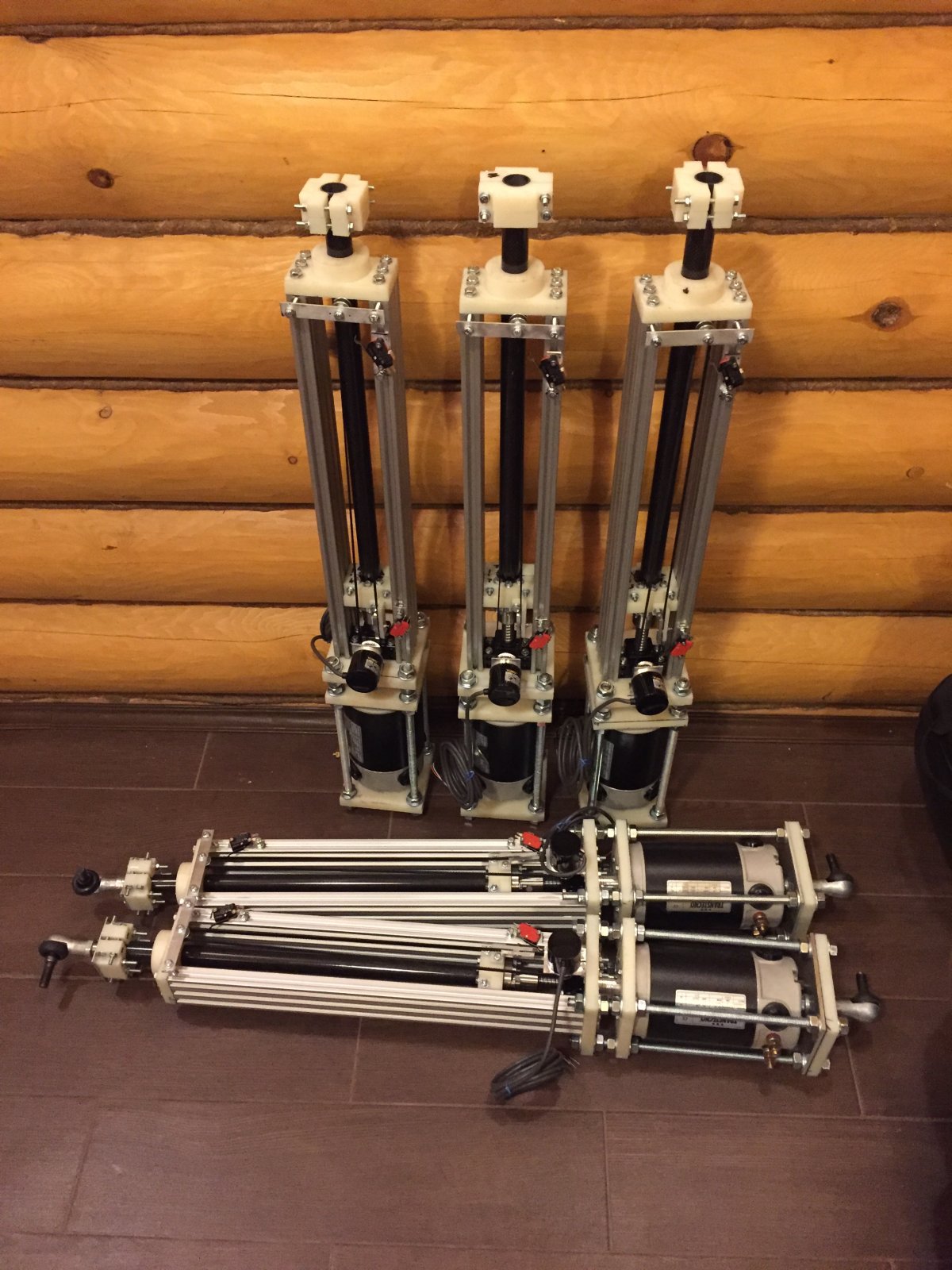

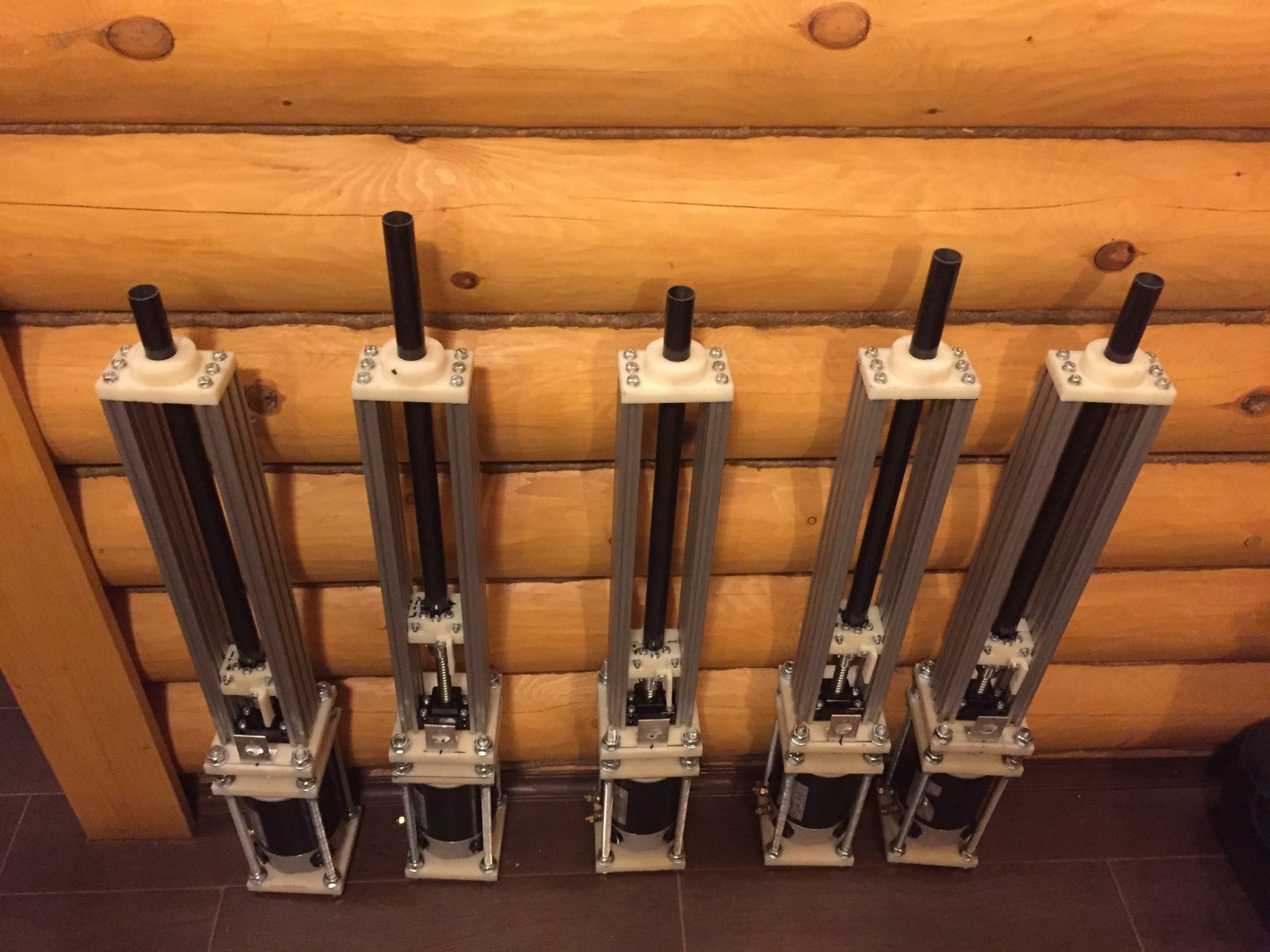

    Things are moving quite slowly, as I can only work on the build on weekends. it took me almost a month to get five more actuators mostly ready. I still need to fit encoders, timing belts and end switches, but this should not take more than one day.
    Here's how everything looks now:

    One more Saturday and a bit more progress.
    The next step will be wiring everything and, finally, installing the actuators.

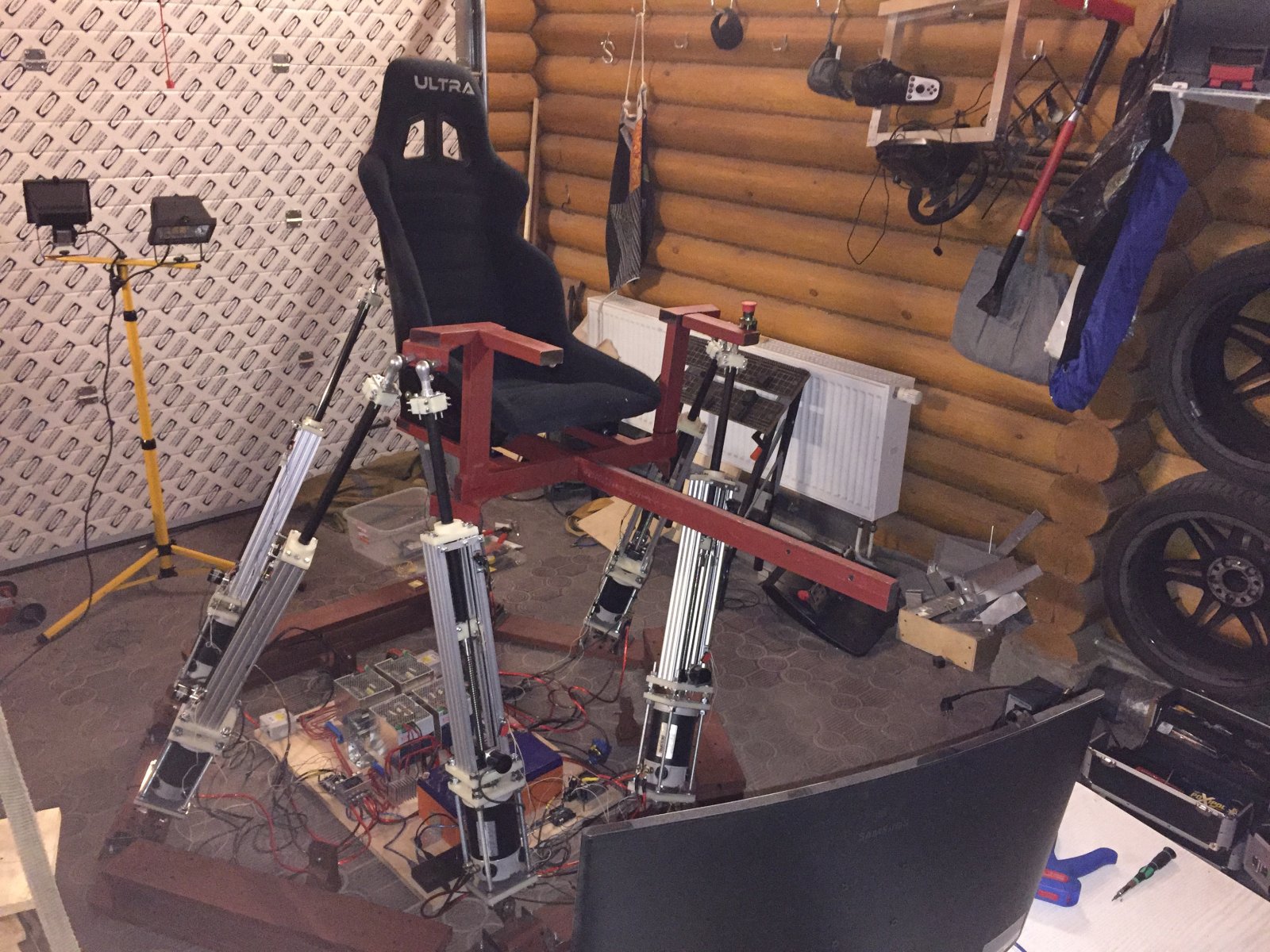

    I finally attached all the acutators to the rig.
    I was hoping to start testing it with Simtools during the New Year break, but, as often happens, the plans did not quite materialize.
    Five out of six actuators passed Kangaroo auto-tune routine, but one keeps reporting that it hit a limit switch during tune process -- without actually being anywhere near it! Soldering and re-soldering wire connectors, changing wires, swapping Kangaroos, swapping Sabertooths did not help, so I hope the issue is with my cheap Chinese limit switches themselves. They work fine on a static rig, but maybe they occasionally close when actuator moves and vibrates?
    I will get some replacement switches and test them next weekend.

    It's alive! A lot of movement profile tuning is of course needed, but at least it finally works.
    Over this weekend I managed to complete auto-tune for all six actuators and successfully paired the rig with Simtools. Sabertooth and kangaroo combo seems to be working well so far.

    It definitely feels much more solid and precise: no backlash at all.
    The settings are all wrong as I had very little time this weekend and was anxious to try it. Indeed, I set up surge as just a flat forward-back movement. I thought that Simtools will combine surge and pitch to simulate acceleration and braking, but apparently I need to change axis allocation so that surge not only moves the seat back and forth, but also tilts it. Is that how it should work?
