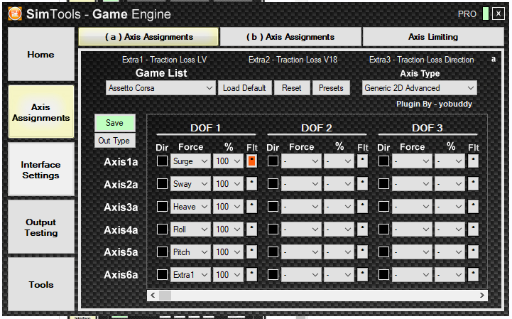

    Can you tell me where I can individually adjust the axes in VB.net?
    When I move in simtools axis1a all motors start to rotate. I am currently using engine 2,3 and 5 because I want to test with 3 engines first. Actually, simtool must control what the maximum result is and not VB.net. Can I change settings somewhere so that engine 2,3 and 5 do exactly what simtools asks for instead of a formula in VB.net that connects all engines to each other. so I set the limits in simtools and preferably not in VB.net.
    I'd love to hear from you.
    Greetings Eric.

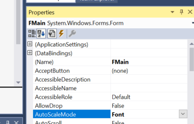

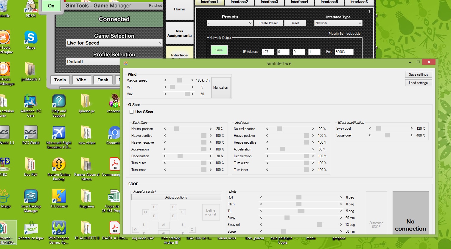

  17. Tuyisenge
    Tuyisenge New Member
    Feb 5, 2019
    40Coins
    6DOF:
    57719
    57720
    Hi Grigory,
    thank you for sharing your application "Siminterface vb", this site becomes very interesting thanks to people like you.
    I'm trying to use your code and app Siminterface does not display the complete page, it stops at 6DOF just down the "Surge" so I can not access the settings that follow it as (Surge picth, heavy max, heavy min and All Dn Adjust positions) as you see in the attached picture.
    I use Windows 8! do you have any idea where this problem is coming from?
    besides that, i really appreciate your work using arduino on AC servo drives, it seems impossible to me before seeing your project.
      File size:
      345.3 KB
      Views:
      782
  18. Grigory
    Grigory Active Member Gold Contributor
    Jul 6, 2016
    202
    Moscow
    224Coins
    +305 / 1 / -0
    3DOF, 6DOF
    I think this is because of the difference in font scaling that you and I have on our computers.
    You can try changing this setting in the form's properties in VB:
