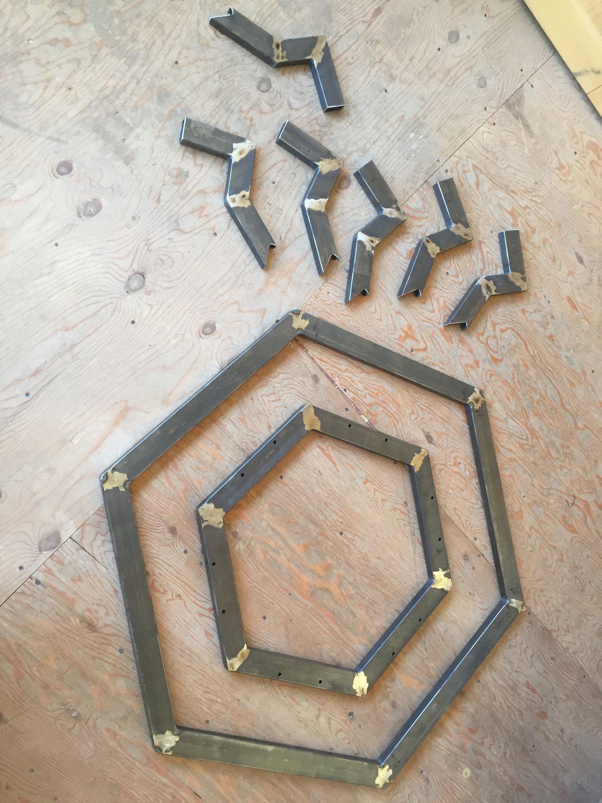

  14. duckdown
    duckdown New Member
    Jan 25, 2020
    19
    136Coins
    +19 / 0 / -0
    Here is my current take on the bottom platform. The picture is a bit busy as I am new to this CAD stuff.
    You can change your inscribing circle diameter to suit your playspace. You can then create an upper platform with it's own diameter and use that to get an idea of the angles that your rig can theoretically attain.
