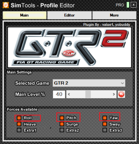

    @value1 , only a question.
    I see the plugin provide data only for sway, surge and heave (as you wrote somewhere in the post; remember having read it ...), but in the Profile Editor I olso see Pitch, Roll and yaw. I think it's only a mistake on the image in the Profile Editor?!?

    I believe, pitch, roll and yaw are provided int data structure but remain just stay "0"

    Thanks for the reply!
    It was just a curiosity'.
    I thought that what was displayed on Profile Editor was something predefined and not "read" from the "data structure"! :thumbs
