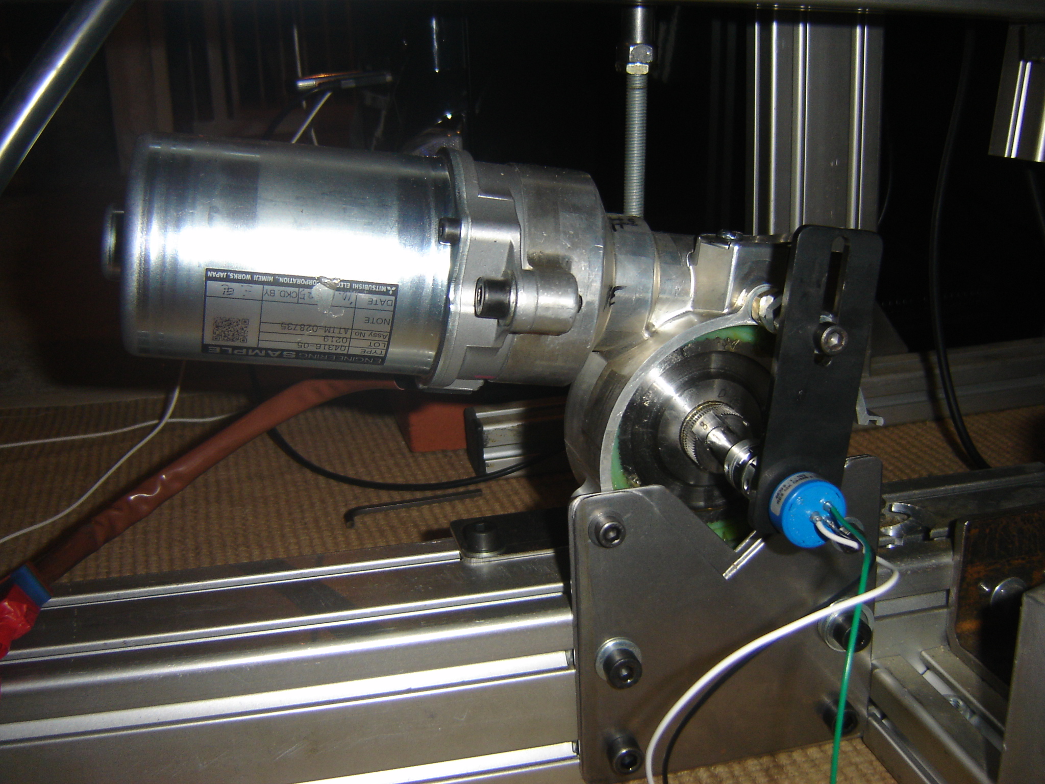

    I try "tune mode" on live test from DEScribe SW, but nothing happens. I have no feedback. However I measure some electrics values between the right pin of the pots.

  4. Niko77
    Niko77 Member
    Jul 8, 2011
    35
    343Coins
    3DOF, DC motor
    I use it with Sabertooth 2x12.

    Right! Some older syrens have fireware issues. I assume you have positive on one side and negative on the other side of your pot with the middle going to the kangaroos input. Also, the leaflet sent with the kangaroo I received shows the motor controller's dip switches set in the opposite positions. 1 & 2 should be set to off and all the others set to on. Let me know if this gets you going.
    Edit: You must also have your pot physically connected to the motors output shaft or somewhere else so the pots shaft will turn with it.

    My pots are connected to the motors.
    For the DIP setting of the Sabertooth i have this: 1 off ;2 off;3 on; 4 off;5 on;6 on

    The electrical or mechanical connection? I'm not able to move the motor. nothing happens when i turn the power on of the Sabertooth. I move manually the shaft of the motor.
    Edit:
    i use Bourns pots réf: 6639S-1-103 http://www.farnell.com/datasheets/1718055.pdf
    pin 1,2,3 of the pots are connected to:
    1=B
    2=A
    3=5v

    Your sabertooth is set to address 129. It should be 128. Please try setting them as I said above and let me know what you get.
    1 off ;2 off;3 on; 4 on;5 on;6 on

    Ok it's was my mistake, address is 128 (DIP 4 to off).( i've not reading carefully the Sabertooth document)
    Now the motors moves!!!! Thank you very much @BlazinH and @telfel.
