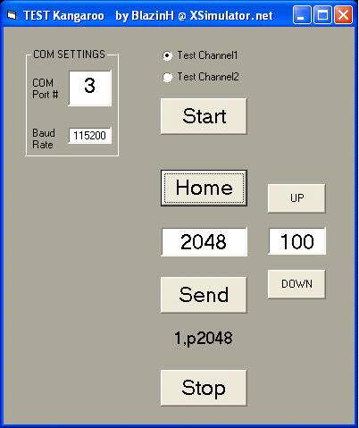

    Hi @jsmith2307 , Well, the good news is it sounds like you have managed to get a tune at only 30 degrees rotation! Before you worry about trying to use it with SimTools though, I have attached a simple program for you (and any member here) to use to test the kangaroo with first.
    All you need to do is input the COM port # in the box that you will be using and change the baud rate if it is different than 115200 (manually type in a different one). Then choose the channel you want to test with the option box and press “Start”. You can then use “Home” the send your motor to its center position. Then use “UP/DOWN” to change the position you want to call and press “Send” and the motor should move to that position. You can also manually type in a position in the position box and press “Send”. If you wish to change the rate used by “UP/DOWN” just enter what you want to use in the box between the buttons. You can start both channels to test them at the same time if you wish and then use the option box to switch between the two when testing. You must first press "Start" one time for each channel to activate both. Pressing stop will stop both channels regardless if both were started or not.
    If you don’t already have a program that uses Visual Basic 6 on your computer you will probably need to download and install the runtime files from Microsoft at the link below.
    http://support.microsoft.com/kb/192461
    Let me know how it goes and Good Luck! Btw there isn’t any error handing routines in the code so if you don’t input a working COM port # or some other error occurs the program will crash. But all you need to do it restart it and try again!
    ps You won't be able to use the full position range of 4095 (12bit) because you don't use all of your pots range (unless you use the voltage fix I posted elsewhere). Therefore, the maximum range you can use will be a percentage equal to the pots ranges you are using.

  13. jsmith2307

    Greetings,
    Thank you for responding. I downloaded the program and will comply with the directions given. Thank you, again!!

    Greetings,
    I guess I had beter check my hook-up to the kangaroo, I behaves like it did previously, a brief spasam and then nothing. I better check the wireing from the delink to the Kangaroo x2. The dip switch on the Kangaroo remains like it was when I tuned it in Descibe.

    @jsmith2307 I got an email notification today saying you were having problems with mscomm.ocx but now it is not here! Are you still having problems or not? Where is the message you posted? If you deleted the post please don't delete messages already posted because now I'm confused as to what the hell is going on! Just let me know you fixed the problem yourself instead of deleting a previous post if that's what happened please. I also need to know if there is something that I need to fix in case someone else wants to use it too. Thank You.
    Edit:I sound mad here. Sorry didn’t mean it that way! I have used my programs for personal use up to now. I always have visual studio 6 on my computers so it always works for me. I should have made an installer to be sure you had all the files that are needed but didn’t think necessary here. Did you just have to restart your computer for it to work or did you install something else from the internet? Thanks

    Also jsmith2307 , Did you try DEScribe's Live Test after tuning? If so did it control the motor(s) properly? If they worked with live test then they should work with my test program too!

    Greetings,
    Sorry, I deleted part of the the message. I did not think anyone had read the post!! My mistake!!
    I had another program and lifted " mscomm.ocx" from that!! The program works fine!!! But my simulator does not respond. I'll try Describe.

    Greetings,
    Movement! I 've got movement! First I had to go back to square one. I checked my wiring, after a satisfactory retuning in DEScribe, It worked!! Now the bad news. In the “Y” axis (only tested in "Y") the upward travel was much less than I had hoped for and the downward travel was more that expected. My settings on your program was SER, 12 Bits, baud rate @ 115200, mid point 2048, upward movement was max 2248 my downward max movement of 1648. Then I checked out Fight Simulator 2004. As stated the plane could barely get off the ground, but good braking and a good ground run, just could not get the plane to take off.
    Also, I was wondering, how does one hook-up multiple axis "Y" & "X" on a single Delink, or are two Delinks in order?

    Fantastic to hear you have had success @jsmith2307 ! :thumbs I think you’re kangaroo is operating normally and it is your tune that again is at fault with the movement you have. Use my program and start and press home on a motor to center it. Use a voltmeter to check what the output voltage on its feedback pot is at this time. It should be 2.5 volts because 2.5 volts always equals center position. Therefore, when you start your tuning next time, if you want the up and down movement from center position to be equal, then your pots tuning limits must be equally up from 2.5 volts and equally down from 2.5 volts. Then make sure your pot is right at 2.5 volts again before you start tuning. This should make your up and down movements equal.
    To control both x and y motors from one delink and simtools you simply send 1,p<Axis> for motor one to respond or 2,p<Axis> for motor two to respond.
