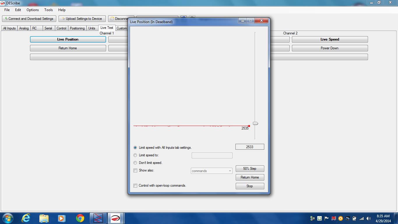

    "The only thing I can suggest right now is to experiment with different update rates out of simtools and see if it makes any difference. Try 20, 30 ms or more. I assume you did a new tune as I suggested? And does your rig follow good when you use DEScribe's livetest?"
    I retuned, and I test out using startup 5ms, interface 20ms - 50ms, shutdown 5ms.
    Is this what I should be seeing, I thought it should be more in the middle of the scale! deadband.jpg
    jsmith2307

    @jsmith2307 You provided little information to assist you! What you did provide I don’t understand. Simtools output has nothing to do with DEScribe software. And I don’t know what you should be seeing because you provided no reference information for me to determine what I should be seeing! But I can say your motor should be at center position @ 2048 units. But forget Simtools for now and get you’re motors working with live test correctly first. The slider to the right of the graph allows you to control the motors position so when you move it up and down, your motor should follow. I suggest more time reading up on how to use DEScribe software and/or on the phone with Charleen @ DE to get motors working with their software first before you attempt using them with Simtools again. If you can’t control your motors with DEScribe and my test program, you will never get control of them with Simtools!
    btw 2048 units = 2.5 volts at the pot output. I also edited above where I had the wrong figures posted.
    ps One difference between my program and DEScribe is mine uses the "simple serial" method of transmission where DEScribe uses "packet serial". The code for Simtools uses simple. If one method works the other should also but testing with my program after DEScribe assures this.

    I apologize for the lack of information. What I was trying to show was the DEScribe LIVE TEST that you mentioned in the previous exchange
    “I assume you did a new tune as I suggested? And does your rig follow good when you use
    I did do a retune, and I needed to know if you knew, or any others knew, where the point on live test graph was supposed to be (lower, middle, or higher). I assumed it to be in the middle, since the POT is centered @ 2.5.

    I believe the graphing function in DEScribe live test is dependent on what the “units” are set at. In Simtools we set the units to 4095 = 5000 meaning 4095 possible positions for 5000 max millivolts thru the pot with 2048 being the center. If units are not set in DEScribe under the “units” tab, I believe the default ratio is one to one. Therefore, 5000 positions for 5000 millivolts and 2500 would be the center. DE hopefully will clairify this when you speak to them.

    Greetings BlazinH,
    Success!! After playing around with DEScirbe, and your program, I got proper movement on the “Y” axis (pitch). Now I have to test the “X” axis (roll or bank)…. I just received the second Delink and have to link the two of them up to work on DEScirbe & Simtools 1.2.

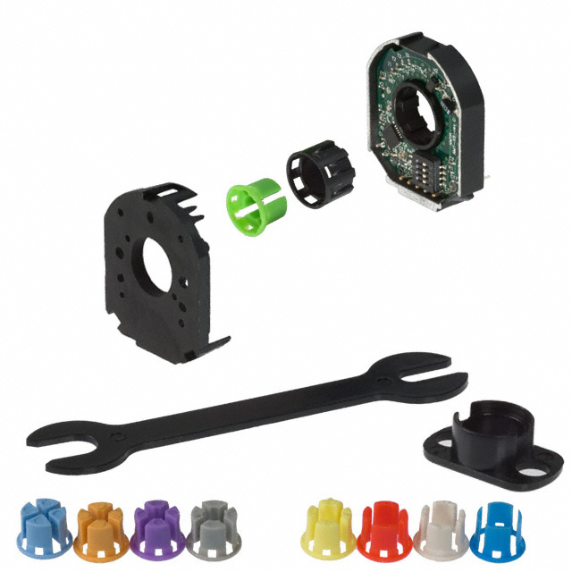

    Hi
    Modifying a couple of my motors the accept these encoders AMT 103 kit
    less than £16.00 each + £3.00 for connecting cable
    dip switches for setting pulse counts, adapters to fit various diameter shafts, alignment tools for installation.
    regards Terry
  12. Historiker
    2,163
    9,212Coins
    +2,179 / 19 / -1
    Hey Terry, could you start a new thread and show how those encoders would be able to replace a potentiometer? I would be very interested in learning more about them. I did read the spec sheet but most of it is over my head ;)
    Great find and thanks for sharing!
