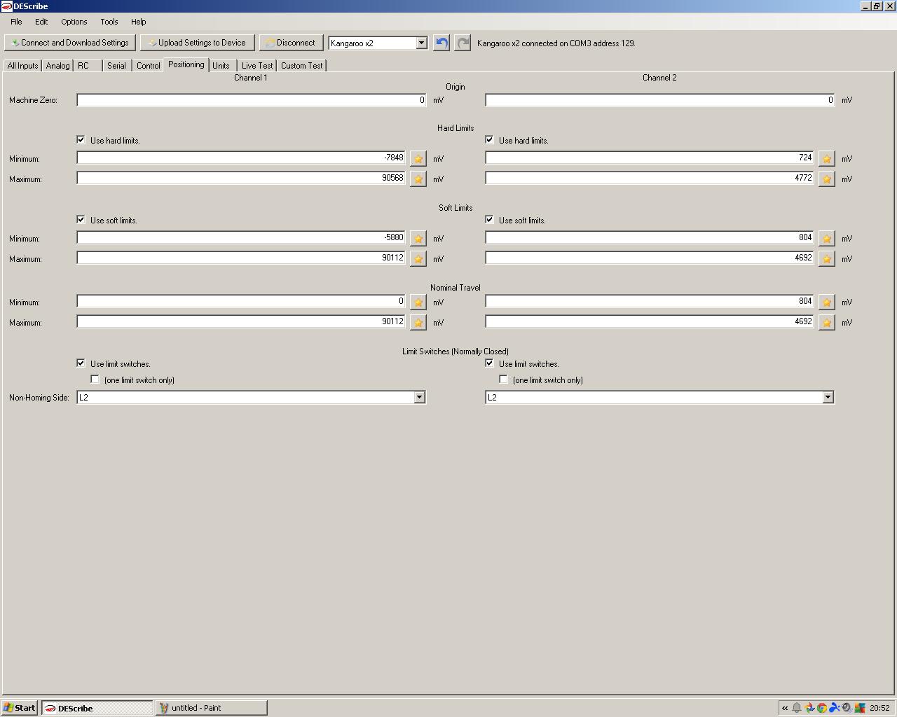

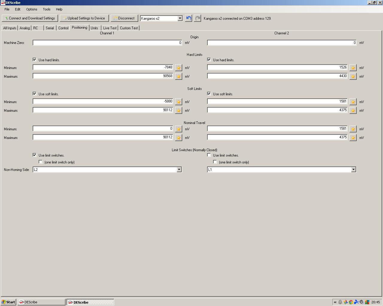

    Ran a couple of auto tune tests
    auto tune with limits 180" pot on output shaft approx 160" to 170" rotation channel 2 (ignore ch1)
    using live position test, center @ 2.7v
    auto tune with teach distance same motor, feedback pot, had to disconnect limits, used slider to give approx 90" rotation channel 2 (ignore ch1), using live position test, center @ 2.8v
    regards Terry

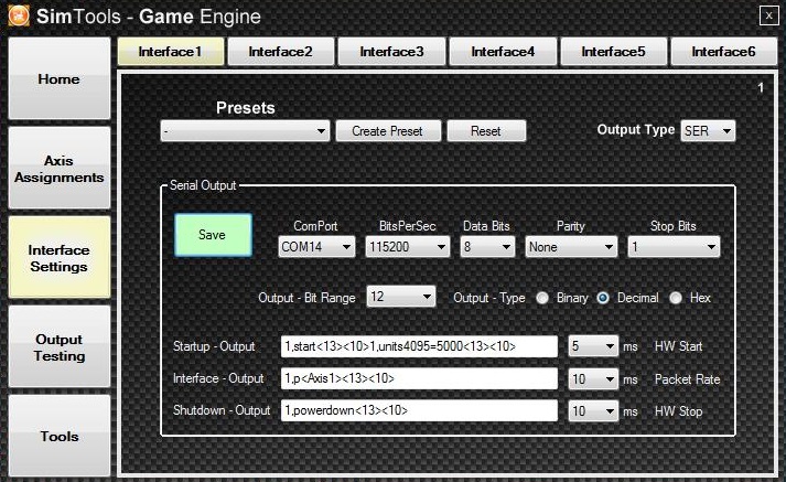

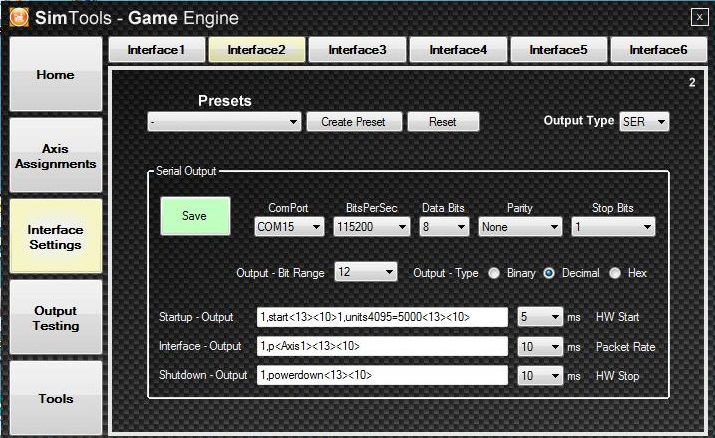

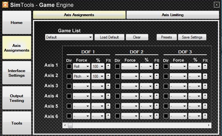

    Greetings BlazinH!
    (see the pic.)
    Then in simtools you will have to set up each kangaroo on its own serial interface and use 1,p<Axis> for the output on each one.
    ........I think this is what you were talking about startup, interface, and shutdown... the only thing difference would be the designation: COM 14 & COM 15 ???

    That's correct except for assigning the correct Axis on each interface as well.

  7. jsmith2307

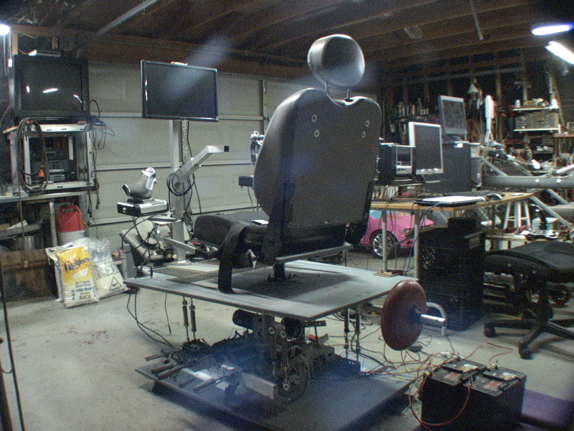

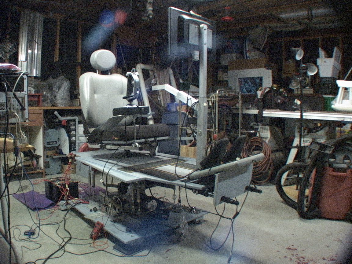

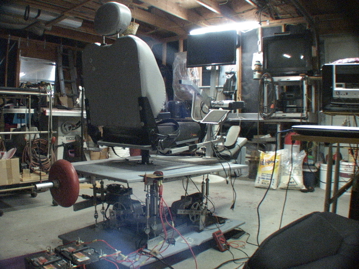

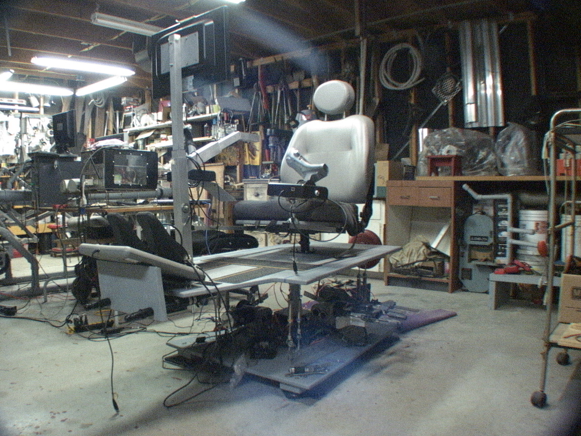

    Greetings @RacingMat and @BlazinH,
    I took the summer off, so give me a little time. I had to relearn and reapply a lot of things. I'm building a Platform Sim, a little less footprint from my joyrider and easier to get into and out of. A two axis simulator, Roll (1 motor) & Pitch (1 motor). the footprint was developed from Floreskies Sim (sic). see pics. sim 1.JPG sim2.JPG
    @BlazinH,
    "That's correct except for assigning the correct Axis on each interface as well."
    I'm sorry for being so dense.....please explain.
    jsmith2307
  8. eaorobbie
    20,506Coins
    +1,687 / 23 / -2
    Looks good mate, like the rework, good idea on the counter weight , keeps everything balanced.
    Might answer your Question , Axis1 is Interface1 and Axis2 is Interface2 , look to me you have set Axis 1 to both Interfaces.

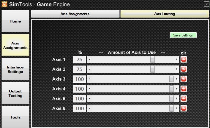

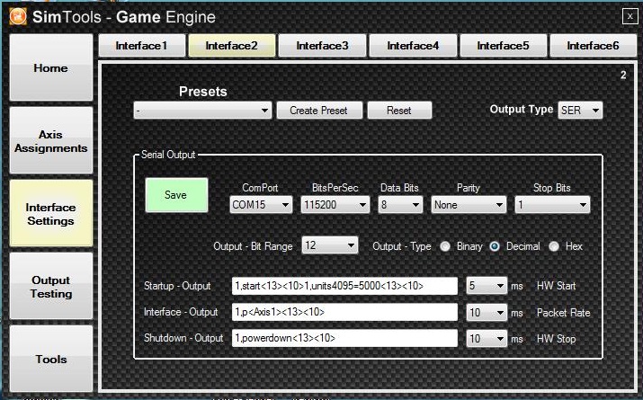

    I think I've got it! see pics

    Hi @jsmith2307 , According to your screen shots you’re still not set up properly. Let me explain. You have set roll on Axis1 and pitch on Axis2 in simtools axis assignments. Therefore, if interface1 is being used for the roll motor, you would use 1,p<Axis1><13><10> for the interface output on interface1 and 1,p<Axis2><13><10> for interface2. However, if interface1 is being used for the pitch motor instead, you would use 1,p<Axis2><13><10> on interface1 and 1,p<Axis1><13><10> on interface2. I hope this clears up the confusion.

    Greetings @BlazinH!
    Thanks for responding. I think I've got it. Funny how one little number can mess things up!
    jsmith2307
