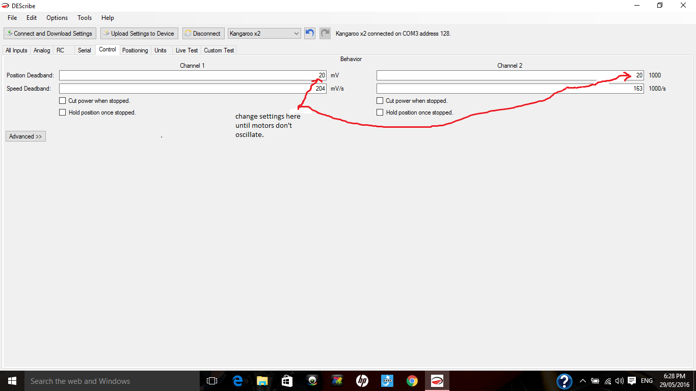

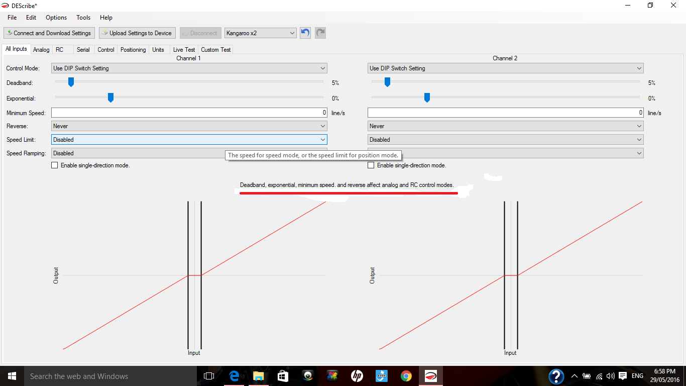

  11. Willem Pienaar
    Willem Pienaar New Member
    Feb 9, 2016
    29
    UK
    478Coins
    +16 / 0 / -0
    Good day gentlemen.
    Me and a friend of mine and I have both decided to take up the challenge to convert our Sim Rig (Predominantly used for iRacing, Dirt Rally and X-Plane) into 2-DOF motion seats. We’re using an identical setup comprising of a Sabertooth (2X32), kangaroo, 2x potentiometers and 2X24 Volt wheelchair motors.
    My friend is a step ahead of me and we were able to get everything working on his setup. In his words “what an experience”. However, he had a power disruption over the weekend whilst his PC was powered up and since then we were unable to get the kangaroo/SimTools working as they use to.
    The kangaroo has been successfully tuned with the potentiometer voltage around 2500 mV when everything is in the neutral position. Both the motors can me manipulated from within the DEscribe software. The settings were unloaded and uploaded to the device (kangaroo) and it was confirmed that the kangaroo accepted the settings by powering everything down and up again and then re-connecting with Describe to verify the travel ranges. Everything is consistent with the values set during the tuning exercise.
    Next up is SimTools. Setting up a default profile seems straight forward (albeit what we initially thought).
    1. We set up the interface setting as described in the post "Guide to setting up SimTools for use with the Kangaroo motion controller" (refer to the top of this forum topic).
    2. We set the Pitch and Roll as Axis 1 and 2 respectively in the DOF 2 column.
      Question : This is a 2 DOF setup. Should values be set for DOF 1 and DOF 2 or only DOF 2?
    3. When we perform the output testing the only response we get is only one of the motors moved to an extreme limit when moving the Roll Slider. The motor then remains in that position. None of the other sliders have any effect whatsoever.
    4. Opening up DEscribe again after SimTools was closed, each time show that the Tune Parameters previously set have been reset (always back to the same values).
    5. The correct “Tuned” setting have again and again been unloaded to the device and each time it resets to the “default” values after a SimTool output test.
    We do not understand what resets the Kangaroo Tuned Values. I would not have thought that SimTools were supposed to do this.
    Did anybody else experience this behavior before?

  12. BlazinH
    BlazinH Well-Known Member
    Oct 19, 2013
    2,145
    Oklahoma City, USA
    16,701Coins
    +1,840 / 32 / -1
    Hi.
    First, think of each axis as one motor. Then you add dof’s to that motor. Normally you start with dof1 and then add more dof’s in order if more are desired.
    If you use independent roll and pitch motors, then even though you have set roll and pitch dof’s up on dof2 instead of dof1, it should still work. If your motors are arranged to share dof’s though, like as in a chair mover, then for each axis you must add all dof’s that will be mixed on that motor.
    Also, I’m not sure your kangaroo settings are resetting. I’m not familiar with the 2x32 model with the built in USB port but with other DE motor drivers, each time you start Describe, you must upload the settings from the device again. Are you doing that?
  13. Willem Pienaar
    Feb 9, 2016
    29
    UK
    478Coins
    +16 / 0 / -0
    BlazinH, thank you for your prompt response and for explaining how Axis & DOF ties up.
    After the Kangaroo was tuned, we’re able to power everything down and power it back up again, start DEscribe, connect and download the settings from the device. These values remains consistent to what they were set when the kangaroo was tuned. At this point we’re happy that everything is as expected.
    The issue we’re struggling with is when opening up Describe, connect and download the settings from the device, after performing the Output Testing via SimTools, returns different results to what we experienced as described in the paragraph above.
    P.S. I know it is illogical but it is almost as if SimTools overwrites or resets the Kangaroo setting we’ve set via DEscribe. Can this be possible and if/if not do you have any suggestions how this can be resolved.

  14. BlazinH
    Oct 19, 2013
    2,145
    Oklahoma City, USA
    16,701Coins
    +1,840 / 32 / -1
    I don't know if this could be the issue for you, but it is a known fact that when loading data back into Describe, that it can be somewhat different than what was loaded onto the driver. I called DE because I was testing throttle curves and the data points would come back different than what I loaded. They assured me that what I loaded was still as loaded however. Do you notice any change in the motion after the settings came back wrong? If so, then you need to call DE and ask for Charlene. She can probably tell you what is going on.
    And no, I'm not a firm believer in the Kangaroo and have never used it myself other than bench testing. I had been using sabertooth 2x60s prior to the kangaroos release which I really liked though so I had high hopes for the kangaroo and decided to make a Simtools interface so others could try it. But it has thus far proven ineffective for motion simulators from what I have seen and most can't get it to auto tune without errors. The best I've seen from a kangaroo that did work used encoders though and not pots.

  16. Willem Pienaar
    Feb 9, 2016
    29
    UK
    478Coins
    +16 / 0 / -0
    I think we have it sorted. We found the solution involves adjusting the “start-up” parameters. The original values posted in this thread were:
    1,start<13><10>1,units4095=5000<13><10>2,start<13><10>2,units4095=5000<13><10>
    What we’ve been able to establish is that the t values 4095 and 5000 are the mV lower- and upper ranges the potentiometers function i.e. the range from one extreme to the other. In out setup the voltage over the potentiometer is around 2500 mV (2.5 Volt). We have thus set the upper and lower limits either side of 2500 mV. The revised start- up parameters now look like this:
    1,start<13><10>1,units2100=2900<13><10>2,start<13><10>2,units2100=2900<13><10>
    Note : The Voltage across the potensiomenters can be established from within DEscribe (or with a suitable digital Volt Meter).
    I trust this information will be of some help to someone.
    Thank you for all your inputs
    Regards
    Will & Robbie

  18. BlazinH
    Oct 19, 2013
    2,145
    Oklahoma City, USA
    16,701Coins
    +1,840 / 32 / -1
    @Willem Pienaar, I didn’t use the @ to address you in my last post above so in case you didn’t see it, may I ask how you established the unit values were lower and upper mV ranges? Since you want this information to be helpful, some background into how you came to this conclusion would also be useful. Also, how did you read the pot voltages in Describe? Are you speaking of the values in the kangaroos positioning tab?
    Upon viewing Describe again after quite some time, I believe I’ve stumbled upon a reason as to why the kangaroo has not been performing as expected. But you are all sorted now then?
