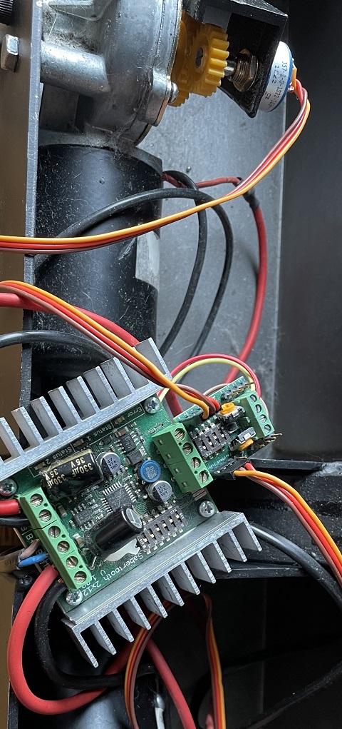

    Hello everyone,
    I come back to you after several years of absence. I connected my dynamic seat again but I can't get it to work, yet I control it with DEScribe... Has Simtools changed?
    22,159
    154,580Coins
    +11,190 / 57 / -2
    SimTools is under constant development.
    Can you please detail your hardware, code being used, and post pictures of all of your settings.
  6. McCorwin
    McCorwin Member Gold Contributor
    Mar 25, 2013
    37
    - 90Coins
    +13 / 1 / -0
    Hello noorbeast ! thanks ! I use Kangaroo X2 and sabertooth
    and :
    1,start<13><10>1,units4095=5000<13><10>2,start<13><10>2,units4095=5000<13><10>
    1,p<Axis1><13><10>2,p<Axis2><13><10>
    1,powerdown<13><10>2,powerdown<13><10>
    22,159
    154,580Coins
    +11,190 / 57 / -2
    For the current version of SimTools that should be:
    1,p<Axis1a><13><10>2,p<Axis2a><13><10>
  8. McCorwin
    Mar 25, 2013
    37
    - 90Coins
    +13 / 1 / -0
    Thanks a lot !!!! All is ok !
