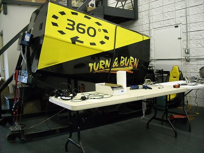

    I agree with @tronicgr Retrofit and existing Sega r360.
    I missed out on an auction for two of them that Michael Jackson owned. I thought they went cheap.
    The buyer refurbished them to original condition. Which increased value but made it hard to find part when it breaks down.
    I thought the units should have been upgraded to more modern electronics.

    If I wasn't up to my neck with my "360 Commercial retrofit". I would be going your direction. I do have a couple of questions.... Did you finalize your design? Did it come out like your drafts that you posted above?
    Have you found a slip ring to your liking? I'm using a Mercotac 8 wire model 830 (2@4 amps, 6@30 amps) slip ring. I know there are lots of units out there so it will be interesting how you will transfer power and data between your loops.
    I use 3 for power and the other 5 for data
    This will be fun to continue this project. Your welcome to glean information off my problems.....
    I don't mind your input. My unit will be shipped to my location today or tomorrow...... Then I can find out what a mess my help caused.

    Great idea in using the gyroscope sensor. I may add this to my current 360 commercial retrofit that i'm working on...... I finally got it relocated to my work warehouse.

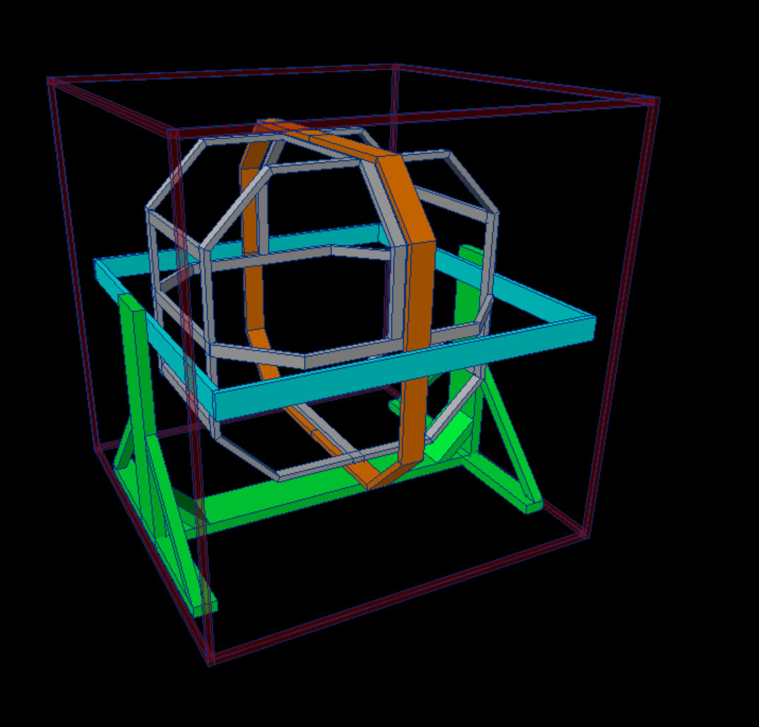

    Alright, since my 2DOF is almost done it is time to get back to this while I am waiting for new motors for the 2DOF...
    For the 360° I think leaving the PAN axis out would just be lame so I reconsidered a sort of spherical gyro construction. I love the concept made by GusBiz but I want to keep it cheap,small and constructable with common tools.
    CF is great but it is expensive, the dust isn´t too good for health and I never worked with it so that is not a good idea for a first project with CF.
    I´ll stick to steel or maybe aluminium for the cage if I find someone welding it for me. This is the updated version:
    The outer box won´t be part of the sim, it is just showing the bounding / consuming space box which is a cube around 1,50m.
    To start with this I´ll probably build the inner cage from wood just to see if it really got enough space or some tweaks are required.
    Of course everything can be constructed and calced in cam program but sitting in the cage just gives more exact information.
    One important thing I need to keep in mind is that this thing needs to fit through a door (which is around 80cm) so I cannot weld all parts
