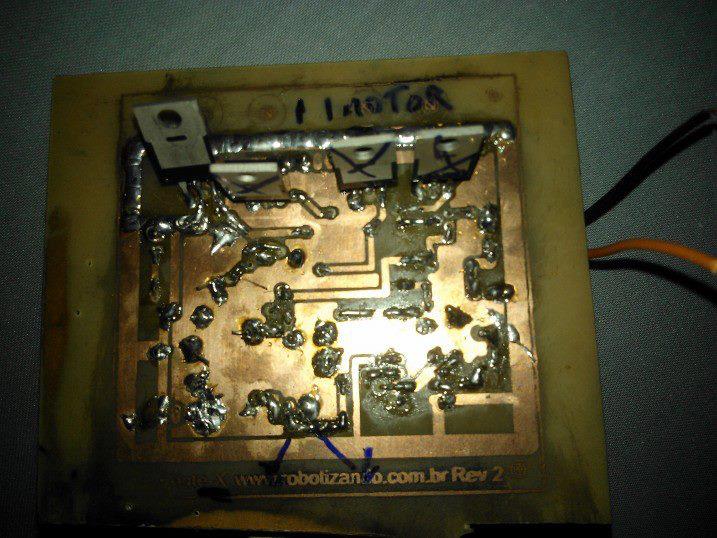

    some pics the h-bridge works pretty good with 5v.. i just need to add the small circuit
    need to take care with the transistor and fets they are really sensible...

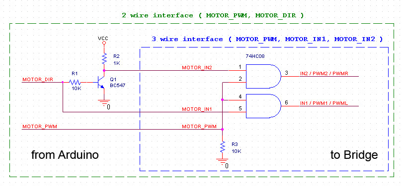

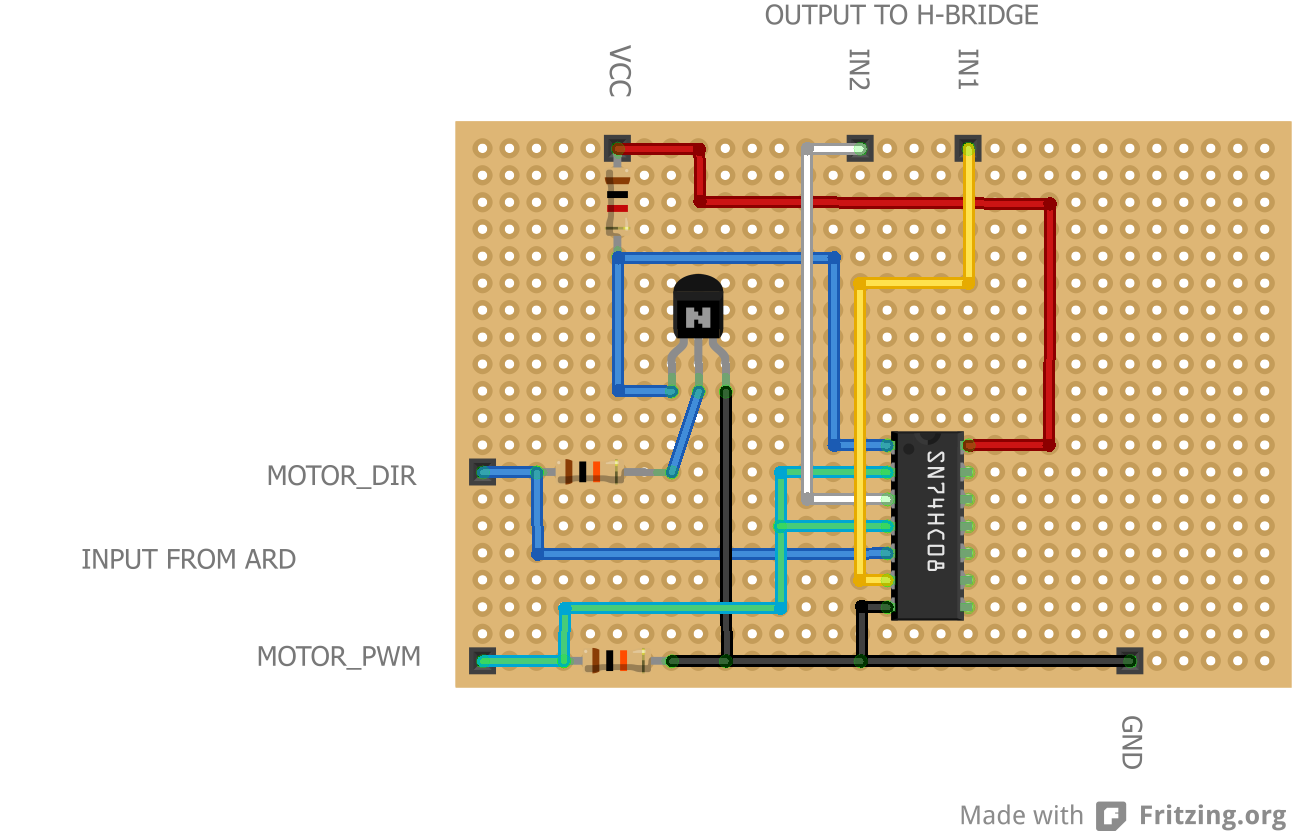

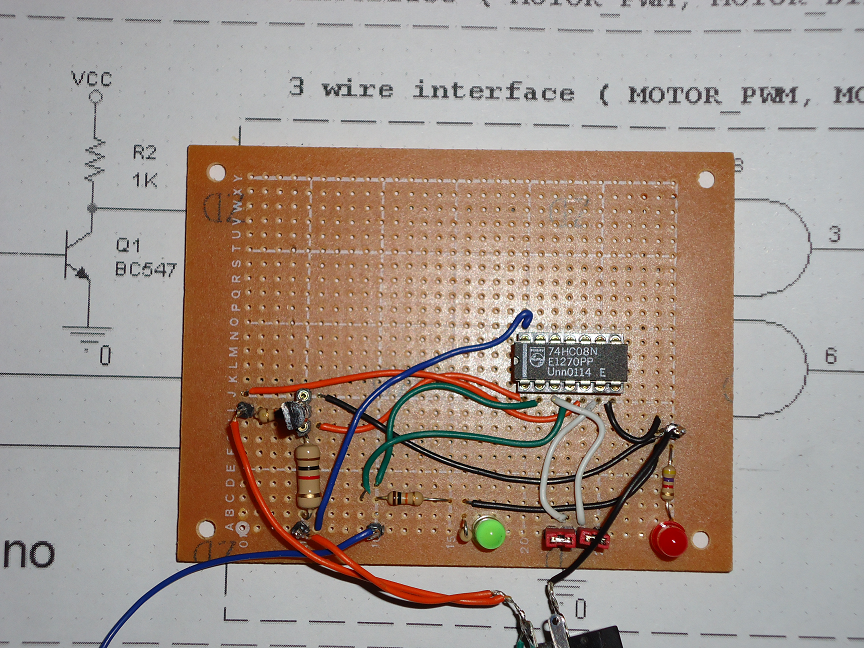

    im finishing the small circuit to add to h-bridge. one simple question
    this 2 diagrams have small differences. like the firt one has an red wire coming from the vcc and goes to the IC
    the other doesnt have it.. and some other small things like the ground resistor
    so its work all the same?
