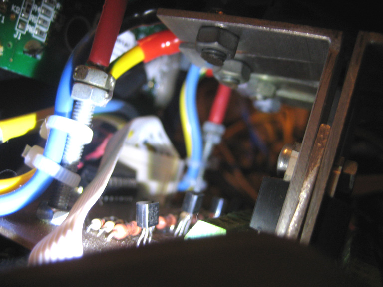

    The back of the mosfets (cooling fins with the screw hole) are electrically connected to their drain. You have to be very careful how you connect them not to short anything out. Don't connect them to any ground!

    hey frakk,
    i can't follow you completely, ok the back of the mosfet (alu/metal) piece you can't connect to ground i now but, ru.null is talking about wire from the back of mosfet to motor somewhere i don't know.
    Or are you talking about this in particular ? or you mean just don't connect back mosfet to ground

    The motor connectors are not connected to ground,they are connect to the drains of both upper and lower mosfets on each side. Therefore you can also connect the motors directly to the cooling tabs because it is the same electrical point. Just be very careful not to short anything unless you like the smell of burning epoxy and melting wires on the board.

    ok i follow you i think, (never learned for electronics just a bit of a hobby). But if i'm correct i connect one wire to housing of motor in other words the minus or the rotor wire.
    Can you put it in scema for me because i don't want burning at all.
    my motor frames are not isolated

    I don't know how you have the motor wired up.
    Basically: connect one motor wire to the tab of one IRLZ44N, connect the other motor wire to the other IRLZ44N tab. If you want it to revers just switch them up.

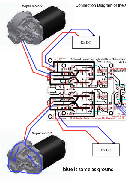

  7. pim
    pim New Member
    Feb 25, 2010
    28
    system engineer
    nederland, brabant
    380Coins
    2DOF, SCN5, SimforceGT
    this is how it is connected

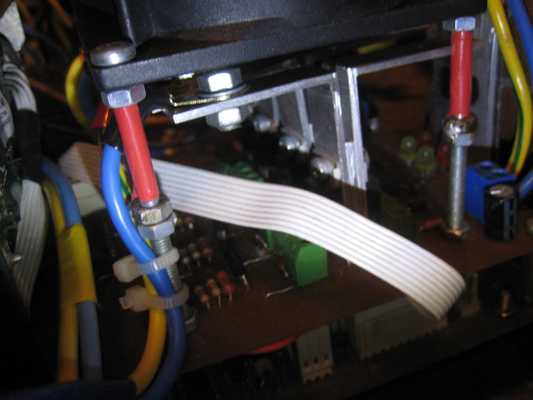

  8. ru.null
    ru.null Member
    Feb 24, 2010
    46
    Petrol stations tech support
    Russia, Rostov-on-Don
    290Coins
    Hi Pim!
    I connect motors directly to cooler mosfets. Blue and yellow wires on the fotos. How Adam said, this is the same as the drain.
    I did not know why you got a problem with connecting ground. This is my second Hbridge with this modification and have no problems. Also I am a little rebuilded PCB and etched this ways.

    pim, be very careful mounting the motors. Do not forget, when the motor is spinning in one direction, your case will be ground, but when it is spinning in the other rotation, the case will be 12V PWM. If you have the motor connected to the frame or any other parts without electrical isolation, you run the risk of shorting it to other parts.
