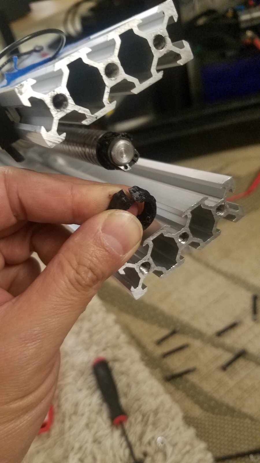

  4. hannibal
    hannibal Active Member
    Sep 29, 2018
    677
    4,492Coins
    +298 / 4 / -0
    i am running through the 6dof gauntlet and learning the hardway
    something was off, and after my hard trip, i discovered that it ate the anti wobble ring..

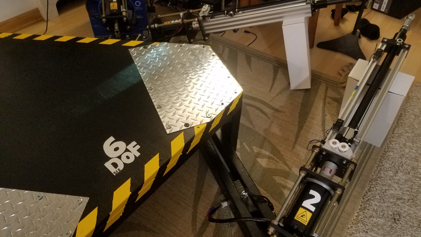

  8. hannibal
    Sep 29, 2018
    677
    4,492Coins
    +298 / 4 / -0
    i attribute my actuator build and design from @SixDegreesOfFlight @wannabeaflyer2 (the crazy tinkerer that likes to talk about bears lol) and @SilentChill (the 6 Dof freak.. :) )
    my actuator spec is i set it for 11" stroke (could be more but im not going to push it)
    using 500mm v slot 20mm x 60mm for the structure
    carbon tubes are 500mm , with 25mm OD, and 20mm ID (other guys went 22mm/23mm..i thought that was thin)
    25mm linear igus bearings.. (do not go steel bearings, i had my carbon tubes scratched) (go alibaba for 15$ a piece, unless u want to pay 60$ a piece from igus)
    powered by E30-400 ampflow motors.. ( i been told its overkill, the E30-150 is feasible)
    i am using 9mm 3d printer belts with GT2 pulleys.
    custom hand made aluminum pot & pulley fixture with bournes hall effect 3600 degree 10 turn pot (36 $ a piece, if you going to make your own actuator, dont go cheap, u lose at the end)
    how i attached the carbon tube is that i epoxied to the nut housing that comes with the ball screw (sfu1605 type ball screw), but put a 3d printer 3/4" spacer so that i have more surface area to epoxy the nut housing to the carbon tube with $$$ 3M 2216 A/B flexible epoxy. (photos a few pages back)
    good luck.

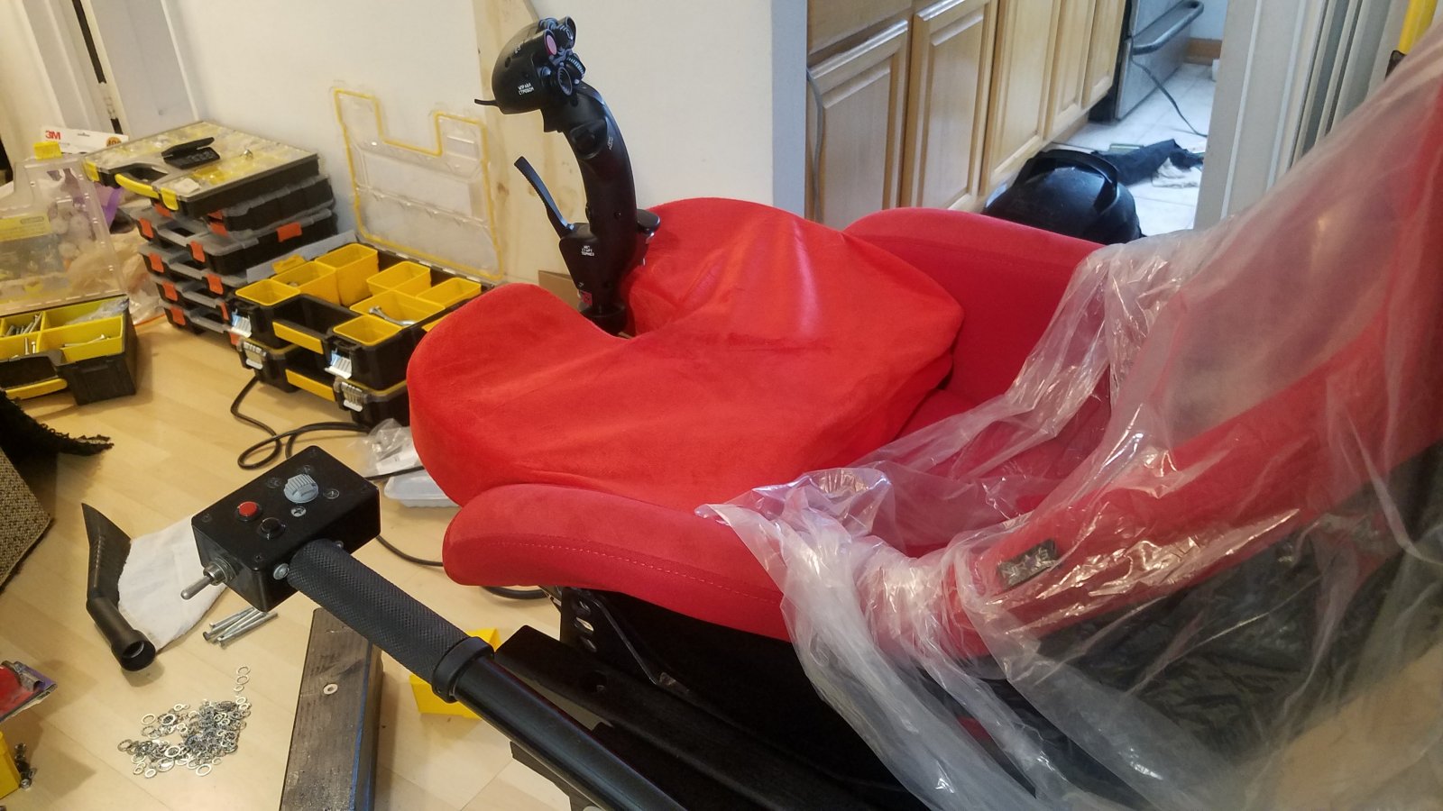

  13. hannibal
    Sep 29, 2018
    677
    4,492Coins
    +298 / 4 / -0
    happy new years.
    im still working on my 6dof.. but at snails pace.
    trying to finialize controller positions before i take down frame for additional welds 20200111_205054.jpg 20200111_145552.jpg
  14. hannibal
    Sep 29, 2018
    677
    4,492Coins
    +298 / 4 / -0

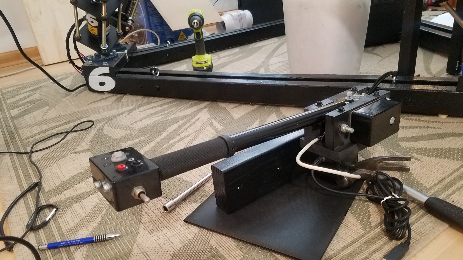

  15. hannibal
    Sep 29, 2018
    677
    4,492Coins
    +298 / 4 / -0

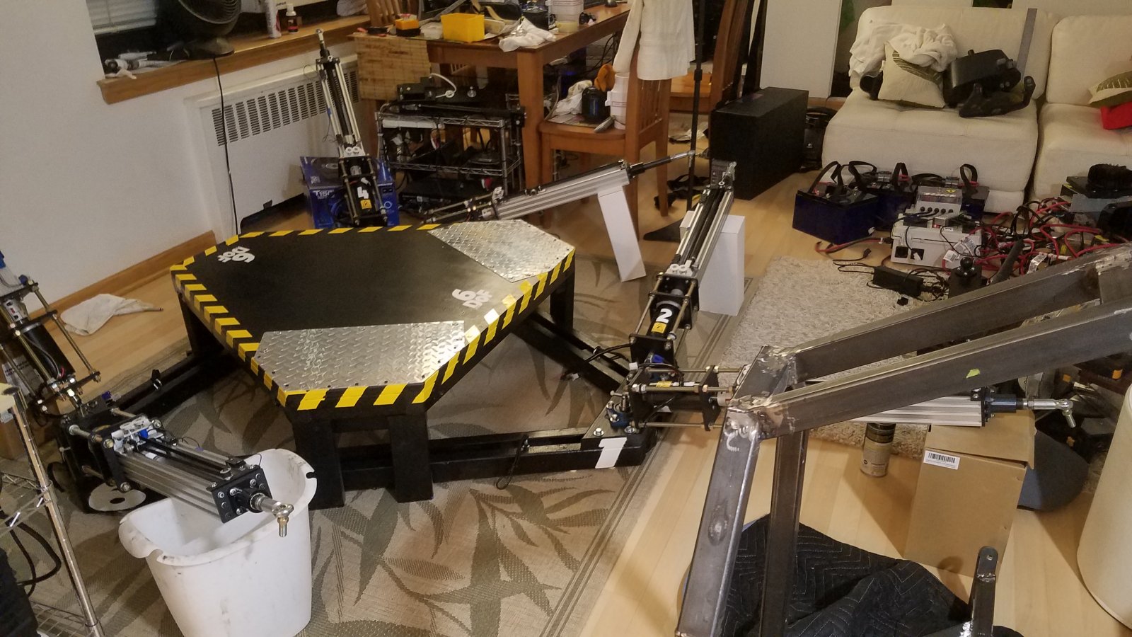

  16. hannibal
    Sep 29, 2018
    677
    4,492Coins
    +298 / 4 / -0
    protective table... 13inches high.. i hope its not too high to hit actuators.. 20200118_190048.jpg 20200118_190056.jpg

  17. SilentChill
    2,645
    20,604Coins
    +3,570 / 34 / -0
    And a mop bucket !
  18. Pierre Lalancette
    Dec 11, 2016
    1,012
    Tech Artist
    Quebec, Canada
    8,052Coins
    +947 / 6 / -0
    3DOF, DC motor, Arduino, 6DOF
    Man, so much time is spend to make it look beautiful.
  19. hannibal
    Sep 29, 2018
    677
    4,492Coins
    +298 / 4 / -0
    thank you @Pierre Lalancette @SilentChill .. i just hope it will work, i feel like im almost building a tank.. i see both of you guys are going for mimimalist with lightweight materials..

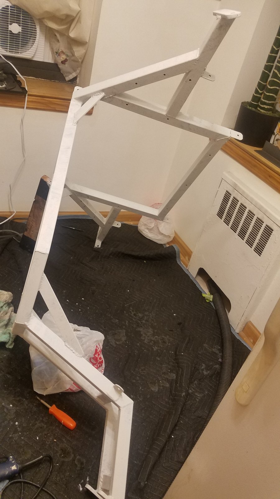

  20. hannibal
    Sep 29, 2018
    677
    4,492Coins
    +298 / 4 / -0
