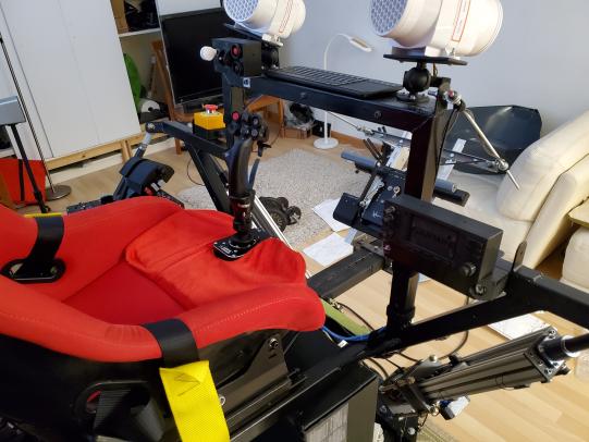

    my last mod was editing my race chair to allow my joystick closer to me

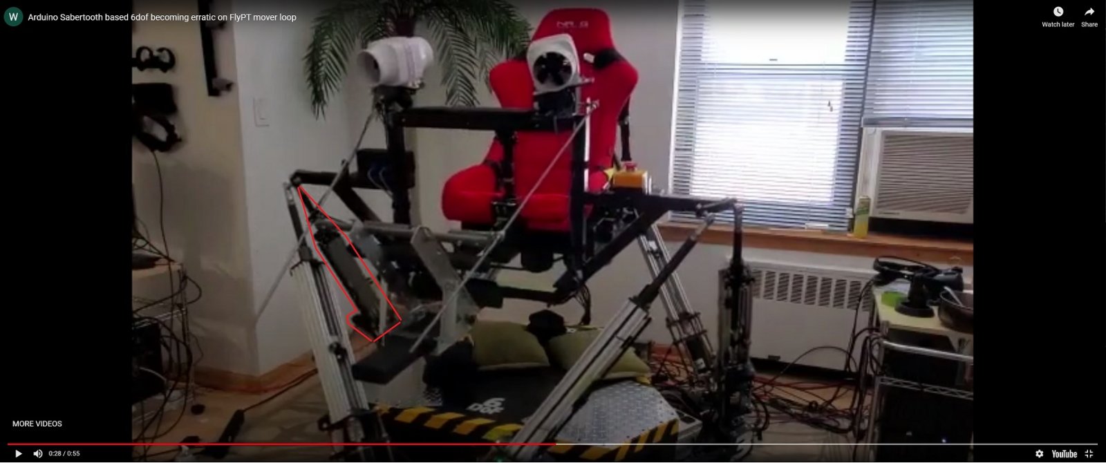

    hey guys.
    i have a problem and i am trying to solve and a year after my build hasn't been as satisfying to use because of hard trips or the thing becoming erratic.
    im running arduino with sabertooth 2x60 driving ampflow motors E30-400
    reducing the PWMmax to 190 seem to reduce the hard trips
    but when i try to test the 6dof with a loop running (via FlyPT mover v3.4.2) and in this example, a loop to run the pitch angle..
    the 6dof works ok, but then after a while an actuator or two becomes erratic...
    i would have to then disconnect from FlyPT mover, then run SMC3 on each of my arduino/sabertooth pairs in order to start back to normal....
    need advice @noorbeast @Pierre Lalancette @SilentChill @BlazinH @wannabeaflyer2

  6. Pierre Lalancette
    Dec 11, 2016
    1,009
    Tech Artist
    Quebec, Canada
    8,043Coins
    +945 / 6 / -0
    3DOF, DC motor, Arduino, 6DOF
    At 28 sec, look at that actuator and how much it turns and twists. After that, you becomes unstable. I think that you have a problem of tortion in your actuators.
  7. hannibal
    hannibal Active Member
    Sep 29, 2018
    677
    4,492Coins
    +298 / 4 / -0
    along with that actuator, the one next to it in the front, i would get jitter after disconnected from mover (no input to actuators).. but a few of the actuators become erratic, the one you pointed out is much noticeable. my problem is not limited to one actuator...
    my actuators are sort built for to spin free, i was worried about binding. i have bungie cords to help it from fully spinning.

  10. Flymen
    May 19, 2018
    348
    Montreal, Canada
    2,471Coins
    +194 / 2 / -0
    DC motor, 6DOF
    Hi , I saw the same thing that Pierre ( it like just one actuator ) look your Pot on this one if is stable ( like set screw on shatf ) or the pot is not stable and give strange ohm....

  17. hannibal
    Sep 29, 2018
    677
    4,492Coins
    +298 / 4 / -0
    maybe that is my problem!

  19. hannibal
    Sep 29, 2018
    677
    4,492Coins
    +298 / 4 / -0
    @SeatTime i used shielded USB cables , cut out the USB ends so i can tie the wires in a way to connect hall effect pots to the arduino... ( i have been concisous of noise so i went with the USB cable instead of just regular wire..)
    i also have the 0.1 uF caps between arduino input and arduino ground..
    @Pierre Lalancette i feel like i have a new 6DoF!!!!!!!!!!!!!!!!!!!
    after setting clip input and max limit to zero, the actuators are running like champs (i hope i dont jinx)
    i ran a loop in mover for the last 15 mins... no erratic behaviors.
    thank all of you @Flymen @Pierre Lalancette @SeatTime
    can i see your SMC3 settings @SeatTime ?
