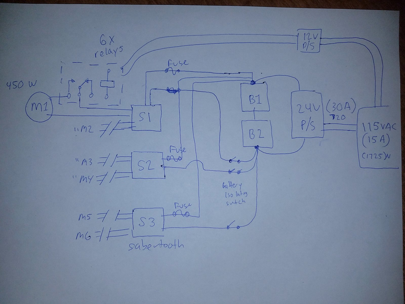

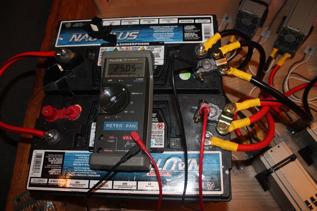

    is this your setup? thanks for sharing...
    so you have (2x) 12v batteries in series with (4x) 24v power supplies in parallel?

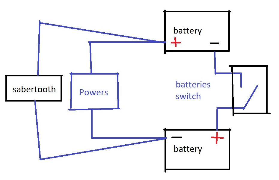

    Not unless he has 48v motors... you must place the batteries in parallel to the power supply.
    Also you should connect the batteries via relays to disconnect the batteries from the PSU if the PSU is off...

    yes.. batteries parallel to power supplies, thats what i meant! :)
    for relays, i was planning to follow @wannabeaflyer2 and have relays between motors and sabertooth, but you are saying we should have between Power supply and battery? i like to show you a sketch wiring diagram when i have it ready @Thanos ! :)

    it would be nice to hear you guys critique of my power...
    i still have to figure out what size batteries, and finalize the wiring sizes.

    For the batteries, I put a kill switch between the two batteries. It's simpler and it cuts the batteries from the system in one go.

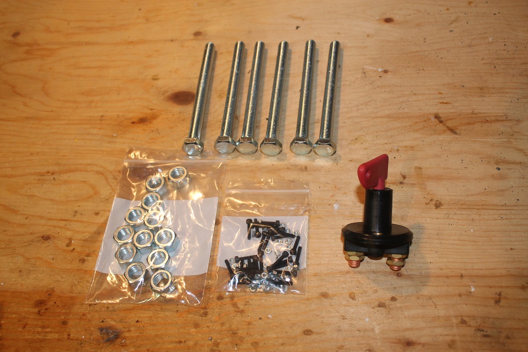

    i need a huge throw switch? kill switch will have to handle 200A?

    Mine is rated 200 Amps.
