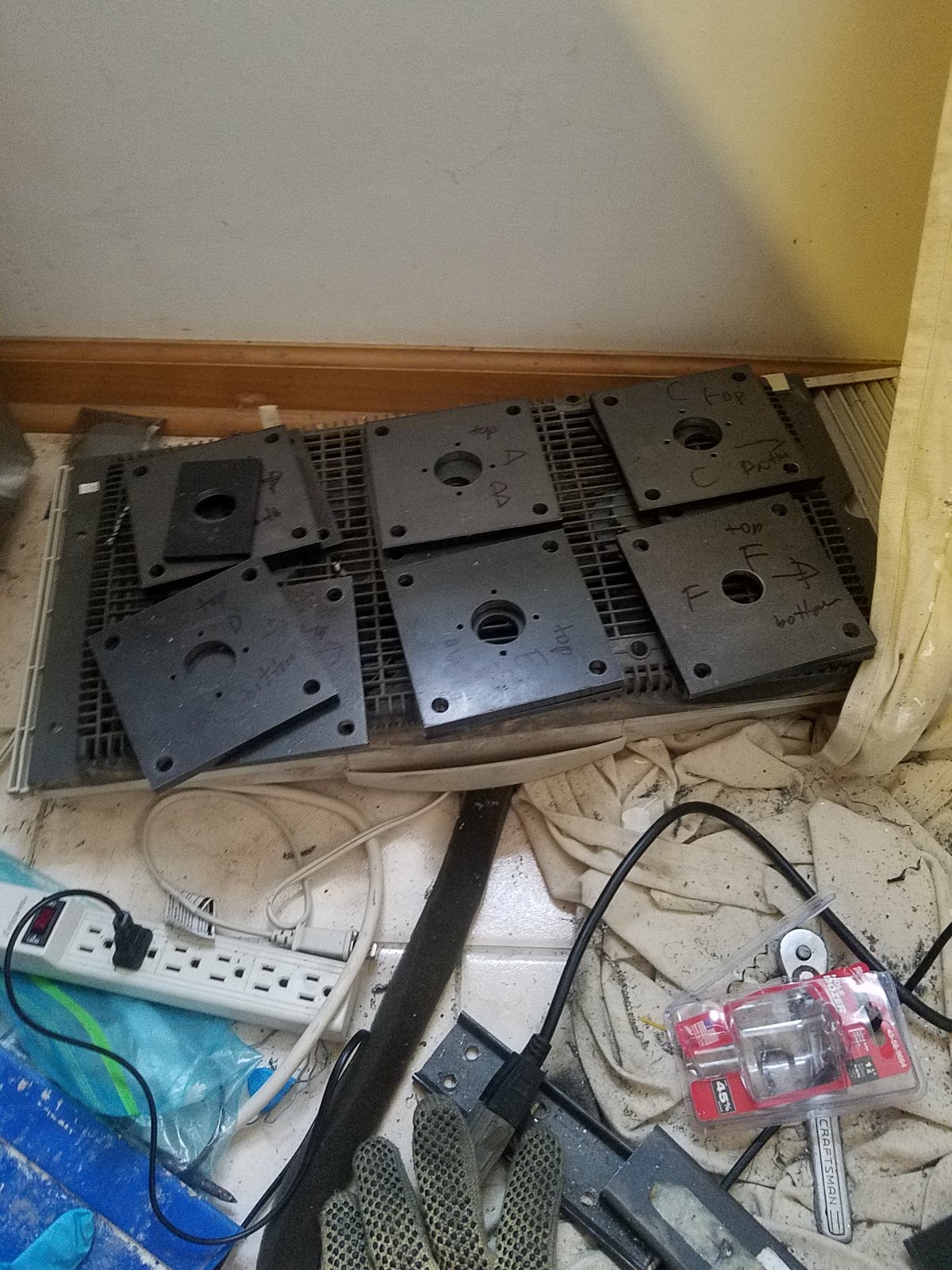

    3/8 rod is perfect , and 18 plates 5 x5 and 6 others 3 x 4 1/2 , that I did !( or near of that depend what you have at home in your home scrap parts )
    Very important : the precision of alls holes is very important and more the center one if you don't want everything move like earthquake!!

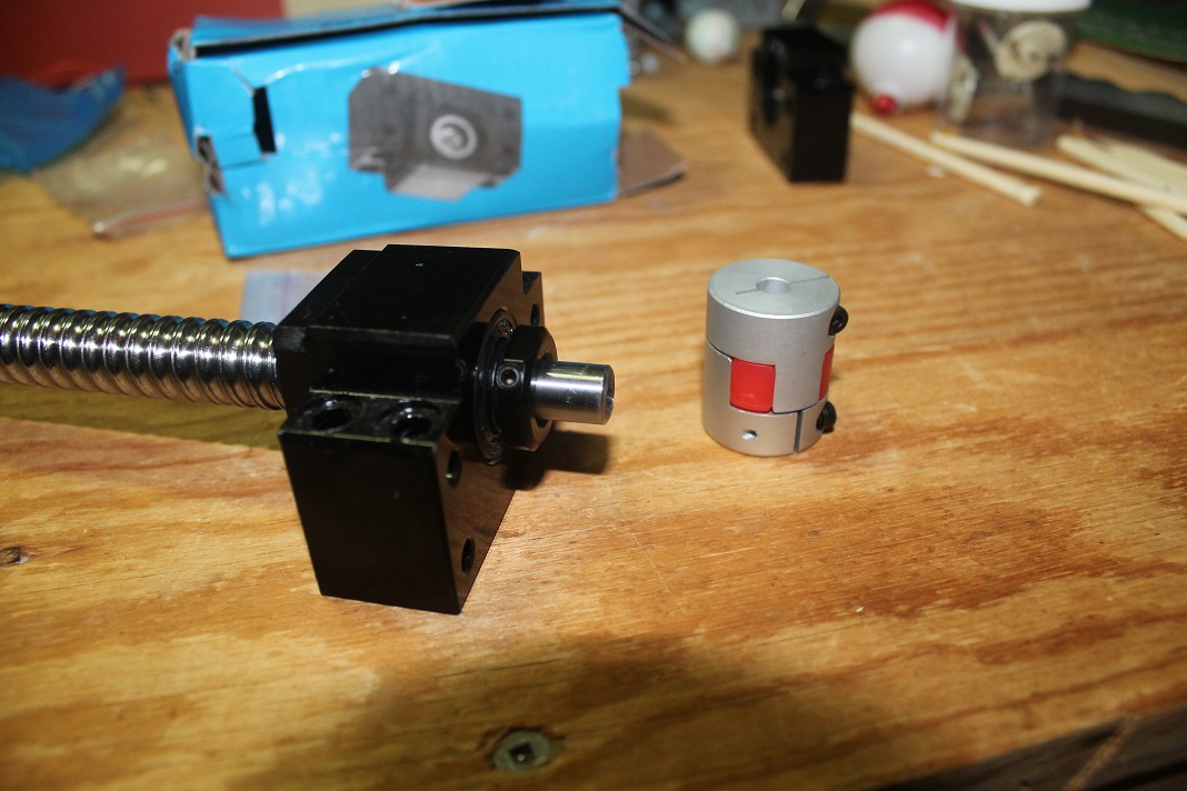

    so now i am researching shaft couplers..
    I see, sixdegreesofflight went with D40 L45 size couples with a rated torque of 10N.m with a max of 20N.m
    because @Pierre Lalancette has ampflow motors with 12.7mm shaft.. he went with rater torque of 7.5N.m
    I also went with ampflow motors with 12.7mm shaft... have my eye on D45 L66 size couplers with a rated torque of 30N.m (max 60N.m)
    is this excessive??
    now i see a D40 L55 with my desired size of 10mm x 12.7mm with 15N.m rating... this is good i think?

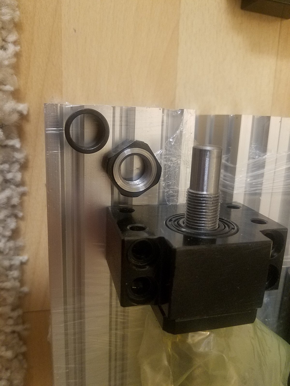

    Do you guys remove the spacer from main bearing block in order to get a longer shaft below the block in order to connect the coupler?

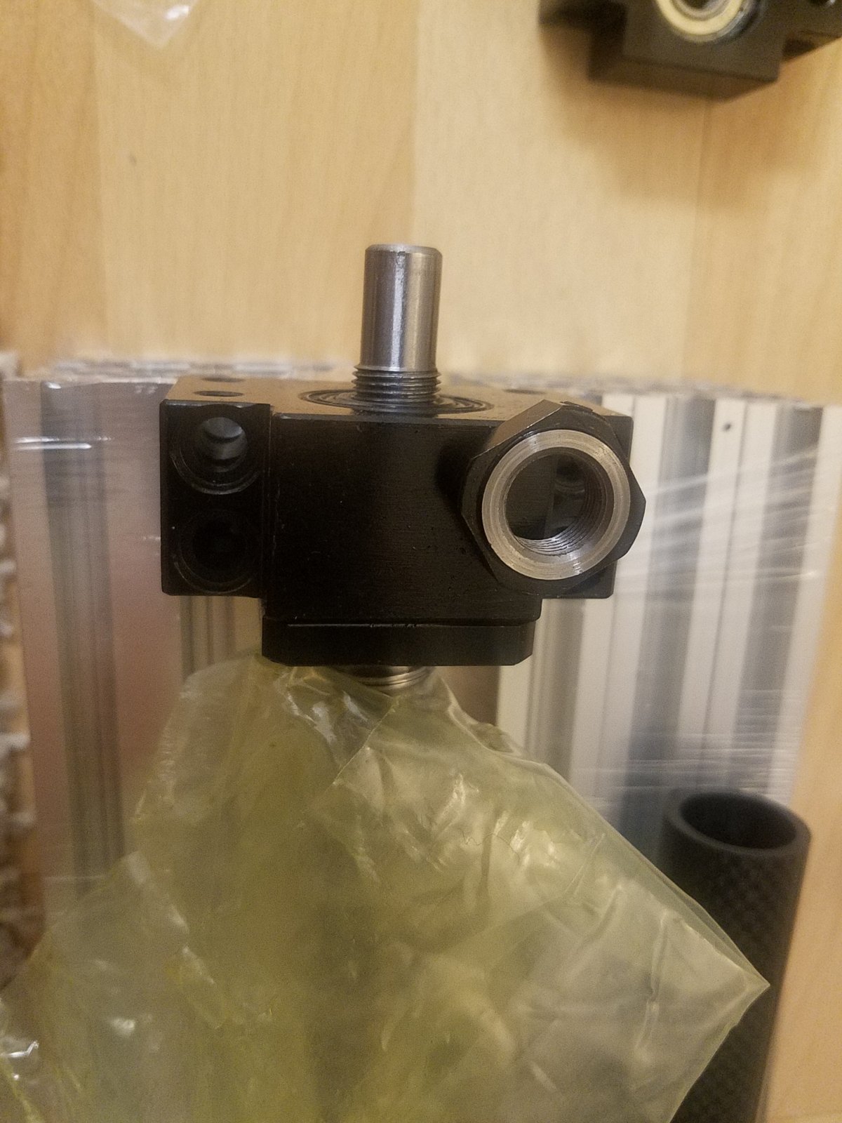

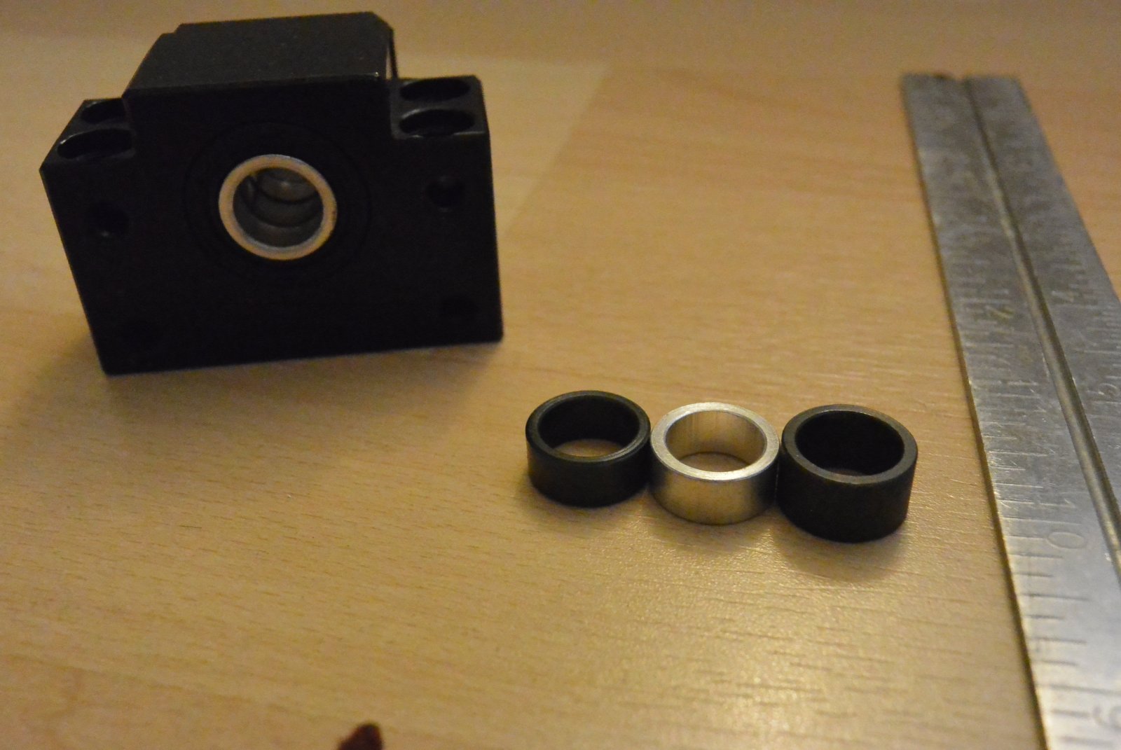

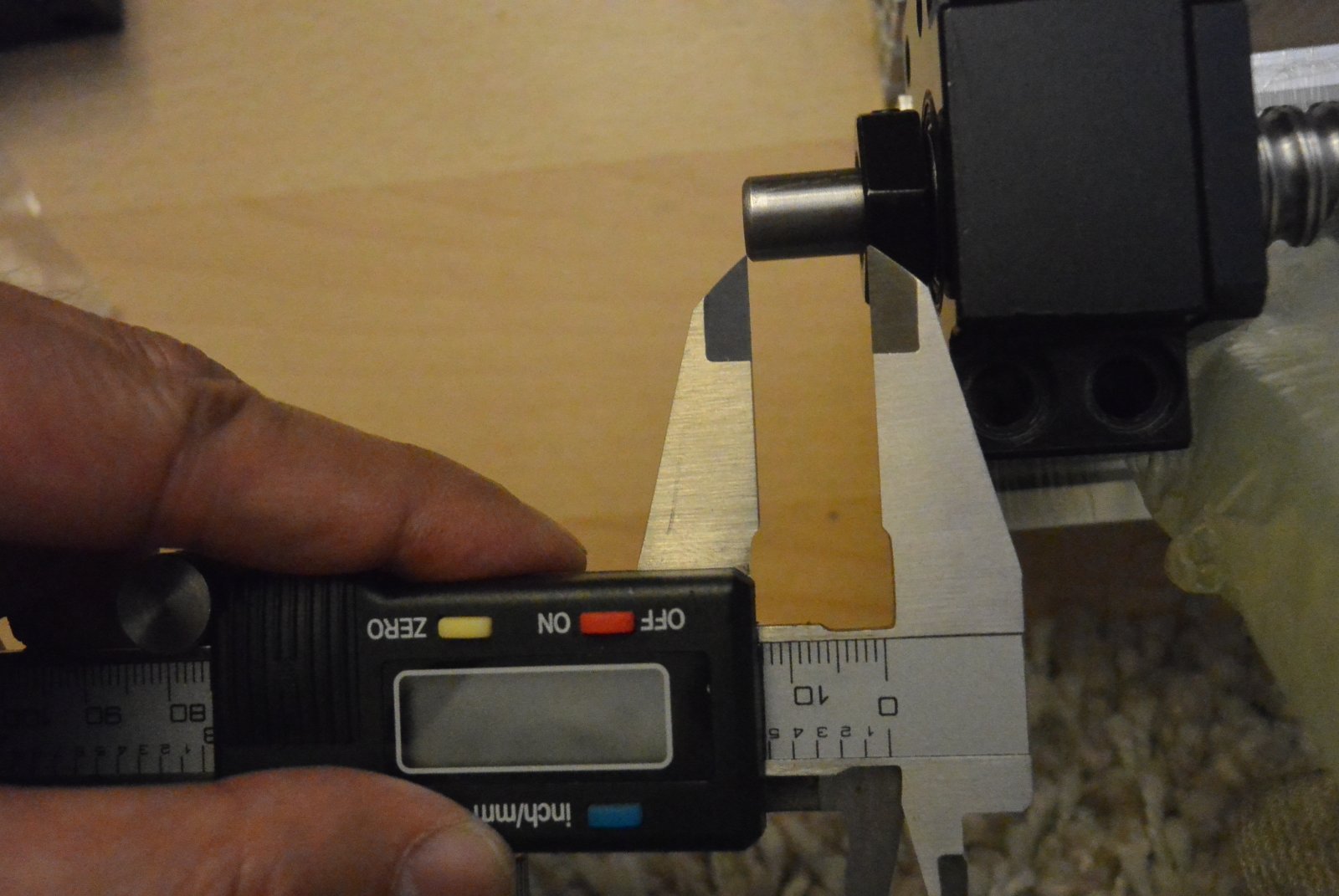

    when i received the parts, on the bearing block, there are 2 spacers, and 2 bearings that are on.
    if i put the ball screw on with all the items that it came with, i have less thread to put the nut that you are talking about. @Pierre Lalancette
    but if i remove one of the spacers, then i have more thread to screw on the nut...ill try to take a photo
  10. hannibal
    hannibal Active Member
    Sep 29, 2018
    677
    4,492Coins
    +298 / 4 / -0
    One photo is with the space, another without.. im just wondering if you guys use the space to have more shaft length to screw the nut and coupler

    Ok, the spacer is on the other side. It looks like a ring to take all the weight on the moving part of the bearing. But I don't know. I don't remember such a thing on mine.

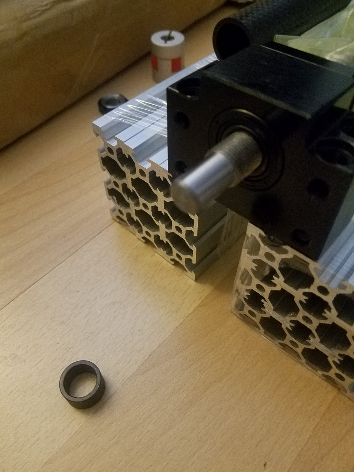

    after looking at photos of your build, you have the 2 spaces and bearings on your block. but i cant tell how much of the coupler fastened to the ball screw shaft... where you able to seat the coupler to the middle of the coupler? i found the photo of yours.. seems like the same!! i wish the length of the ball screw and size of the actually allowed the fully exposed shaft end up to the screw threads.

    after getting extra 7mm length 12mm ID 16mm OD spacers and removed the 9mm length spacers, i was able to achieve about 14mm from the shaft to mount the coupler..

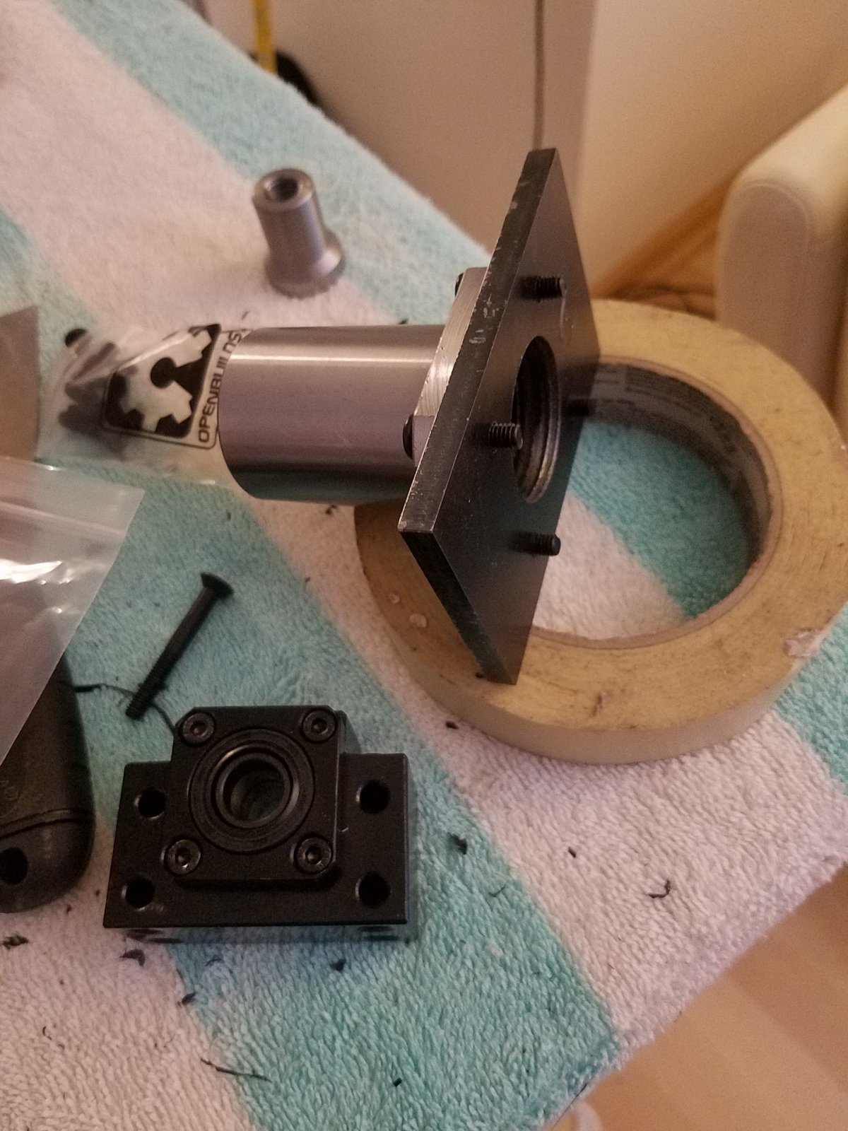

    ran into proper way to epoxy..
    also, i heard about using sand, but the proper thing to use is "bond beads"
