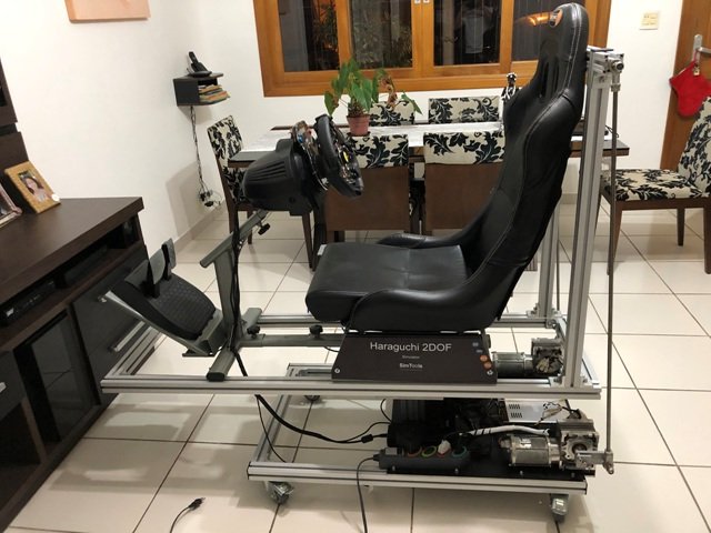

    I may try building an aluminum profile frame structure very similar to yours, could you please send some technical details ?
    I found a company on internet that actually assembles the aluminion structure the way you ask for.
  2. Haraguchi
    Haraguchi Member
    Dec 13, 2017
    77
    Gas rig operator
    Brasil
    120Coins
    +72 / 0 / -0
    hi Bruno !
    Yes i used aluminium structrure by Estrutural
    www.estrutural.com
    Jacareí-SP

    Hi Bruno, how are you?
    I spent about R$ 2500.

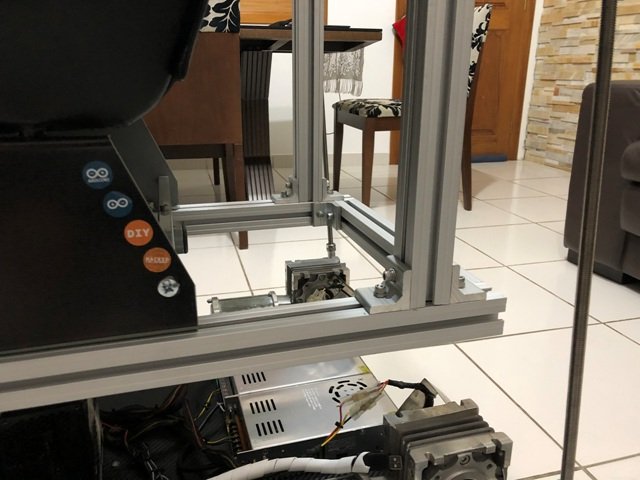

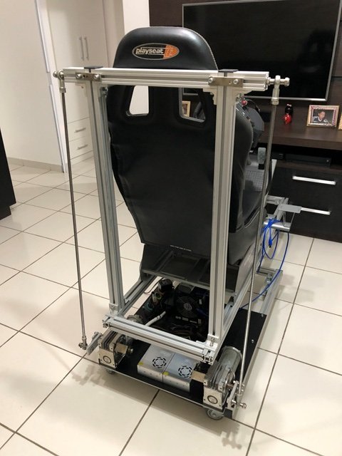

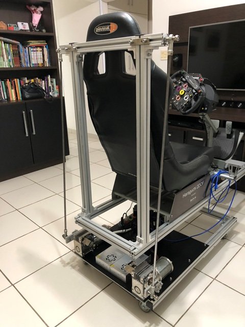

    Well I made some changes, mainly due to the heating of the engines. The heating was due to poor design I made. I had to study levers (Newton's laws). After some adjustments and with the help of this program (https://www.xsimulator.net/communit...e-linear-speed-and-forces-of-your-design.270/)
    I came in the model below.
    Maybe the aesthetics did not look so beautiful, but now the engines work pretty cool!
    Then I'll make aesthetic changes.

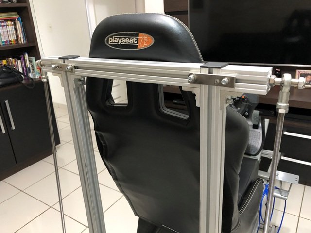

    I was looking at your design, the potentiometer part, you get 180 degrees? Could you tell me what potentiometers you used?
    Thank you.
  16. Haraguchi
    Haraguchi Member
    Dec 13, 2017
    77
    Gas rig operator
    Brasil
    120Coins
    +72 / 0 / -0
    Hi man.
    I'm using a linear 10k cheaper and simple potentiometer.
    I have used a precision model, but it dont works well.
  17. Haraguchi
    Haraguchi Member
    Dec 13, 2017
    77
    Gas rig operator
    Brasil
    120Coins
    +72 / 0 / -0
    Yes i got 180 defrees
