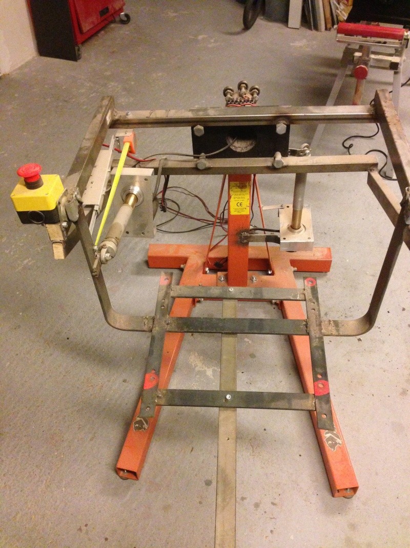

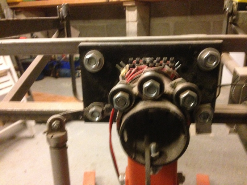

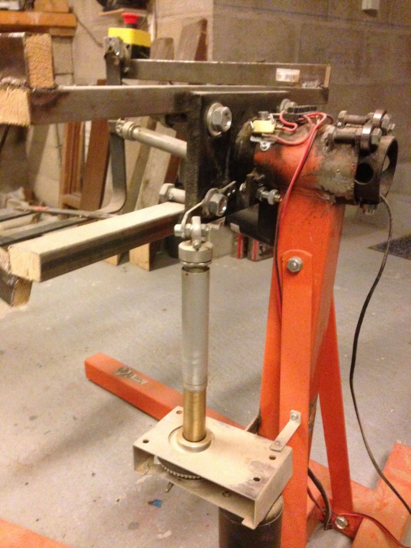

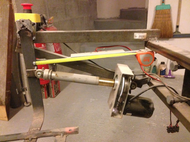

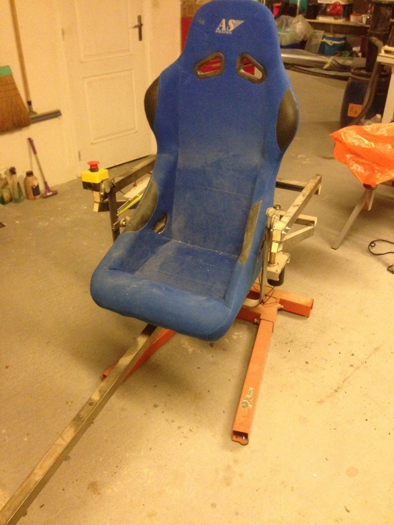

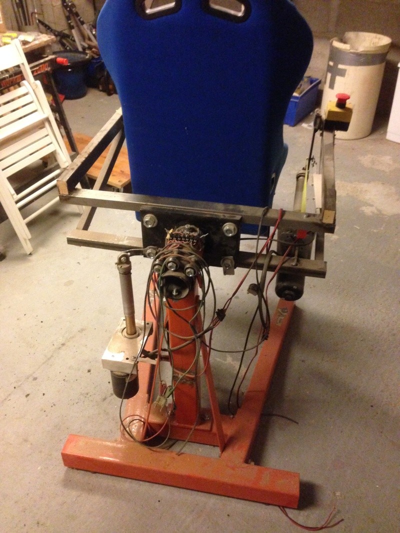

    As promise, please find attached a couple of pictures.
    Please excuse the dust, it was located in my basement and I had heavy woodworking closeby.
    Project is for timebeing on hold, but not cancelled.

    Thanks very much @OscarH ! Did you got it working?
    Maybe too much stress for the motor so near the shaft. What I really like is the compactness of the unit :)

    Compactness is one of the reason why I moved to this setup. I can also be easily dismantled and moved away, much ore than the Tornadoblu setup who was one piece...
    The motors does no suffer from any stress using this type of actuator. If you removed the supply on motor, the seat stay as it. This was different from Tornadoblu, as center of gravity was too much on the front, and motors had to support 2.5 Amps to have seat staying horizontal. This was the reason for the big counterweigh in back to compensate.
    So far, I didn't had chance to use the new seat as real simulator, I just excercised the 2 bank and picth motors manually. Worked well.
    Then came another bigger project (a new home to design and build) so it became asleep.
    In the meantime, I have seen my old BasicStamp soruced from TronicGr can be replaced by an Arduino + shield, so this bring new ideas to surface... but probably not short term.
    Cheers.

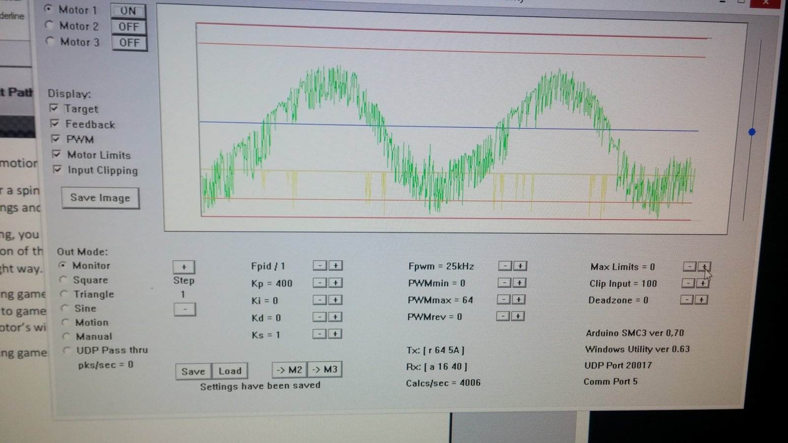

    All is wired again, using RufusDufus SMC3, but looks like maybe I have a problem with the POTs, also the only way I can turn on the motors in SMC3 utils is putting the max limit to 0.
    Pics and video of wiring:
    Any tips?

    hi @mariano68 I assume you have read and followed all the steps strongly recommended below:
    Initial Setup
    8. Set Kp to about 400
    10. Do the above for each motor

    Thanks @Pit I did from 1 to 8, I'll do something to connect the POT to the motor and I will try "9". Just the way the motor spin out of any kind of control even if I moved the POT manually was what made me not to even try point "9".
  12. Pit
    3,012
    30,490Coins
    +3,100 / 31 / -0
    if you follow carefully the steps there is nothing going wrong.

    Ok, connected but I think it isn't the way, but I post the video as the other problem is still here, that is I cant change the clip limit from 0 or my motor shut down and I dont know why.
  14. Pit
    3,012
    30,490Coins
    +3,100 / 31 / -0
    either your pot is faulty or it is not correctly wired.

    you can do something more:
    1. Upload the SMC3 code 0.63 (!) to the Ard
    2. Connect ONLY the pot to the Ard
    3. Start SMC3
    4. Move the pot by hand and have a look to the screen - if the feedback line is NOT jerky the pot is OK, if the feedback line is jerky there must be something wrong.
    I had a couple of pots (very cheap gadgets) which have been very noisy but never like the your's.
