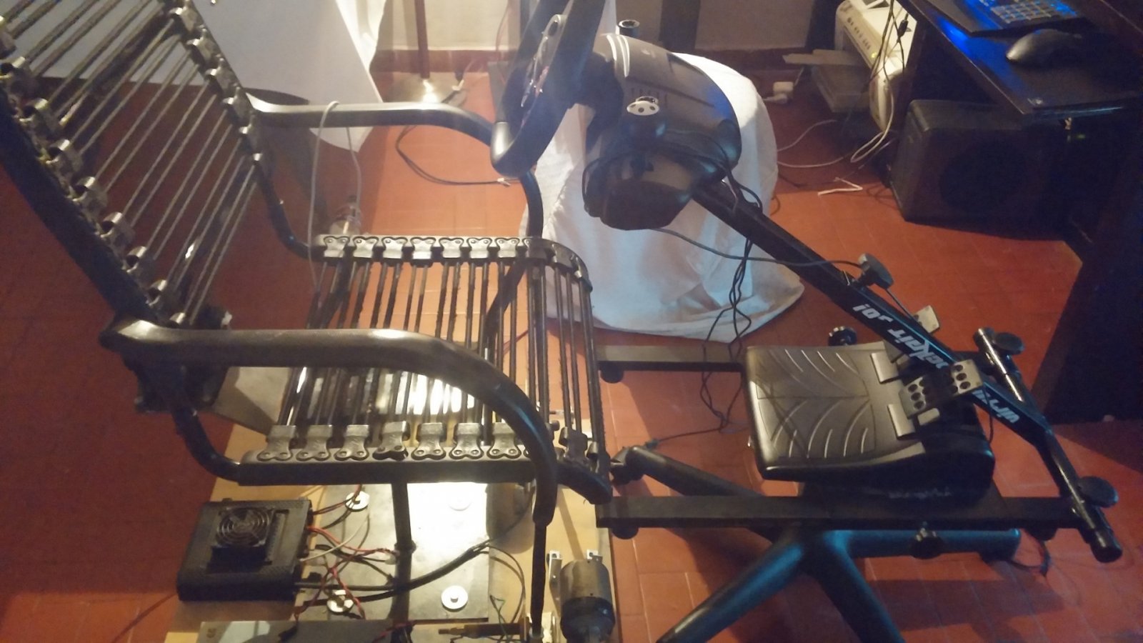

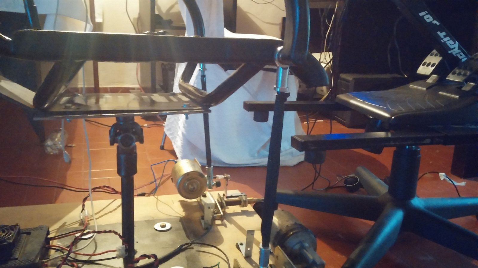

    Sadly I cant take a video right now, as my phone
    slipped out of my hand and got crashed, so no phone for some days.
    The chair is moving, it looks like it has a soul on his own right now, but I hope I can tame her soon ...
    BTW, One of the motor gets some electric (burning) smell, it isn't even hot but smells anyway, any clues?

    Basic video with the tablet
    It's a chair, and it moves :nerd
    Lots of problem with the pots placement, keeps getting out of sync :(

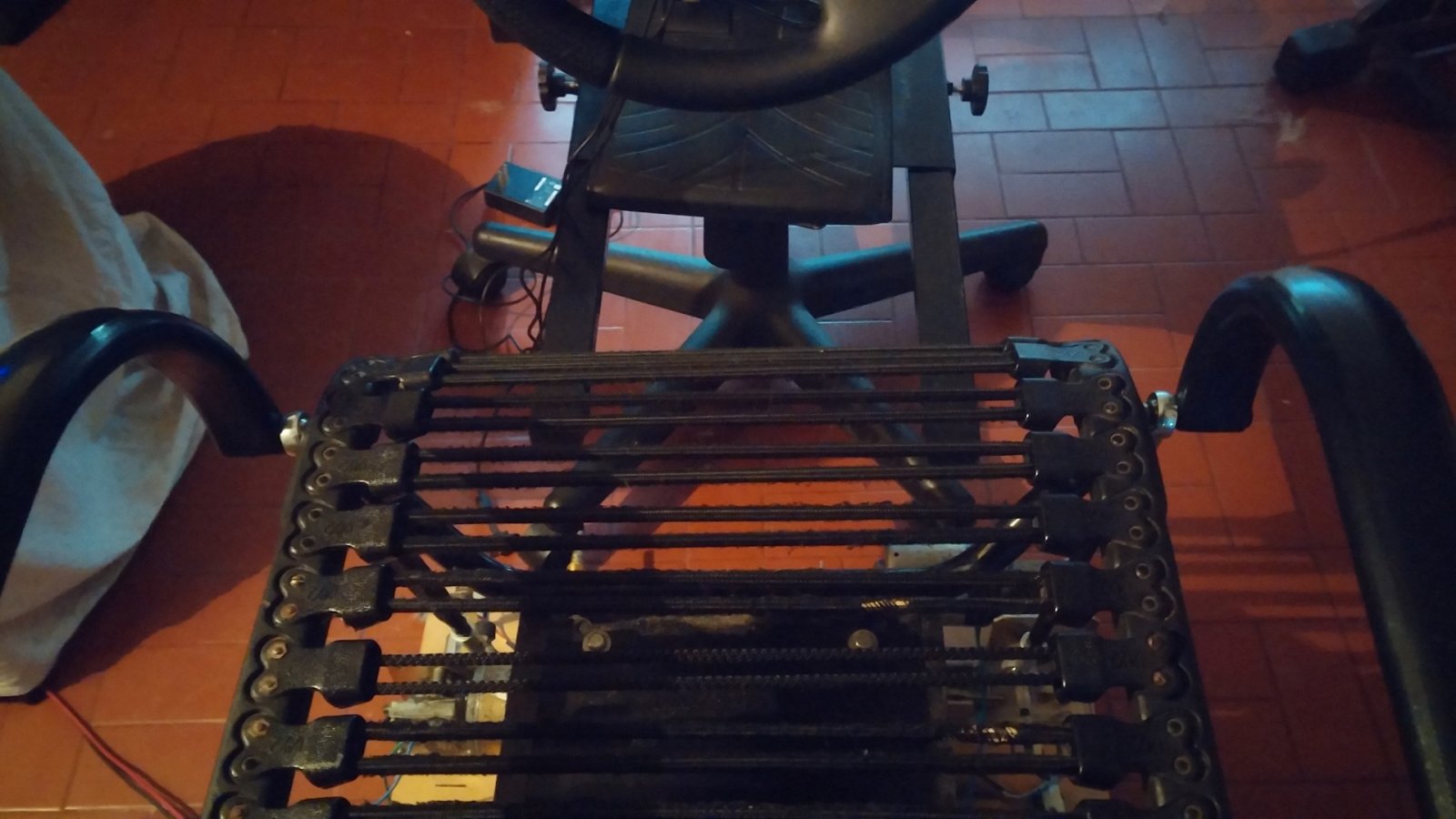

    Yes, I tested with rfactor, it feels too rough, needs a lot of tweaking, but at least moves me without problems, and I'm about 110kg... I think I took the right decision to not to make an upper structure and fix the motor directly to the chair.
    I will have to change the way I put the left motor as it doesn't pair with the right motor fast side and it is really annoying when brake and accelerate, also the left motor loose centering too fast, I will have to try a different approach on the POTs placement.

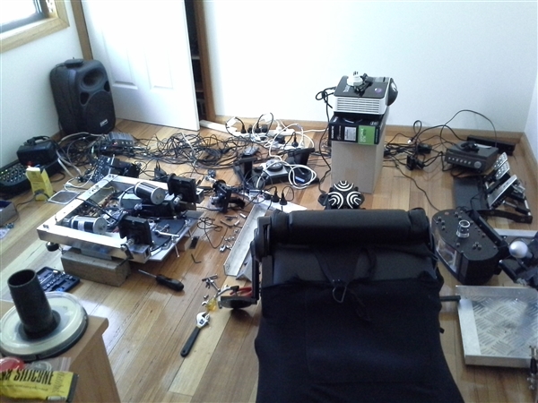

    Sorry, I have both my sim and computer in bits at the moment for some updates, and will be for a while as I am waiting on some parts, so I can't grab any presets.
    Though to be honest even though two sims may share a somewhat similar design they are very different in terms of geometry and hardware. Hence a preset may be a guide to getting something moving but I have found it is far better to understand how to work though creating and tweaking a motion profile for your own sim. There is plenty of info, guides and tips in the FAQs, it takes time but do one force at a time and work your way through, it will give you much better results than any preset: http://www.xsimulator.net/community/faq/simtools-settings-tips-and-tricks.18/category
    A glimpse of my current chaos!

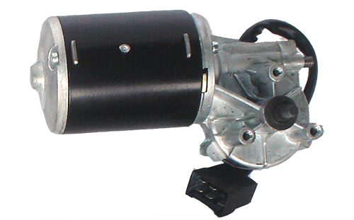

    Well, nothing good to report :(
    I'd installed the POTs in the shaft, and being there blocks the motor levers when it reaches 180 degrees if the motor goes wild, good to not break the POT, but bad for the motor as it keeps trying to turn, end results, one motor is half baked...
    On the other side, the motomonster is giving the motors less than 12v now, 10v at top in SMC3tool pwmmax, so motor can't cope the weight.
    Also, I tried to read all the info and manuals for tuning Simtools, and can't get any game to run half decent, I'm really disappointed...

    Have you tried to open up the fried motor to fix it? It could be something as simple as a burnt commutator.
    If you are just going to throw the motors away I would try to fix them first as you have nothing to loose and knowledge to gain!

    Thanks Alexey for your reply!
    The motor works if I move the outside shell, but NOT very well, once opened, the winding shows half of the upper part of the copper with some burned color. I think the only way to get it fixed is to redo the winding (I hope thats the name of the copper wire).
    Tomorrow I will post a pic of it.

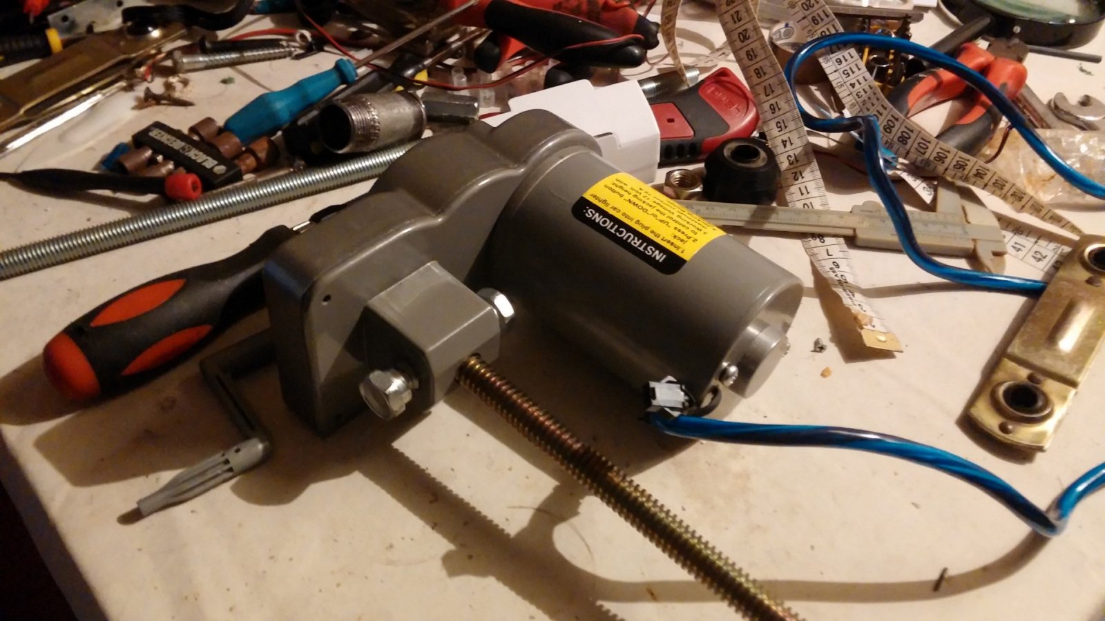

    I got a new motor, well, not the motor alone, an electric car jack :grin.
    Specs on the motor 12v 13amp, and after dissection 50:1 gear and about 55RPM at shaft.
    Now I have to cut the shaft, solder the lever and a mounting braket.
    I'm thinking on letting the shaft as long as the motor and put a bearing holding it.

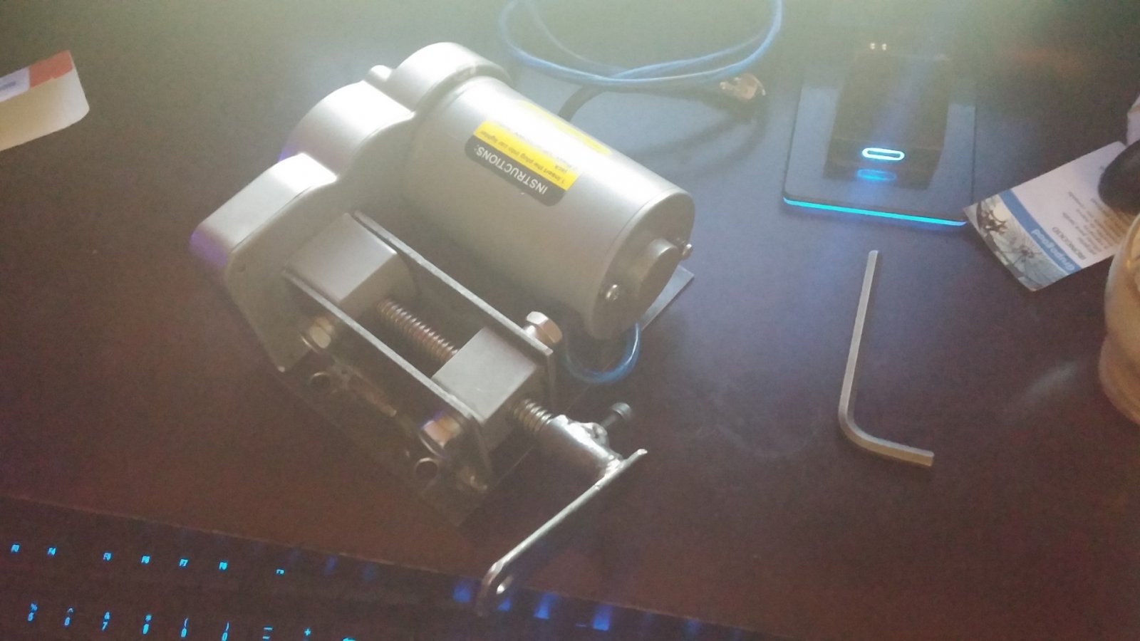

    Anyway, I have the electric jack modded, look at it :)
    I will try it tomorrow to see if it works good enough, if it is ok, I will get another one and do the same and build a foot mounted full 2dof.

    Hey guys, finally I tested the modded E-jack today, it was a total success!!! I replaced the broken wiper motor with it and it is notably stronger and noise was acceptable. I even used a 60mm ctc lever where the wiper with 25mm ctc struggled and I had to hold the chair!
    I will be getting another one on Monday, will do the mod, and I hope I will have the new sim ready this week!

    It looks like the entire design relies on that set screw. Are you able to get that tight enough to not have any slippage under load?

    That set screw is against a flattened face of the shaft, so it is not a weak point.
    Anyway, worked fine in test, will see once the sim be ready.
