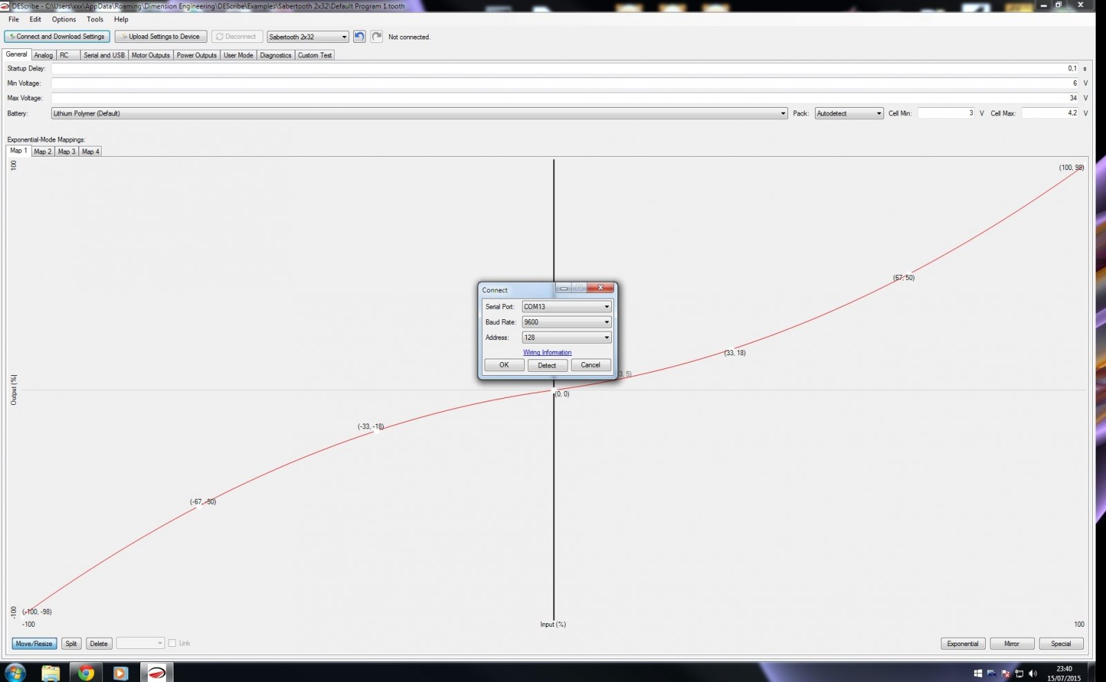

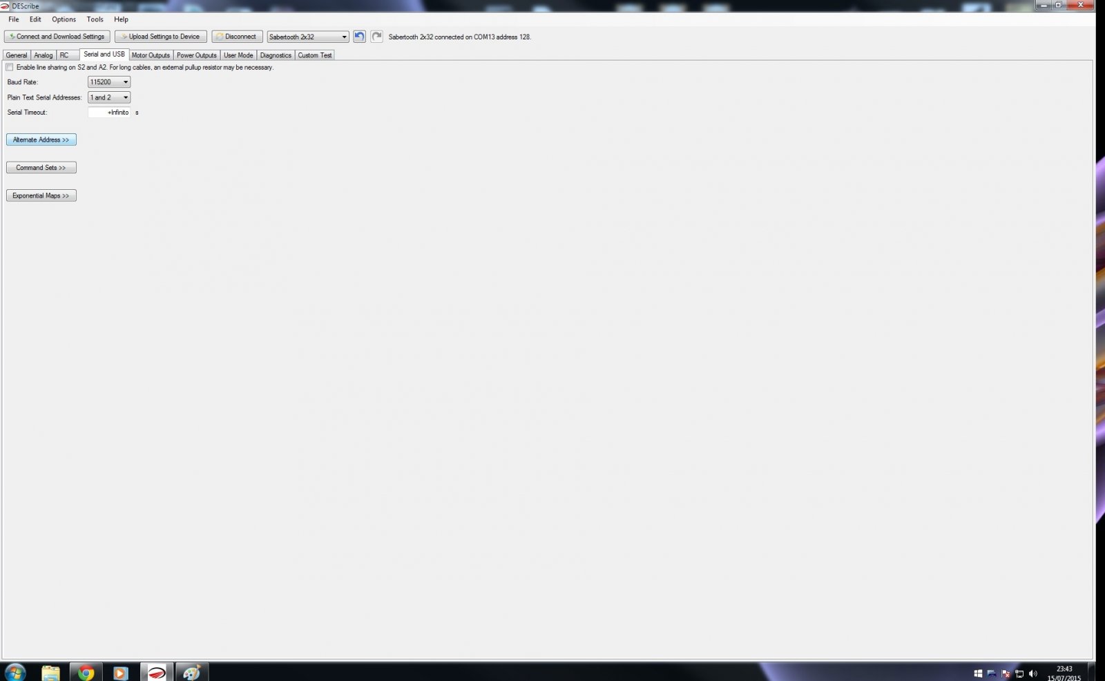

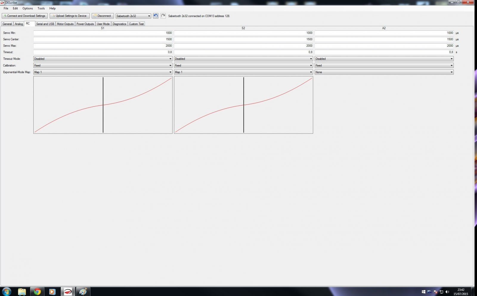

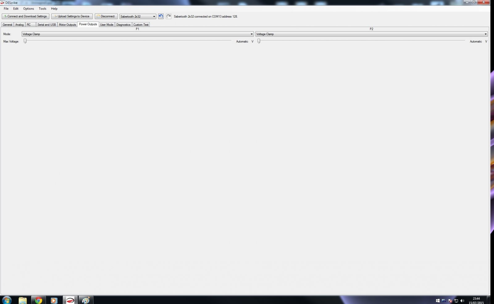

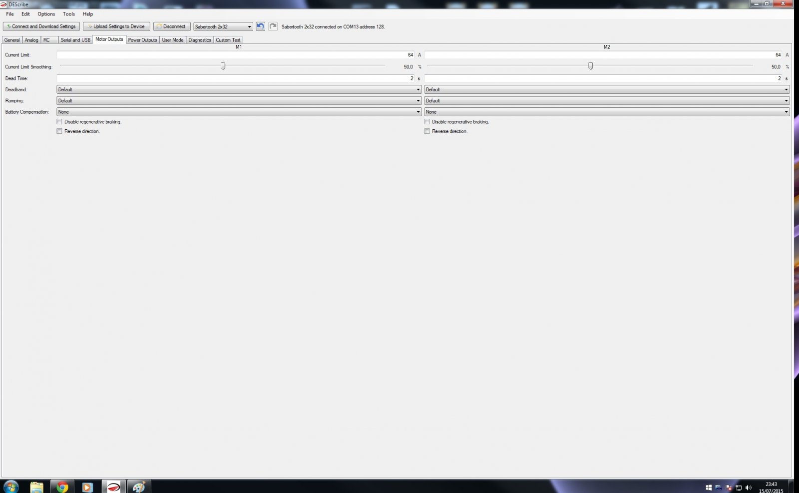

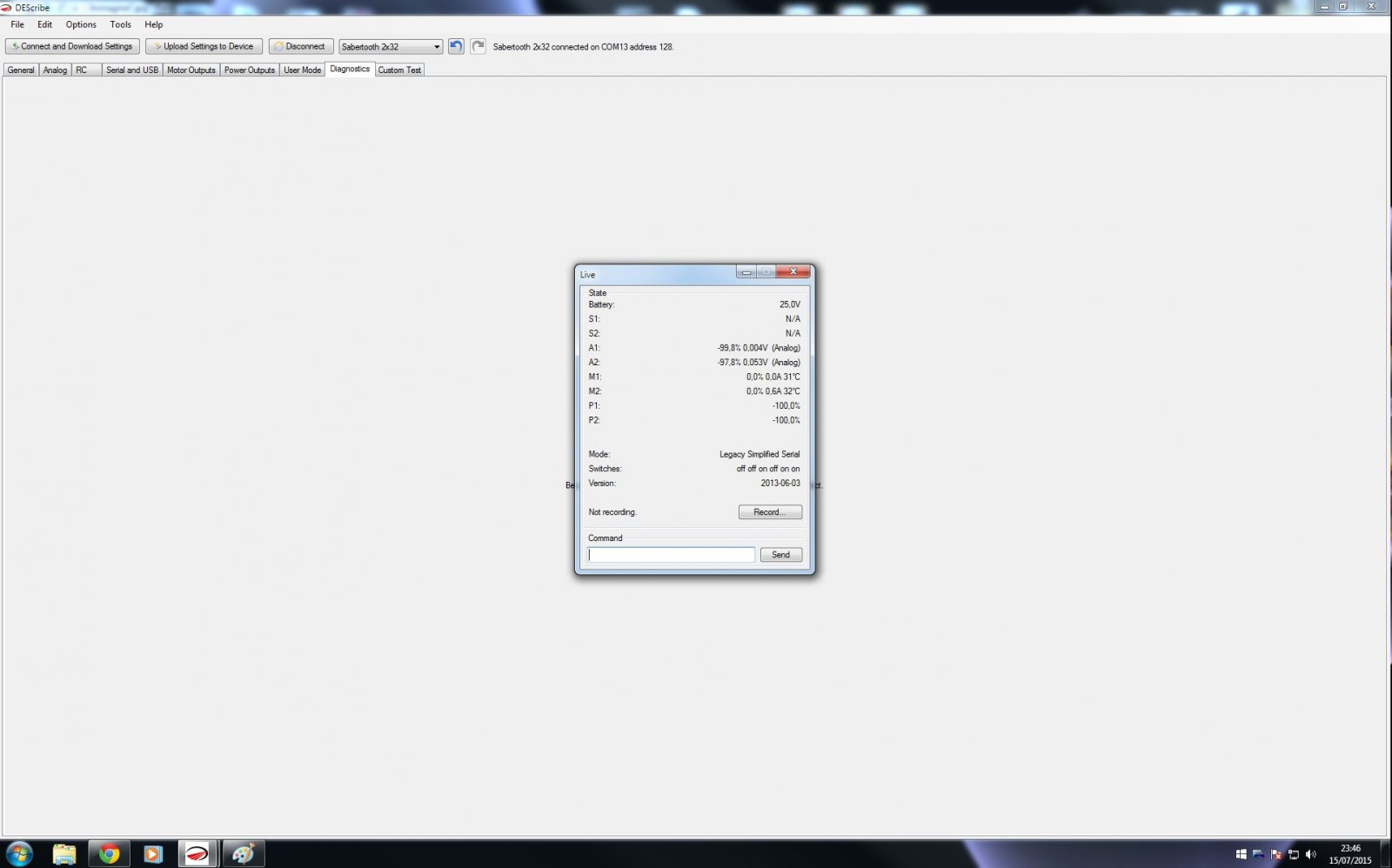

  12. Paul Shortland
    Paul Shortland Active Member
    May 13, 2015
    154
    Northampton - UK
    317Coins
    +77 / 1 / -0
    2DOF, AC motor

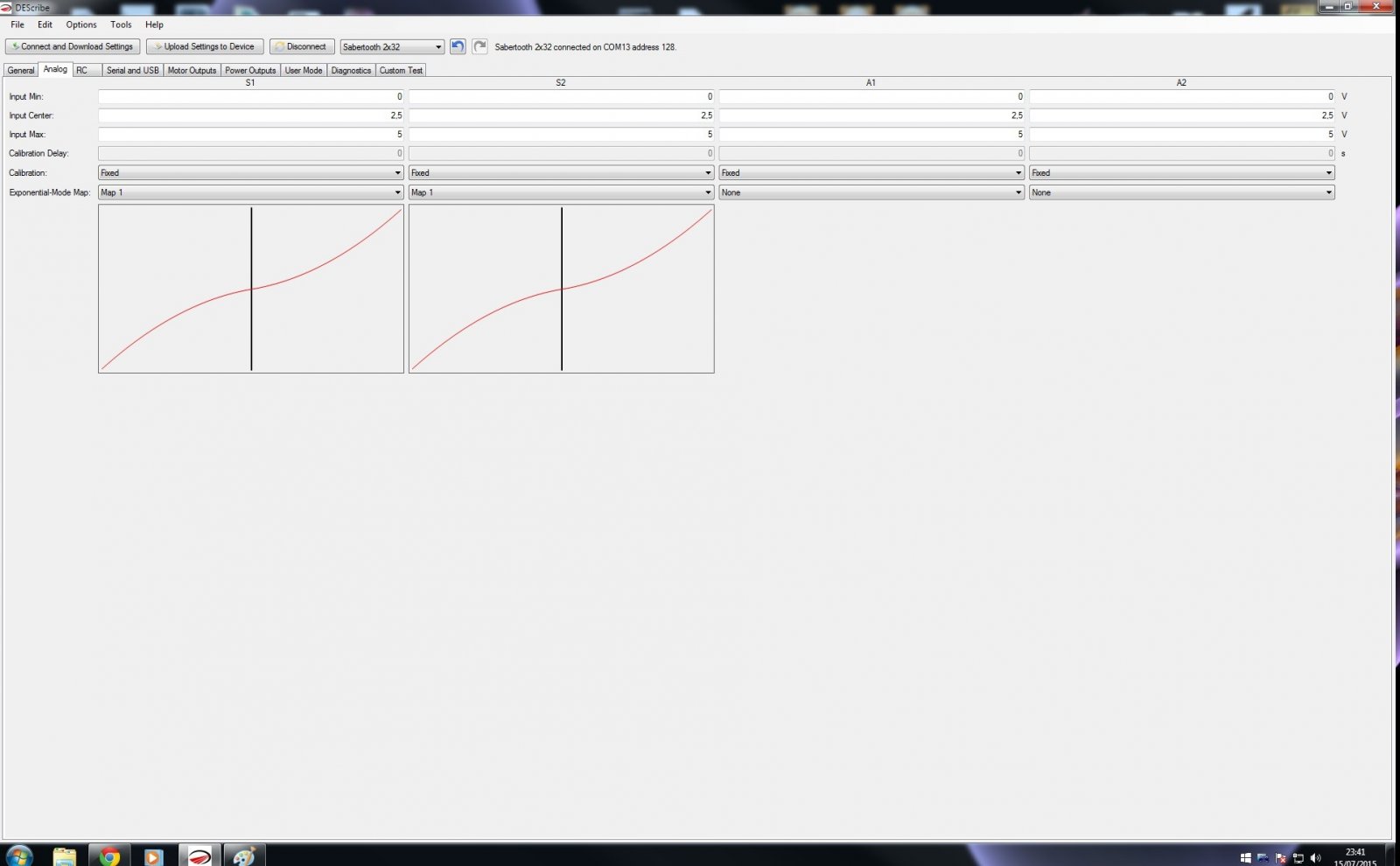

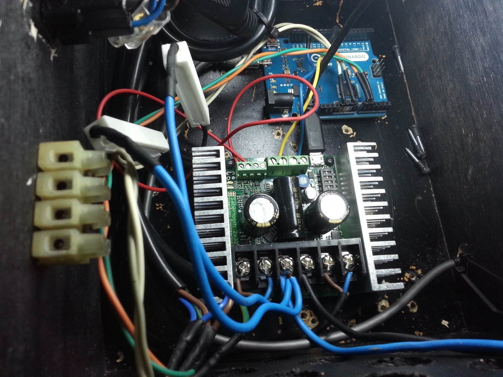

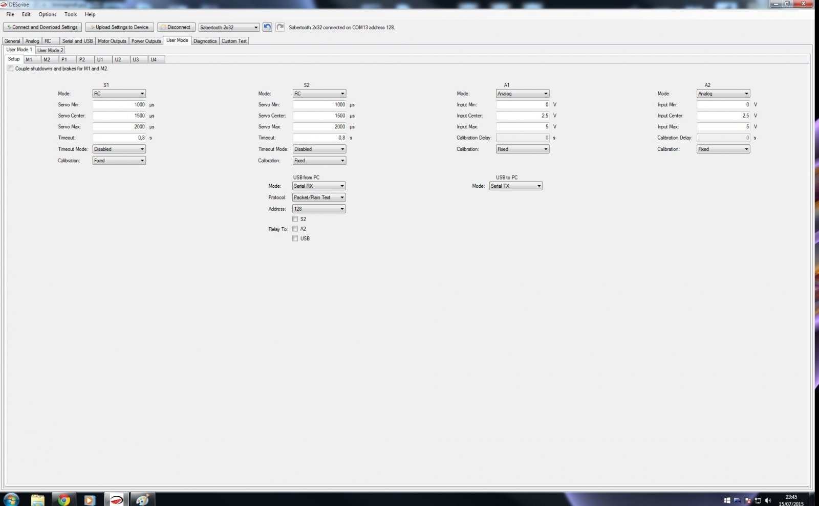

    Might be time for screenshots of the describe settings and pics of your set up so we can hopefully ID the issue.
  13. dualclick76
    dualclick76 Active Member
    Mar 23, 2015
    163
    italia
    11Coins
    +40 / 0 / -2
  14. dualclick76
    Mar 23, 2015
    163
    italia
    11Coins
    +40 / 0 / -2

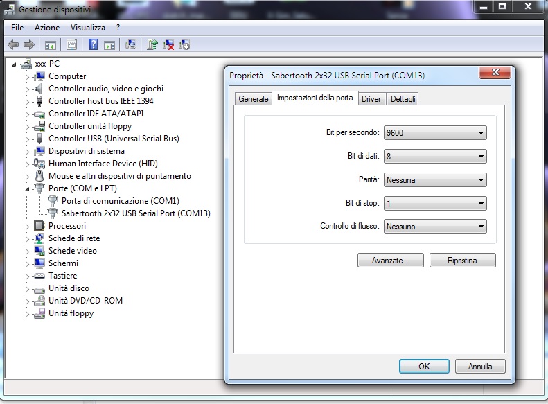

    These are the screenshots of about configuration of sabertooth
    1Immagine.jpg Immagine.jpg Immagine1.jpg Immagine2.jpg Immagine3.jpg Immagine4.jpg Immagine5.jpg Immagine6.jpg Immagine7.jpg Immagine8.jpg

    Arduino/sabertooth
    pin 8 / s1
    grd / 0v
  16. zigzag49
    zigzag49 Active Member
    May 27, 2014
    251
    723Coins
    +220 / 3 / -0
    Try to feed your potentiometer with 5v and 0v the sabertooth. In setting interface has com1 you, that's it for the Arduino to your device manager?
  17. BlazinH
    BlazinH Well-Known Member
    Oct 19, 2013
    2,145
    Oklahoma City, USA
    16,661Coins
    +1,839 / 32 / -1
    It looks like your 2x32 is set at 115200 baud already. Try setting your arduino to 115200 also using SWSerial.begin(115200); and put dip switch 5 in the off position on the 2x32.
  18. zigzag49
    May 27, 2014
    251
    723Coins
    +220 / 3 / -0
    You did well "upload settings to device" to send your configuration to the sabertooth?
  19. BlazinH
    Oct 19, 2013
    2,145
    Oklahoma City, USA
    16,661Coins
    +1,839 / 32 / -1
    Or did you connect and download settings? That is what I assumed.
