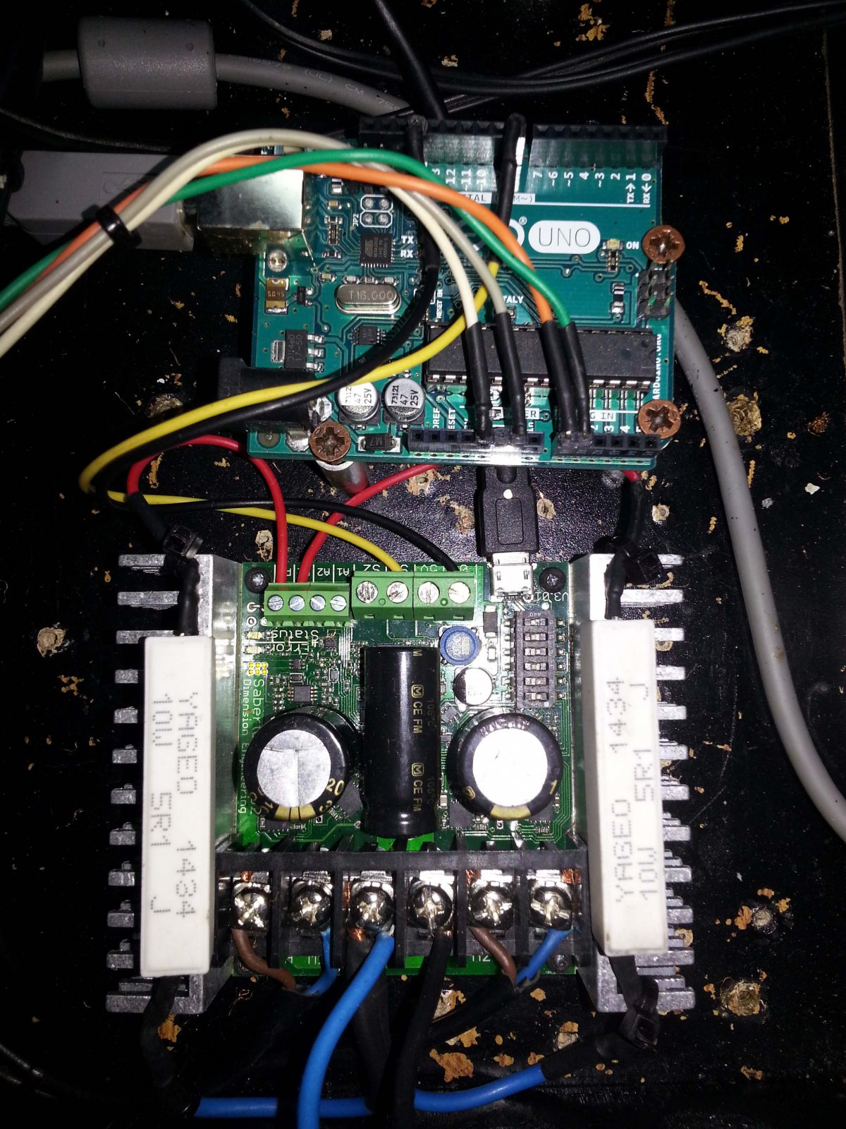

    Another problem, sim tools work only if the sabertooth is connected with USB. the sabertooth connects and disconnects from usb continuously.

    my dip switch is: 1 off 2off 3 on 4 off 5 on 6 on;

    code arduino :XPID_SimTools1_23

    describe the software load the file sabertooth 38400, going on to see real-time diagnostics crashes descrirbe

    You don't need to connect the Sabertooth with USB.
    You can try to invert the plugs on your motor which is heating.

    help help help
    guys i need your help do not abandon me. current situation sim seems to work, but it only works if the sabertooth is connected with USB.
    The sabertooth connects and disconnects constantly. Arduino code that works is XPID_SimTools1_23_2x32, the DIP switches are set as follows: 1 off; 2 off; 3 on; 4 on; 5 on; 6 on. DESCRIBE with the software I set the baud rate 115200 HELP HELP HELP HELP

    Set the baudrate at 38400!

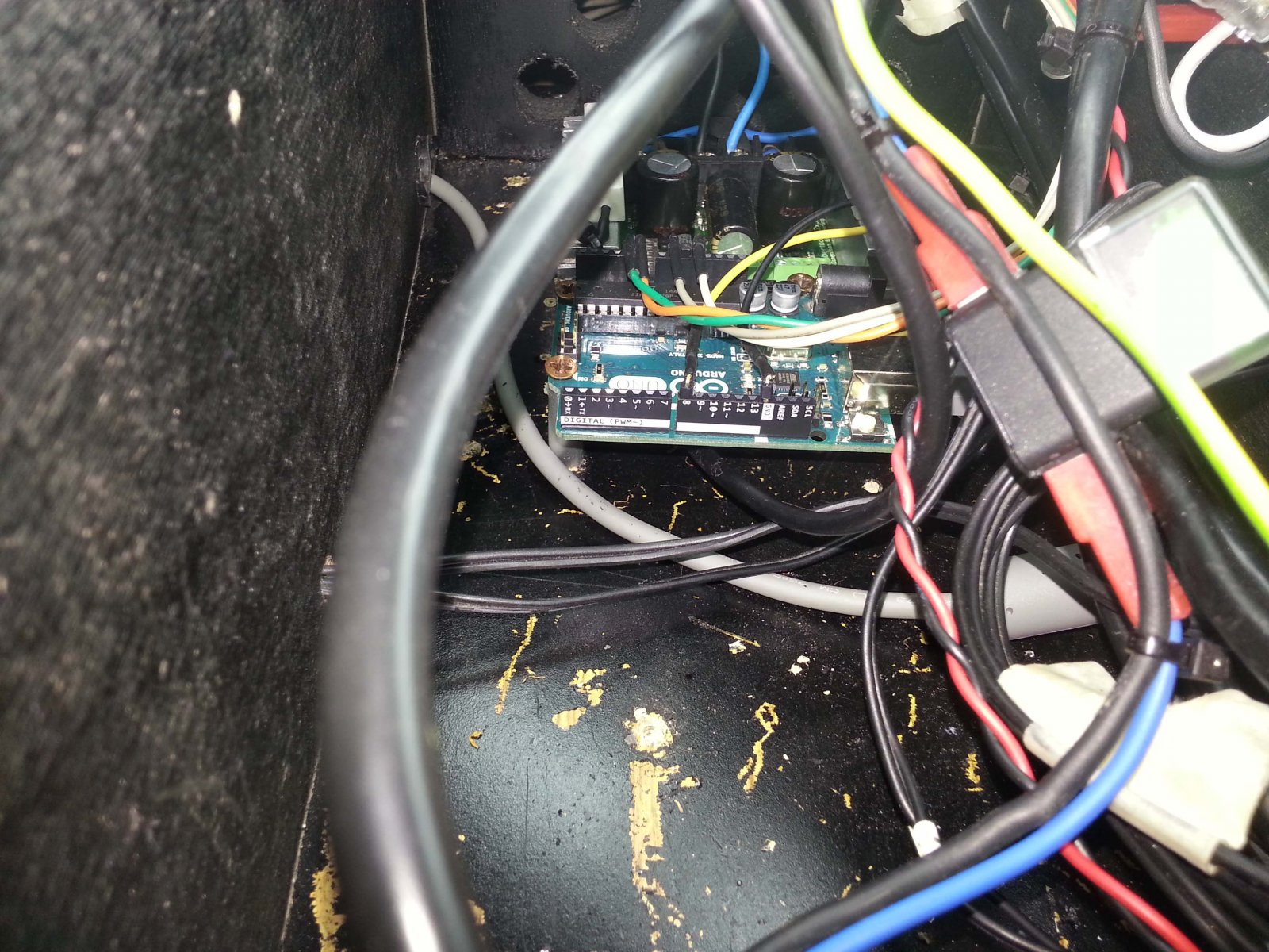

    boys I still need your help, I noticed that I turn on the simulator start simtools I press you turn on Arduino LED rx on; when I try roll or pitch or yaw, or any other dof Arduino by a small movement signal then turns off the LED rx therefore no other type of movement

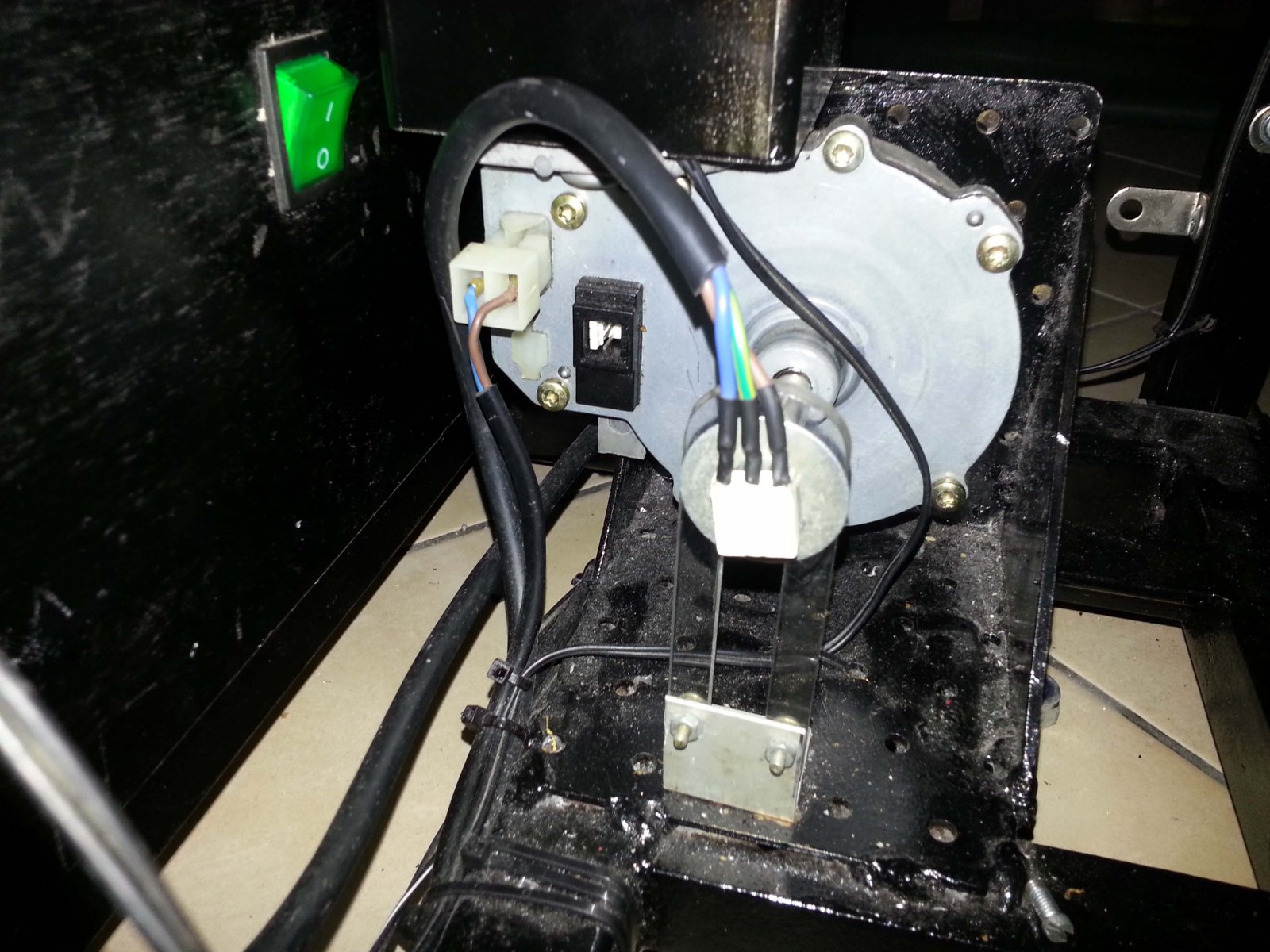

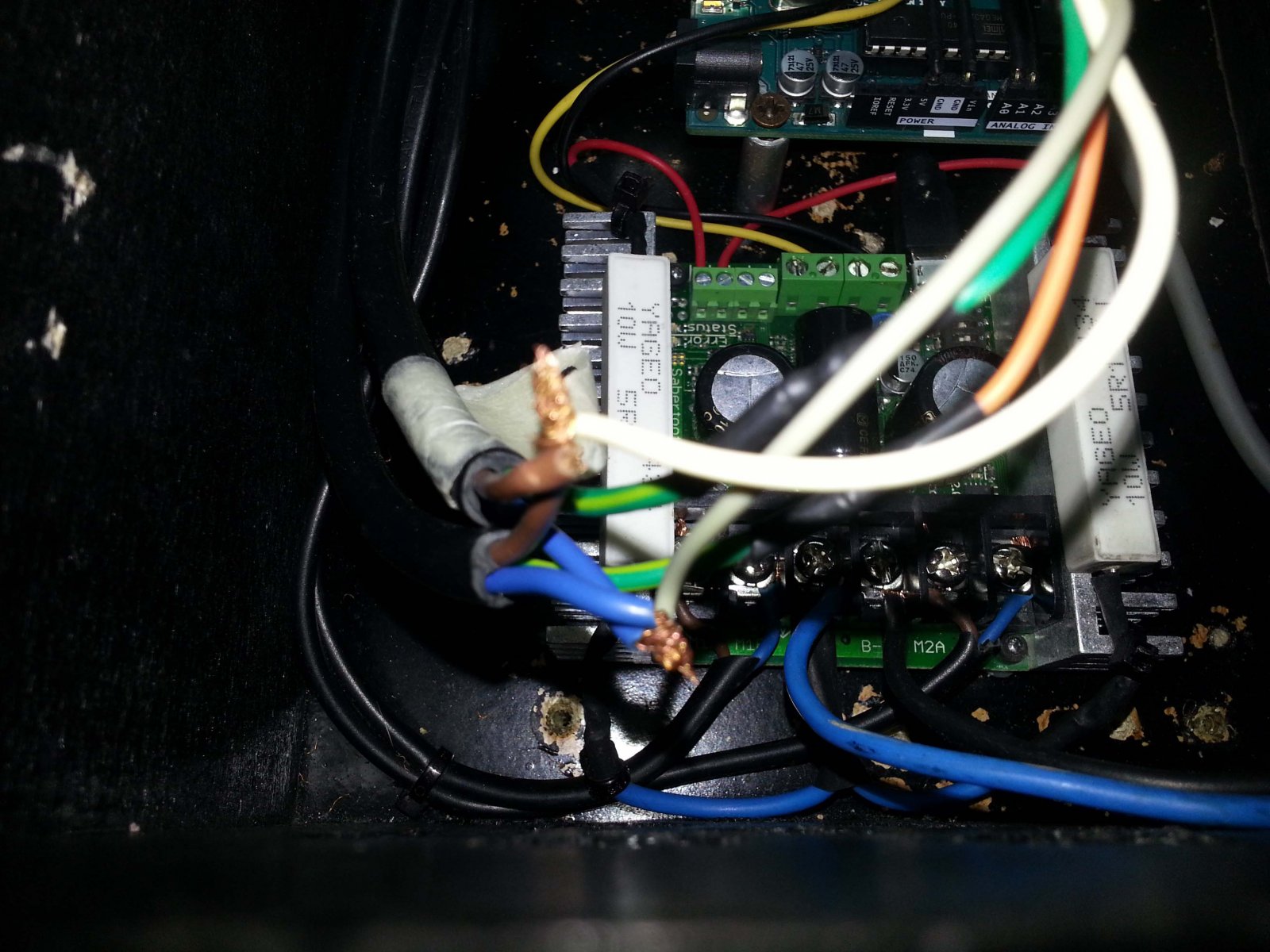

    UPDATE: I was able to isolate the problem but do not know how to solve. I try to explain; I have tried to cut the power to the motor 2, start the sim, start simtools works great. The moment also connect the engine 2 turns off the signal rx and Arduino stops rotating only in one direction of the potentiometer. help me please let

    i had the same issue, problem was a USB cable ! Too long, weak contact, i just replaced it with new one and problem is gone
