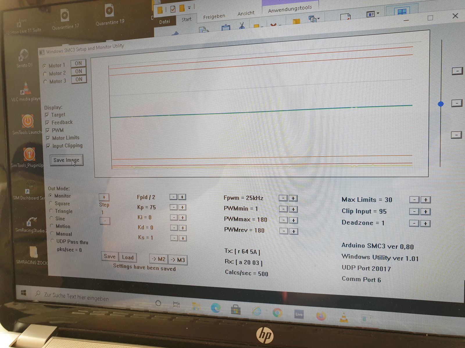

    Hello, maybe you could help me again in this wonderful forum.
    I have the exact same problem with my rig. What do I have to do to ground pin 8? Is there a wiring plan maybe?
    I have no connection to the rig if i only change the baudrate to 115200.
    The problem that the motors are crashing after a while is really annoying

    Thank you Noorbeast for your answer....i searched all topics with this problem and i tried different things.....i reduced kp in smc3 to 75...pwm max and pwm min to 180 ( also tried out down to 150 )
    Fpid in the moment is at 2....i tried out up to 4...
    I will make a foto later of my smc3 setup.
    In Simtools axis management i reduced to 80.
    And intensity i went down to 50.
    Sometimes i can ride 15 to 30 min, sometimes only 5 min til one of the motor crashes.
    Then I have to plug out the usb cable and start game engine new.
    The posts of mike and Blazin H were making me thinking about the baud changing
    In Smc3 i have no issues after putting the kp and the fpid down

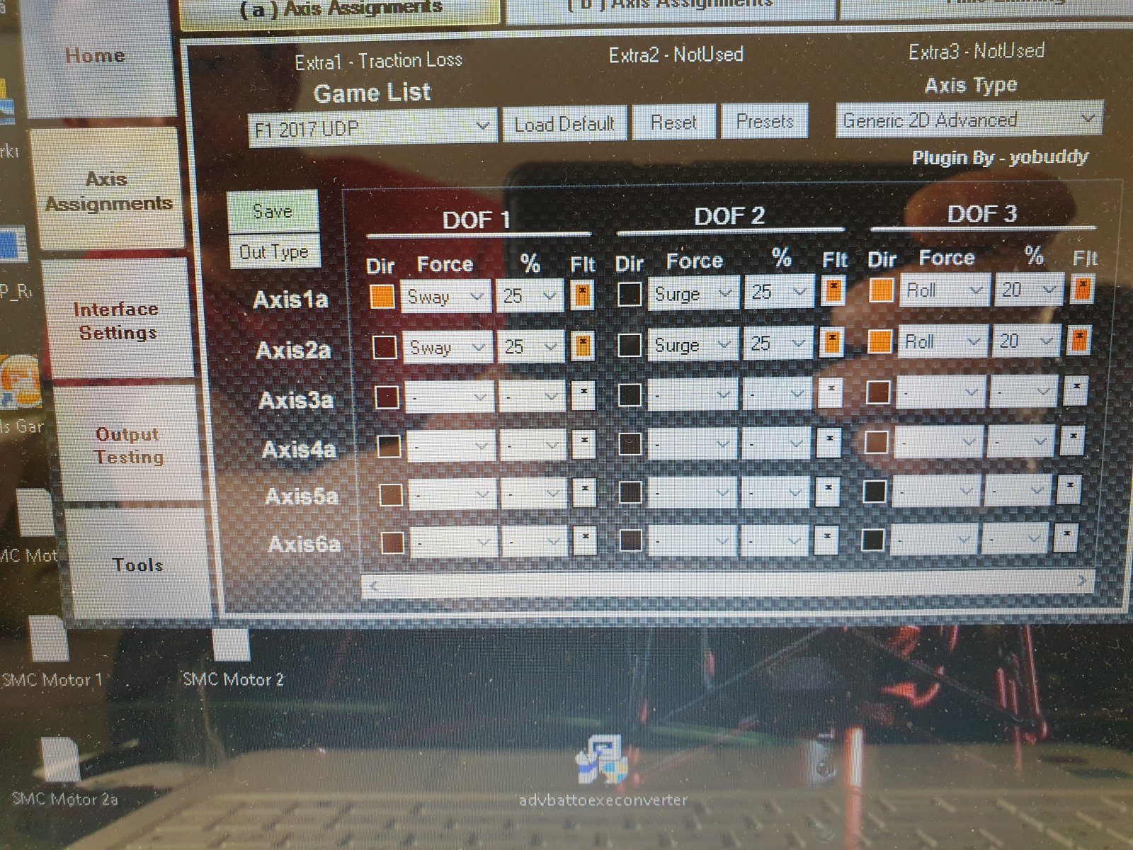

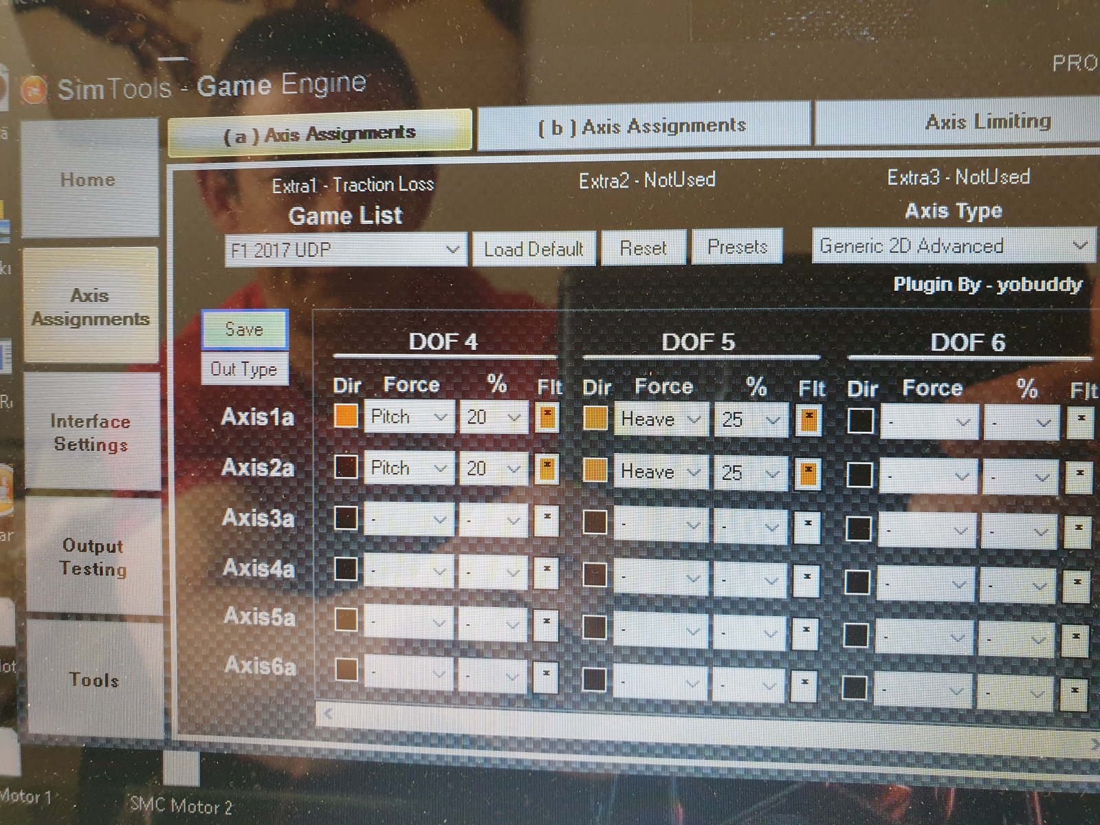

    Hello, i am back after studying the simtools manual again haha....i made some mistakes with the directions ( orange )
    After i corrected this i went to finetung.
    I had few tests since then with Forza 4 and F1 2020 playing on xbox.... no motor shaking, no problem. I hope it qill stay like this.....and I was motivated from this forum and made a windsim to my rig.

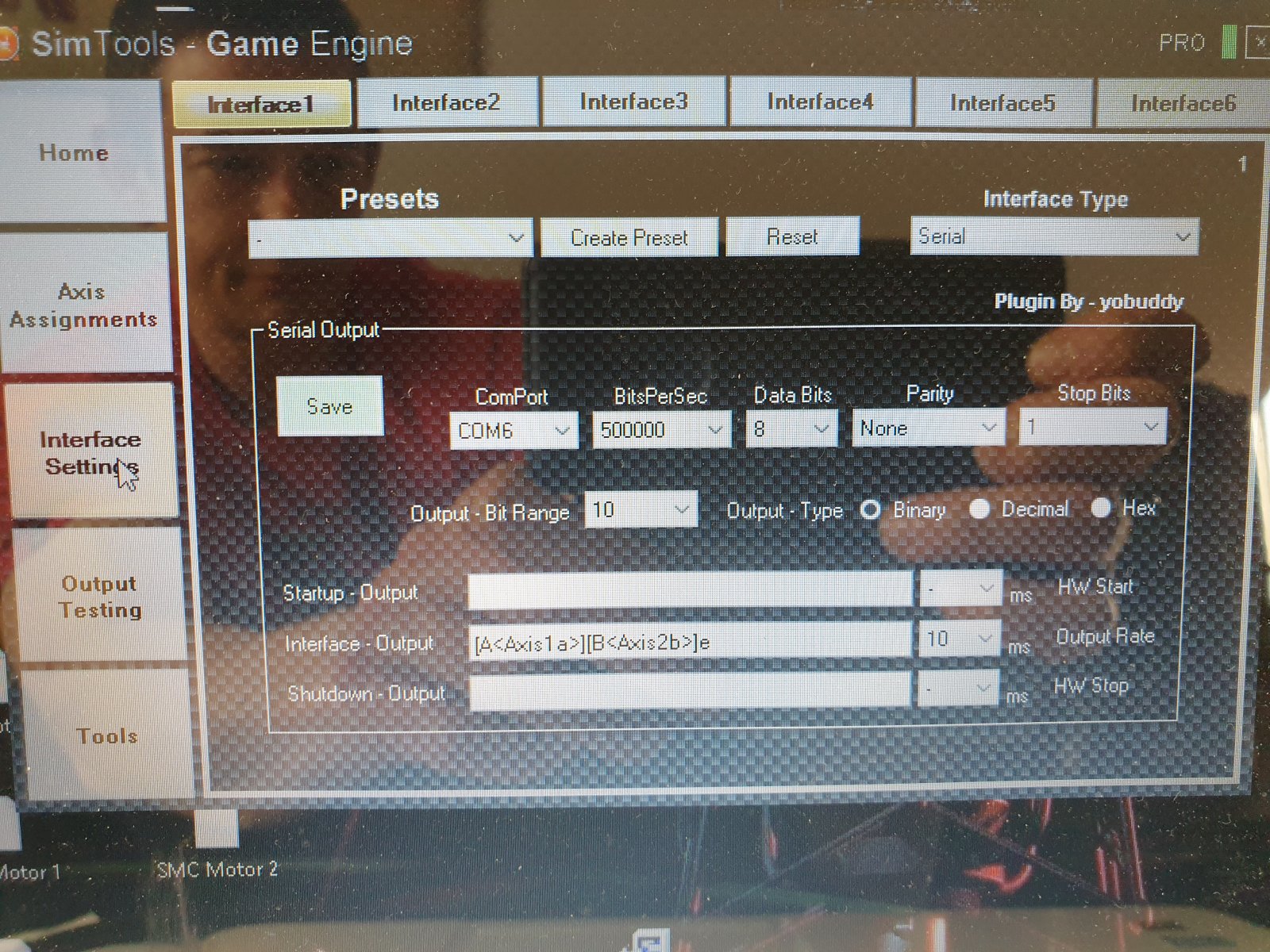

    That was the question I asked myself. I also thought about changing the baud rate, but I didn't know how.
    After a week and a few attempts it now works with the baud rate 500000 or the 40 ...... I went back to the settings of simtools and changed my wrong settings. It seems that this was the solution.
    Hopefully. I'll drive a little longer on Saturday and see if the system remains stable

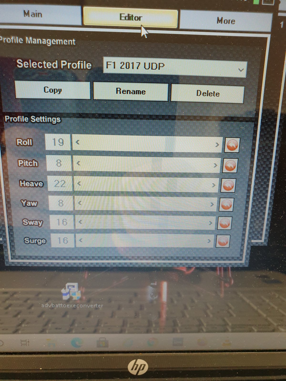

    Here are my default settings in the game engine.
    In the Game Manager Editor I fine-tune the number of desens.
    I've heard that this is correct and you may find it helpful
