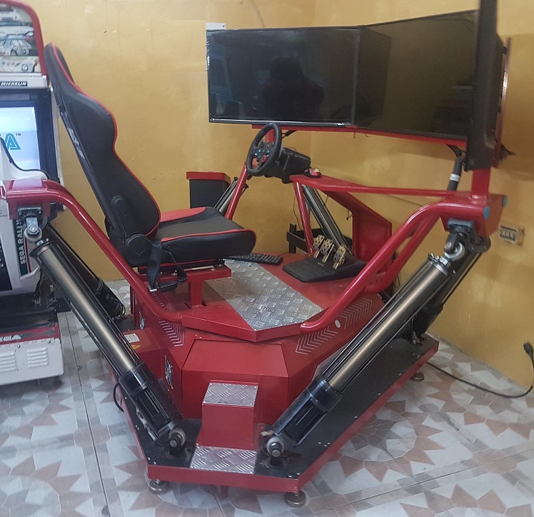

    Is there any progress with Vegafu and possibly connecting it to Simtools? If not, what is the current best practice to control Dorna M1 that is compatible with Simtools?
    I am considering buying a chinese 3DOF simulator with Vegafu and it's likely to have Dorna setup too.

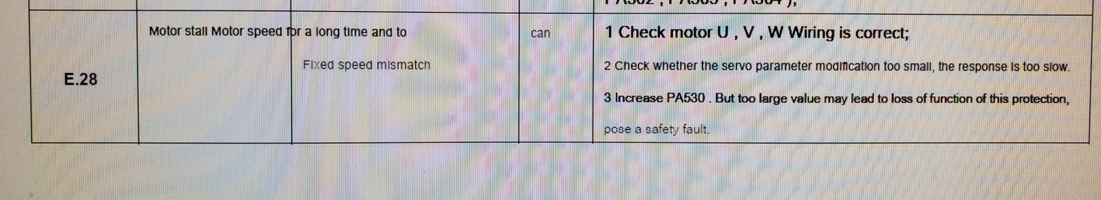

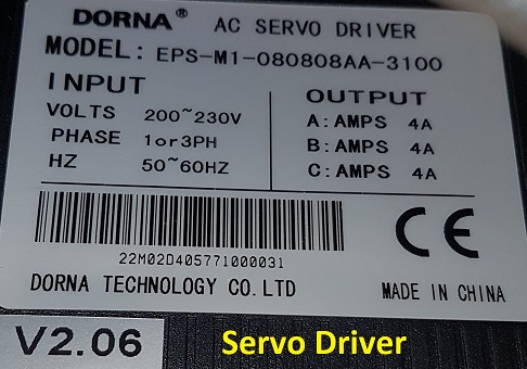

    Do you have documentation for the Dorna EPS M1 drive? I have a 6DOF using the same Vegafu controller and EPS servo driver. Already bought Thanos controller but I am getting an error on one of my driver ops. E28. Anyone?

    Looks like motor stall issue. See recommend actions:

    Also did you set the M1 parameters as in the github? Make sure the DB25 cables to 44pin, are also correct.
    https://github.com/tronicgr/AMC-AASD15A-Firmware/tree/master/DornaM1_interface

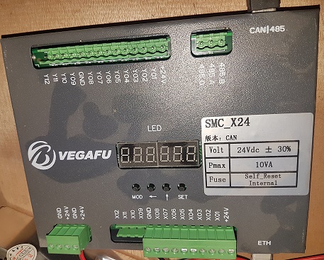

    I am working on the same project containing the same components as yours. I have assembled the hardware but cannot program the controller. I have a Vegafu SMC_X24 controller. Can I get your help programming it?

    Hello Ashraf. I am also working on the same controller, facing Err 1 in the controller. I need help in resolving the error. I also have the manual of this controller. I am sharing the manual here plz help me to resolve this error I have tried alot but failed to resolve this.
    - Manual is attached here
