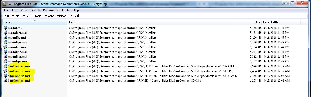

    Oh I wanted to add that I searched for all instances of simconnect.msi under the steam fsx folder. Found the four discussed. I even tried uninstalling them all and install each one, one at a time and rebooting in between. I was thinking it may be looking for one specific version of simconnect. No result so I installed them all again. Silly question but wouldn't the last one installed be the one that is 'seen' by other programs trying to use simconnect?
    After installing each one, all four have the option to uninstall. Quite confusing this simconnect business. :confused:

    I have installed FSX (Steam Edition), pathced the game with Microsoft Flight Simulator X Plugin 3.0.1.1 and I have run and installed the simconnect msi files (that are in the "FSX\SDK\Core Utilities Kit\SimConnect SDK\LegacyInterfaces" folder) and finally I also checked the presence of the SimTools_GameManager.exe.config file into the program directory of SimTools... but equally GameManager crashes after the game start and there are no movements!
    P.S.: in my system is present Microsoft.NET Framework 4.5.2

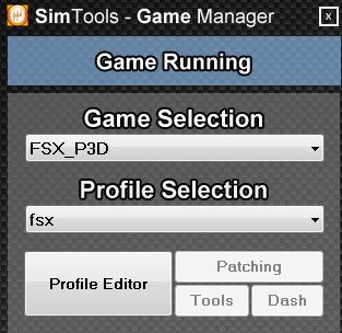

    Hey so some 'progress'... after installing to c: drive now Manager won't connect to FSX_P3D. No matter what order I start Engine/Manager, Manager always says 'Connected' to Ansetto Corsa (the first plugin in my list) and doesn't change when I run FSX_SE..

    Did you reinstall the plugin?

    Nope.. forgot to re-install after the new install. hey it was late :oops: Manager sees it but still same same as last time. no values in Tuning Center..
    I'm in the process of installing the box version to see if if that will work. Just have to find my old DVD burner Lol
    Will report back... cheers!
