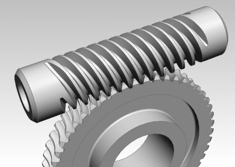

    With a bigger pulley you need a longer belt to normaly, or shorten actuator stroke.
    With a shorter stroke he needs different gear math to.
    I adviced him a i=10 reduction to keep cost down and keep it simple
    Sorry for te bad english
    Regards Ad

    Not compleetly
    I did the math with youre motor in it
    Youre 10 turn pot will make 500rpm @ topspeed
    And this is the pot max shaft speed to (see tech spec sheet)
    I hope it last long!

    My motor probably running at around 90% top speed so I think it should be fine. I will get one and try

    This is made on rated speed.
    A belt needs tension, when this tension come on pot shaft its give a shorter lifetime.
    Try to take tension from potshaft with a second bearingblock upon pulley for example!

    I know you’re trying out the 10 turn halls @SilentChill but to answer this from your first post,
    , I wonder if you could modify this 200:1 plastic gearbox by removing the motor and make them work with yours and a 1 turn hall pot somehow? They're only $5.75 each too.
    https://www.pololu.com/product/1120
