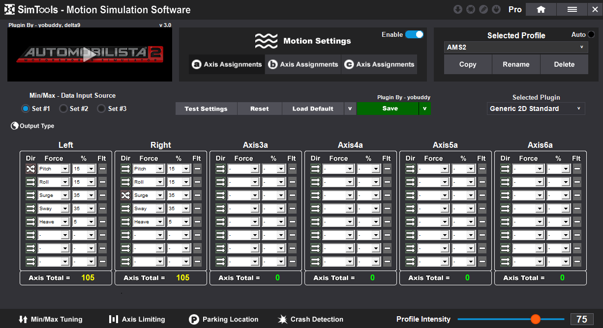

    In case anyone has the same motion I´ll share my settings I´m pretty happy with.

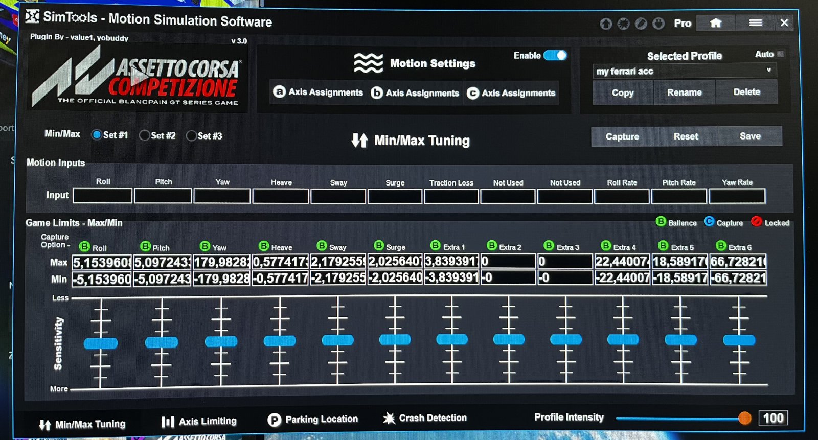

    Hi Bro got my Compact-R for about a half year too. But I got some probs, it feels like there iss a lil bit too much motion going on. Even when I use the remote of my njMotion Seatmover (there are 3 diometers, one for the short motions, one for long motions, and one for the overall motion) and set the overall motion to some low settings, it feels like I feel to much street/ground effects. For example, when I drive a normal straight road without any holes or rocks on the ground, it feels like there is always a lil bit motion. Is that normal or did I set something wrong? I attached my settings for you maybe you can help, thanks and have a nice Day
    PS.

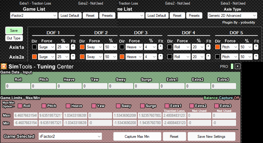

    The guys on xsimulator.net told me to capture then refine the Tuning Center values, but I cant find any good video tutorial for doing that. Here is an example of my standard settings that I use for my racingGames...

    Hey there, I sometimes felt the same thing. Even if I have read the manuals about simtools I don´t have enough understanding on the software, so if I say something wrong or stupid please anyone with knowledge correct me.
    As far as I know, it has to do with the middle rotary of the Motion, the one that controls fast movements. It shouldn´t go above 75%. The other two rotaries didn´t have impact on the issue.
    As for the Max Min, I think the smaller the ranges the more sensitive the motion gets, so it may be some value to be too small. Here´s my current setting for them:
    I think probably it is the pitch, roll and/or heave value the one that gives you that issue.
    Hope that helps.

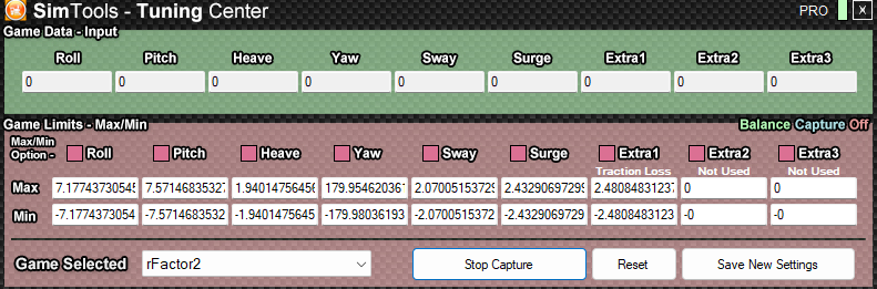

    Edit: The how to capture max/min can be found here, though it is for the older version of the software it sure is very similar to the one you have:
    https://www.xsimulator.net/tuning-centre/

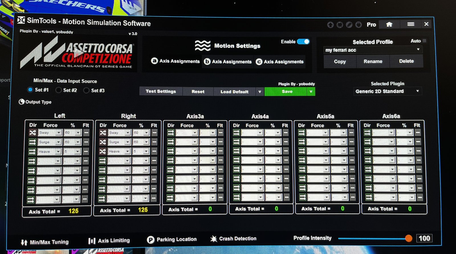

    Hey, here all my settings in SimTools:

    Many thanks for your Feedback. I have checked all this and also adjusted the Heave while in game to higher values. 10/20/50/100… I was also hoping to get the road bumps smother with that but no change :/

    As per the links to previous advice just do one axis at a time, in this case heave, disable the others temporarily.

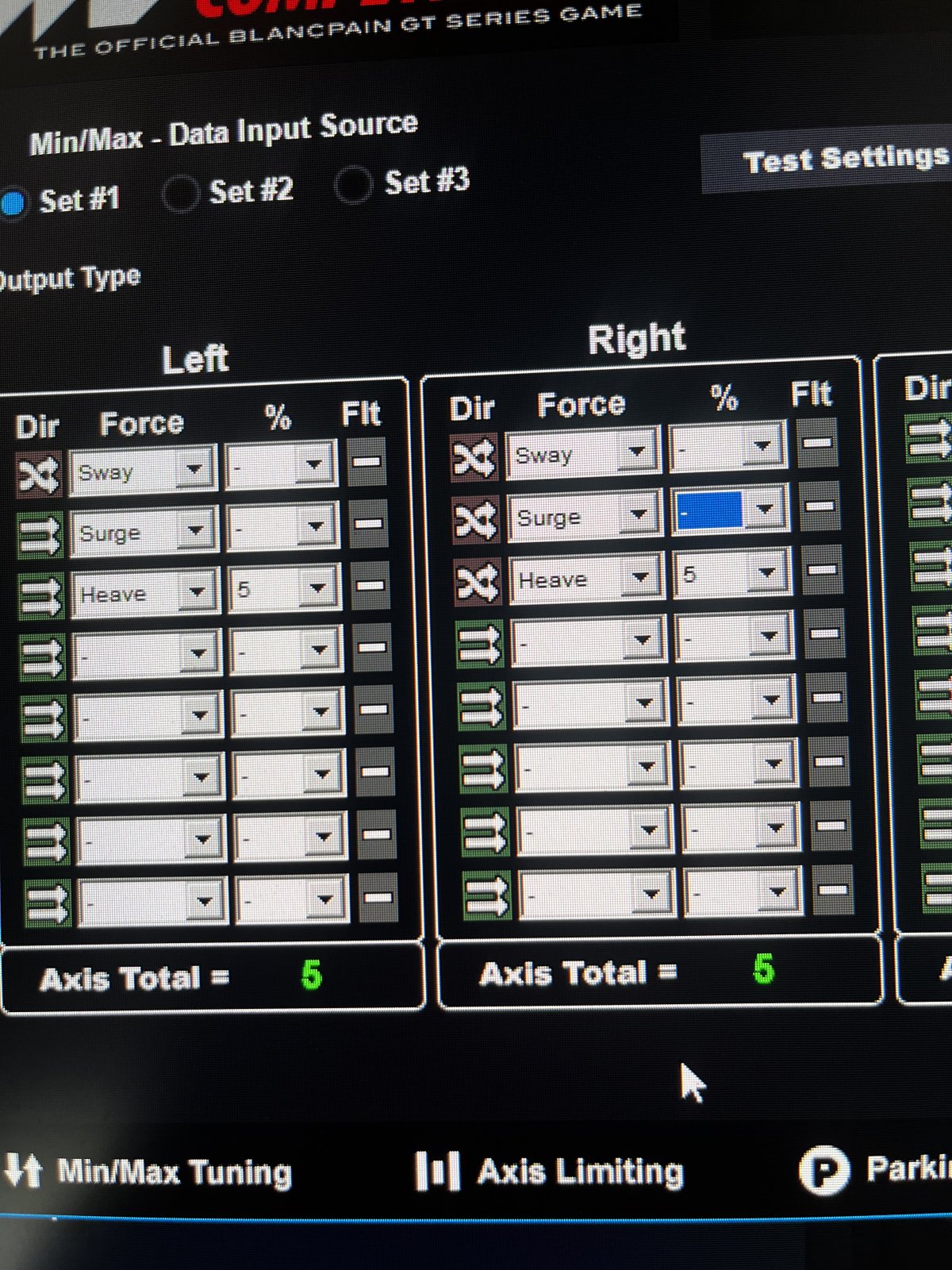

    Ok will try it again. So for example like this?

    Yes, tune one axis at a time, then combine and refine them.
