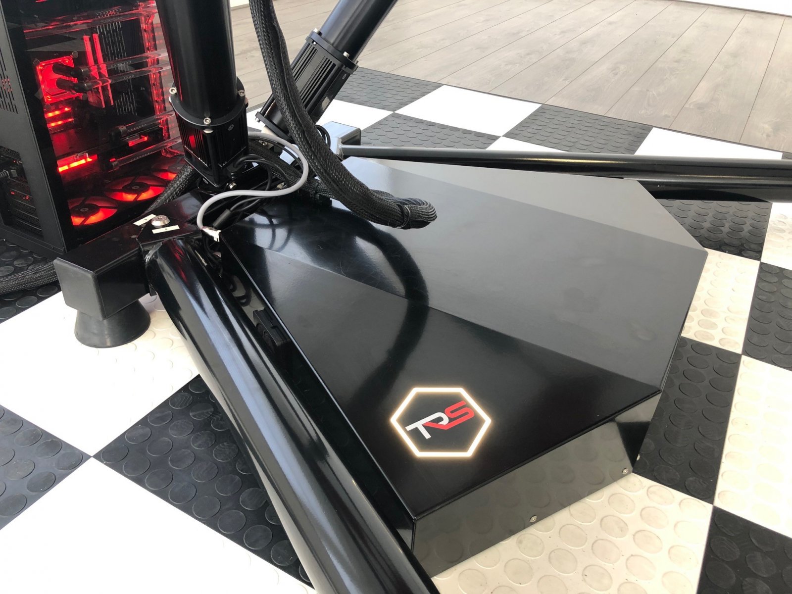

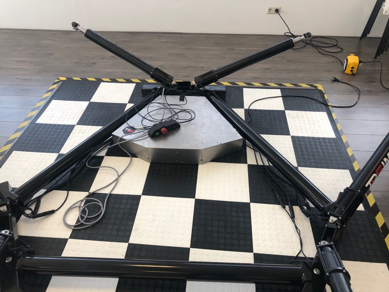

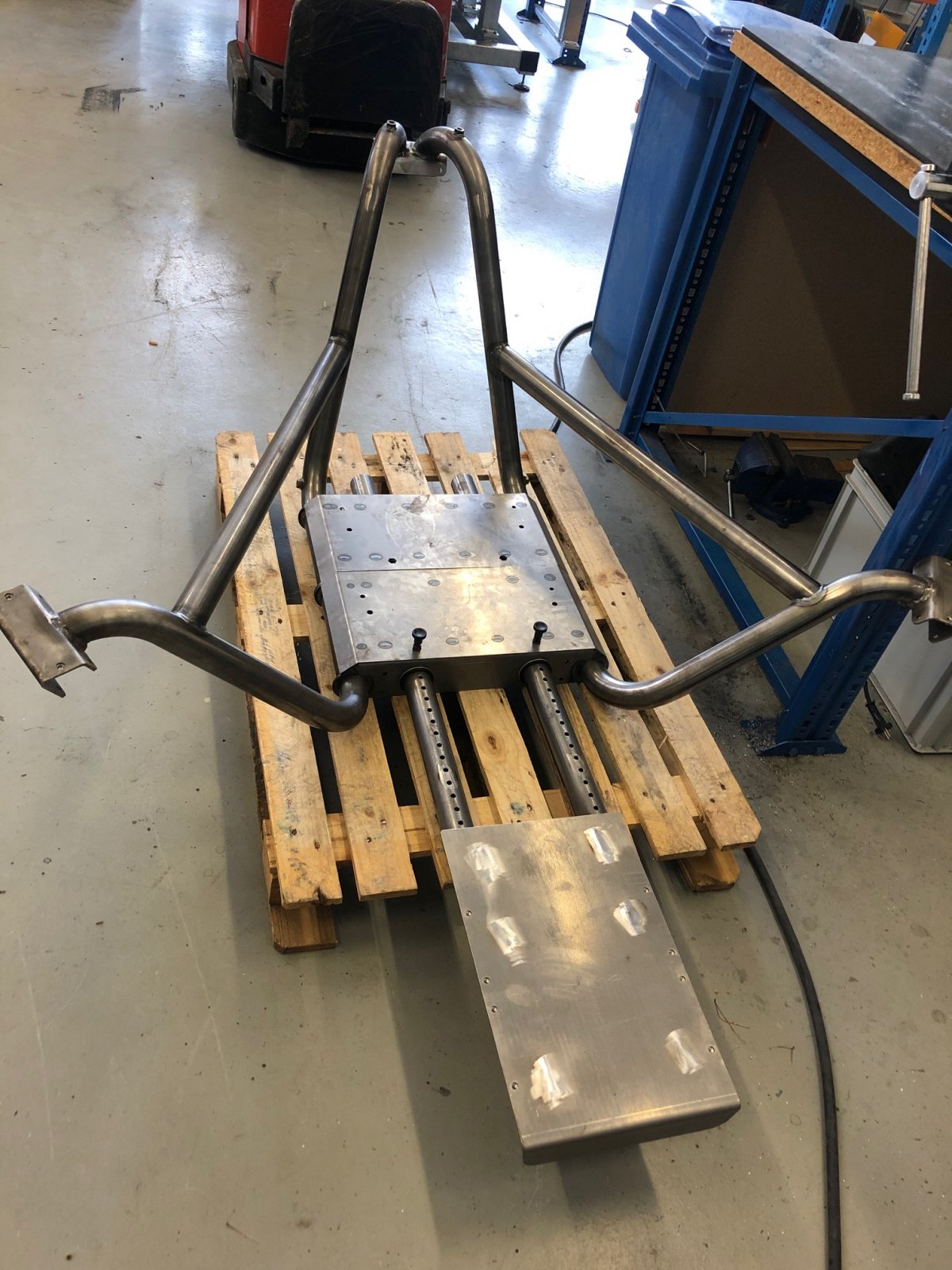

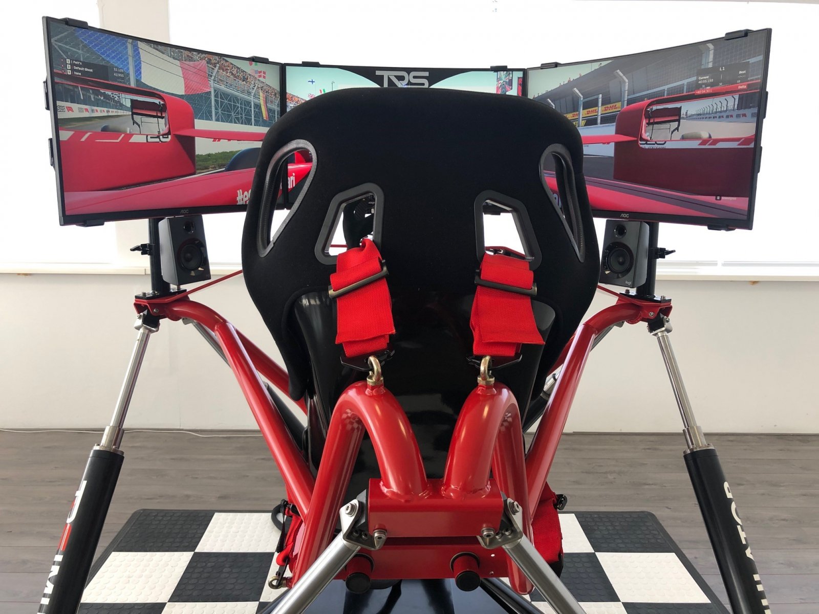

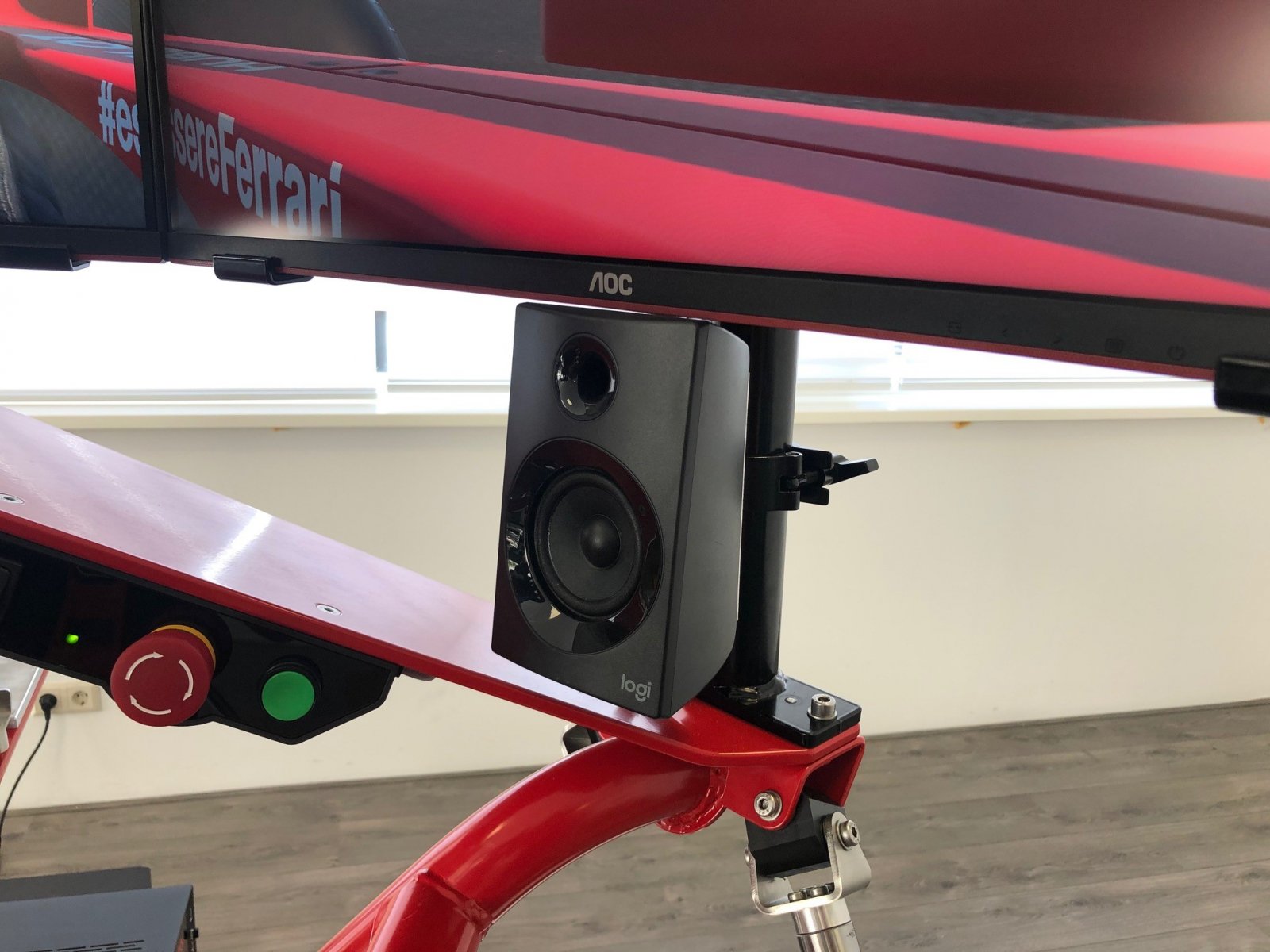

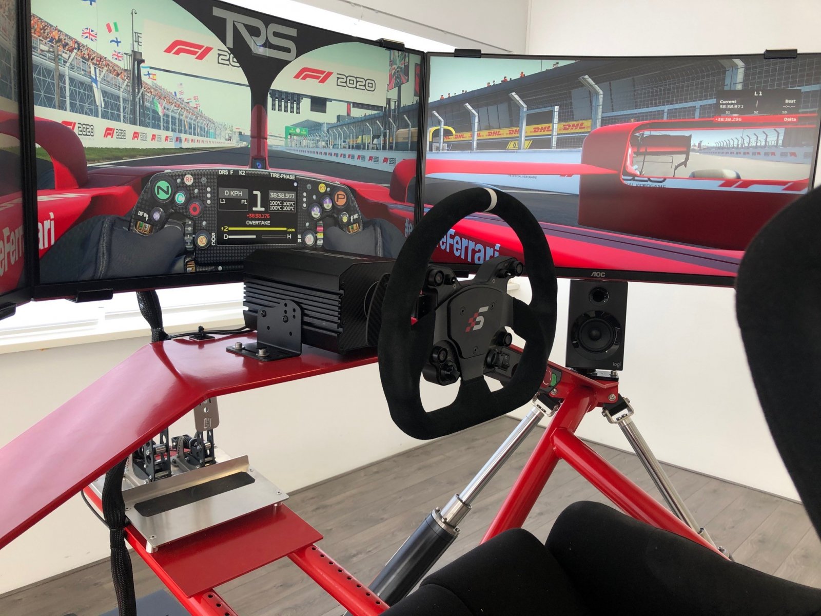

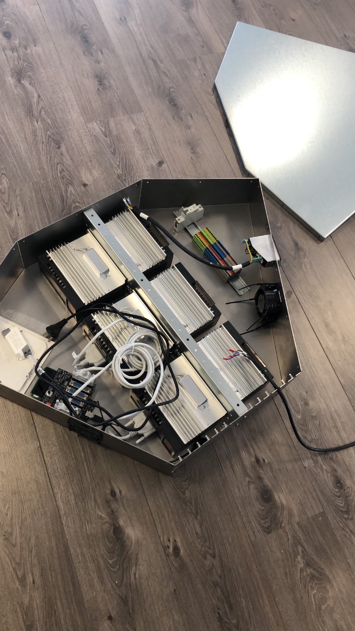

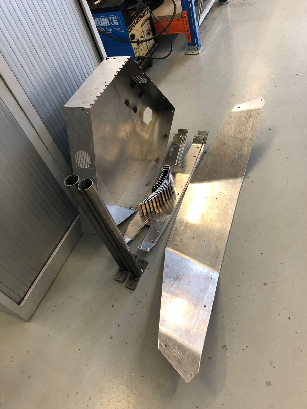

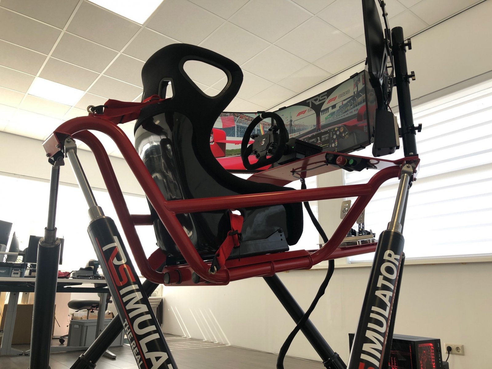

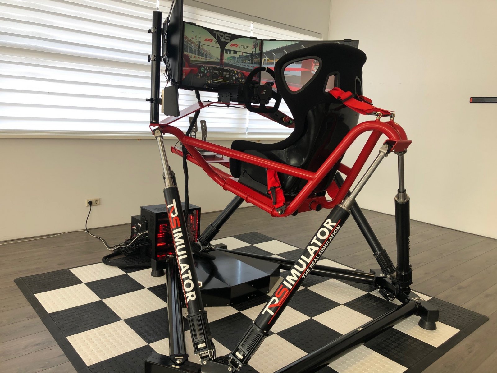

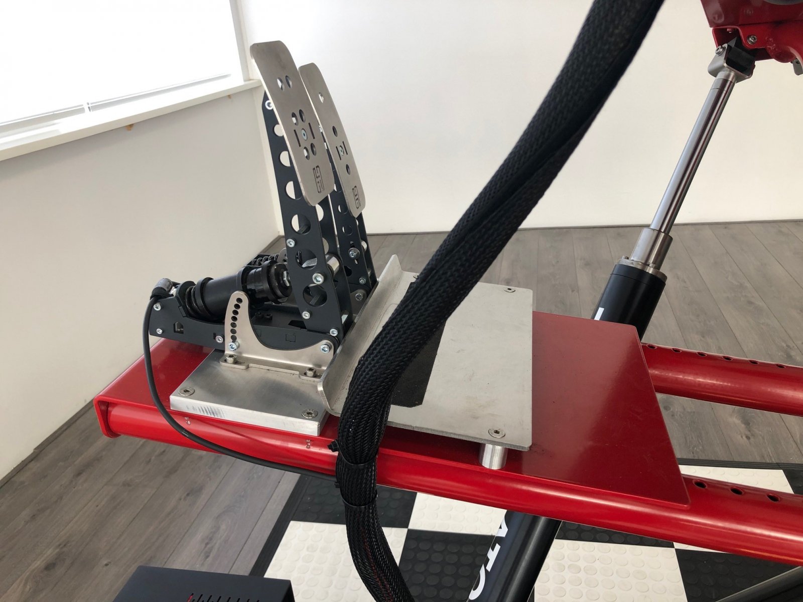

    ah yes, so busy I forgot to keep you all in the loop, sorry for that!

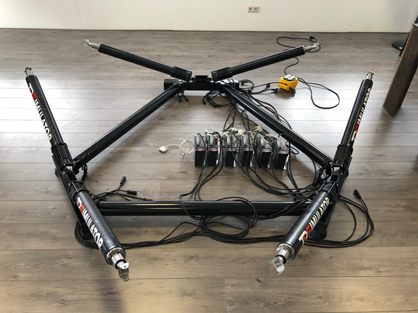

    • We finished the frame with adjustable footrest "ferrary style".
    • Made a control box to contain the VFD drives and thanos. (for those who are paying attention: VFD drives will be mounted with the cooling fins up so picture is wrong)

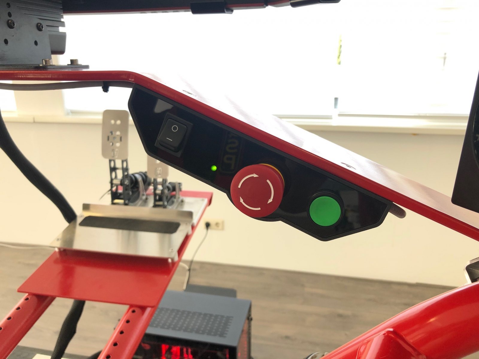

    • Made a button box for park, on/offline and emergency switch
    • Put the whole thing on a checkered flag floor
    • Finished screen mounts and control interfaces
    Sending it out now to the powercoat factory, in a couple of weeks it should be finished!
    thumbnail_IMG_3256.jpg thumbnail_85852946-30A2-42C3-BDED-276E0A1E9767.jpg IMG_3421.jpg IMG_3420.jpg

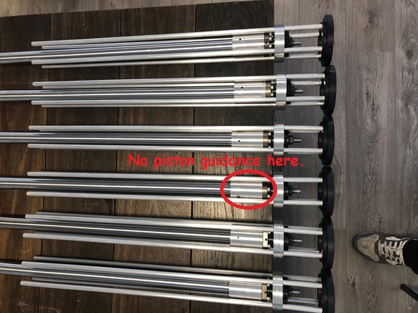

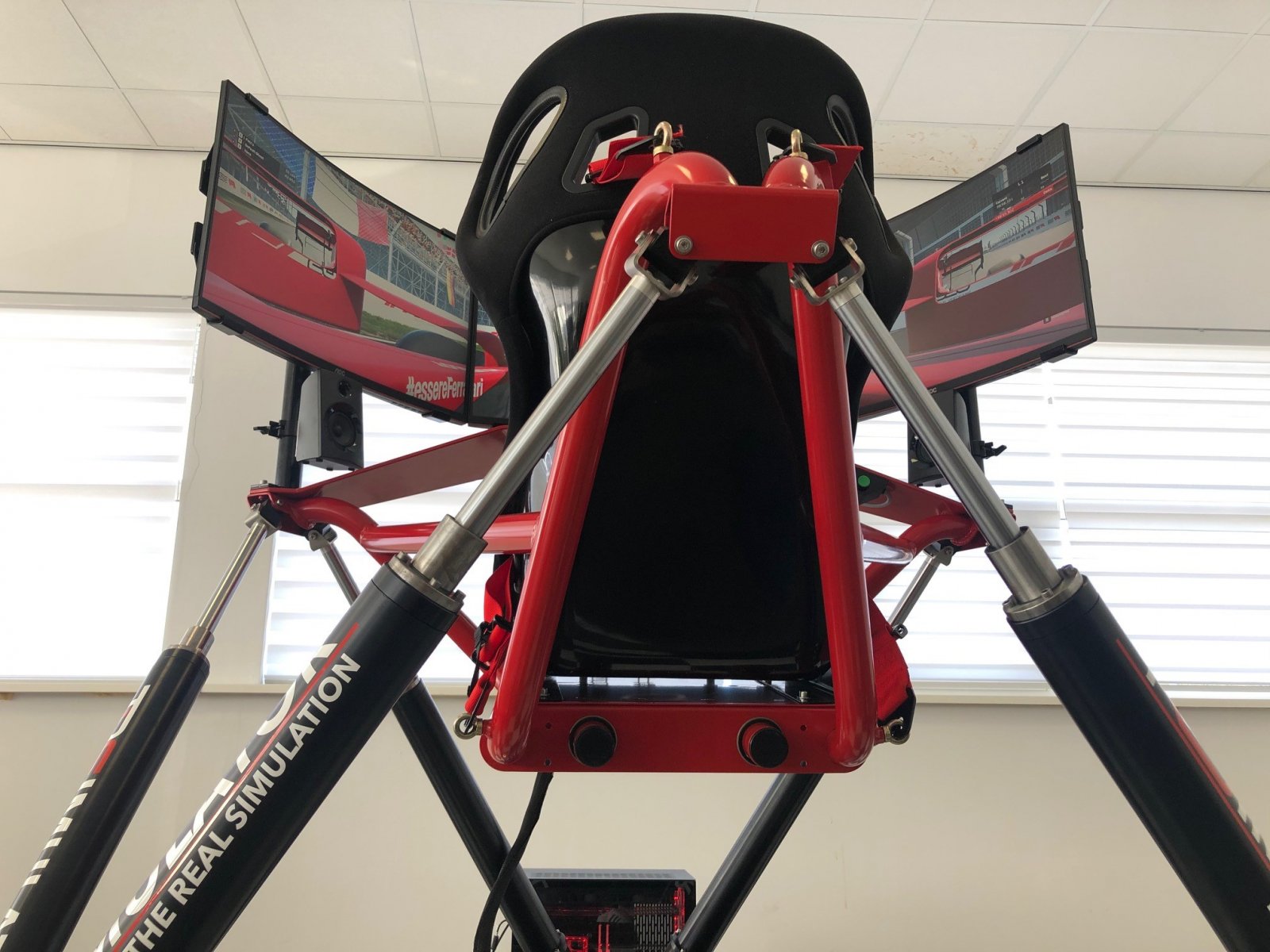

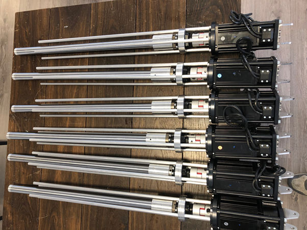

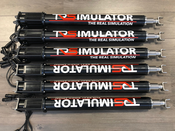

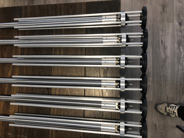

    I have a question on one detail of the conception of your linear actuator. I can observe that you don't use slide rode to fix the piston rotation due to the fact that you use u-joint at the bottom and the top of the actuator. So, the piston can rotate if needed . However, i don't understand why the lower part of the piston next to the nut is not guided ? Is there no risk of vibration at high speed ? Wouldn't the guide also improve the positioning of the piston?
  10. Petertje
    Petertje “Engineering changes the world.” —Isaac Asimov
    May 7, 2020
    57
    Mechanical engineer / battery specialist
    The Netherlands
    447Coins
    +96 / 0 / -0
    Indeed I dont need to lock against rotation: the u-joints lock the position. Ans since no switches or string pots are used the position doesnt matter/
    When using linear bearings the play is minimal. The piston (rod) is thick walled hardened steel. Not much movement there. There is no noticeable vibration.
    Furthermore, when the rod is extended, that bearing wouldnt be in contact anymore anyway.

    "Furthermore, when the rod is extended, that bearing wouldnt be in contact anymore anyway."
    What do you mean ?
    Usually, the piston is guide on two points :
    1-At the upper part of the actuator (Linear bearing or self-lubricated ring )
    2-The lower part of the piston ( Not exist for you ) --> and that's what caught my curiosity... :)
    But saw your video, it seems to work very well, with this particular conception :thumbs
  12. Petertje
    May 7, 2020
    57
    The Netherlands
    447Coins
    +96 / 0 / -0
    i'm not sure what you mean. Can you post a sketch of how its should be according to you?
  13. Will974
    Will974 Active Member
    Jan 11, 2020
    134
    Industrial Ingeenering Teacher
    Reunion Island
    965Coins
    +141 / 1 / -0

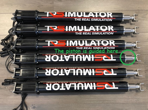

    Look at photos attached. The piston is guided only at one place. Usually the piston is guided in two places at the same time unlike the fact that rotation is fixed by the two u-joint but not you. Can you explain me your decision to choose to not guide the piston at this place please ? Are you sure that there won't be problem when the rig will be loading ?
  14. Petertje
    May 7, 2020
    57
    The Netherlands
    447Coins
    +96 / 0 / -0
    Ah I see what you mean. I'm using a long linear ball guiding on a hardened axle with very little play. Works perfectly: no sideways movement and/or vibration is present.

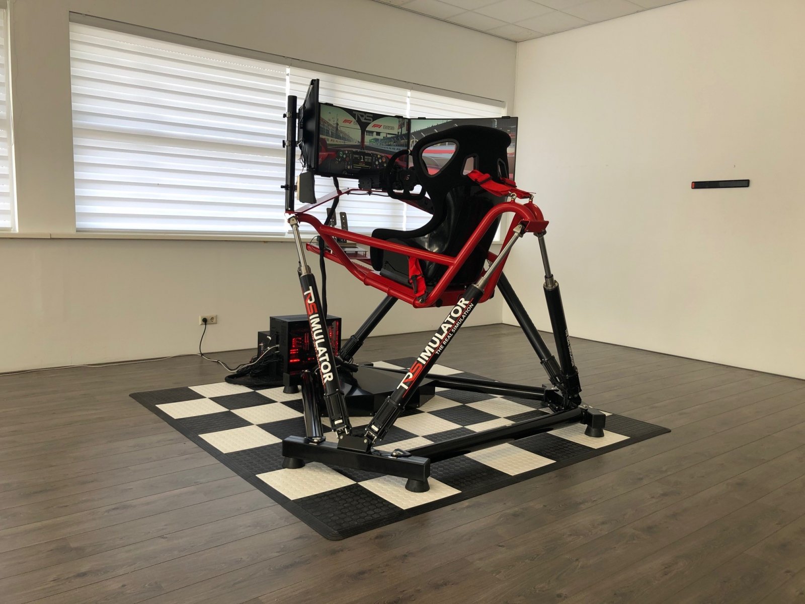

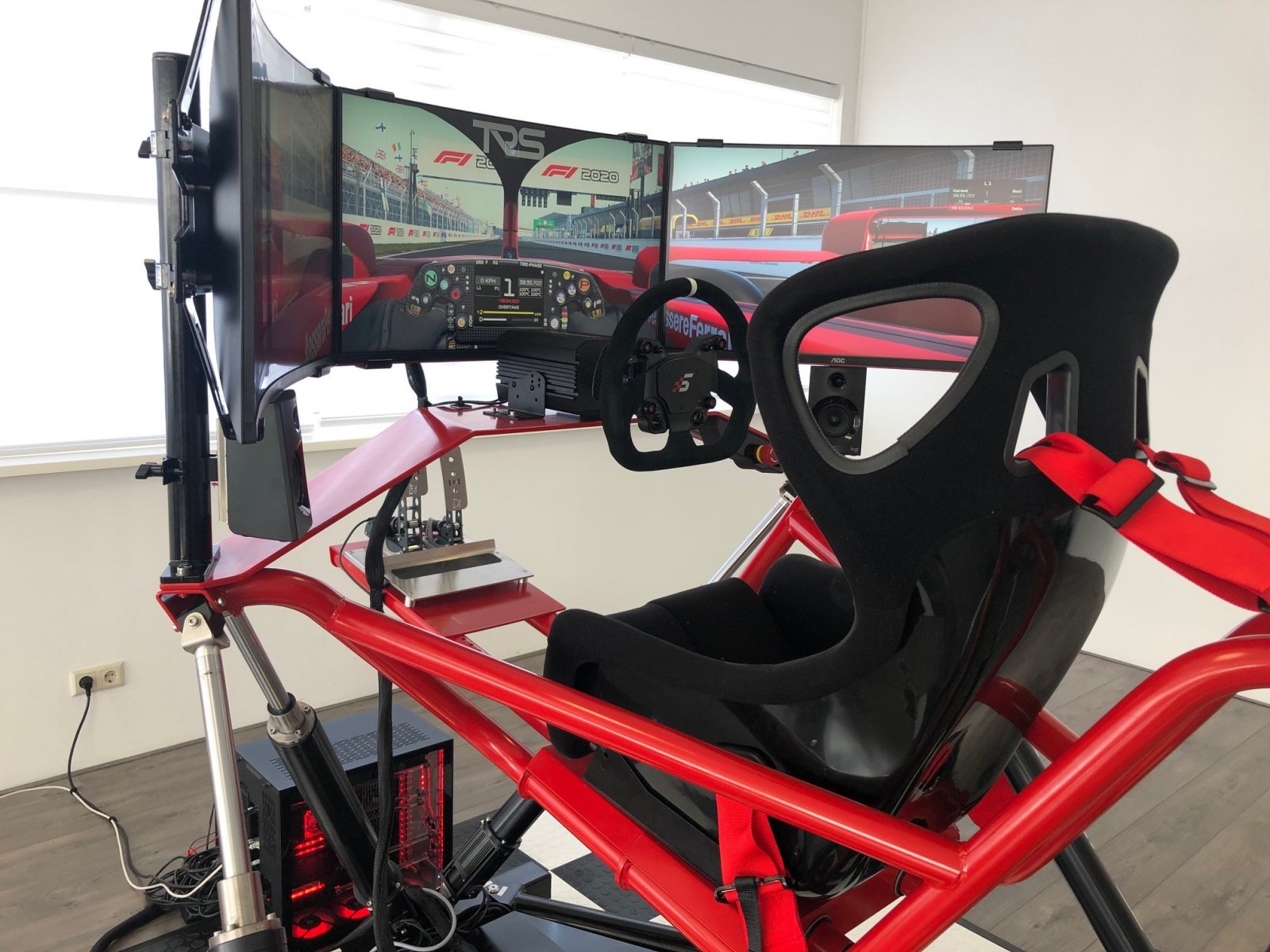

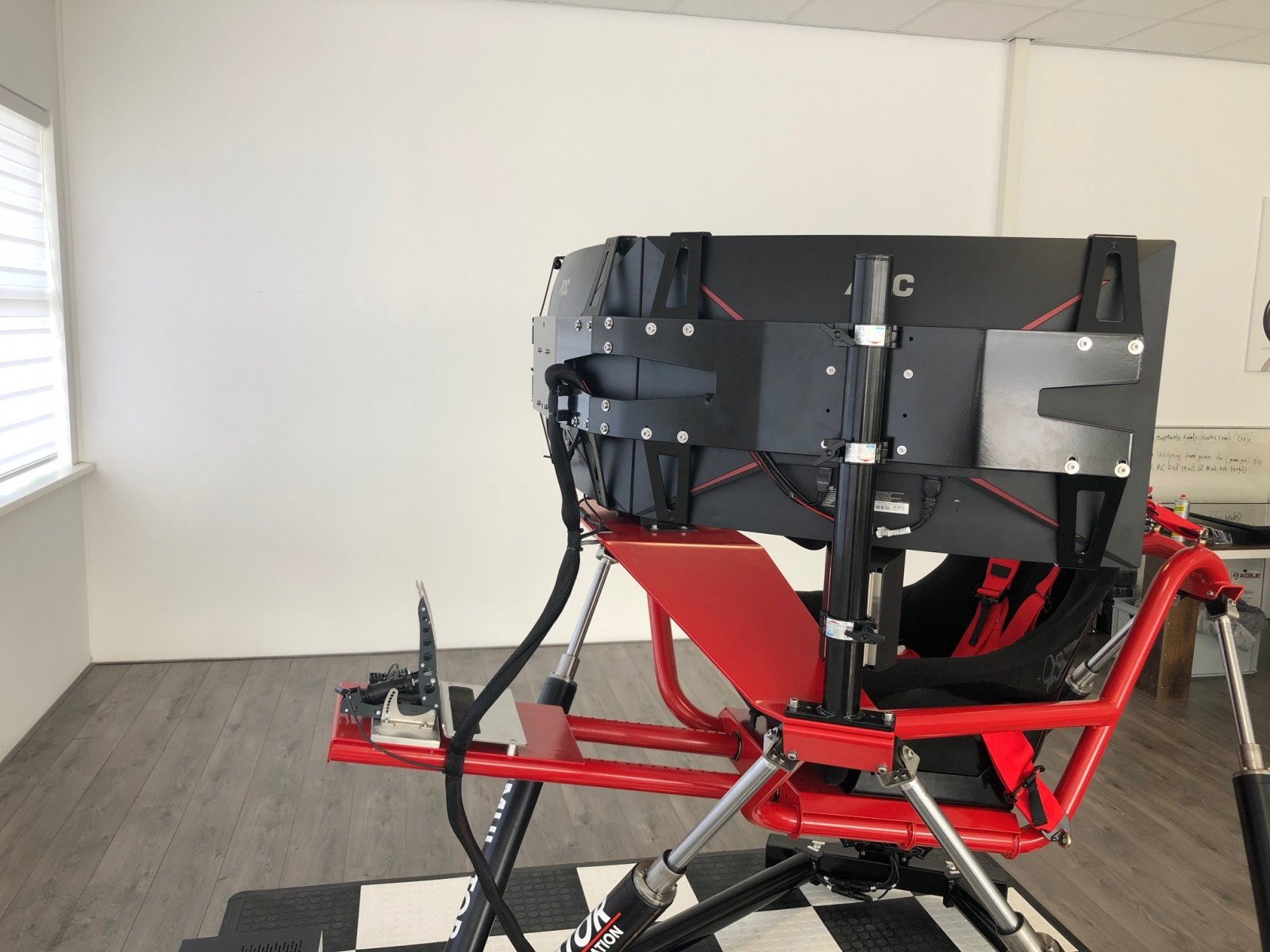

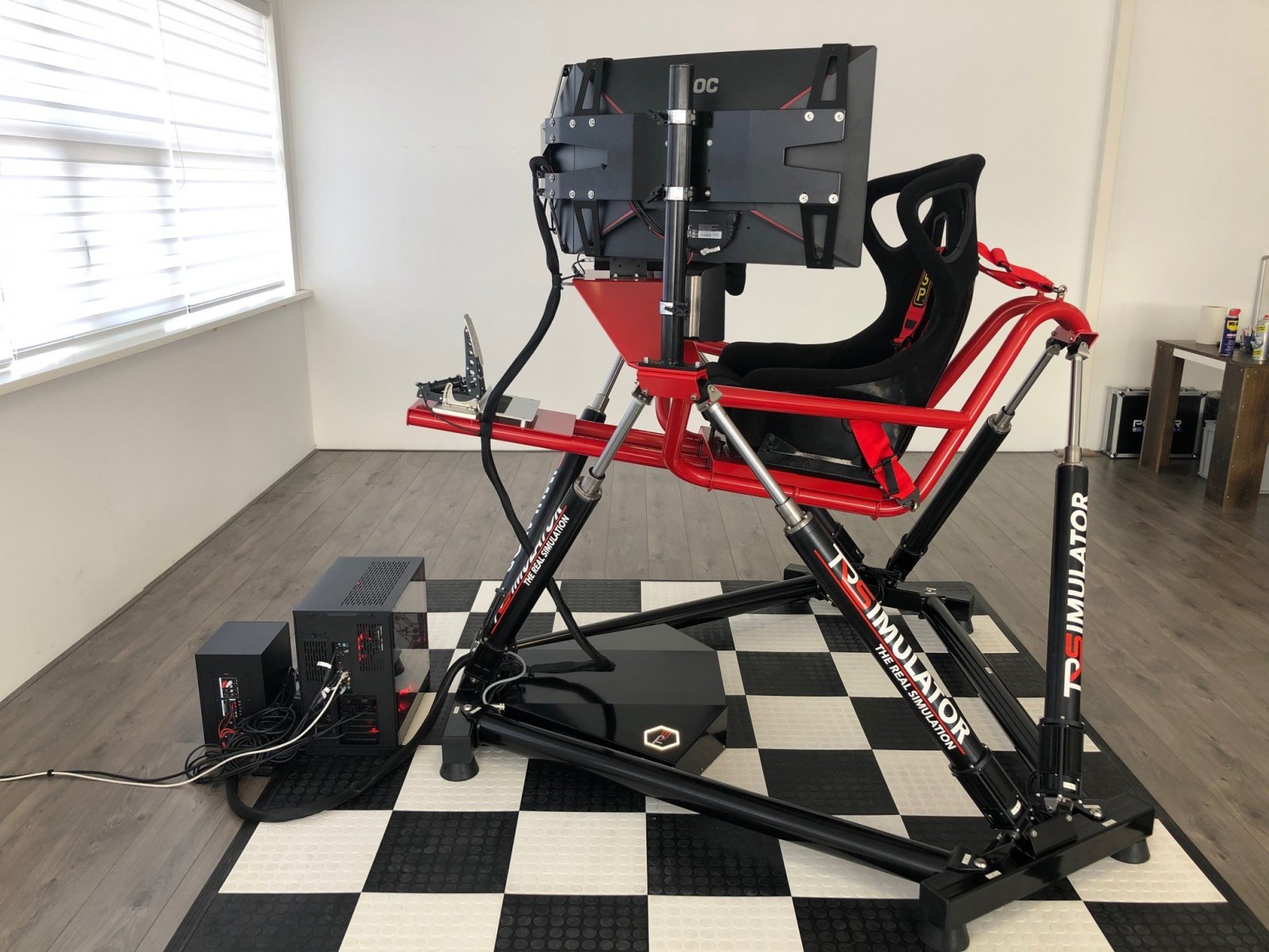

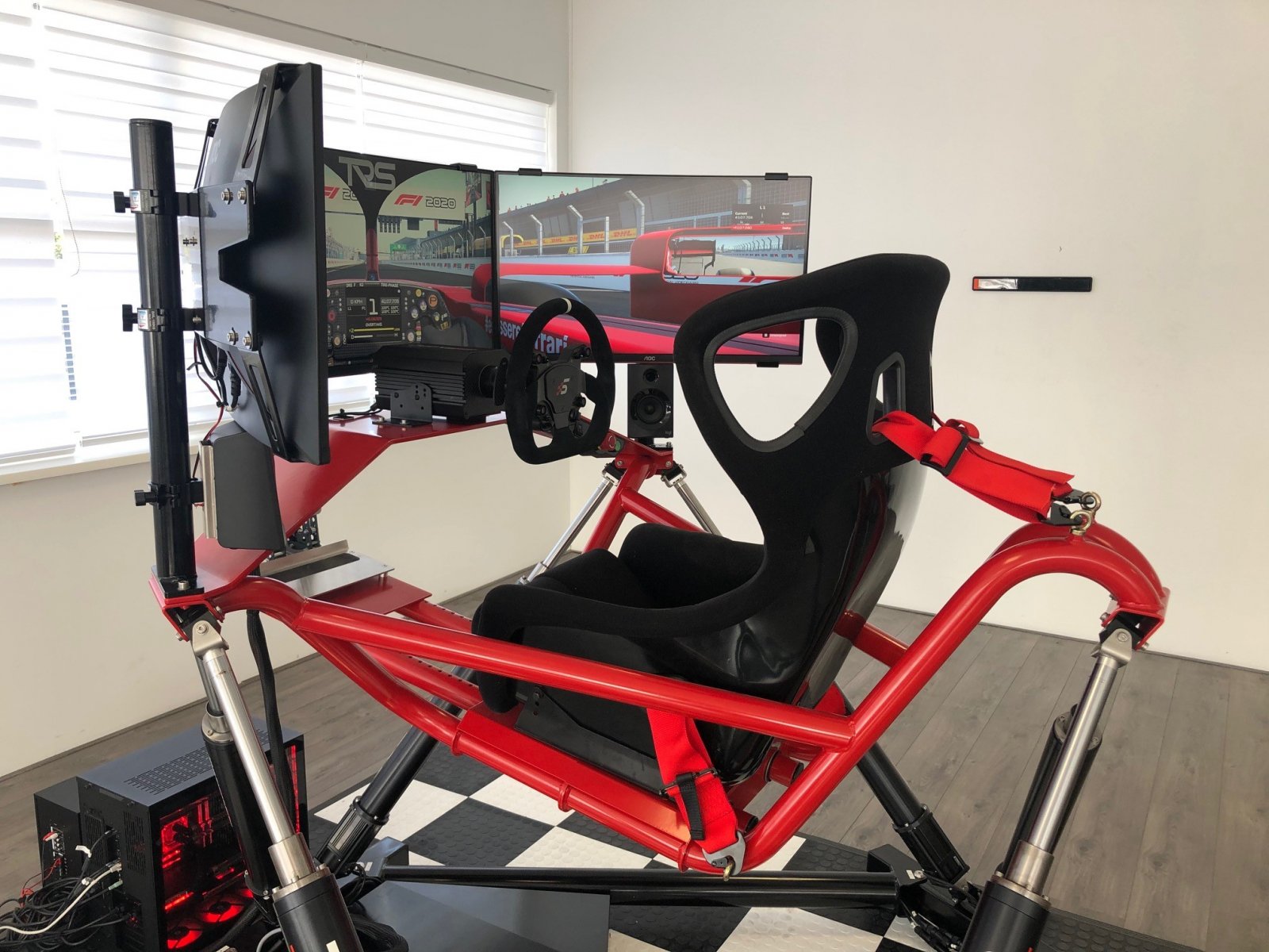

    Put it all together, quite happy with the result!
    xs14.jpg xs13.jpg xs12.jpg xs11.jpg xs10.jpg xs9.jpg xs8.jpg xs7.jpg xs6.jpg xs5.jpg xs4.jpg xs3.jpg xs2.jpg xs1.jpg
    • Winner Winner x 7

    A super clean build, wow! Looks absolutely amazing.

    Wahou ! The result is awesome !!! Congratulation hug:
    Now we wait for a video of your rig in action !!! :)
