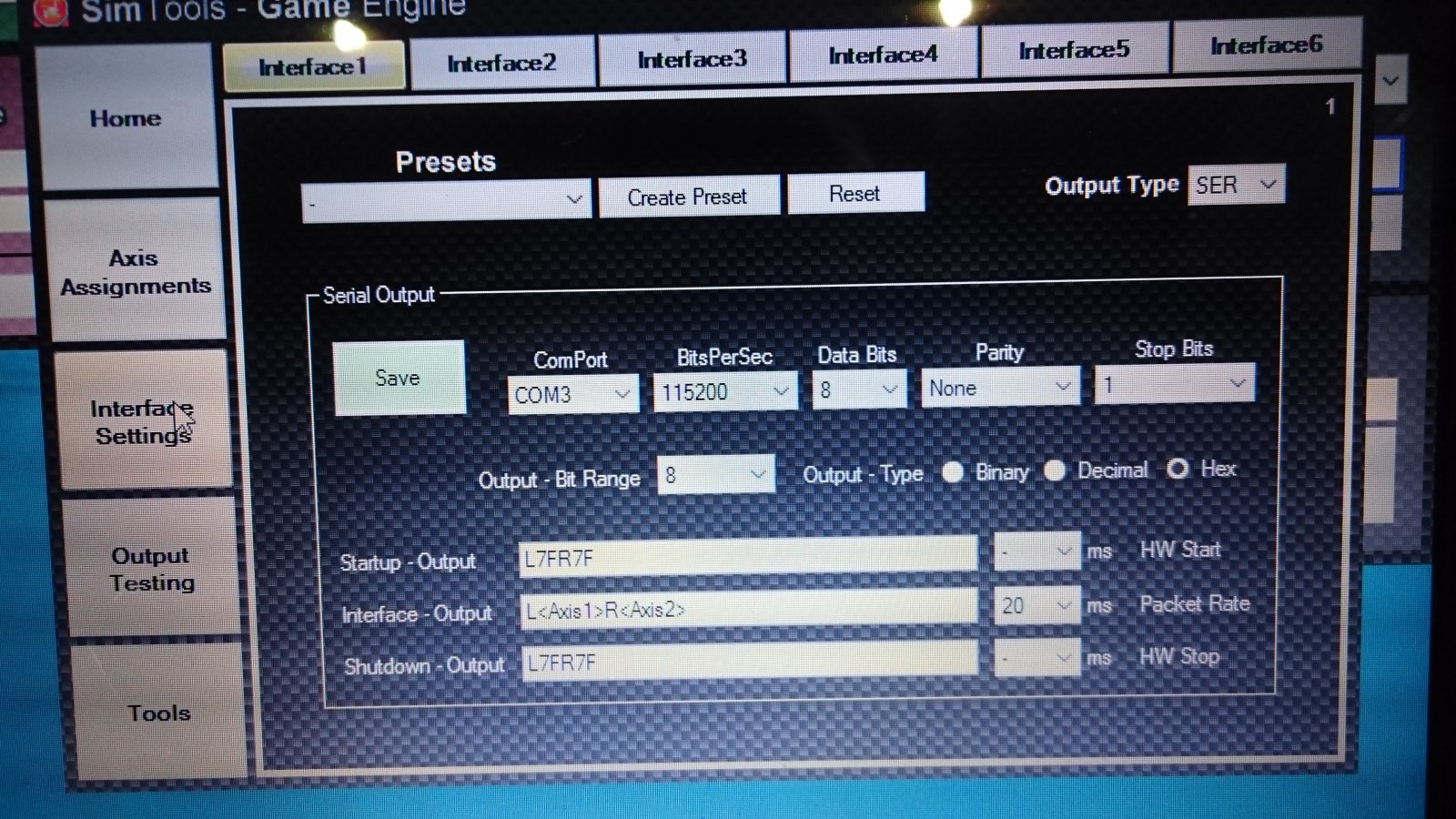

    Hi all all seems to be done apart from mounting potential switchs is there a way I can test
  6. Vdub180
    Vdub180 Member
    Jan 20, 2016
    83
    England
    148Coins
    +15 / 1 / -0
    I can seem to make SimTools work with the motors all powered up but not motor output??? Little stuck
  7. Vdub180
    Vdub180 Member
    Jan 20, 2016
    83
    England
    148Coins
    +15 / 1 / -0
    I've followed the step by step guide but can't get passed the output test. there dont seem to be any communication between the laptop and the motors, there's voltage at the pots and voltage does increase and decrease ok just no out put to motors, been on it for the last 5 hours

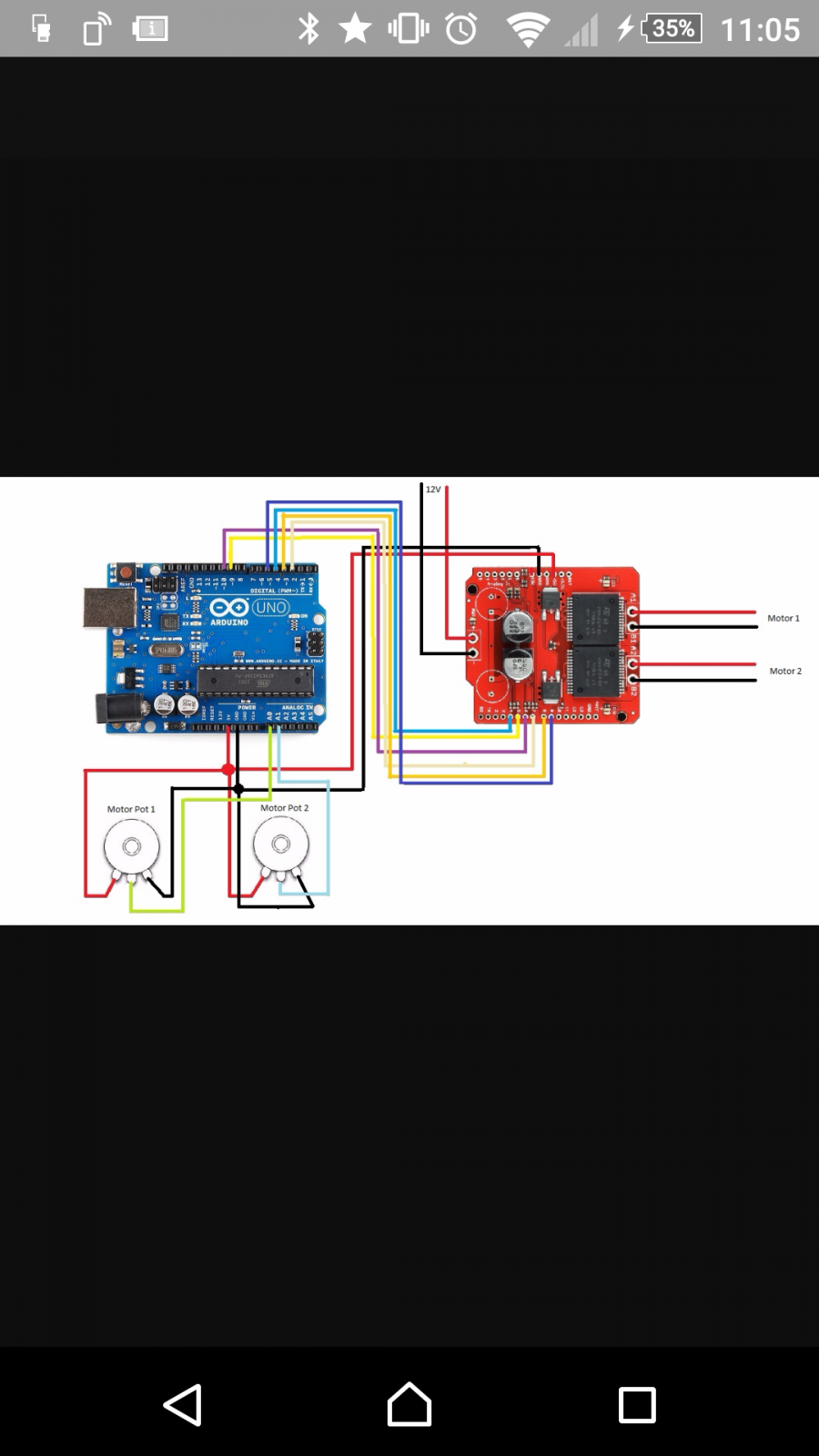

    I used this
    21,712
    151,979Coins
    +11,061 / 56 / -2
  10. Vdub180
    Vdub180 Member
    Jan 20, 2016
    83
    England
    148Coins
    +15 / 1 / -0
    Hi all thanks for the reply, seems like I missed a few steps I thought because my motors worked when I tested them off a car battery they was ok and didn't need ground isolation, also I'm not sure about the code I've posted a pic I what I've entered but not sure if it's what u ment by code, and I did not test the mm before using ether so looks like I got a busy few days a head thanks again all

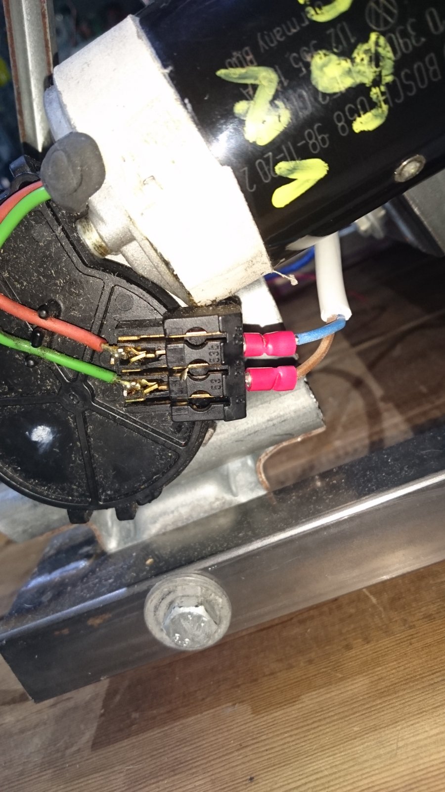

    My motor wiring

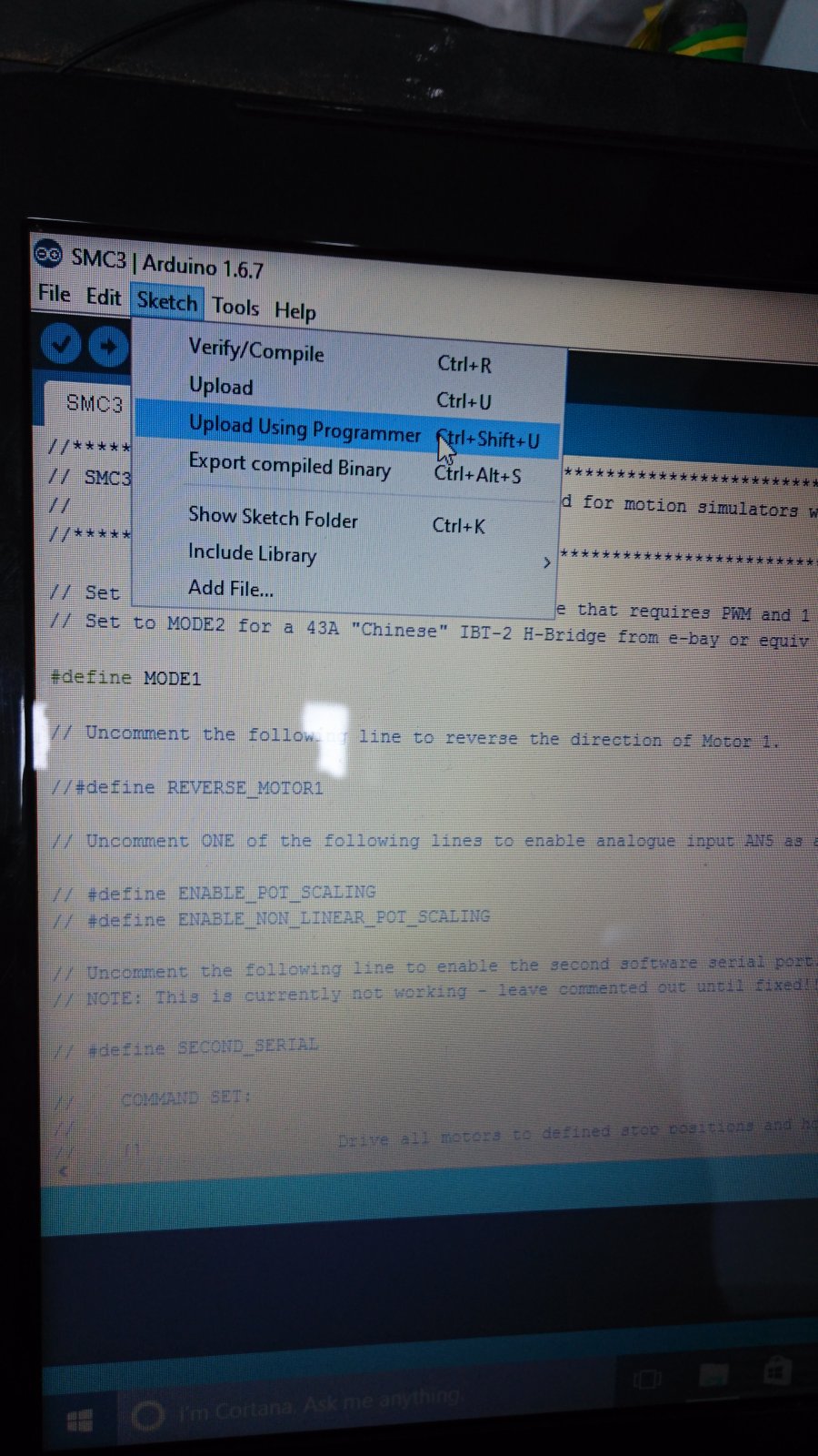

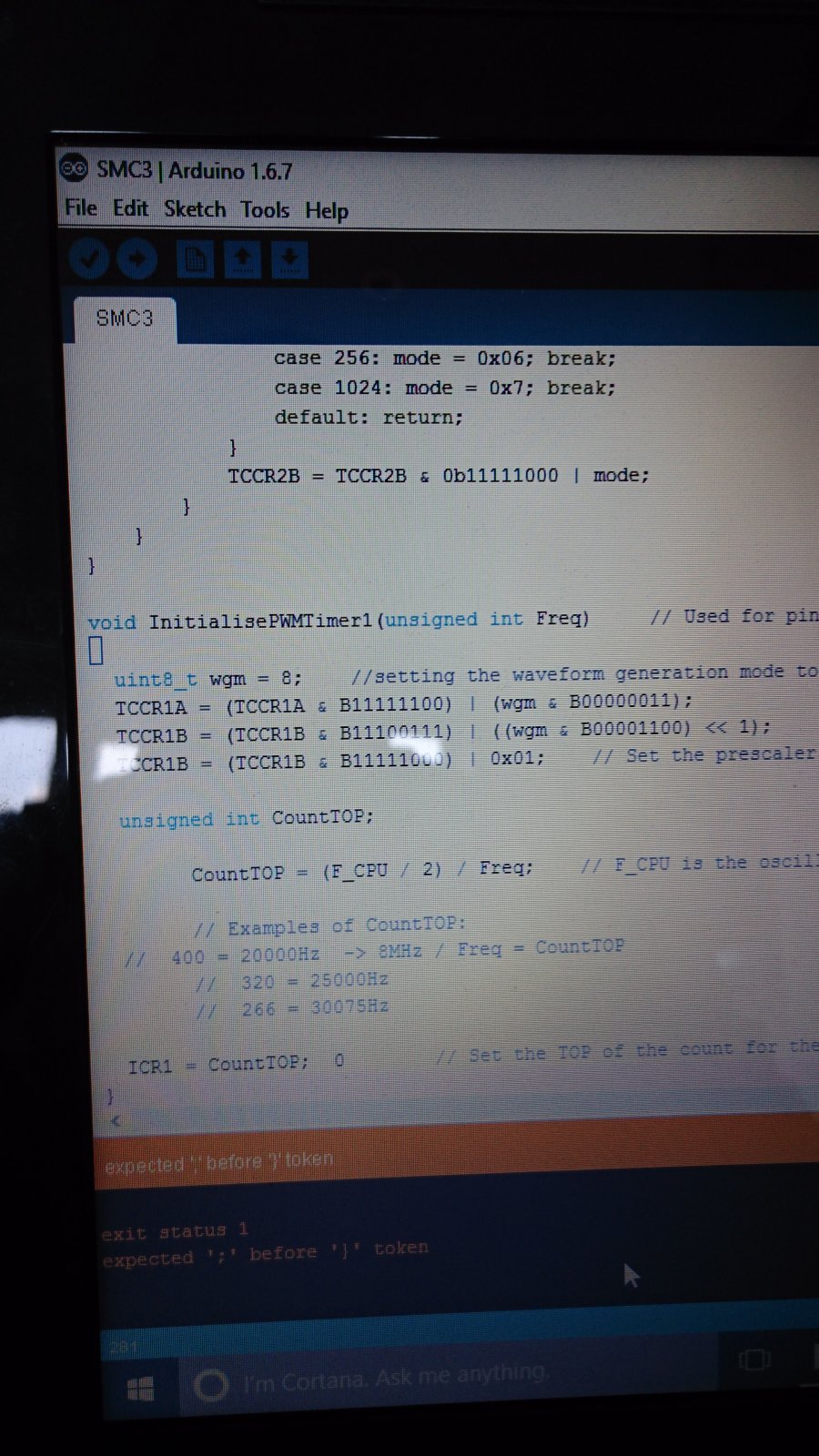

    Ok I've downloaded arduino & smc3 opened it up and tried to upload it to my arduino but I get this error never coded anything in my life so well out my depth here

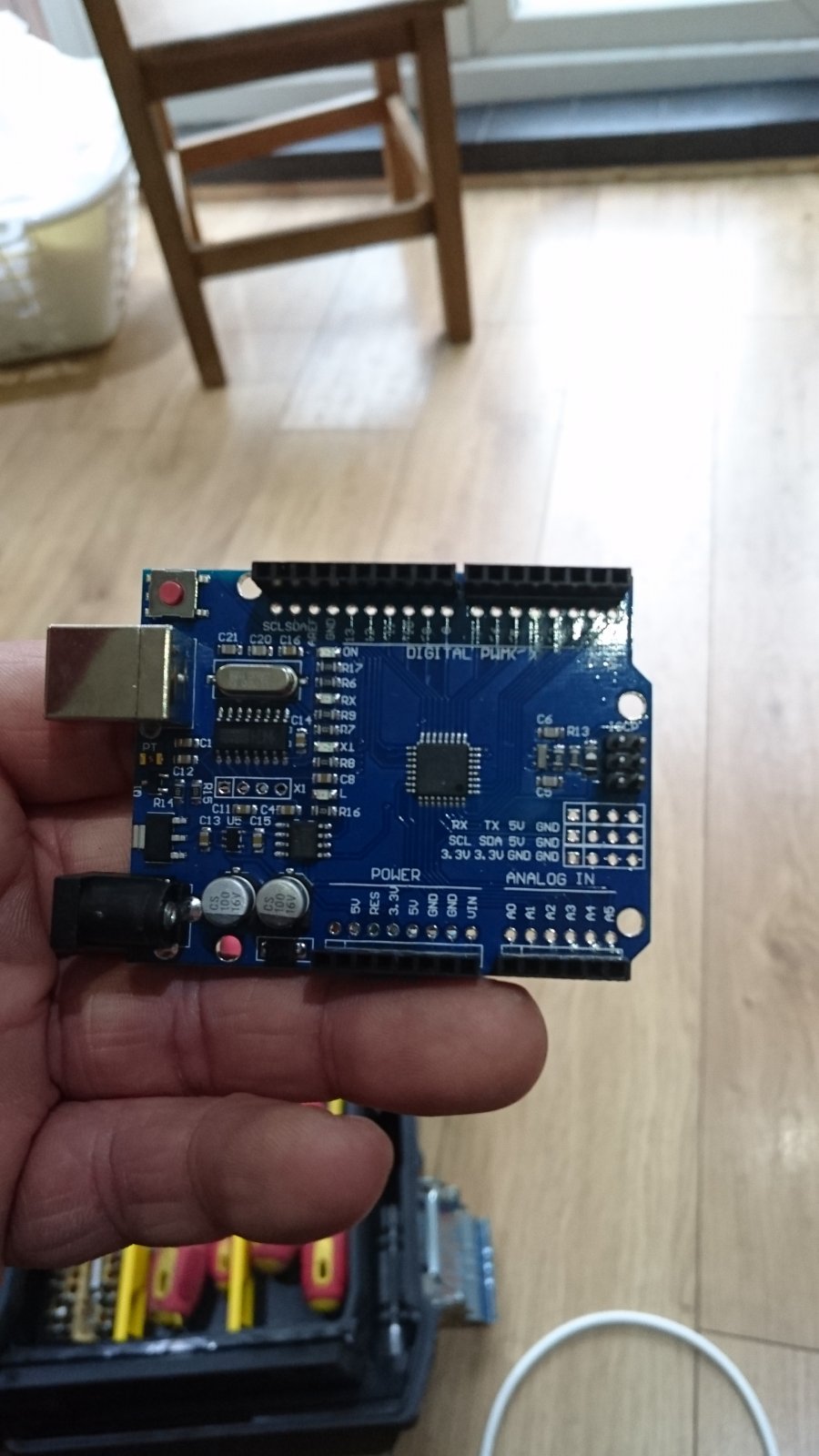

    I
  20. Vdub180
    Vdub180 Member
    Jan 20, 2016
    83
    England
    148Coins
    +15 / 1 / -0
    • Uploaded smc3 to anduino
    • Linked moto monster anduino together
    • Powered up
    • 2v at motor connections but did not change with increasing pots
    • I just noticed my anduino dont look the same as one on the Internet
    • Also changing mounting
    • I think I need to but another mm and Anduro and start again
