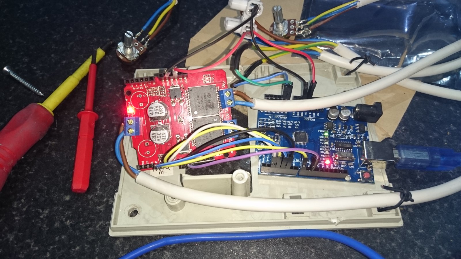

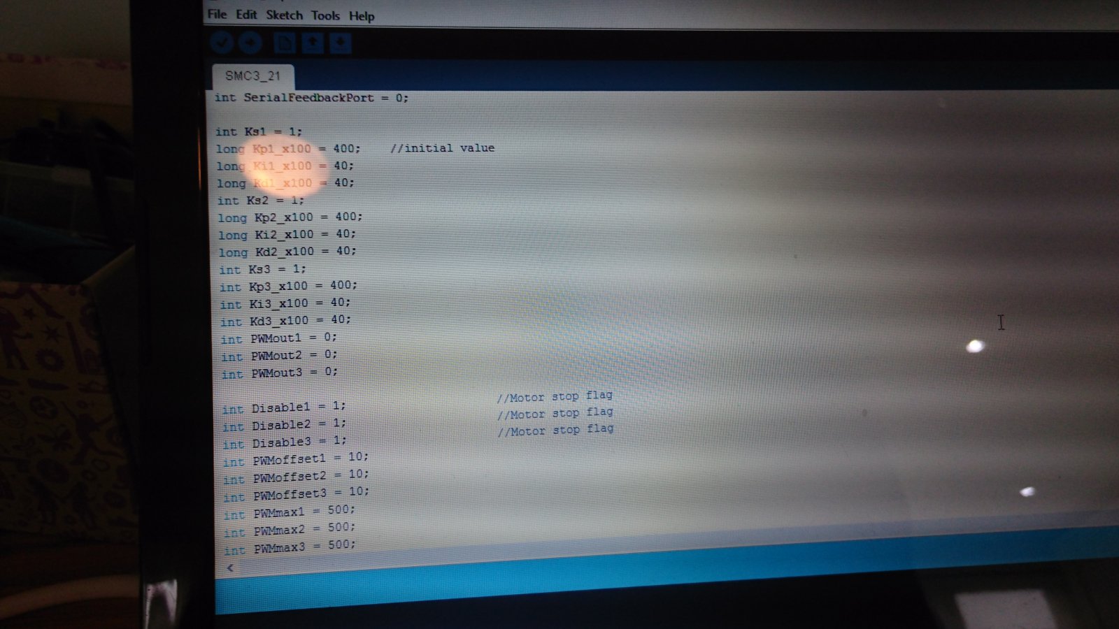

    Still pulling my hair out, put software on used the smc 1.6.7

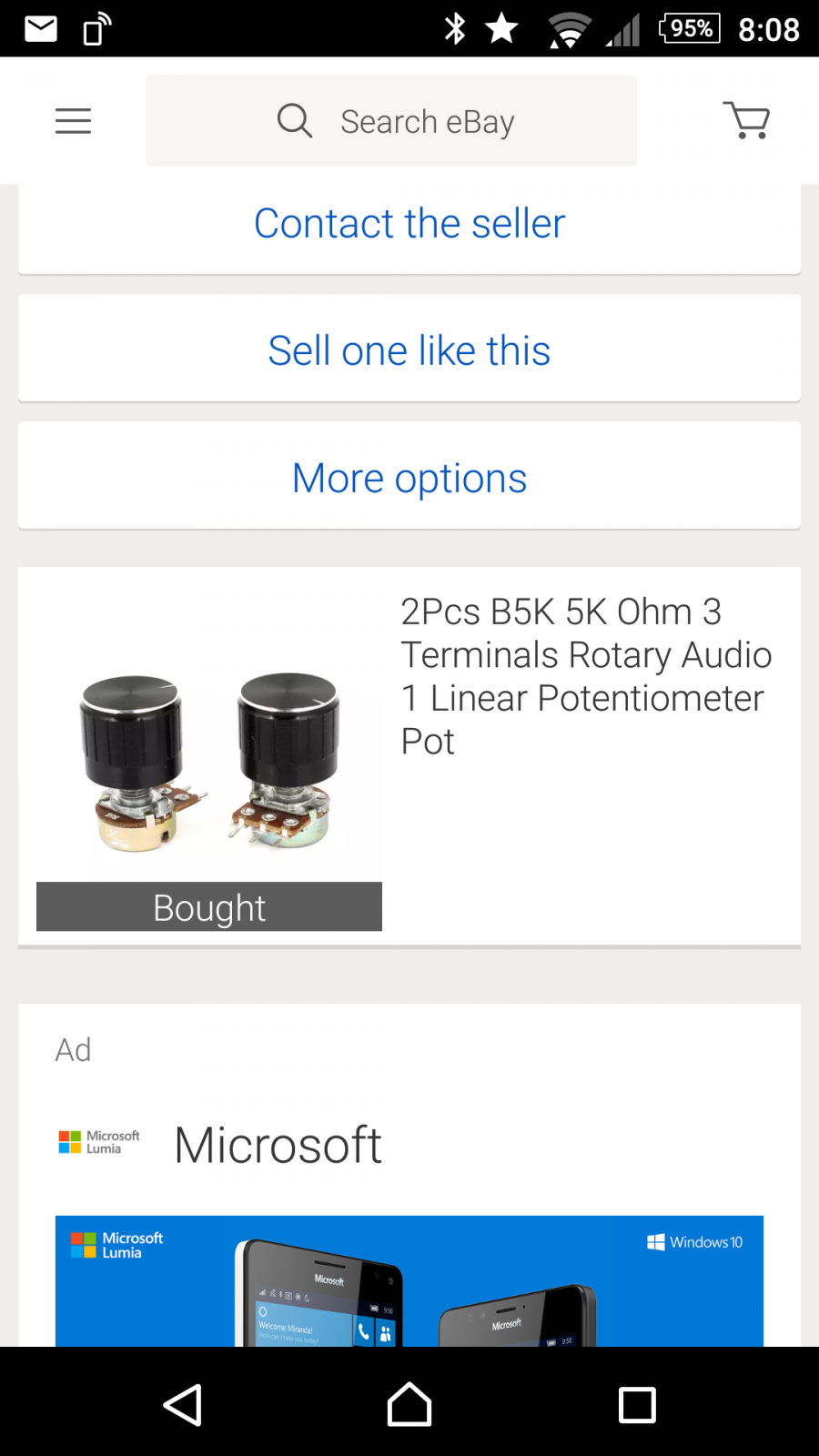

    Need it to work first not sure if I'm using the right pots only getting 3v to motors
  4. Vdub180
    Vdub180 Member
    Jan 20, 2016
    83
    England
    148Coins
    +15 / 1 / -0
    These the correct pots

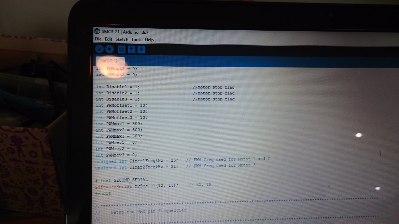

    I used the smc 1.6.7 software but didt make any alterations just up loaded as it was. No motors connected just tester to check voltages

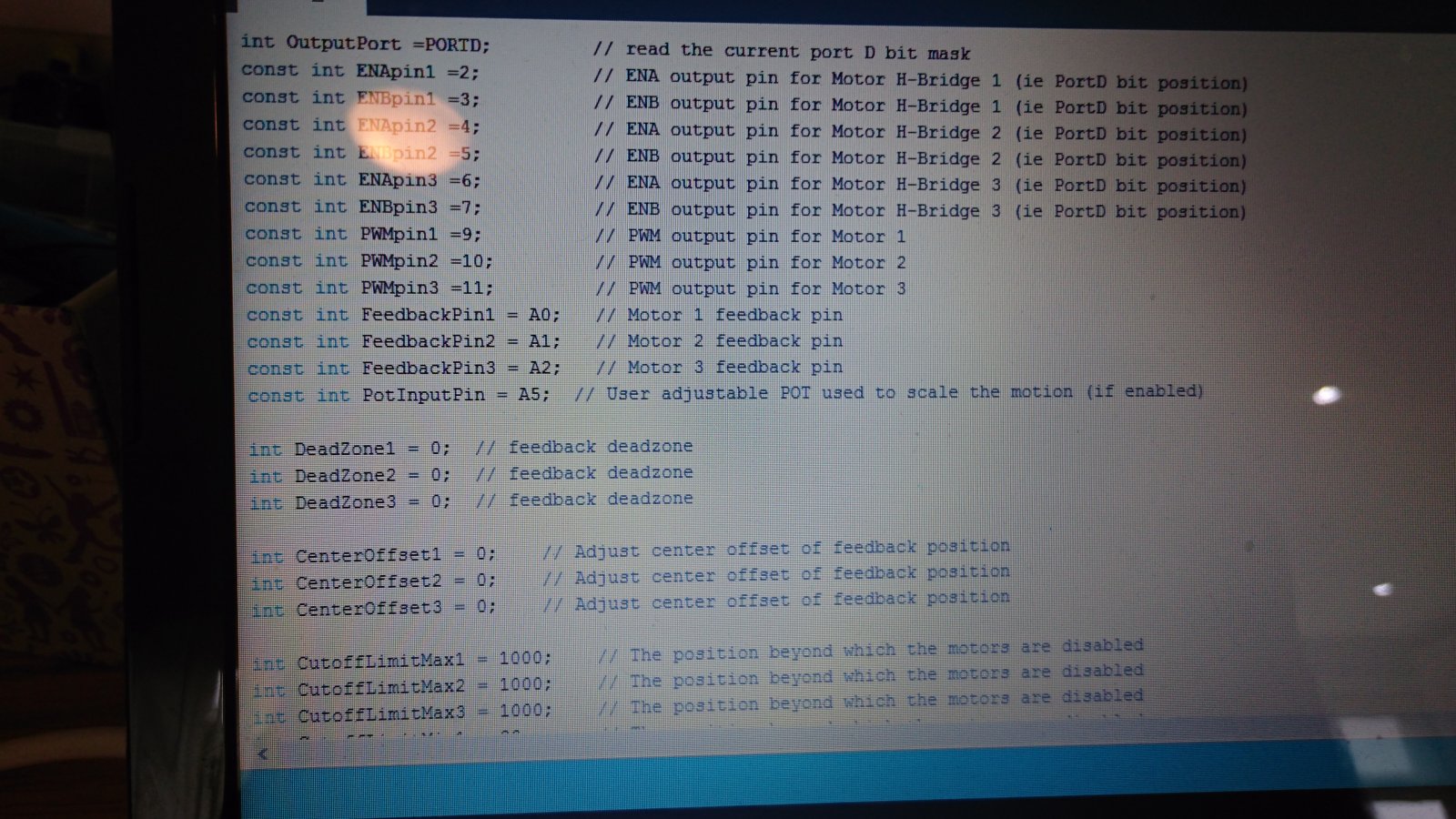

    This look correct

  13. RufusDufus
    RufusDufus Well-Known Member
    Jul 21, 2013
    681
    Adelaide Australia
    16,221Coins
    +1,016 / 10 / -1
    You shouldn't really be changing the parameters in the code other than the #define MODE line.
    All user adjustable settings can be changed and tested with the Windows SMC3Utils.
    EDIT: To avoid confusion, there is no SMC3 version 1.6.7 - The 1.6.7 is the Arduino IDE version number.

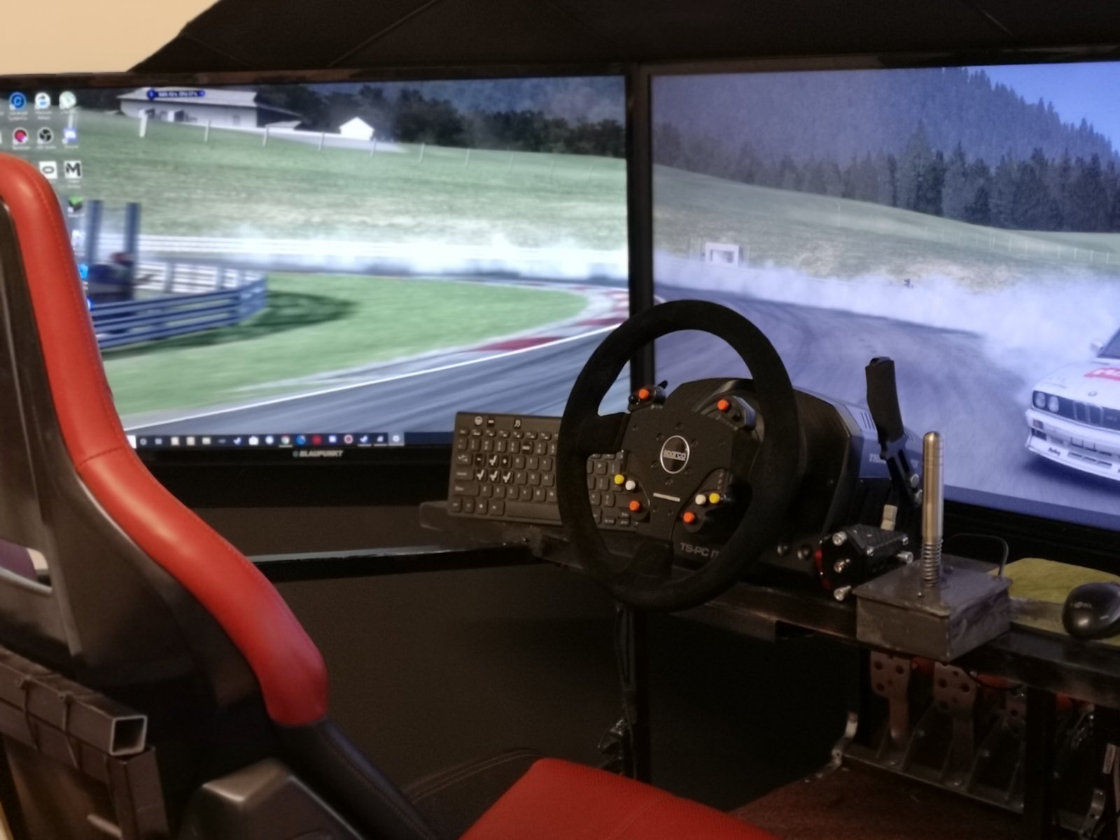

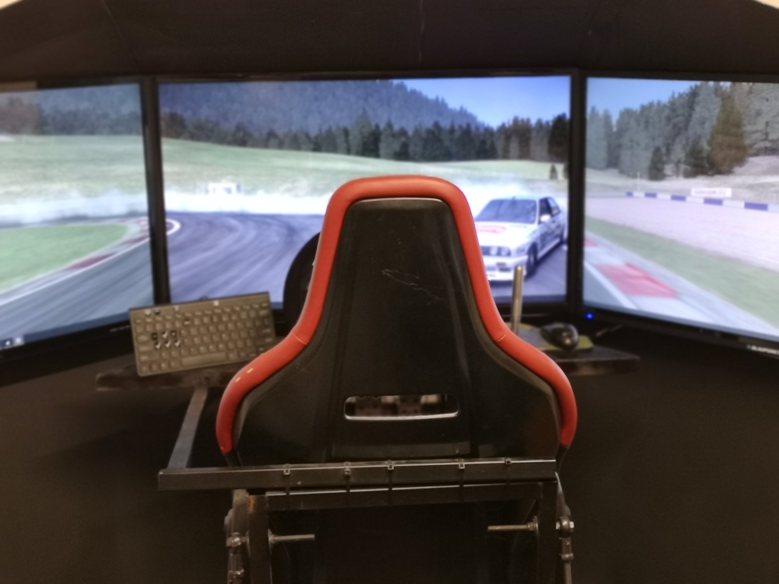

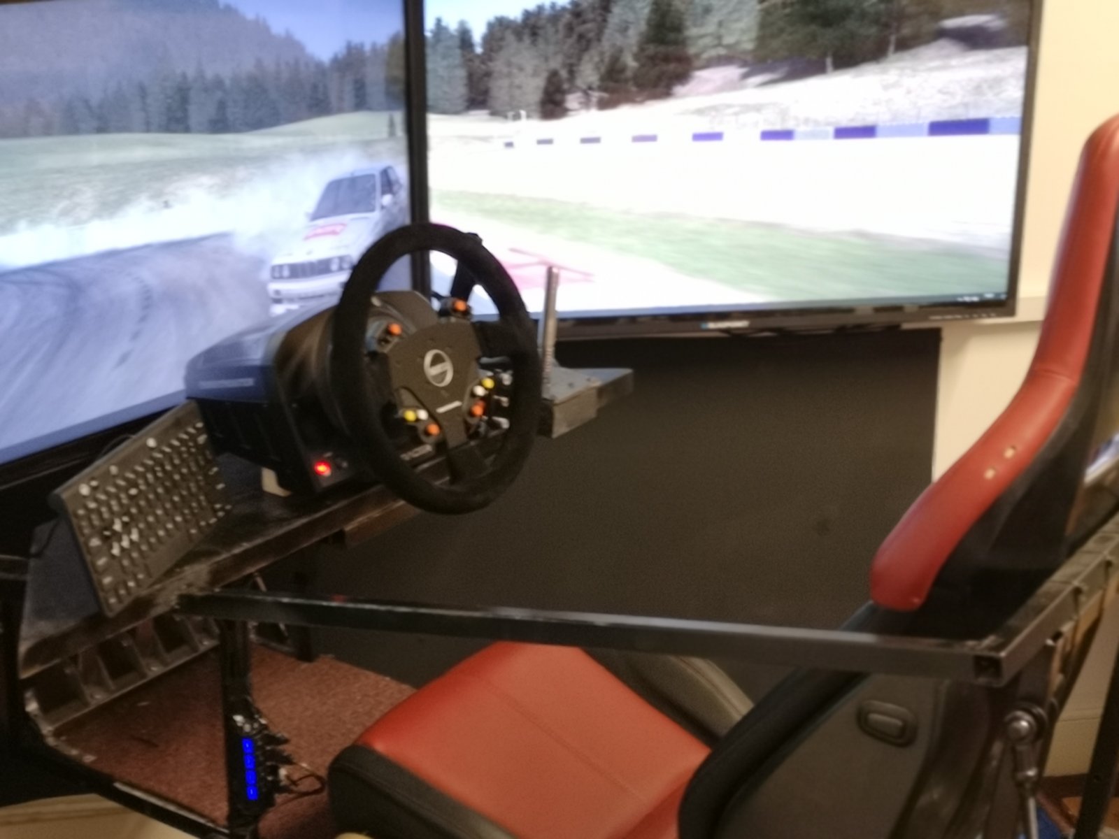

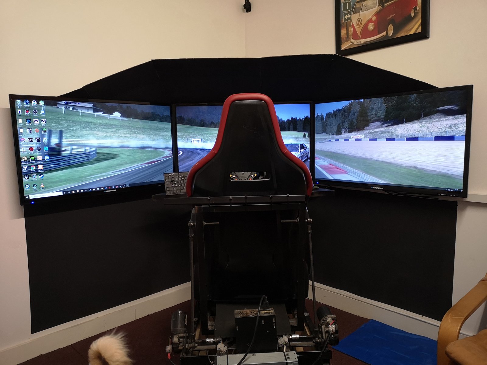

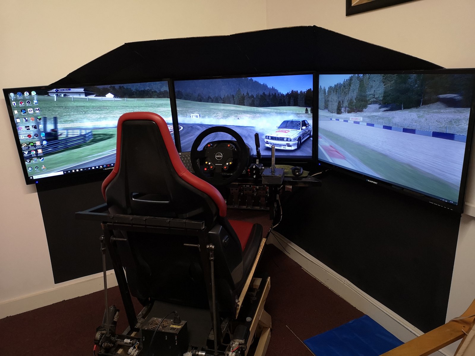

  16. Vdub180
    Vdub180 Member
    Jan 20, 2016
    83
    England
    148Coins
    +15 / 1 / -0
    Hi all i thought after all the years ive been using my rig id share how its holding up and how it looks today, sill running the same mk4 golf wipers also
  17. Daguru
    Sep 4, 2013
    720
    Kitchen installer
    Wales uk
    460Coins
    +633 / 1 / -0
    Motion platform
    looking good love the triples:thumbs
