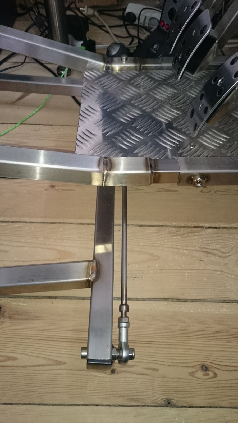

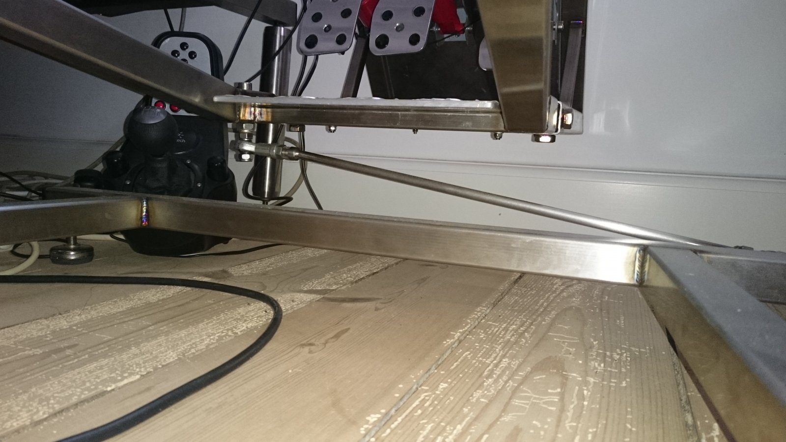

    Buy the way, I managed to keep, only just, the movement of the rig inside the travel of the ball joints, luckily! And as an old-timer earlier in this thread predicted, I had to do something about the play in the driveshaft CV joint, so I mounted some 8mm ball joints and a bar to lock it up sideways, works perfectly! DSC_0059.JPG
