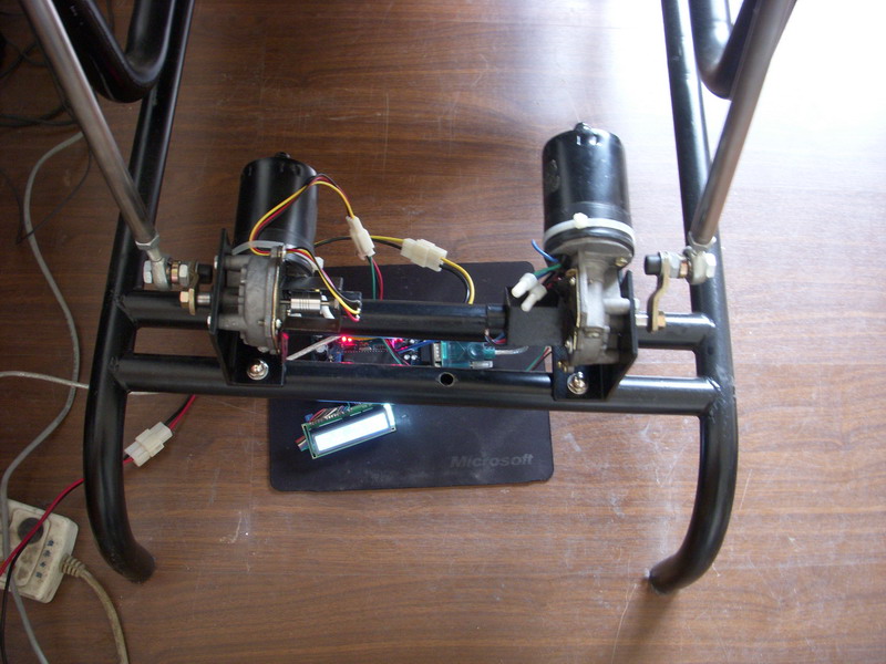

    Hi guys ,today i 'm test the AMC with 2 motos.
    I config the Force-Profiler and run the GTR2 .Here is the video.
    I 'm not finish the fram yet. so it only can test on the ground.:0)
    The video shot by my mobilephone ,it's not clear.If i can borrow a DV,it's so perfect.

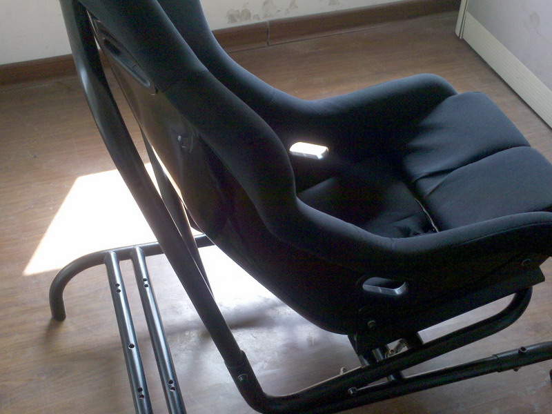

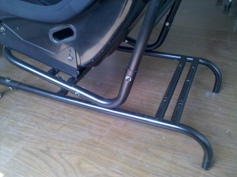

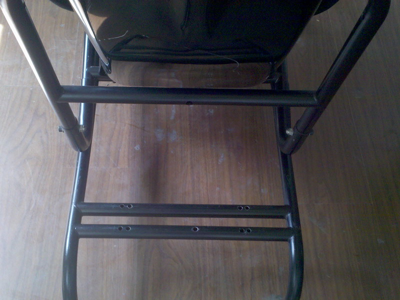

    Hoho,I have finish my fram and conect the racing chair.It looks good .:)) I wish u are happy as me.

    hi guys,There are connect all the system(wiper motos,PCB,frame)today.
    System run in the game GTR2,here is the video. :D
    http://player.youku.com/player.php/sid/ ... OTg4/v.swf
    Can you upload the video to the Youtube?I will thank you very much.
    next,i will finish the front of the frame,add the logitec racing whell.

    The MosFets is cool,it's keeping cool for long time when game running.
    I have made massage in the seat for several hours.:))

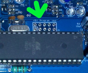

    hello Briut!! All things redesign is base on Tronic's AMC.The electronic part is same as Tronic's list.
    My friend just reorganized parts and reduce the board.
    The max amperes can handle is 70A each channel.
    Next 2 questions are not understand,sorry.I think Tronic must be have the answer.
    I use the power is 12A 12V Switching Power Supply.
    My friend estimate the AMC price is about €50~€100,the prices are subject to the quantity of each order
    Best regards

    Briut: The H-bridge in the circuit will not handle 70A (continous) / channels. You have to use a logic level MOSFET replacing the IRFZ44N's in order to get a theoretical 49A continous keeping everything at 25°C. However you will run into problems with the PCB traces above 10A. I can guarantee you that 50A will evaporate them off the board.
    The circuit and components are the exact same as the rest of the builds. Hitme's board is only redesigned to put the AMC and DMShb into one device. There are small SMD components and the board is 2 layers to save space. He also excluded the serial programmer circuit from it and those components that are not used.
    Given the price for the board I would recommend you to build everything else and hope that something cheaper and more reliable comes along in that time.

    But the serial programmer circuit is included .It can be used by 10 stitchs.

    I can see you included the connectors to program the chip which is all good!
    I am referring to this simple AVR programming circuit:
    http://www.olimex.com/dev/images/avr-pg1b-sch.gif
    This is included on the AMC, connected to the top serial port.
