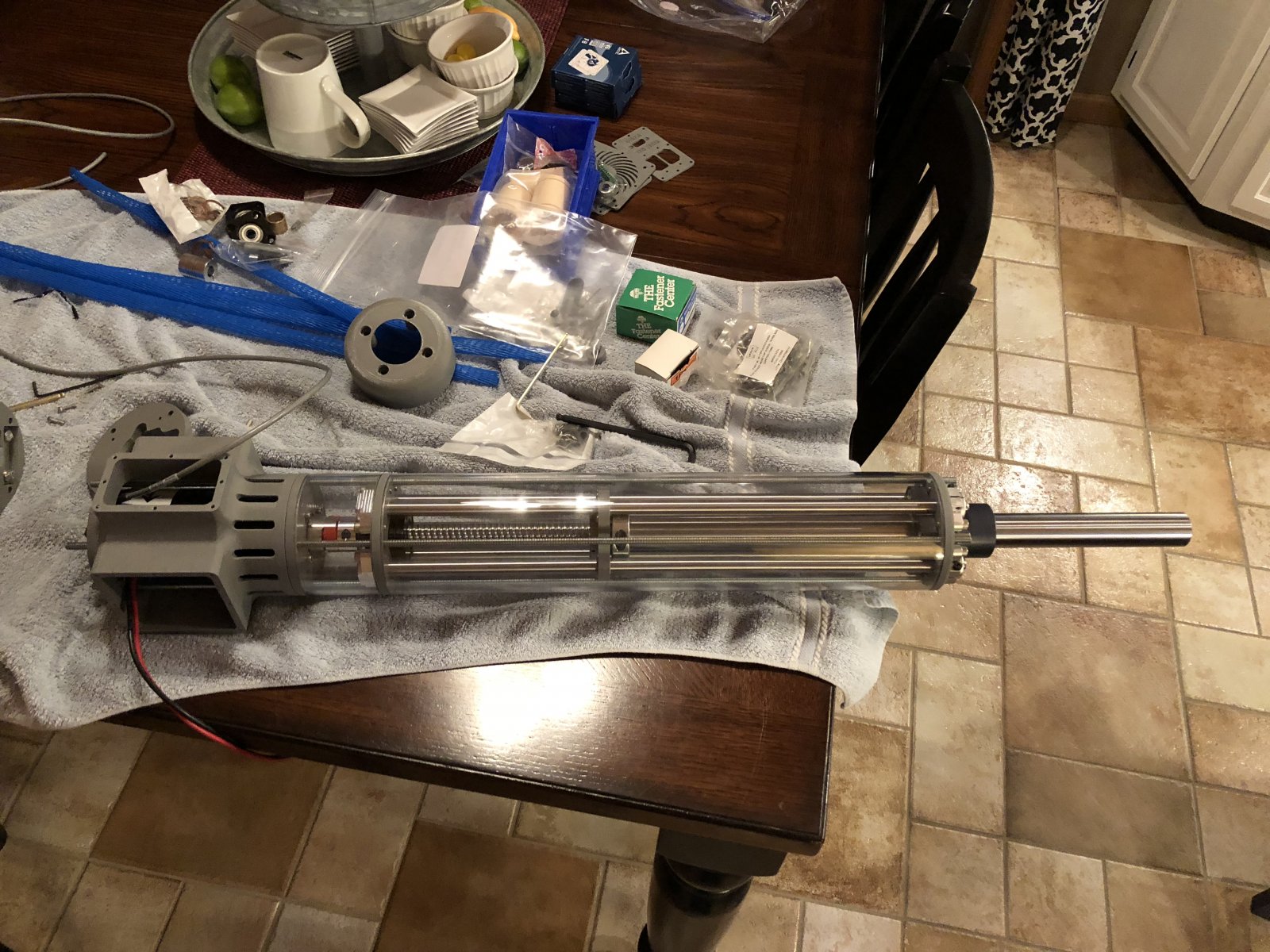

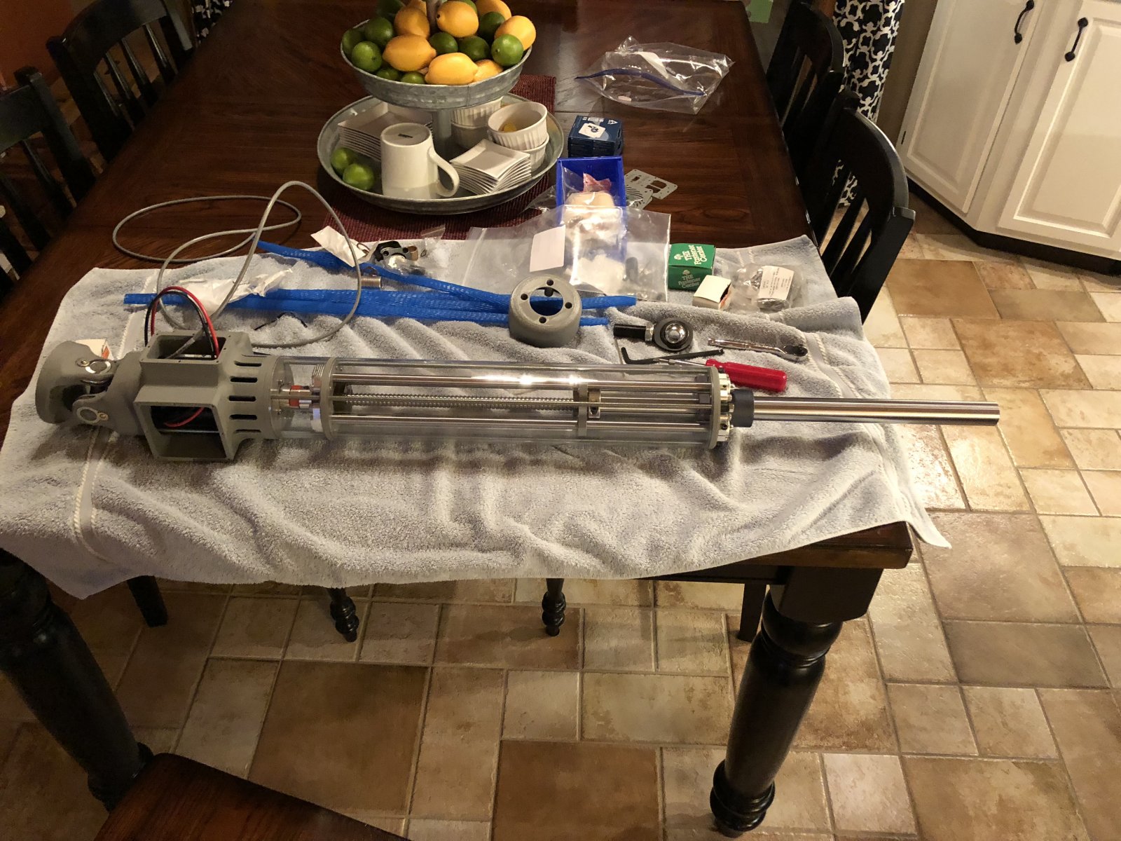

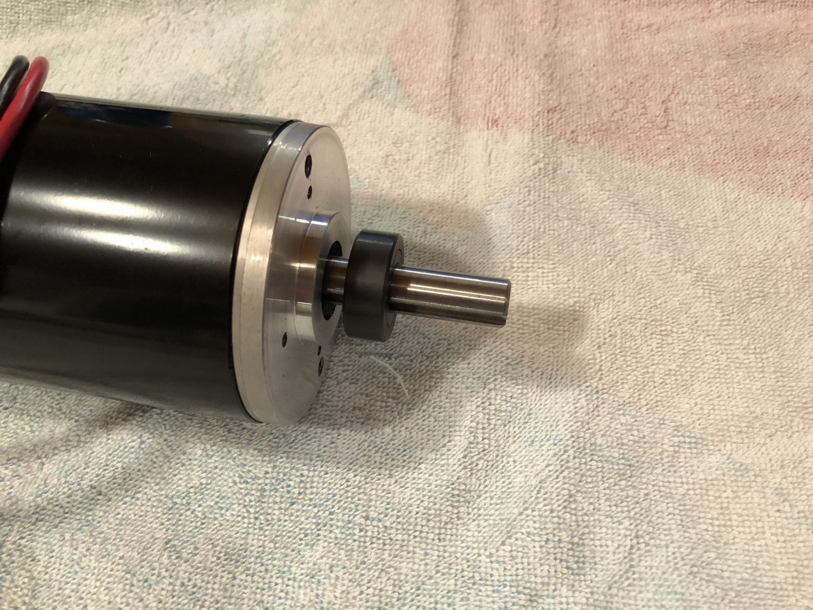

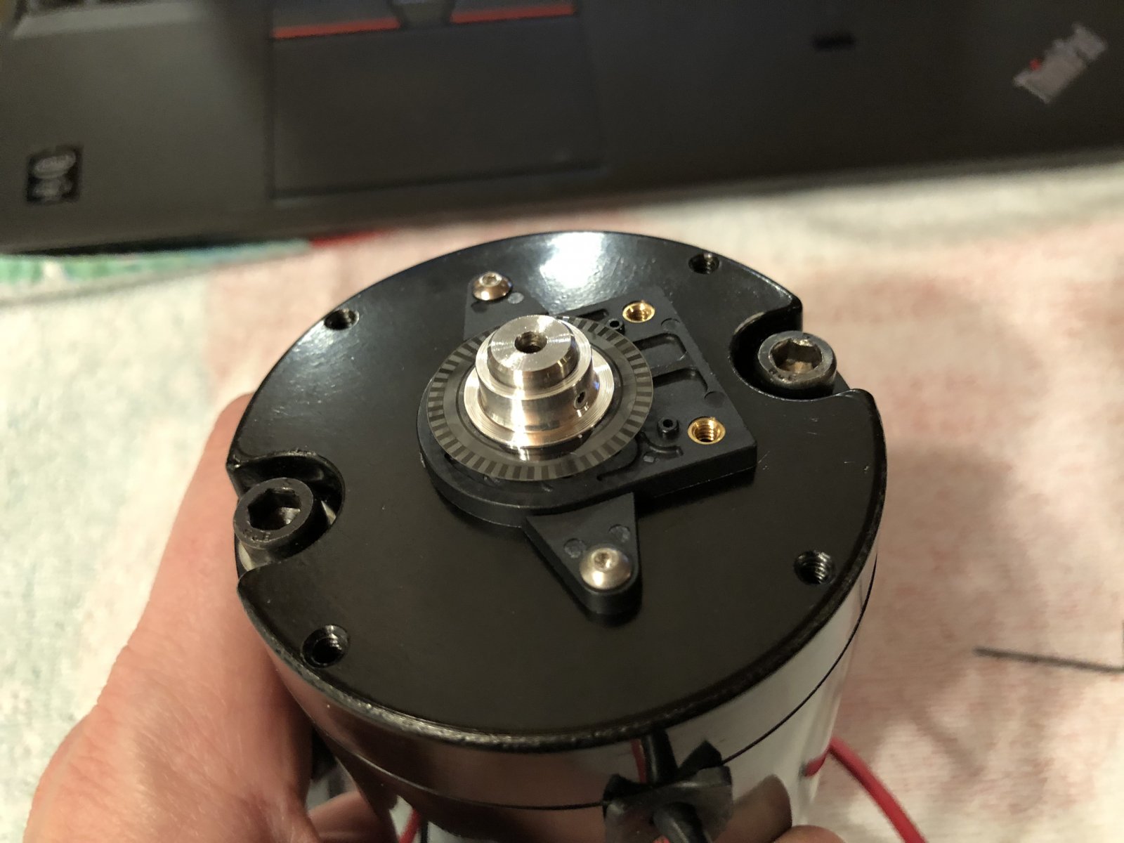

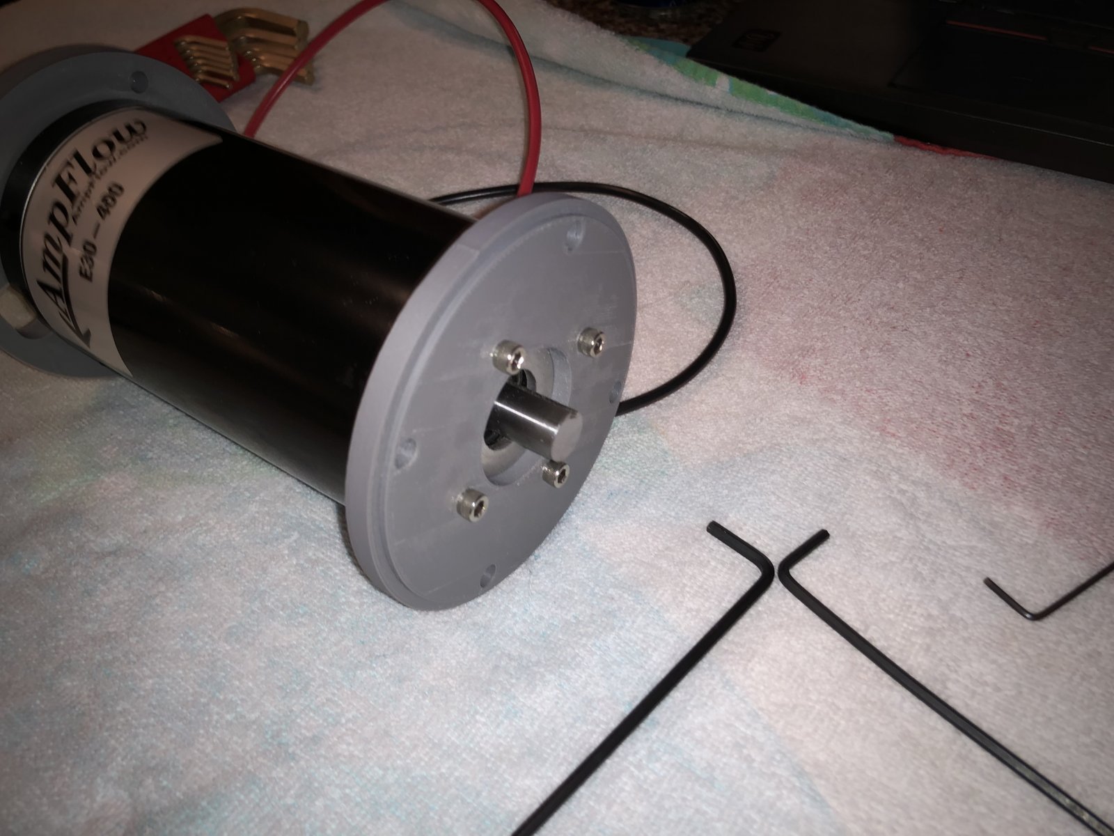

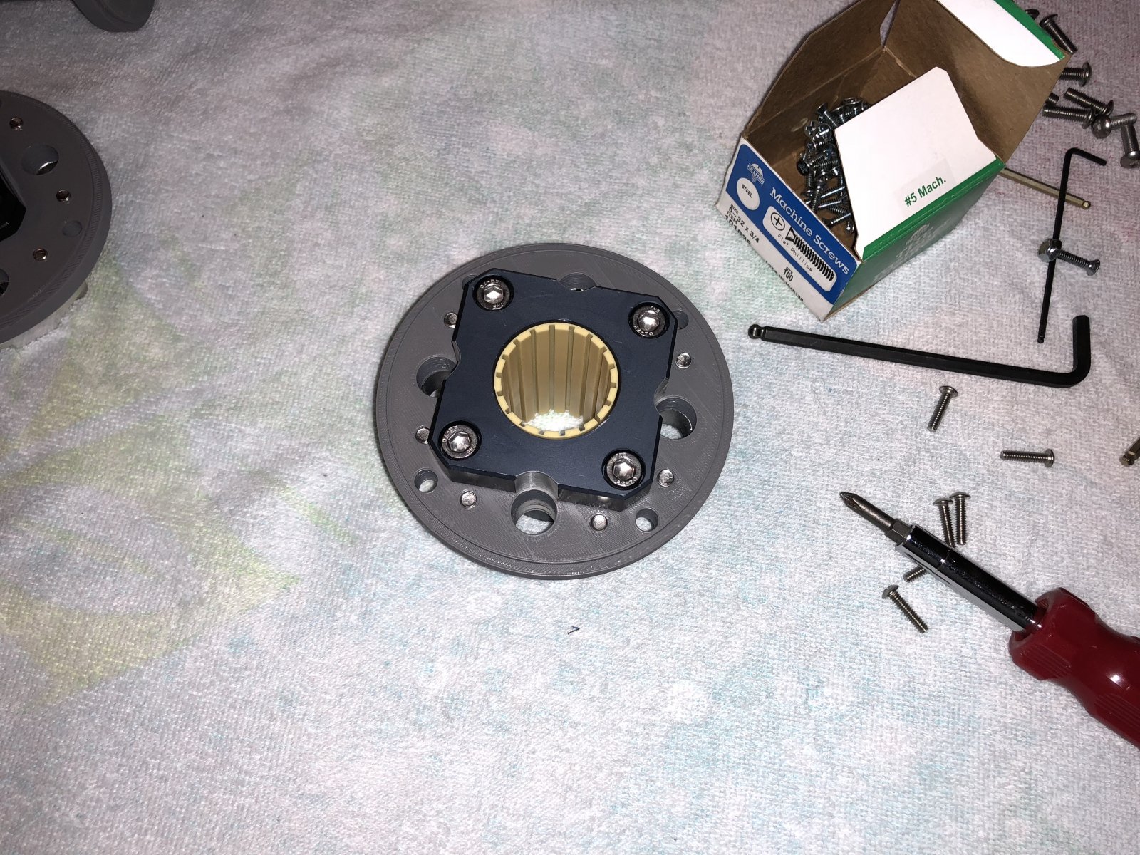

    So I said I would do a little write up on the assembly, I'm going to try to keep the words to a minimum and the pictures to a maximum (sorry to anyone who has slow internet).

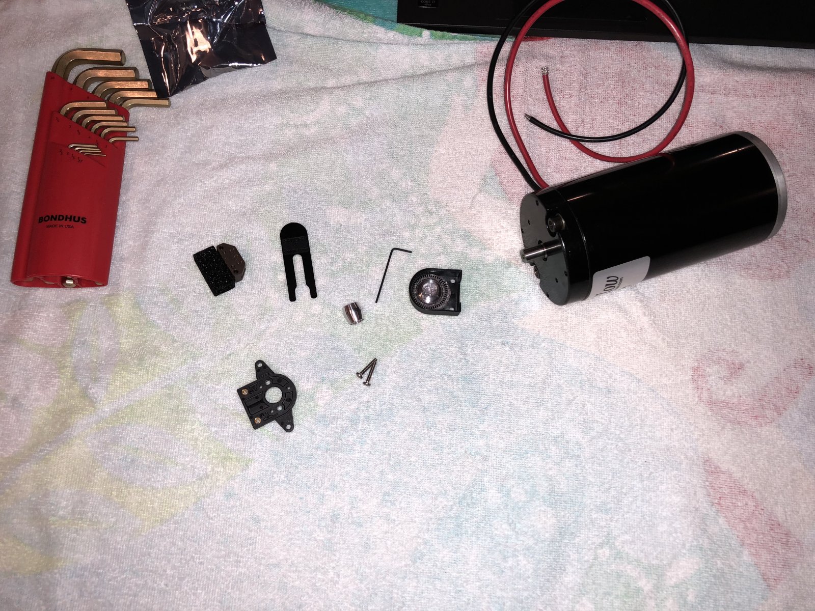

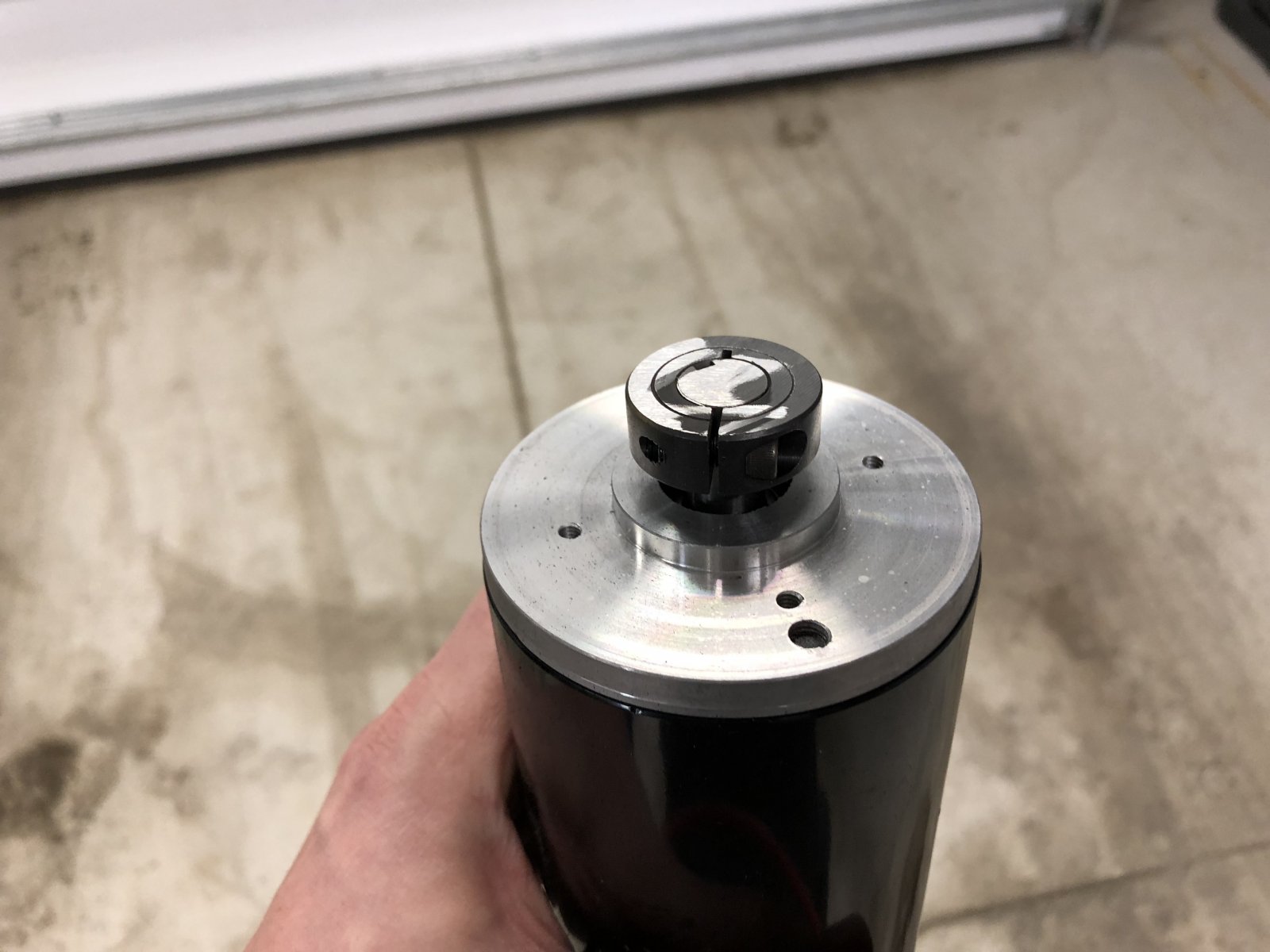

    The motor shaft is too long from stock so the first thing to do is trim it down. I clamped on a shaft clamp to keep the cut square, then I finish the edges with a hand file.

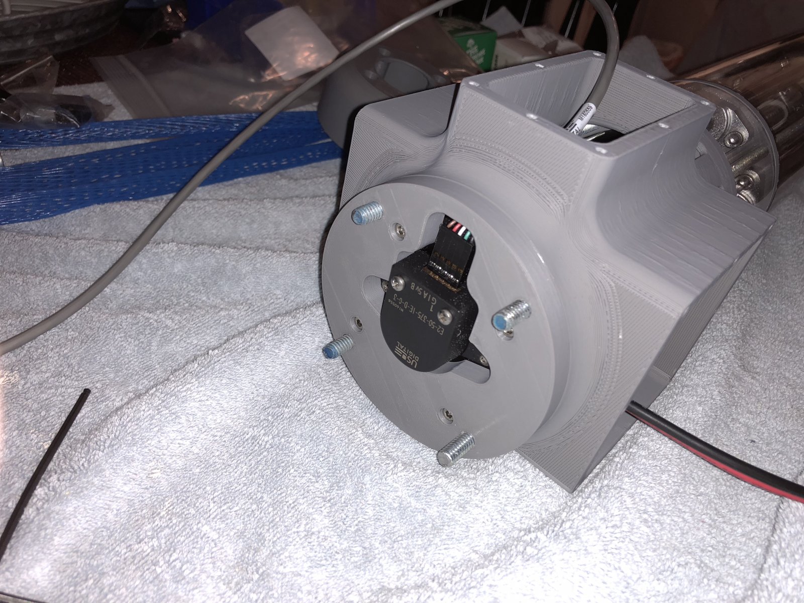

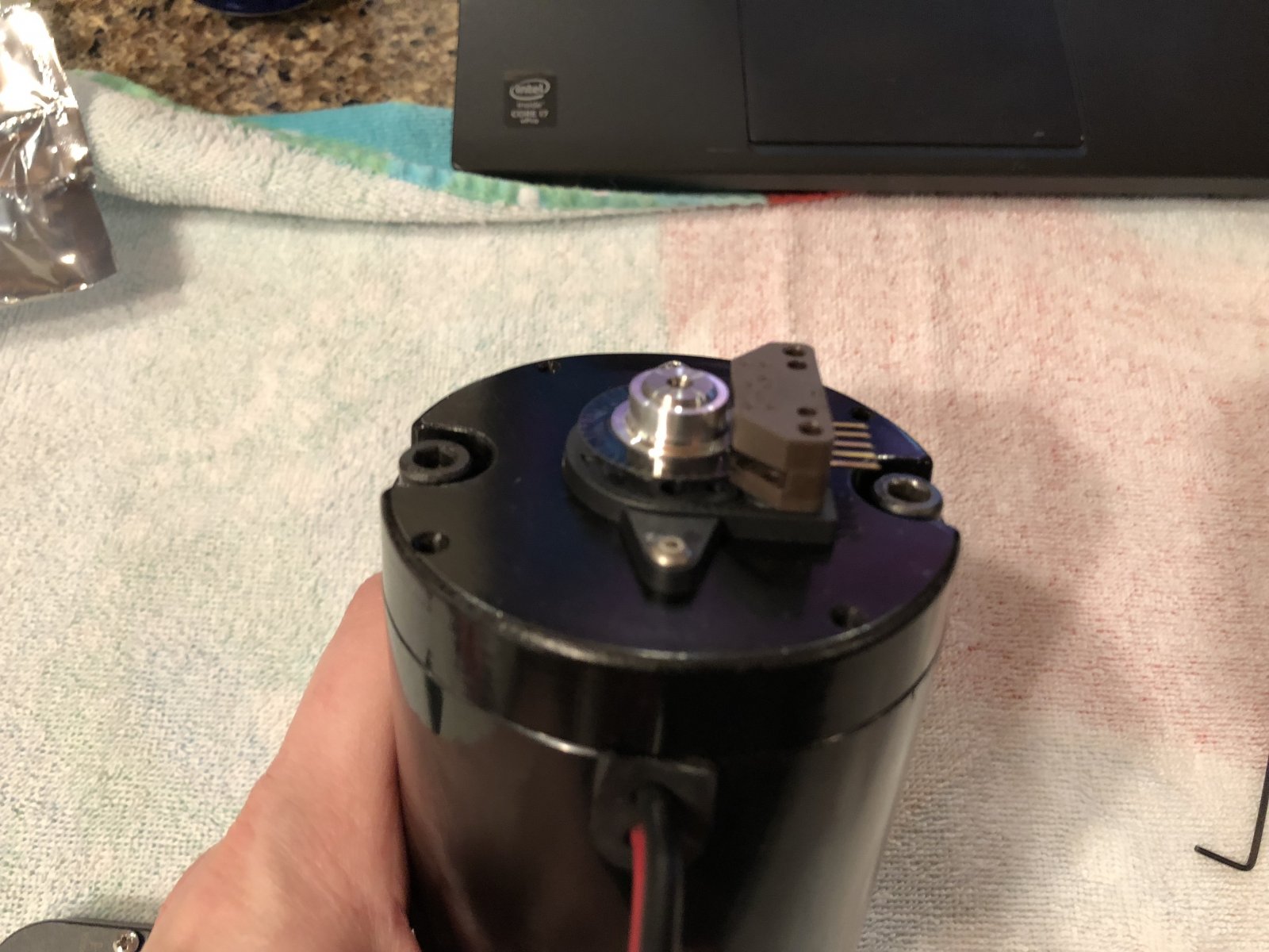

    encoder assembly - using a US Digital E2 shaft mount encoder. kit comes with all the tools needed to center everything on the shaft and align the encoder disk to the sensor.
    Mounting the front and rear plates to the motor, knowing that one will need to come back off later to get the housing installed.

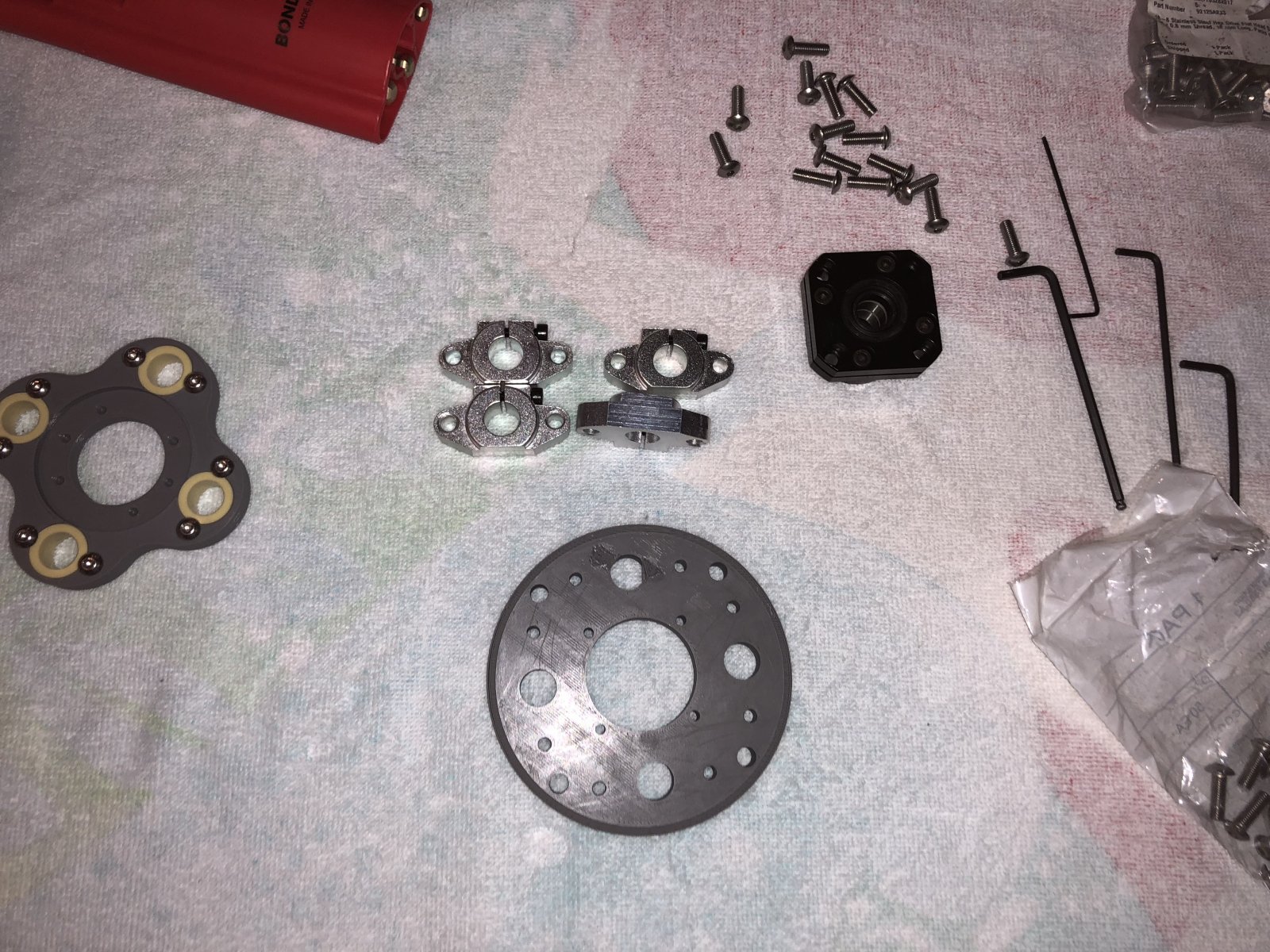

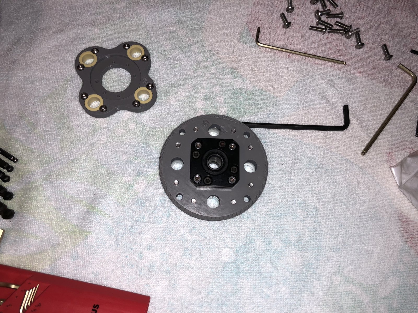

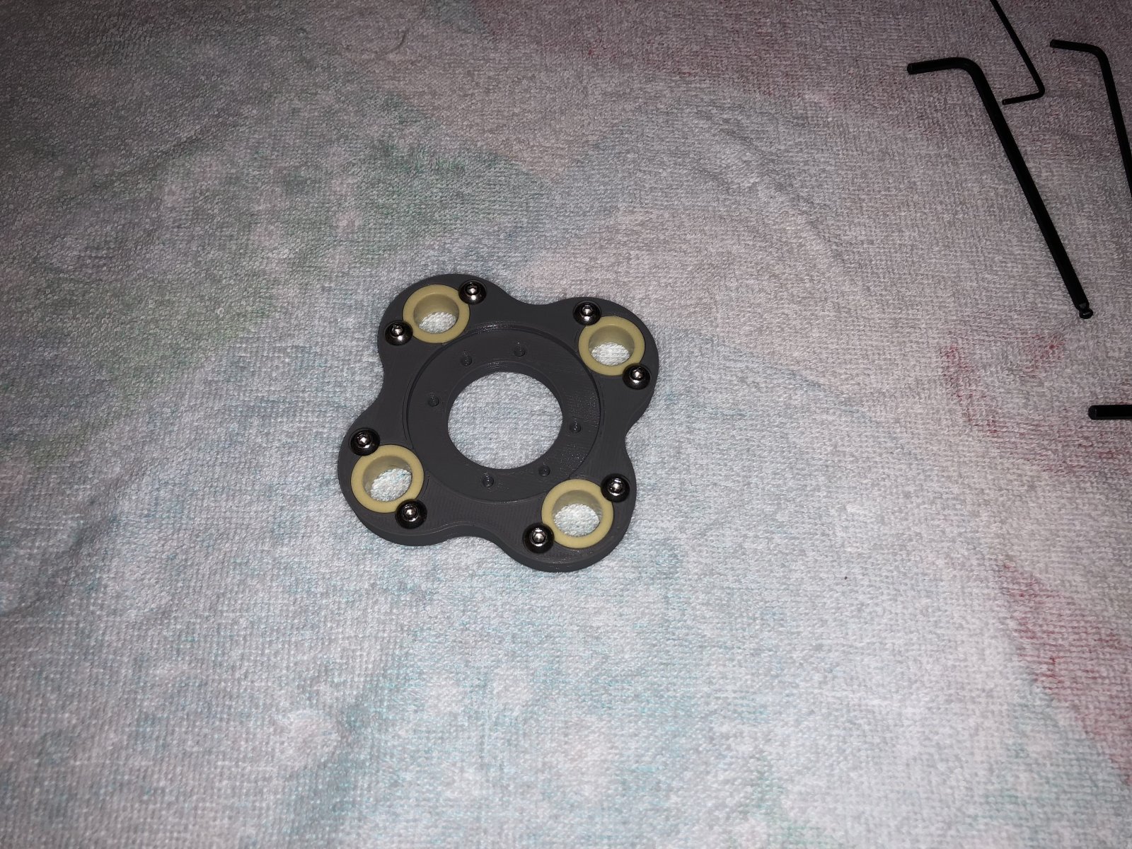

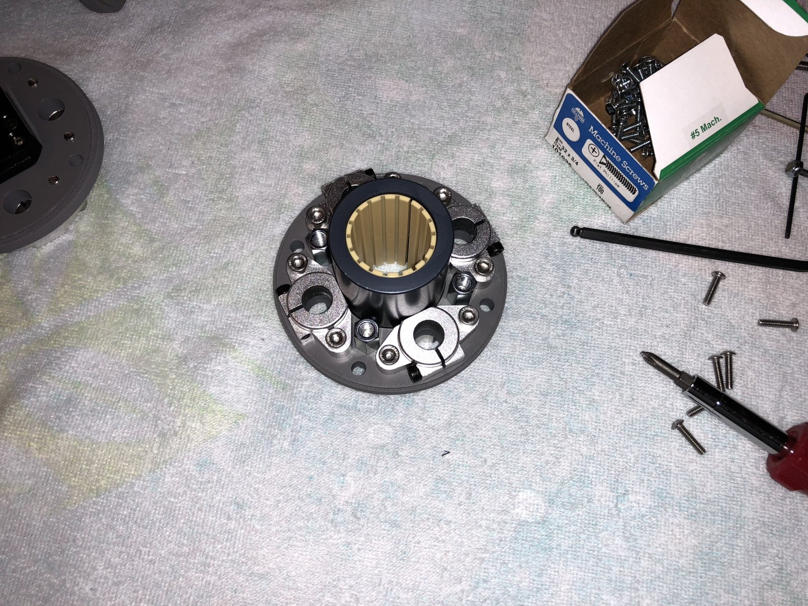

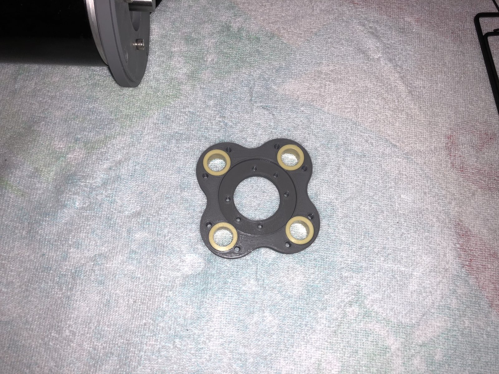

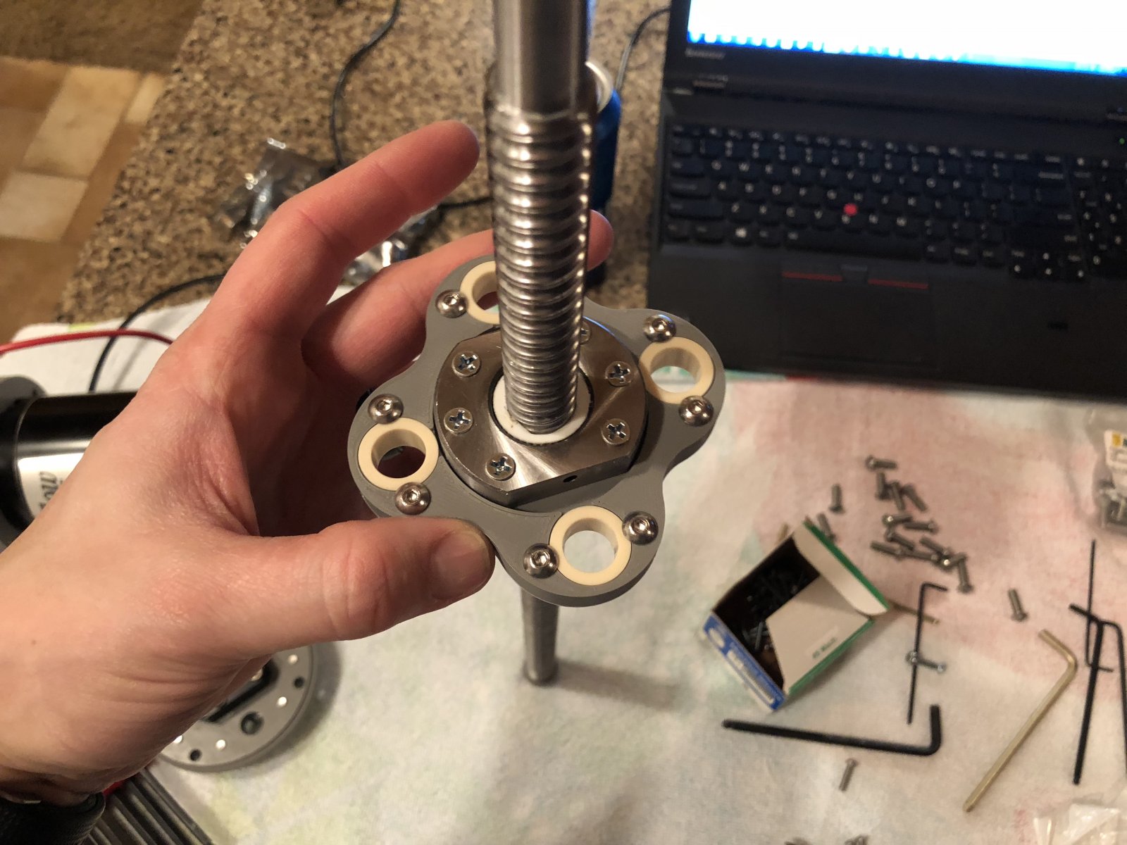

    Building up the plate that will merry the ball nut to the 4 guide shafts. the bushings are IGUS polymer and are press fit. The bushings are supposed to be installed into an exact hole so I picked up a cheap China reamer from ebay and reamed the holes to get the right fit. Bushings are retained with some 8-32 pan head screws.
    Mounting the ball nut in the guide plate, I am using 6-32 flat head screws to help center the ball nut. I had planned on countersinking the 6 holes slightly to get a flush mount on the screw heads and maximize travel, but realistically its about 1mm of lost travel. I didn't have the right screws so these ones were just a bit too long and stick out the back too far. also they are Philips and I always try to go with Allen screws.

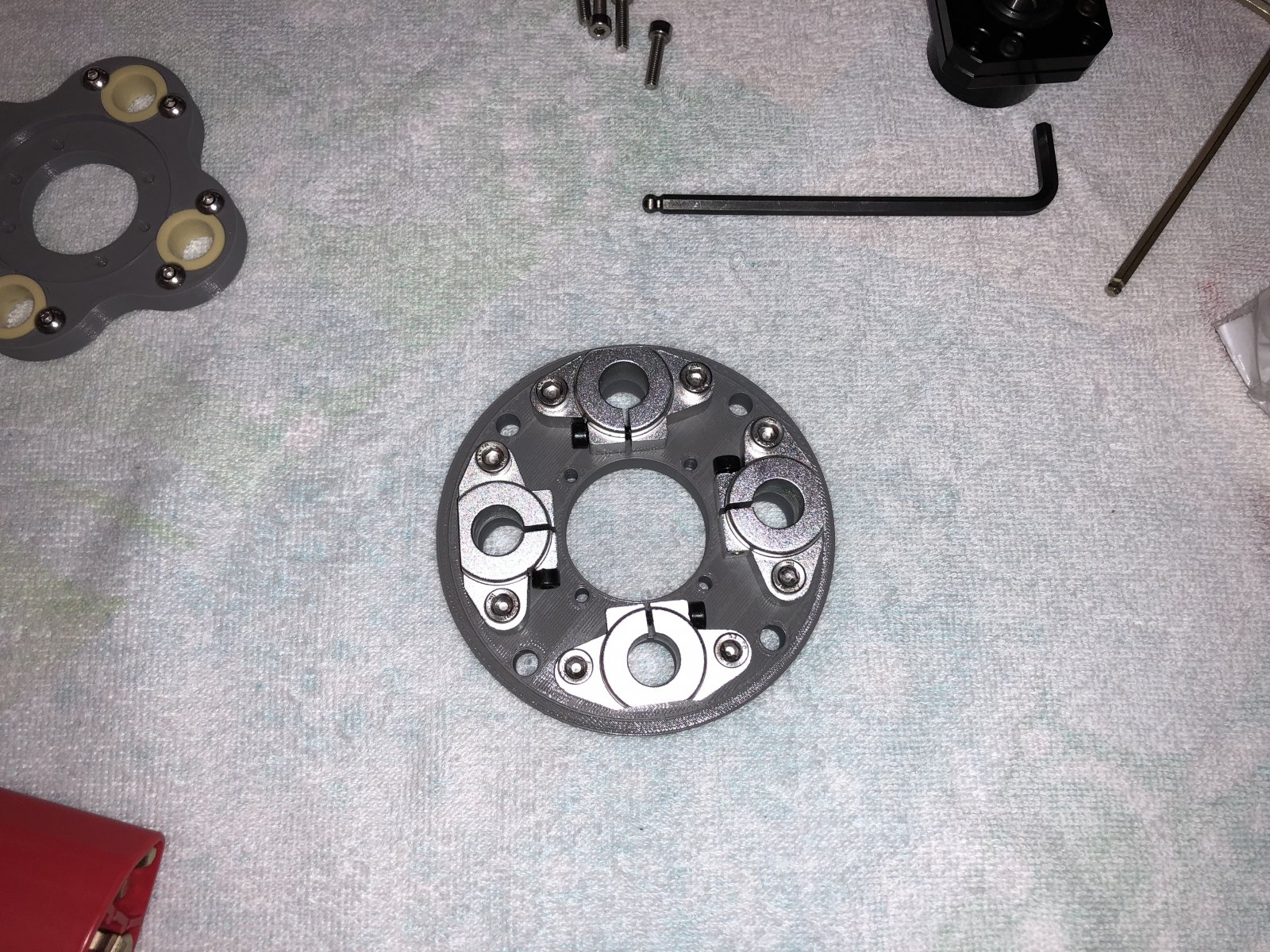

    This is the lower plate that holds the ball screw bearing and shaft clamps for the 4 guide rods. Notice that the shaft clamps have been trimmed, that was the only way I could fit these inside the 4" OD tube. I trimmed them on my CNC.
    Next I assembled the top plate (I already had this assembled before I started). I am using an IGUS 30mm Polymer bearing with aluminum housing. I had to mill some notches in it to get the whole assembly smaller. If you look closely you can see the 4 screws that hold the bearing in have coupling nuts on the top side, this is where my cap will screw into.

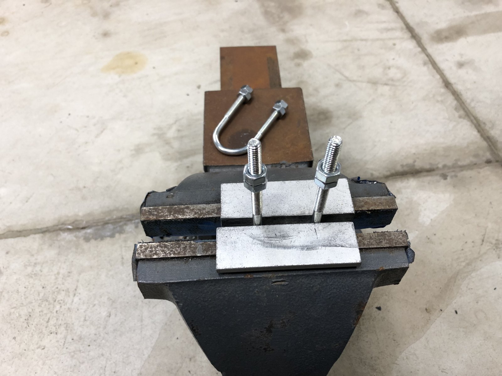

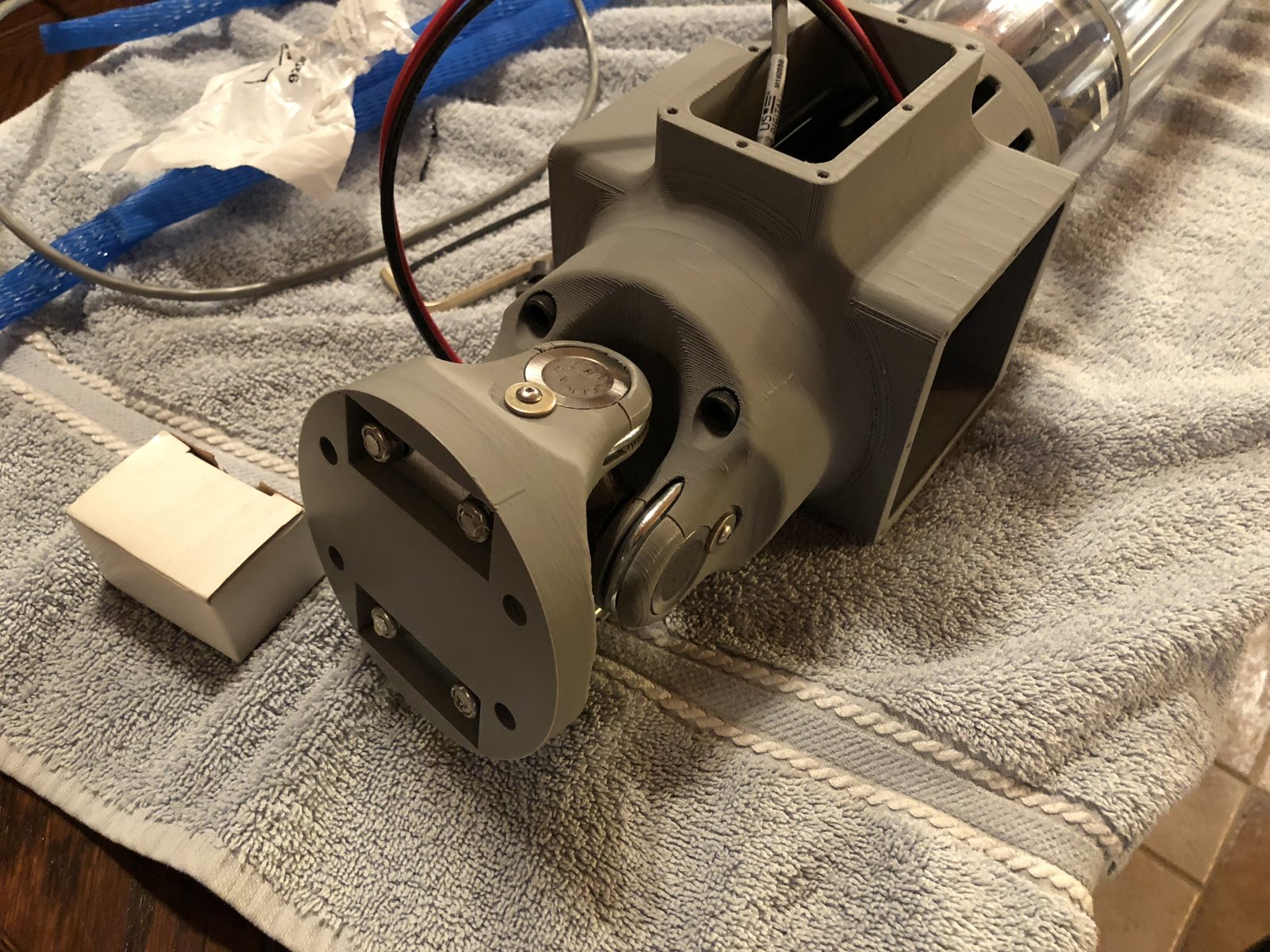

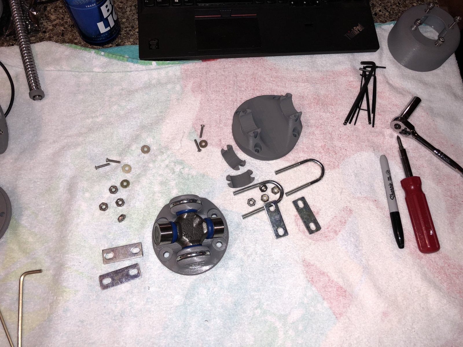

    Assembling the U-joint, I changed the design to utilize the flat plates that come with the ubolts. I had to cut all of the ubolts to the correct length so I double nutted them in the correct location and then used the nuts as a cut guide. I swapped out the standard hex nuts for some low profile lock nuts. Also the one side has a relief that matches up with the encoder.

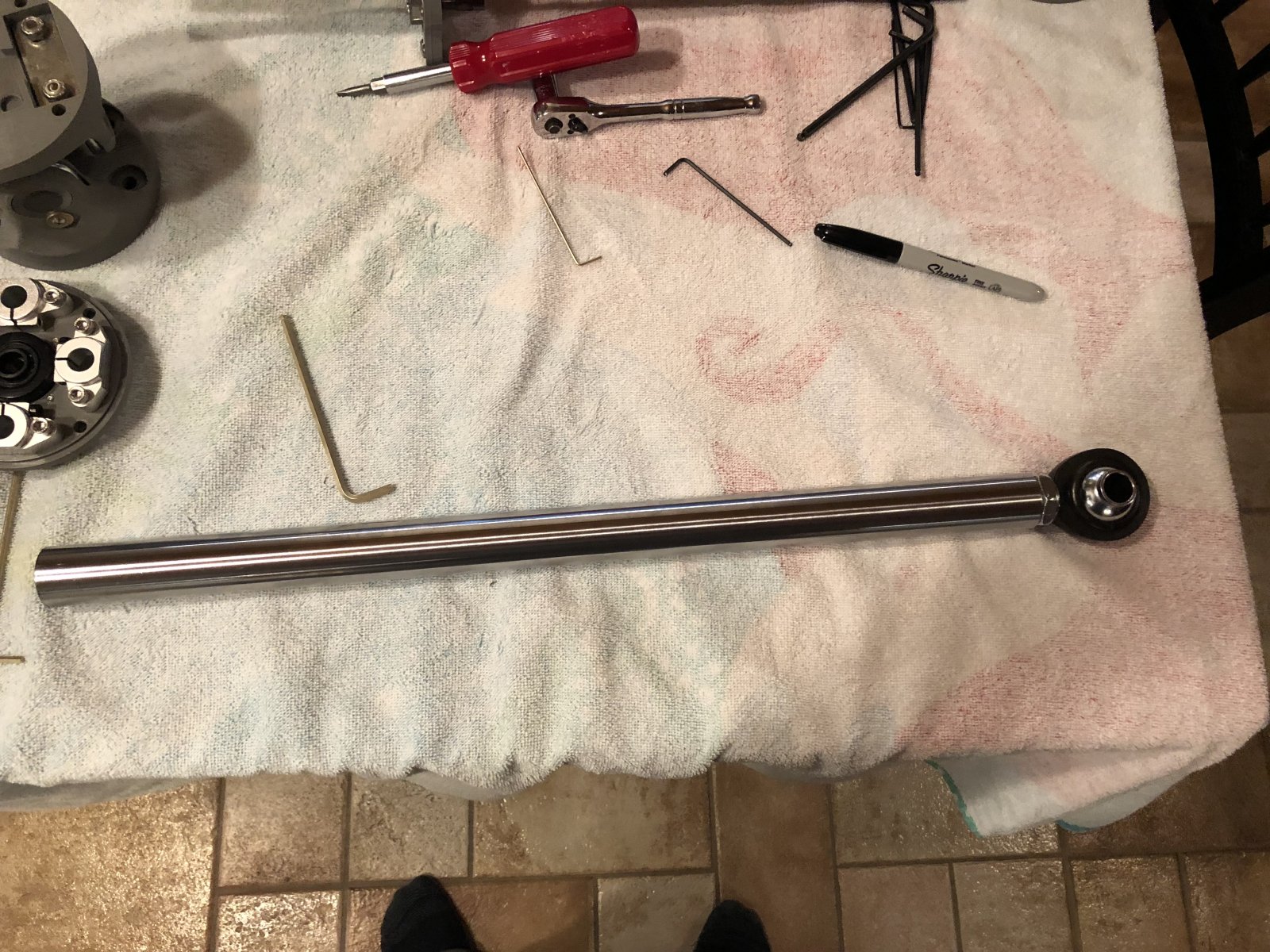

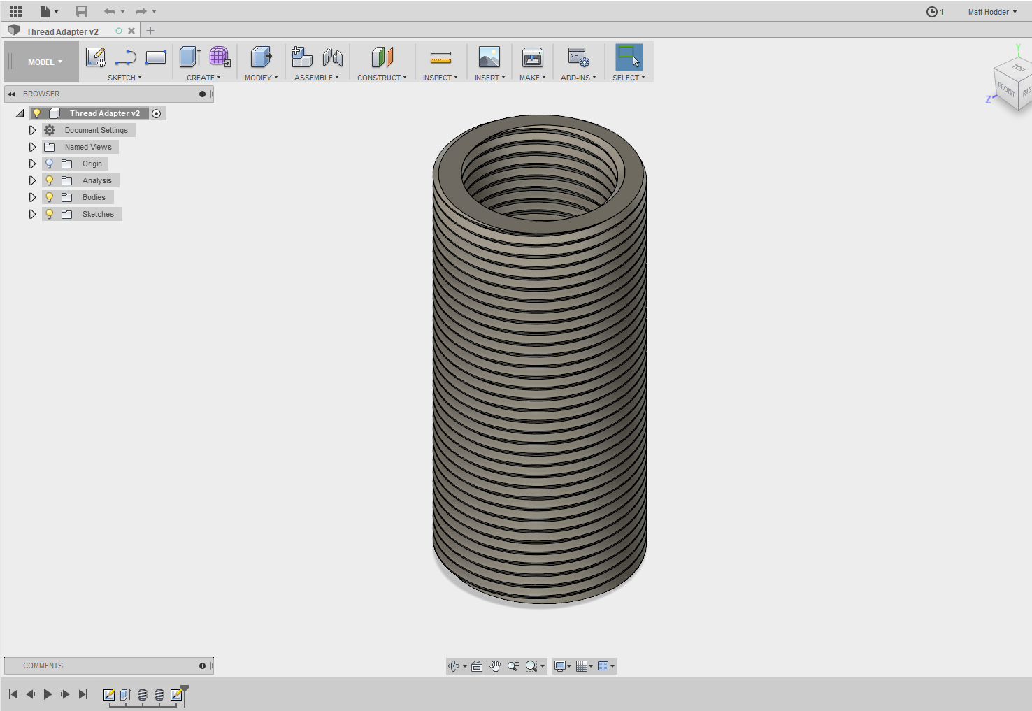

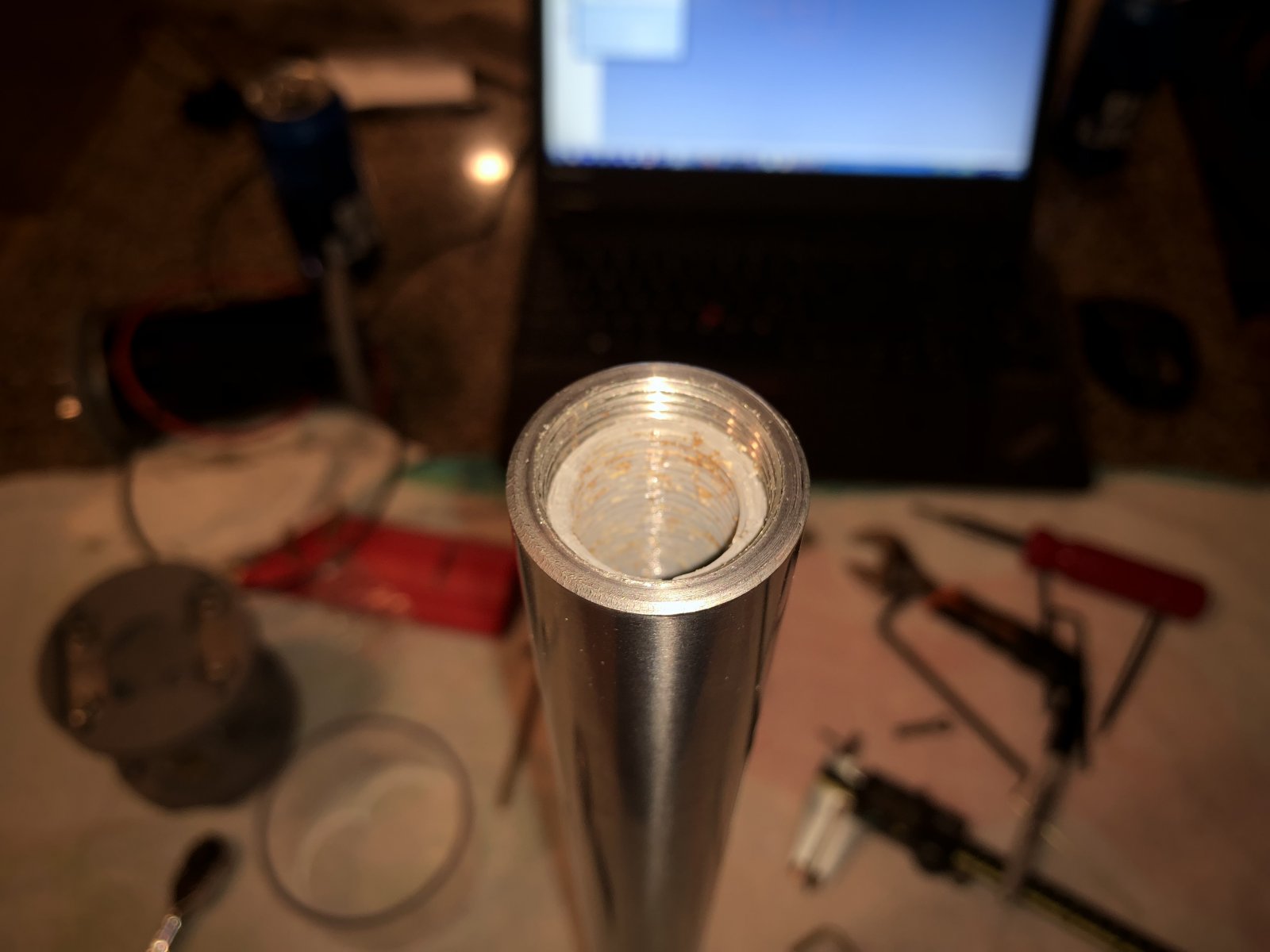

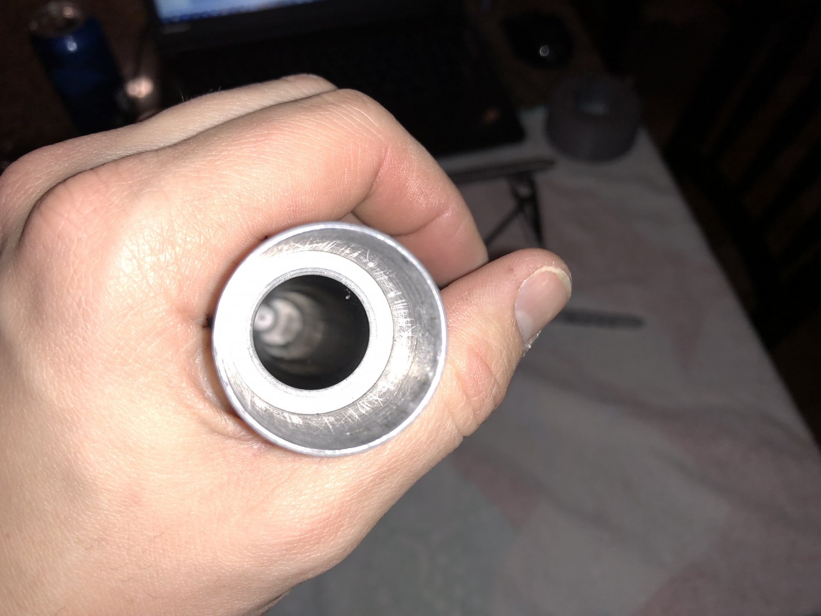

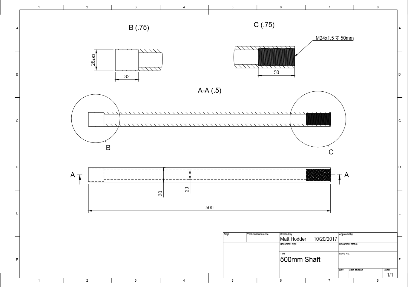

    Building up the main shaft, It is a custom hollow hardened linear shaft. One end is bored out to accept the ball nut and the other is threaded for a swivel joint. I ordered it from a shop in china and I am very impressed with the quality, the side that accepts the ball nut is bored out to 28mm, that's only 1mm wall thickness left and they pulled it off. On the other end I couldn't get the correct thread so I had them make it with a larger thread and then I printed an insert with threads on the outside and inside. I didn't do it for this build, but long term I will run a 3d printed insert on the end of the ball screw to reduce wobble. For that reason the inside of the linear shaft needs to be smooth. However when I got the shaft the inside was rusty and pitted, I asked the factory if they could polish it for me and they said the couldn't. I picked up a hone and polished the inside of the shaft enough to get rid of the rust and minimize the pitting. I don't have a good picture of it, but the tools is a flex hone. The last piece is a super swivel rod end with a 3/4 shank and 5/8 mounting hole. Its pretty big, but I wanted it to look proportional.

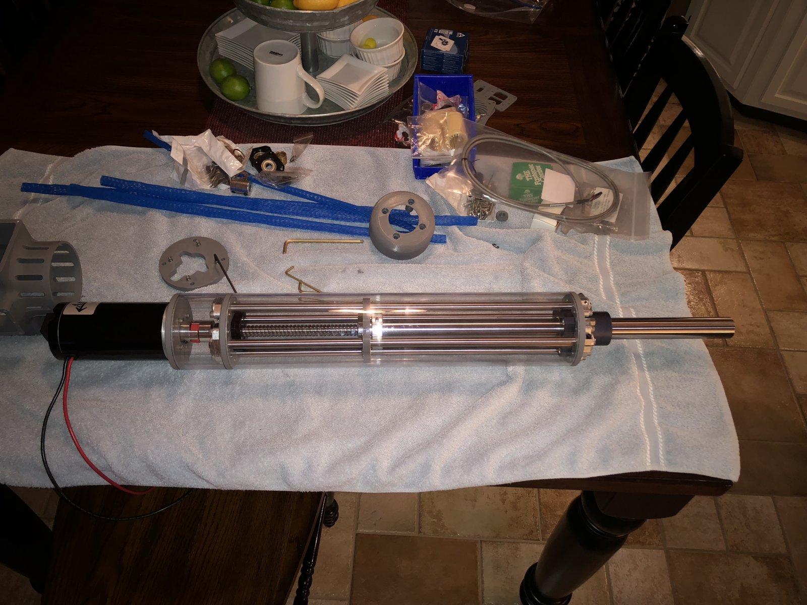

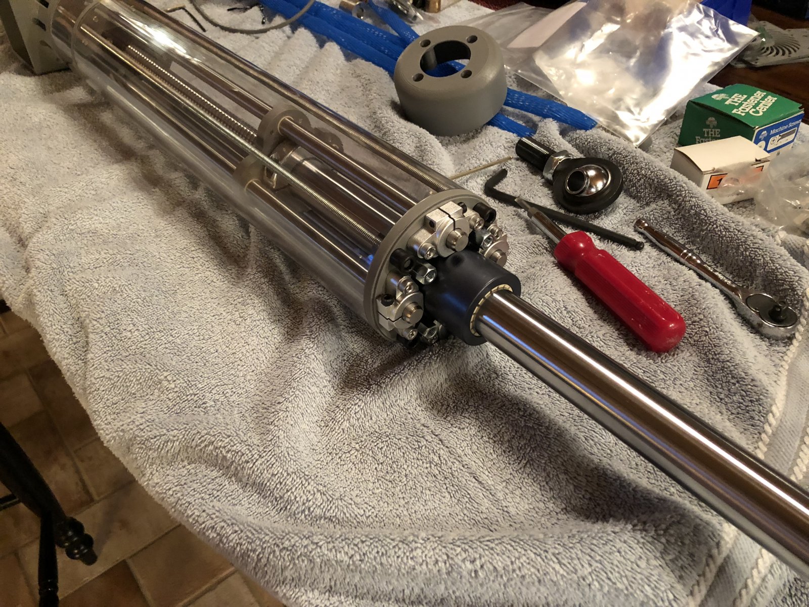

    Next I started assembling everything, here I have the main shaft clamped into place with a 30mm shaft clamp. If you look closely you can see a gap between the shaft clamp and the ball nut plate, that is from the wrong screws sticking out too far. I also installed the ball screw in the lower bearing and locked it in with the included nut. Then I worked the (qty 4) 12mm hardened shafts into place. surprisingly everything went in nice with minimal binding. Then I added the flex coupler to the motor and ball screw and mated the two halves together.

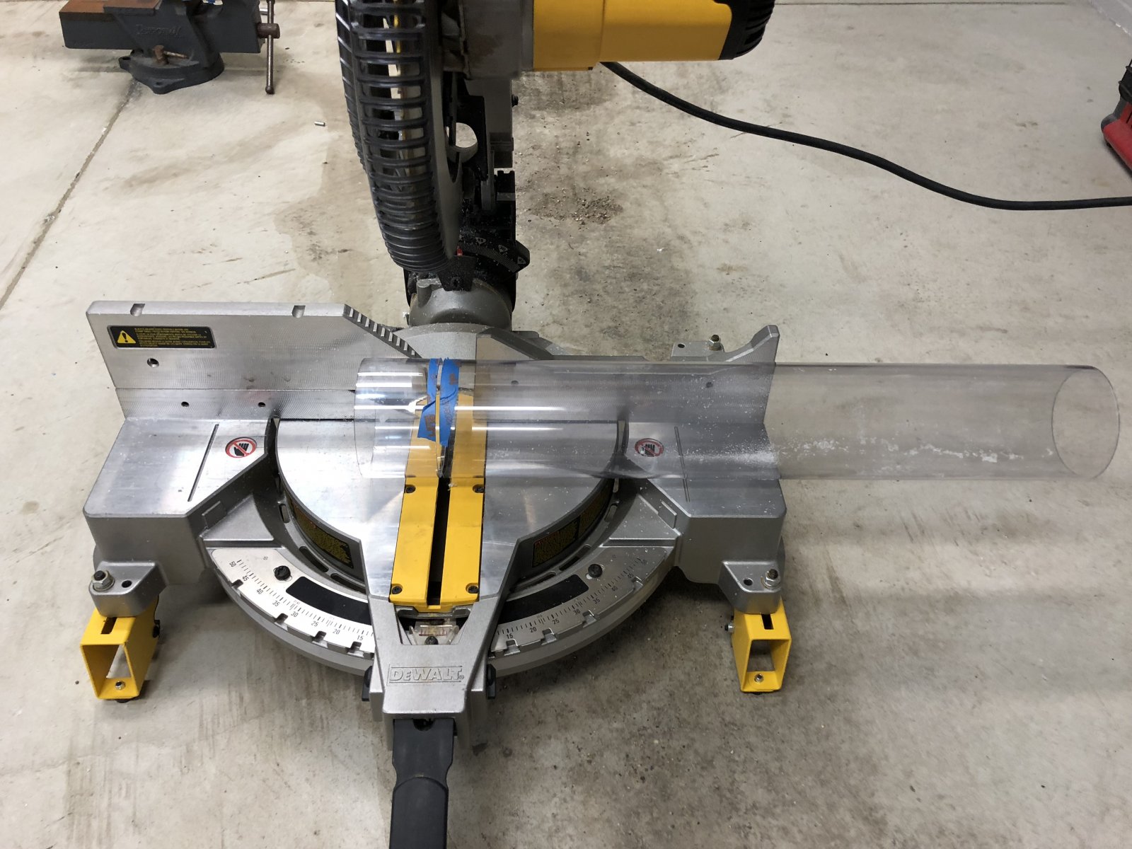

    Then it was time to cut the polycarbonate tube to size. I am using a 4" OD x 3.75" ID x 24" tube trimmed into the two sections. For the final version I had planned on replacing the polycarbonate with 6061 aluminum, the cost is about the same believe it or not. I trim these up on my chop saw with a coarse carbide wood blade and I just go slow enough not to crack it and not so slow as to melt it. I used the blue tape just for marking the length. Lots of hot plastic gets stuck inside the tube so I wash them out and chamfer the edges with a deburring tool. First test fit didn't go well, I printed my parts with no tolerance so I had to file the groove down to get the tube to fit. I also hit my first gotcha moment here, my plan for assembly didn't work out so I had to remove the swivel rod end and in order to put everything together in the right order.

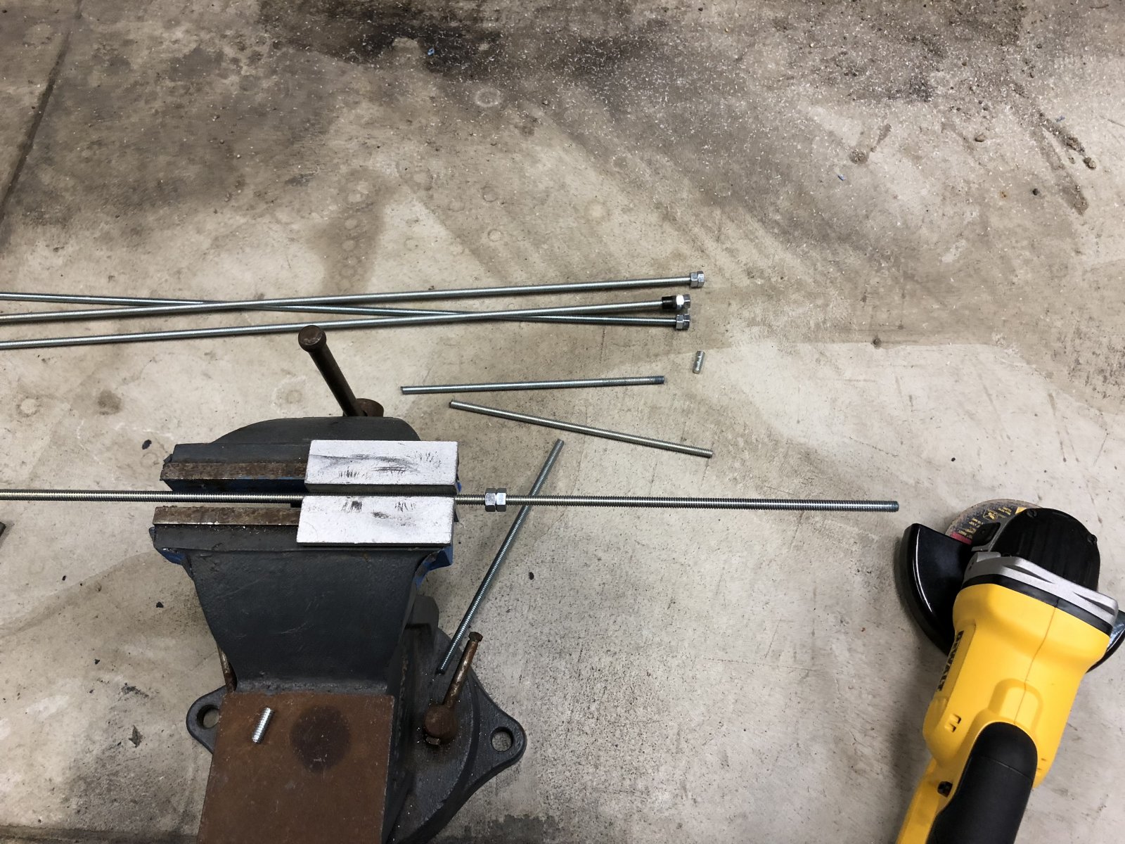

    Last customization was cutting the 4 threaded rods to length, more of the same with double nuts as guides. I slowly worked the rods in from the top down, I of course removed the lower motor mounting plate and installed my housing too. While I had access I also installed the encoder cable. I used an internal hex nut on either end of the assembly to lock every thing in place, its a tight fit so it had to have a small OD. The last step was to re-install the swivel rod end and the cap.

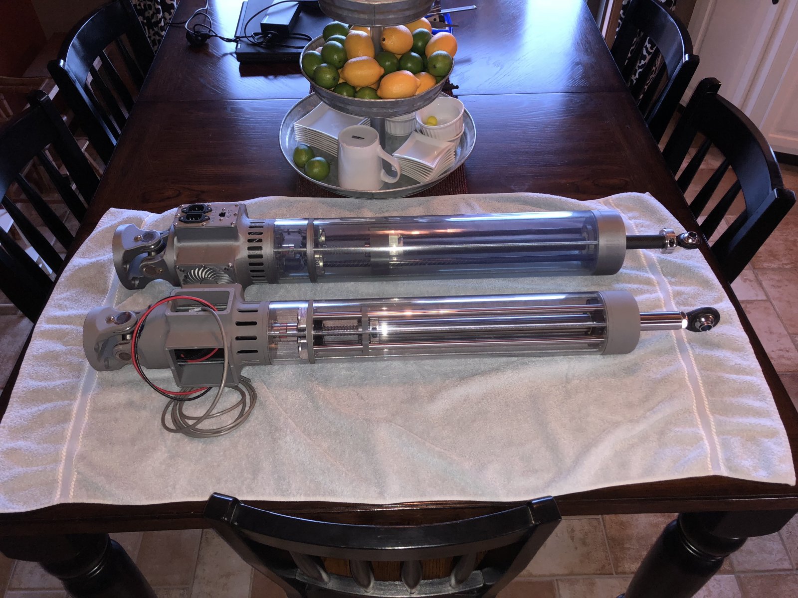

    Here is the finished actuator next to my old actuator. Its not actually finished as I need to install the fans and wire up the connector plate, but close enough for testing purposes.

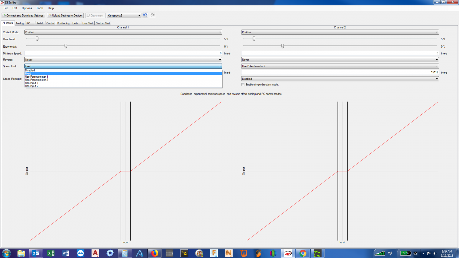

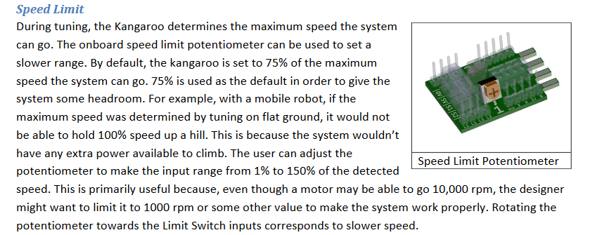

    Just had a thought, the kangaroo is speed limited from the factory, I think 75%. I will have to play with that and see. Tomorrow I am going to strap my phone to the actuator and get some data with the accelerometer. I need to get some actual results. I also need to think of a way to accurately test the max speed.
    Edit pulled from the kangaroo manual
    Describe has the ability to set the value manually or turn off the speed limit completely so I will have to test that tonight.
