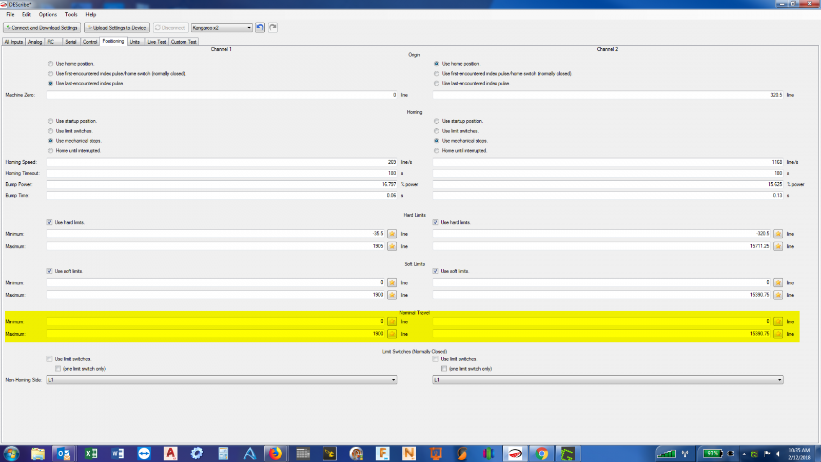

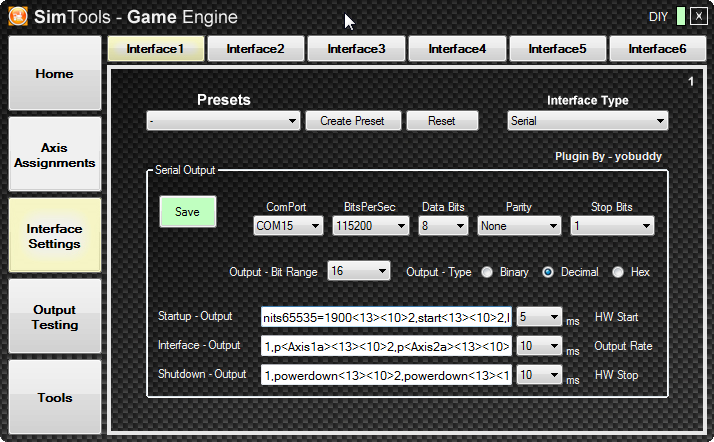

    After some actual testing my theory on the encoder and resolution isn't exactly correct. The confusion comes from the different encoder sources using count/line/pulses as mixed terminology and the way the kangaroo interprets the pulses. My first actuator used a 200 pulse encoder from sparkfun, there words directly. Turns out that the sparkfun encoder is actually 200 counts and 800 pulses per revolution. My new encoder is a 50 count/200 pulse encoder from US digital.
    There is a factor of 8 difference between the two actuators (10mm pitch vs 5mm and 50/200 vs 200/800 counts/pulses), not really a problem as I wanted to keep my total pulse count below 80,000/s for two units. I am still getting a theoretical max 20,000 pulses/second with the new actuator which puts me comfortably at the 50% mark for total pulses. Here is where the kicker comes in with simtools and the kangaroo. The kangaroo actually reads the pulses as 1/4 count so each pulse adds 0.25 to the position. So it is possible to control the position of the kangaroo down to 0.25 increments giving me the the minimum step of 0.05mm that I had speculated (10mm /200 pulses). However, Simtools outputs in whole numbers so with simtools even using 16 bit output I still reduce my step resolution by a factor of 4. so my minimum travel is up to 0.2mm. There maybe some hope though as describe has a units function that allows commands to be scaled (IE move 1 foot would equal 1 foot) I thin I can just change this by a factor of 4 to get back tot he 0.05mm minimum move. something like 4 = 1 line and then scale up simtools output to be 4x my current output.
    These are my current parameters
    1,start<13><10>1,home<13><10>1,units65535=1900<13><10>2,start<13><10>2,home<13><10>2,units65535=15390<13><10>
    1,p<Axis1a><13><10>2,p<Axis2a><13><10>
    1,powerdown<13><10>2,powerdown<13><10>
    Notice I am scaling the 16 bit output to the 1900 counts in the kangaroo, I believe if I change the units in describe I can just change the scale by a factor of 4 to be 7600.

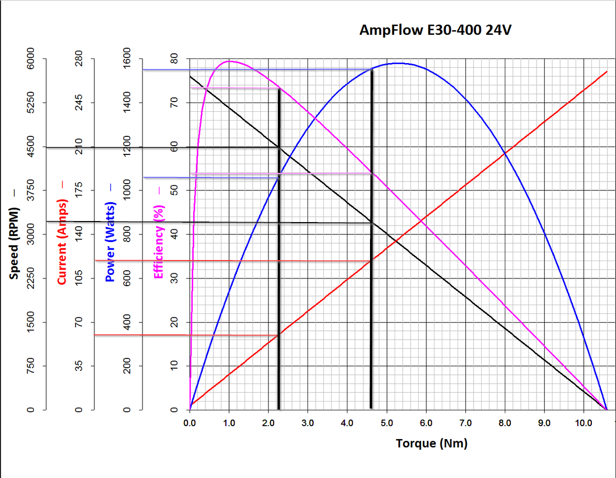

    Did you / do you measure current it's pulling? I had hopes this would run on a Sabertooth 2x32 @ 24V.

    No I haven't measured it yet, and none of my testing has been under load. I would think you are going to run out of juice though. take a look at this chart and see where 32/64 amps puts you. you will be pretty low on the chart. I would wait until I can do some additional testing though as its still up in the air. I wish the sabertooth 2x60 had the same usb interface as the 2x32 and I could just monitor the current of each channel real time. It would be cool to sync the two outputs on the 2x60 and get 120/240 amp peak that would really push the limits of this motor.

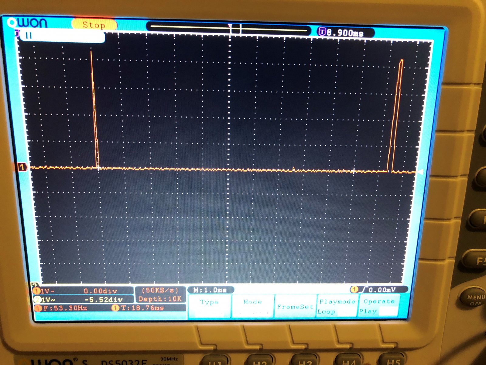

    Didn't get as much done as I would have liked, but still good progress. I set out to get a better indication of the max speed. I started by using my o-scope to read the Index pulses on the encoder, after a bunch of fiddling around I found the best way to do it was to send positional commands over serial to move the actuator from one max to the other. during which I would record the pulse outputs with my scope.
    Here is a screenshot from the middle of the stroke.
    I counted am showing about 11.5ms from pulse to pulse which is one full rotation of the motor. ((1/0.0115)*10mm)=870mm/s

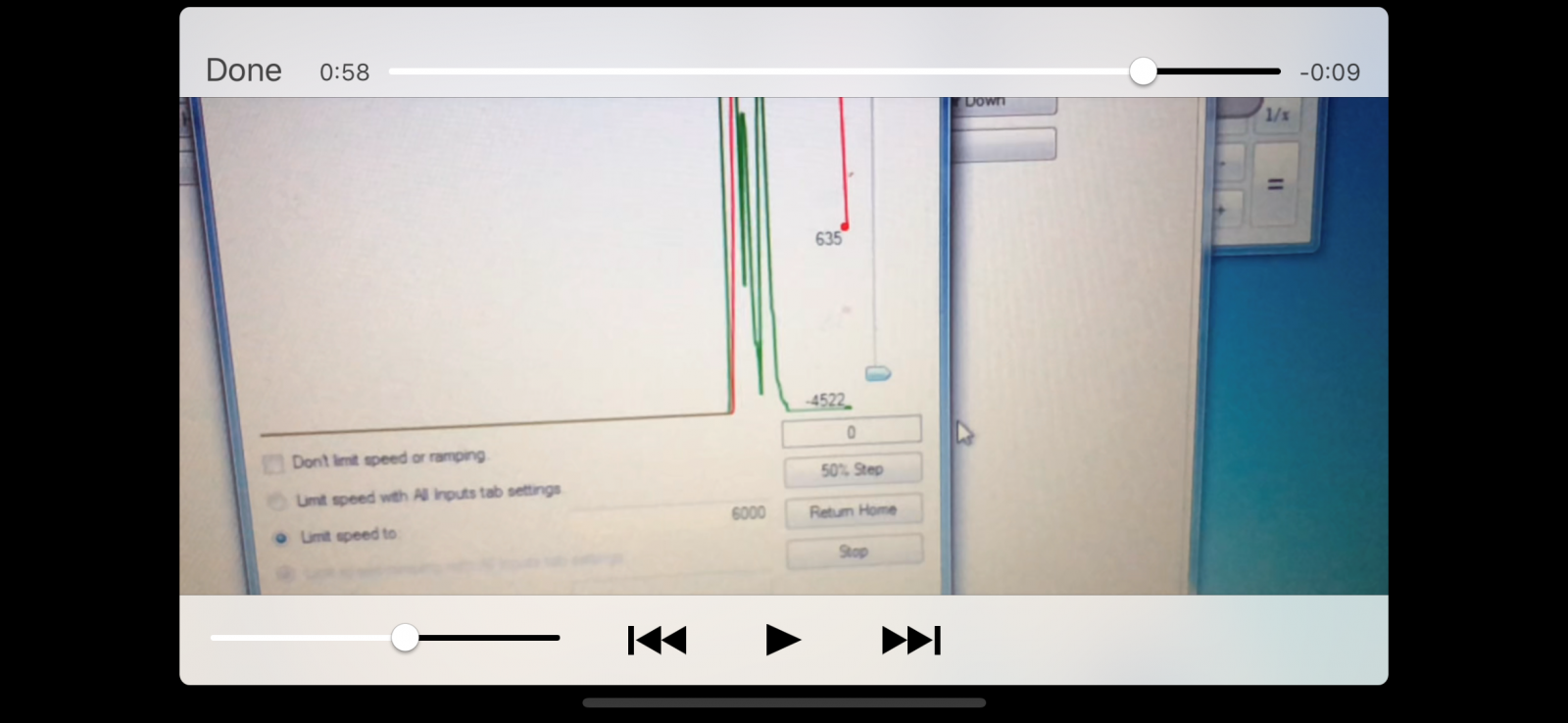

    then I started playing around with live positioning and noticed there is an option to show current speed in counts. I had to take a slow motion video and step through it a frame by frame, but the highest value I was able to capture was 4,522 counts/s. ((4,522/50)*10mm) = 904.4 mm/s. If you notice where the position is the motor is just starting to decelerate so by the looks of it I am running out of stroke before max speed is hit.
    for the testing I turned off speed limiting and there was a noticeable jump in speed. so much so that I think I'm over driving the mechanical components and there is a lot of vibration near top speed. I will try to get a video as soon as I can.

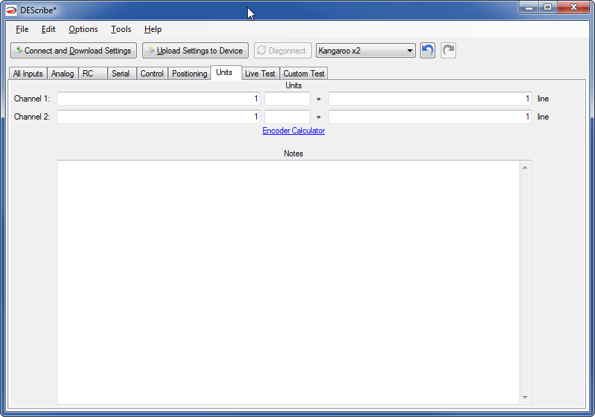

    Lastly I tried sending decimal commands to the kangaroo like 1,P100.5 and there was no response so I am pretty confident that the UNITS function is scaling to whole numbers and as such I will only get 0.2mm minimum moves with my 50 count encoder vs my hoped 0.025mm.
