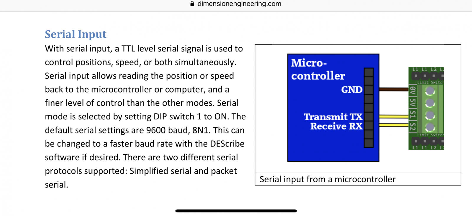

    I’m using a usb to serial converter. Spark fun FTDI basic 3.3v board. No particular reason other then I had one in my box of parts and it worked.
    https://www.sparkfun.com/products/9873
    I am connected directly to the kangaroo with the usb to serial converter using 3 wires going to tx-s1, rx-s2, g-g (serial-kangaroo).

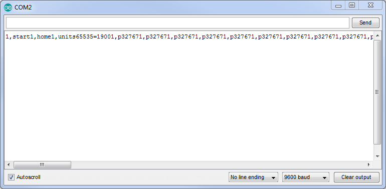

    I don't think the carriage return <13> command is required for the kangaroo, I just did a little testing and it doesn't seem to be doing anything.
    Test 1
    Start - 1,start<13><10>1,home<13><10>1,units65535=1900<13><10>
    Interface - 1,p<Axis1a><13><10>
    Shutdown - 1,powerdown<13><10>
    Result in serial monitor
    1,start
    1,home
    1,units65535=1900
    1,p32767
    1,p32767
    1,powerdown
    Test 2
    Start - 1,start<10>1,home<10>1,units65535=1900<10>
    Interface - 1,p<Axis1a><10>
    Shutdown - 1,powerdown<10>
    1,start
    1,home
    1,units65535=1900
    1,p32767
    1,p32767
    1,powerdown
    Test 3
    Start - 1,start<13>1,home<13>1,units65535=1900<13>
    The commands all run together, however when I try to copy and paste the code the computer automatically adds the new line like so
    1,start
    1,home
    1,units65535=1900
    1,p32767
    1,p32767
    all of my testing is using just a virtual serial bridge and the arduino serial monitor so I will have to test this out on the actual kangaroo when I get a chance.

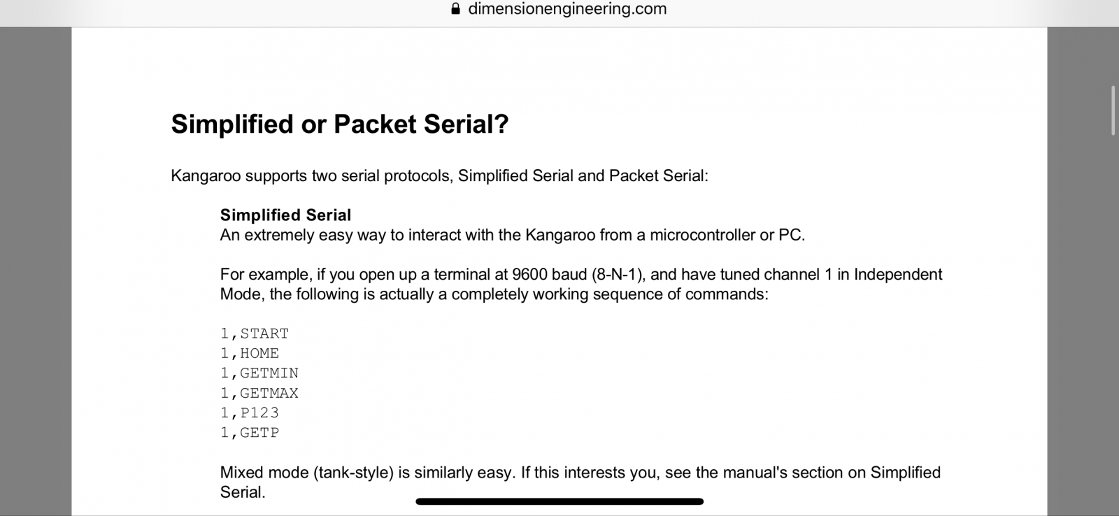

    Pretty sure we are running simplified serial not packet serial
  12. Hoddem
    Hoddem Well-Known Member
    Sep 27, 2016
    404
    Engineer
    Minnesota, USA
    3,342Coins
    +717 / 2 / -0
    Here are the simplified serial commands from the manual

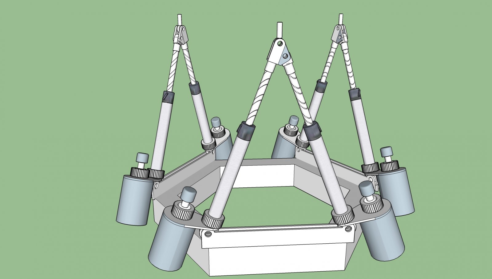

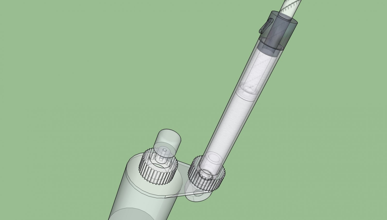

    The cylinder spins on this. (be cool if they were all striped)
    Designed for easy maintenance, good thing with 6 cylinders.
    Belts should reduce some of the noise.
    Adjustable gear ratios.
    Fairly simple to build.
    Easy access to components.
    I still like my 2dof so someone else can fave the honer of being the first to build : )
    Model needs to be cleaned up some, but I think it works!

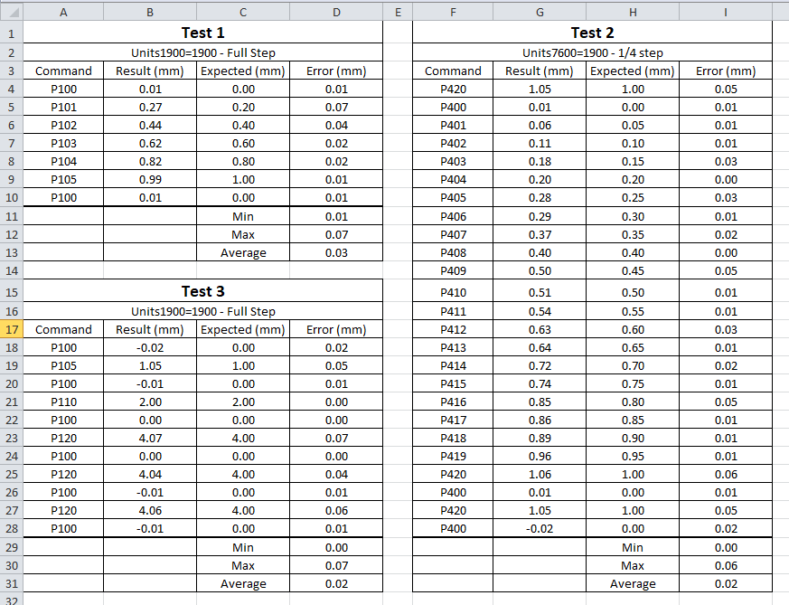

    I had a chance to get some additional testing done tonight, Here I am running positional commands in describe to show the accuracy of the actuator.
    My actuator is 1900 lines of travel so when I scale 1-1 or units1900=1900 one position should be .2mm, when I scale units7600=1900 one position should be .05mm
    Here is what I found
    These numbers are going to be best case, no load and small movements. I will have to repeat the test again with a load at some point. Based on what I was told by dimension engineering the actuator will always be in "1/4 step mode" as long as my simtools output is greater than 0-7600 (13bit or greater).
