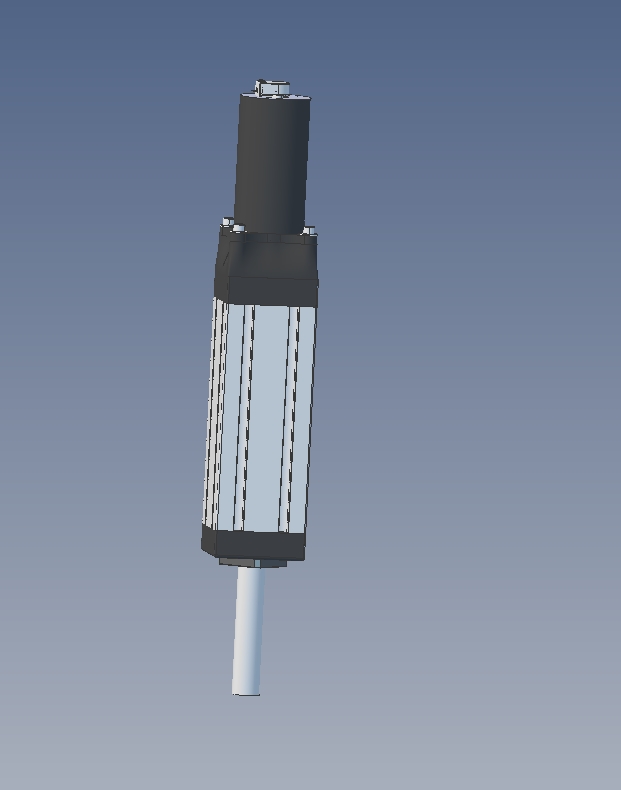

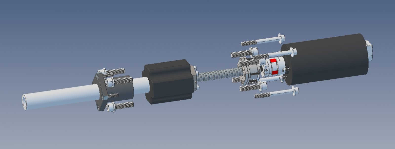

    Hey guys,
    I have had this burning in the back of my mind for a few months now and I think I have come up with a compromise that will keep me moving towards a full motion rig. Initially I was going to just pull the trigger on the full 6dof system and start buying parts, but I pulled back a bit mostly because of the complexity of a full 6dof system. I would essentially be scrapping almost all of my existing system and starting over. After lurking around on the forums here and there I came across the SFX-100 thread.. I really like the simple design, but I don't like being locked into 240v servos (no easy access to 240v in the new garage). So my new game plan is to build a set of SFX style actuators utilizing the Ampflow E30-400 motor and Sabertooth/Kangaroo control system. I will slightly modify my existing rig to accommodate and hopefully for a relatively low expense and not a lot of work I can have a 3dof system up and running with as much success as the guys running the SFX-100's seem to have had. I have already finished the preliminary design and ordered all of the parts needed to build the initial test actuator. Luckily most of the parts on my actuator will transfer to these so if some day I decide to go 6dof I could still do so with less cost then starting from scratch.
    Specs
    ampflow E30-400 Motor
    Stall torque -4.6nm
    Max RPM @24V 5700
    1605 Ballscrew
    Max speed - 475mm/s
    According to @adgun, 1nm stall torque gives 100kgf of lift with a 1605 ball screw. I haven't run the calculations but if that is correct I will have 1840kg of lift with 4 actuators. These numbers start to get a little scary thinking about doing a 6dof with 6 actuators and 1610 ball-screws. 4.6nm*50kg*6 actuators = 1380 kgf /200kg rig = 6.9 g's. these numbers seem high, but again I haven't done any actual calculations.
    So here is the preliminary design
    As I wait for the first shipment of parts to come in I will be adjusting my cad model of my rig to accept the new actuators.
